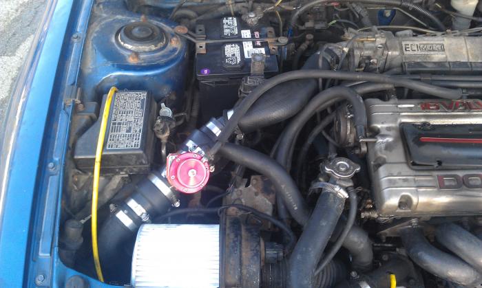

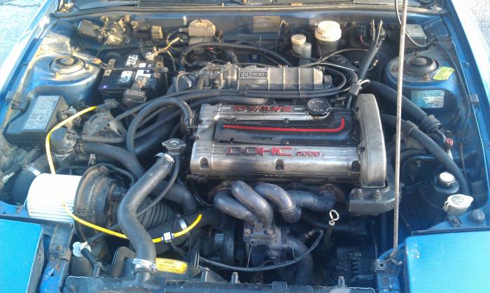

I would have stuck with the stock 1g bov. It would hold better than that knockoff.
I wish I would have. It's pretty ghetto, the way I set it up. The hose going from the bov to the elbow of the intake manifold is kinked, as well as the recirculating hose, so it's not getting good air flow. Shopping for ic piping and an aftermarket intake pipe right now. If I can't find anything good, I'll probably put the stock bov and hoses back on.

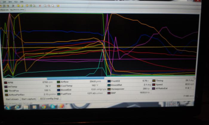

Your timing is very high on that log picture and you were knocking quite a bit.
Do you not log wideband? Should be a quite simple modification to add logging capabilities.
I downloaded ecm link to my laptop about a month ago and logged this. I haven't done any tuning yet. The person I bought dsm link from tuned it for me like this a couple months ago. I've been trying to get a hold of him to have him retune, but he's been a flake, took some parts from me and didn't pay me, and changed his number. Which is why I'm trying to learn how to use it...
Thanks for the link! Watched those videos. Should help out a bit.
Here are some prnt scrn images of that guy's tune on my car from ecm link. After watching those videos I'll be able to handle a few things and probably try out some tuning this weekend.

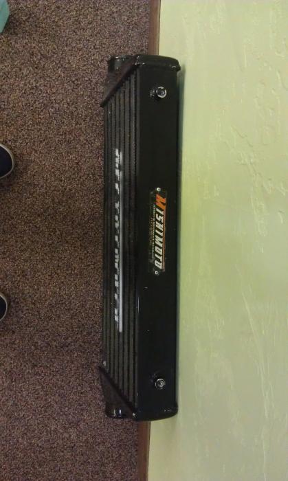

I wasn't able to get the fmic piping I wanted at the right price so I spent my weekend on plan b. I found a supplier out of Missouri that can ship me 5-6 feet of 2.5" aluminum piping for about $40. I have a friend who goes to school at the tech who can make all the proper bends and flare the ends of the piping, and also any necessary welds. Below is a pic of the intercooler that I have for install that I bought for $40. Should have everything installed within a few weeks. Will post my progress as soon it's happening.

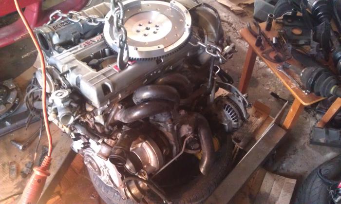

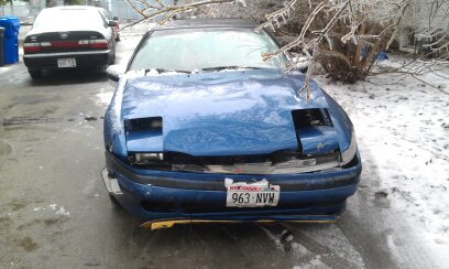

It's been a bad day. My wife got into a car accident this morning on her way to work. The front end of the car is totalled. I'm ending this thread and will be starting a new one very soon. I have a 93 talon tsi shell that i'll be building up, putting my motor and all of my upgrades into. The talon has previously already been 4g63t 6 bolt swapped, but the dude who rebuilt that motor didn't know what he was doing.. it's been sitting all winter with no head, so needless to say, the motor would need a lot of work before it can be rebuilt. I already have the talon in a friend's garage and have to get started and finished on this over the weekend, since I now have no vehicle. fml
It's been a bad day. My wife got into a car accident this morning on her way to work. The front end of the car is totalled. I'm ending this thread and will be starting a new one very soon. I have a 93 talon tsi shell that i'll be building up, putting my motor and all of my upgrades into. The talon has previously already been 4g63t swapped, but the dude who rebuilt that motor didn't know what he was doing.. it's been sitting all winter with no head, so needless to say, the motor would need a lot of work before it can be rebuilt. I already have the talon in a friend's garage and have to get started and finished on this over the weekend, since I now have no vehicle. fml

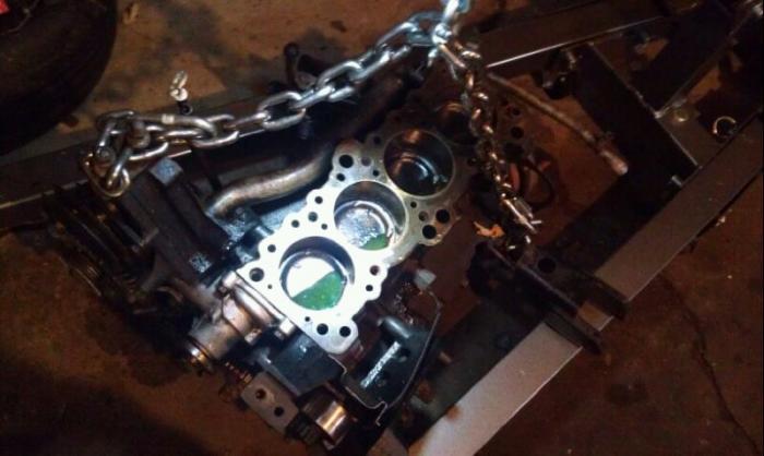

I already posted something in the newbie section but thought I might as well post something here as well. I plan on putting the motor that's in this car into a 93 talon tsi shell on Sunday. I also want to swap out the ecu, since I have dsm link v2. What do I need to know?

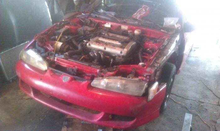

3 cans of brake clean and 3 wire brushes later.

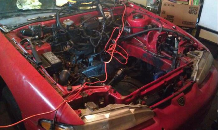

Almost everything is put together. I have a few minor things, like the rest of the dash, hood, etc..
I swapped out the section of harness that goes from the ecu to the engine bay so that I could keep my 90 ecu. Finding a 93 ecu with link would have been easier and much less work, but I didn't do that.
