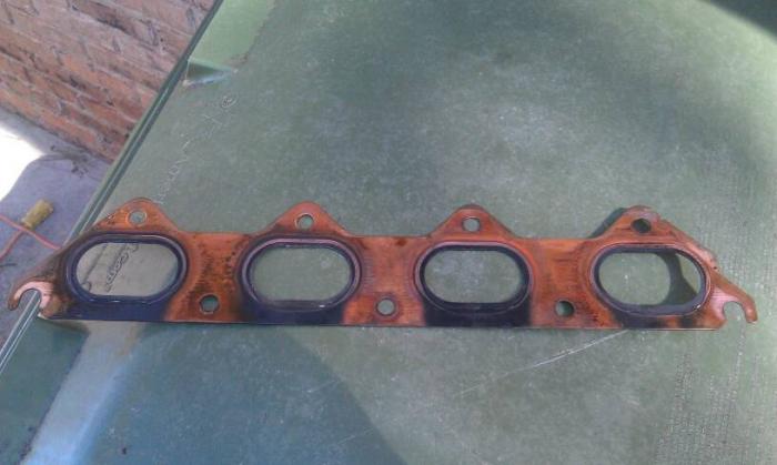

Felpro been good ever since
Awesome results Man!! I've heard great things about the Wally 450 though so for the Time being that's what I will go with, I've been Following the thread about jays pump and the results are awesome but I am a fan of Wally's so plan to stick with them. Also kel what gasket did you have an issue with the ERL because I remember reading your thread about it?
Thanks man I appreciate it! The old block and trans are already out of the car and ill post pics soon! As far as the flywheel I've been thinking the same thing about going with the ACT but ill talk to the guys at RRE before I make my final decision
The copper gasket it just wouldn't seal

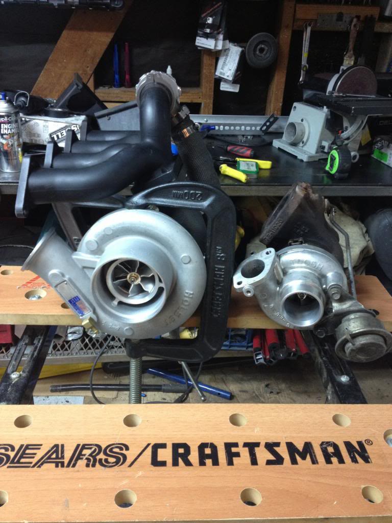

Finally home for a few days for thanksgiving so i decided to do a quick mock up of the Hx40 with the ERL t3 manifold and tial 38mm external wastegate with open dump tube. Thought for perspective's sake I'd throw in my old evo 3 16g right next to it to see how much of a different in size there truly is! More pictures to come this weekend! Happy Thanksgiving everybody! :hellyeah:
