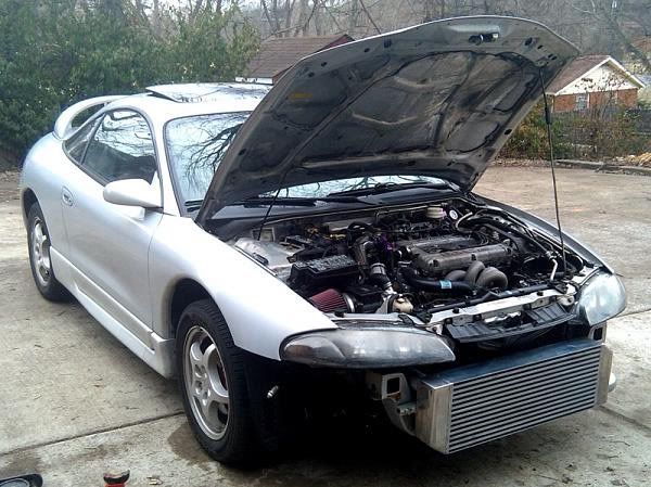

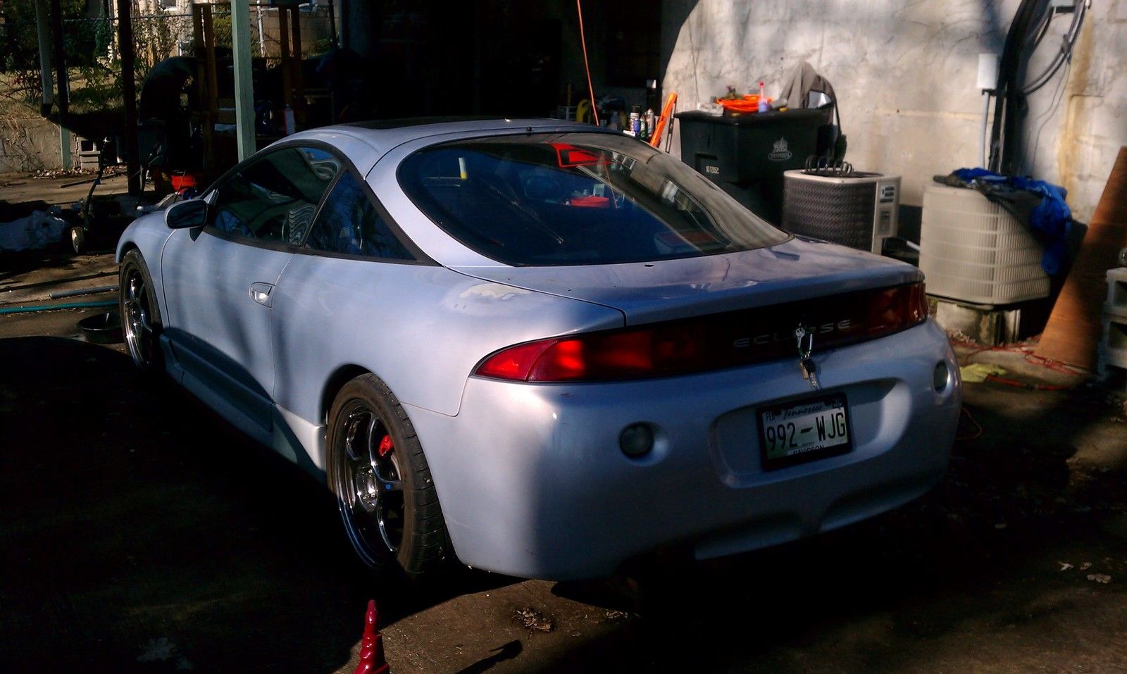

I received the gsx as a trade, along with some cash and injectors.
This:
For this: (minus the intercooler, which I added)
It had 176k miles on it, a few mods(some eBay), fuel cut like a banshee, and an auto trans. I wasn't super excited about the auto trans, the miles, the eBay turbo, the ride height, etc........

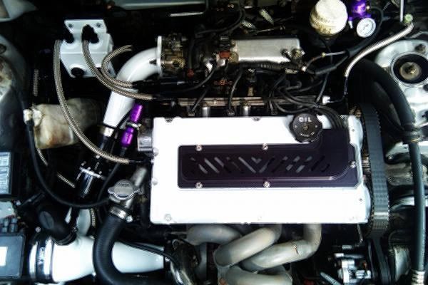

After installing catch can, intercooler, and powder coating some things.

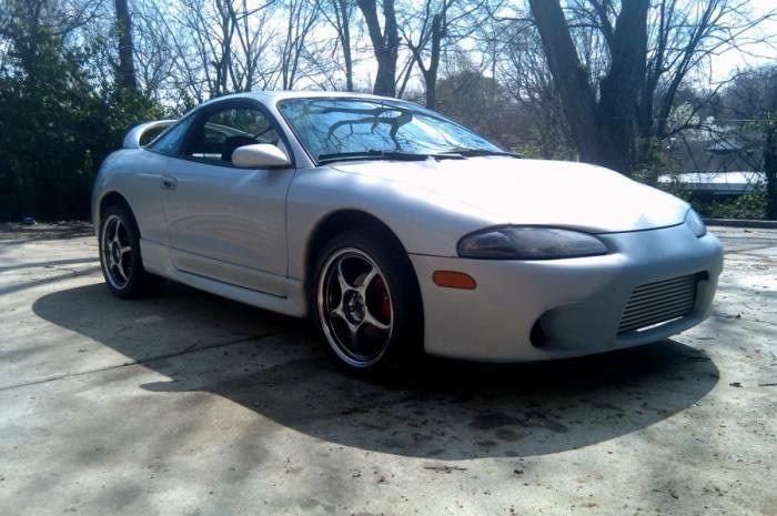

New wheels and a shaved front bumper.
Now basically up to speed. I am now on my quest to build a very clean, fast, street car that I can daily drive and have fun with. I'll be updating often as I can't stop screwing with this car.

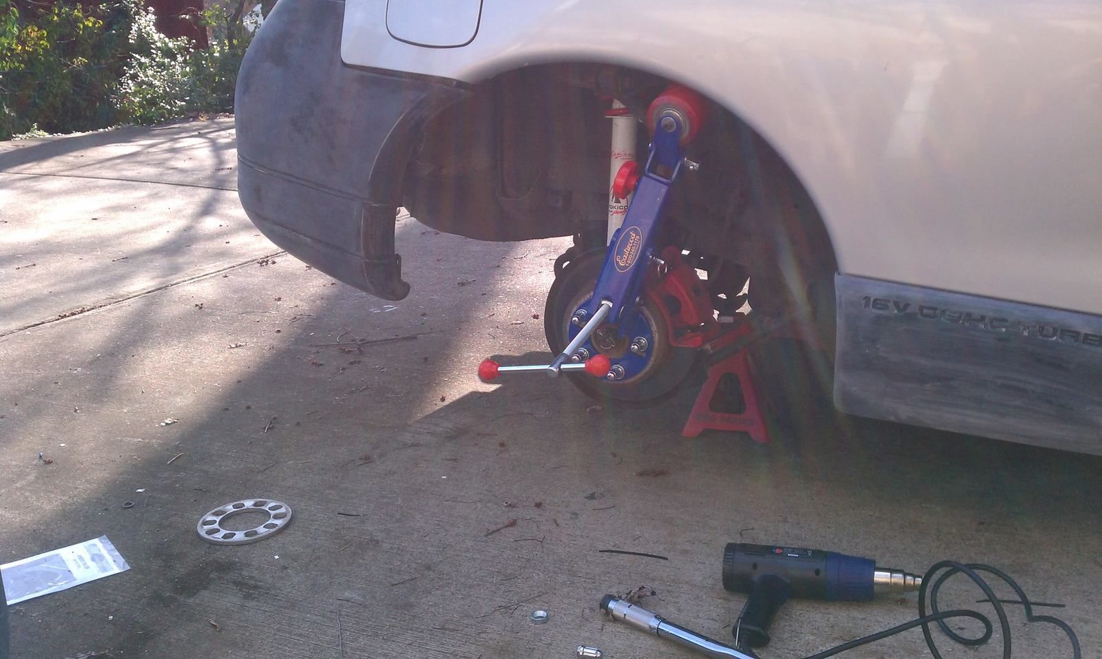

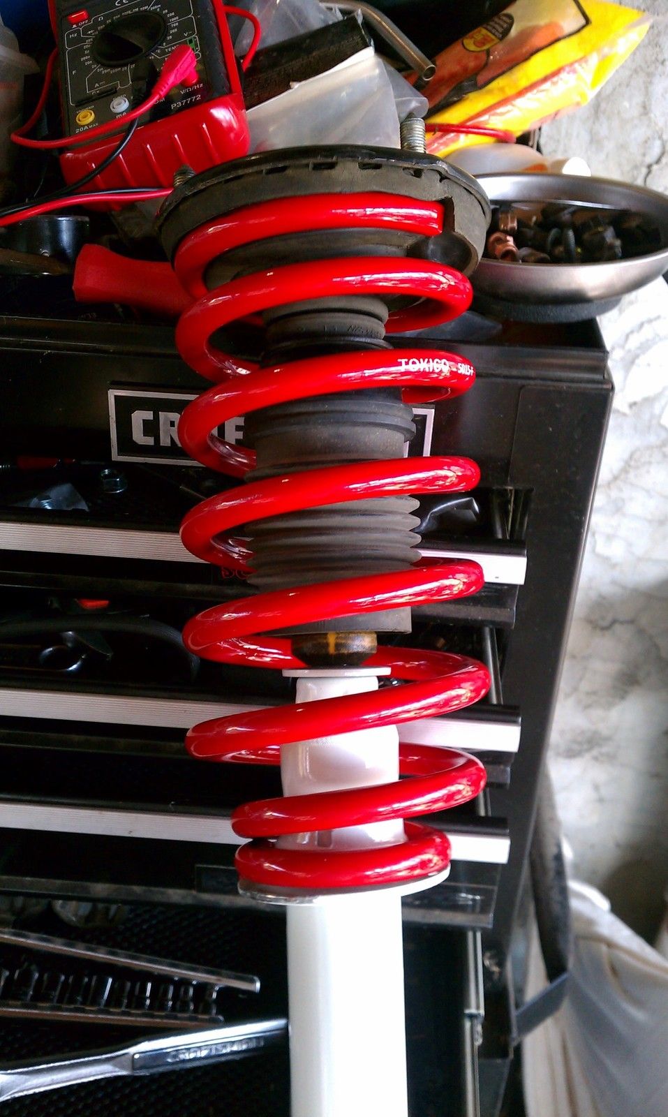

After installing wheels I really, really needed to address the "riding like a monster truck" issue. I did so with a tokico illumina suspension kit that I picked up crazy cheap.
Lower

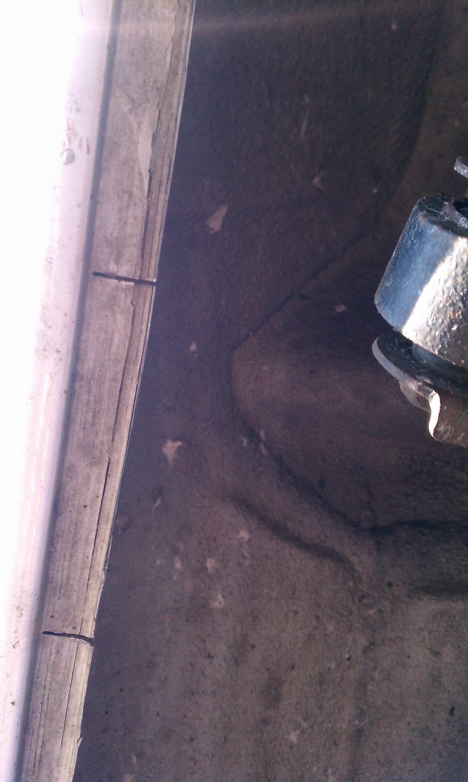

It rubbed in the back so time to roll.(more explanation on the body in a bit)
2g rear fenders really suck to roll. Had to cut slits and persuade with a hammer.

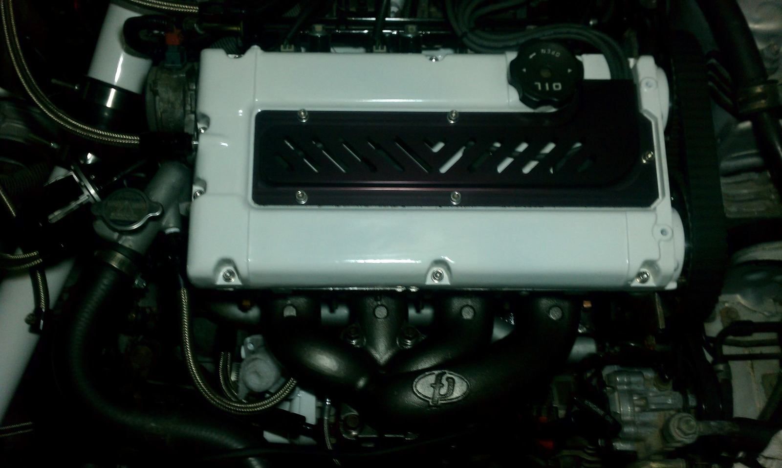

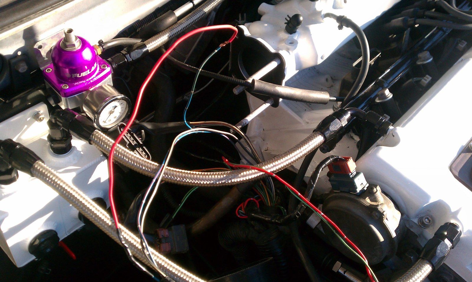

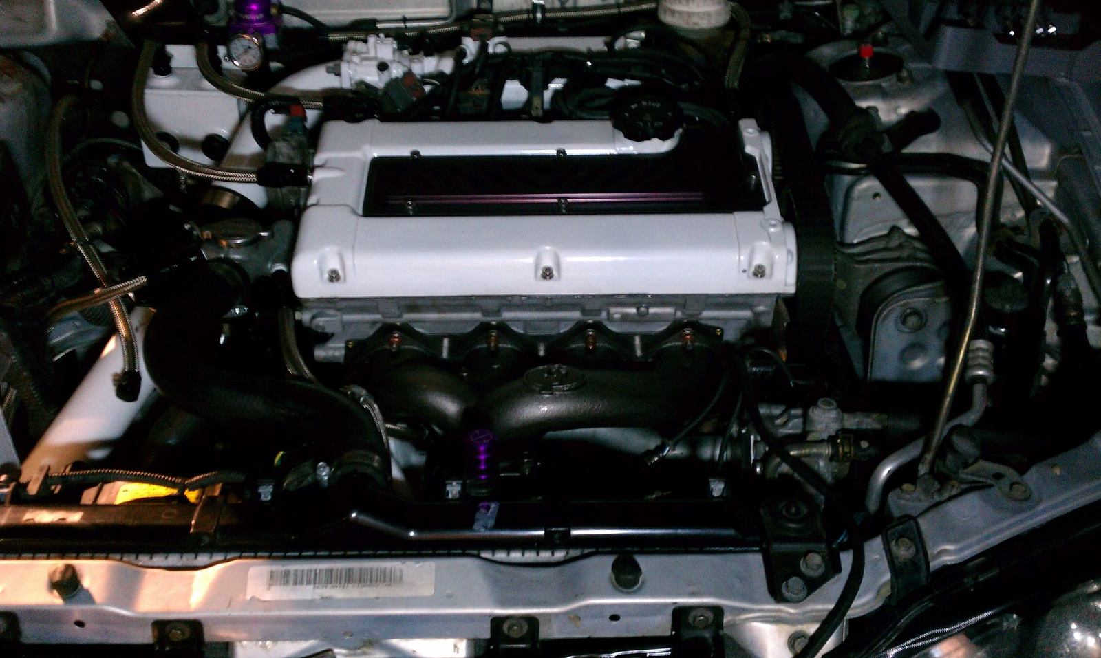

Oh looky there. I got a great deal on a fp manifold. New studs and nuts. New turbo bolts and washers too.

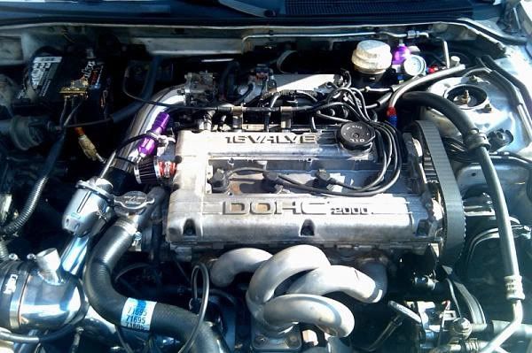

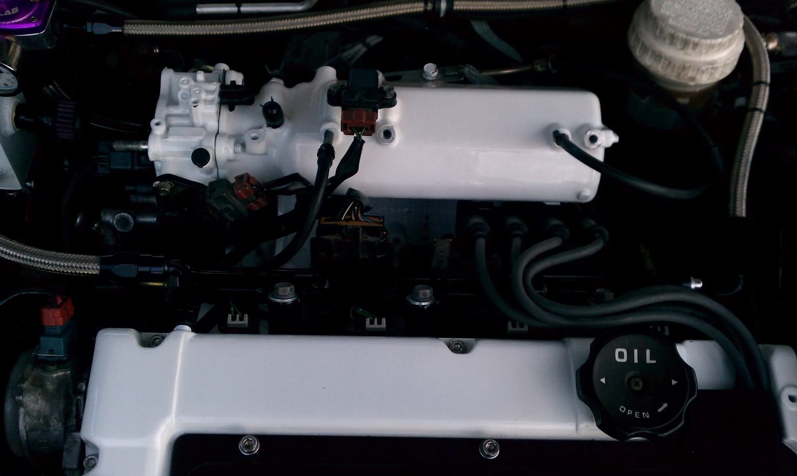

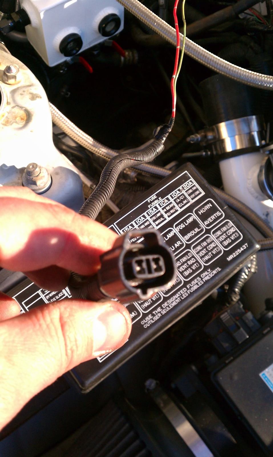

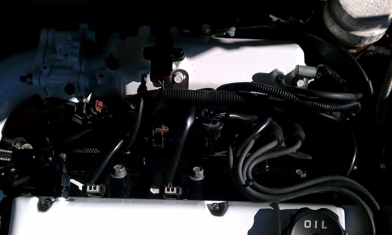

There's always been a whole bunch of loom hanging out on top of my intake manifold. It finally drove me crazy enough to something about it.
Before
During

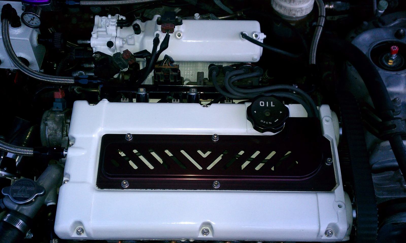

I removed this plug and wires all together.
After
