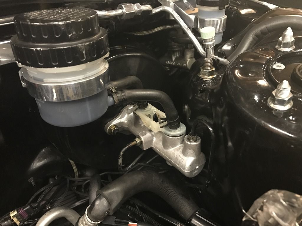

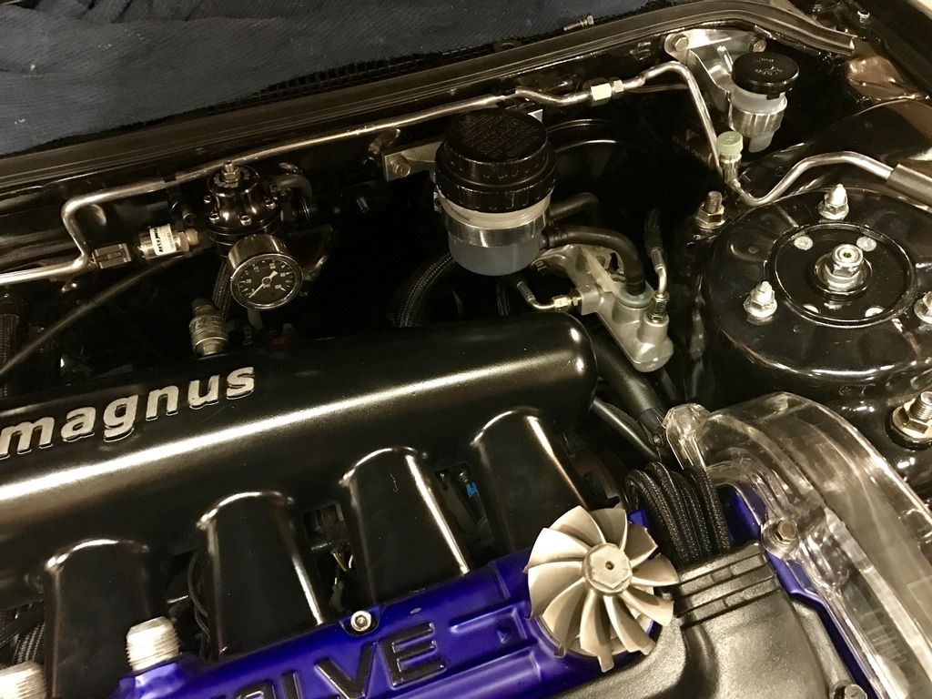

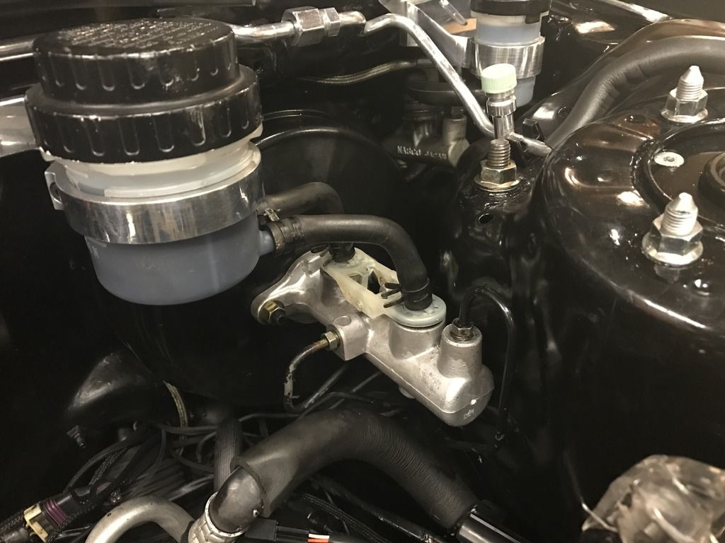

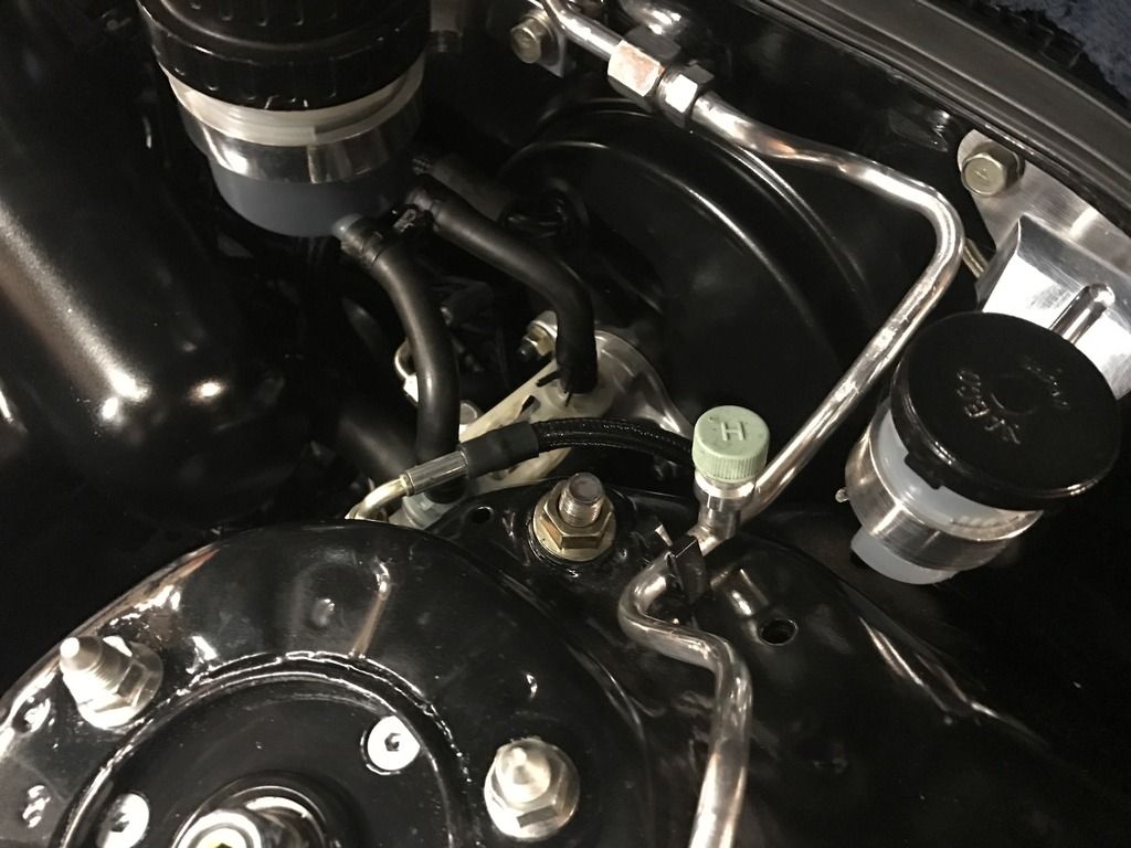

So I installed my 3g brake booster and MBC so my brembo brakes will work as intended. I also used my 2G res and not the 3G res that comes mounted too the 3G MBC. The two inlet ports have the same diameter as the 2G MBC so I was able the swap everything from my 2G res over without an issue. I also used my original brake lines, I just couched them into place, wasn't too bad. Also as ceedawg points out in the next couple posts, the flares are different from the 2G (double flare) to the 3G (DIN/ISO bubble). I should of pointed that out in my above post as I was more interested in seeing if I could get the lines manipulated into place without kinking them, knowing I would have to re-flare them to work properly.

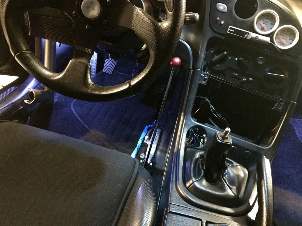

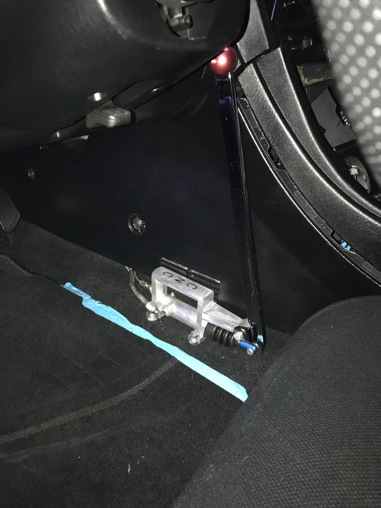

Been wanting one of these for some time now, finally found one lightly used and with the line kit. This will make launching the car so much better IMO.
Above picture was before I installed the staging brake, I'll update it with the staging brake line kit installed later. Also that's blue making tape on my floor mat.
Nice job. Love your work. Those stock flare fittings though are the wrong fittings for the 3G MC. They will screw in but they will not seat right. You need to use the fittings from a 3G to seat properly. Just fyi.
Very true, I bought the flare kit and fittings and redone my stock lines. Cost less then new lines, look stock and simpler to do without removing the intake mani. and stuff.
Thanks ceedawg!
Very good point about that and at that point I hadn't bleed the lines yet as I was waiting for the staging brake to come. I did come across that, the different flare, in my research and had to source the right fittings for the master to work with the STM line kit to install the staging brake. Surprisingly it didn't leak the week I waited the brake and fittings as I already bench bleed the master before installing it.
Here's how it looks with the right fittings and lines installed.

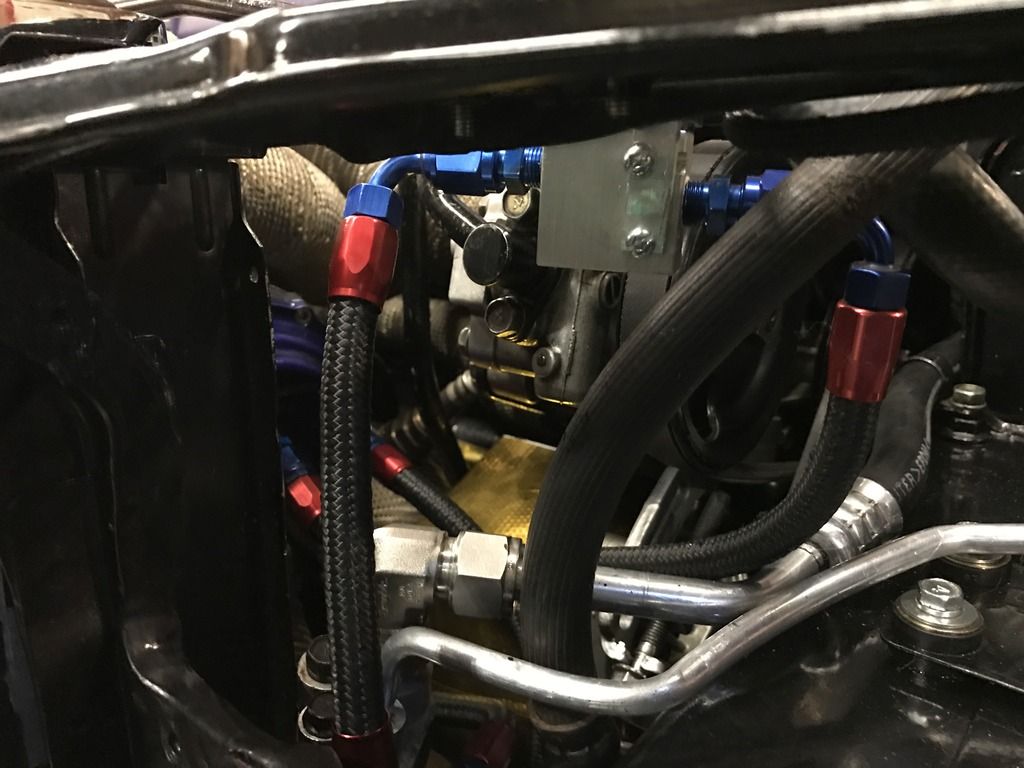

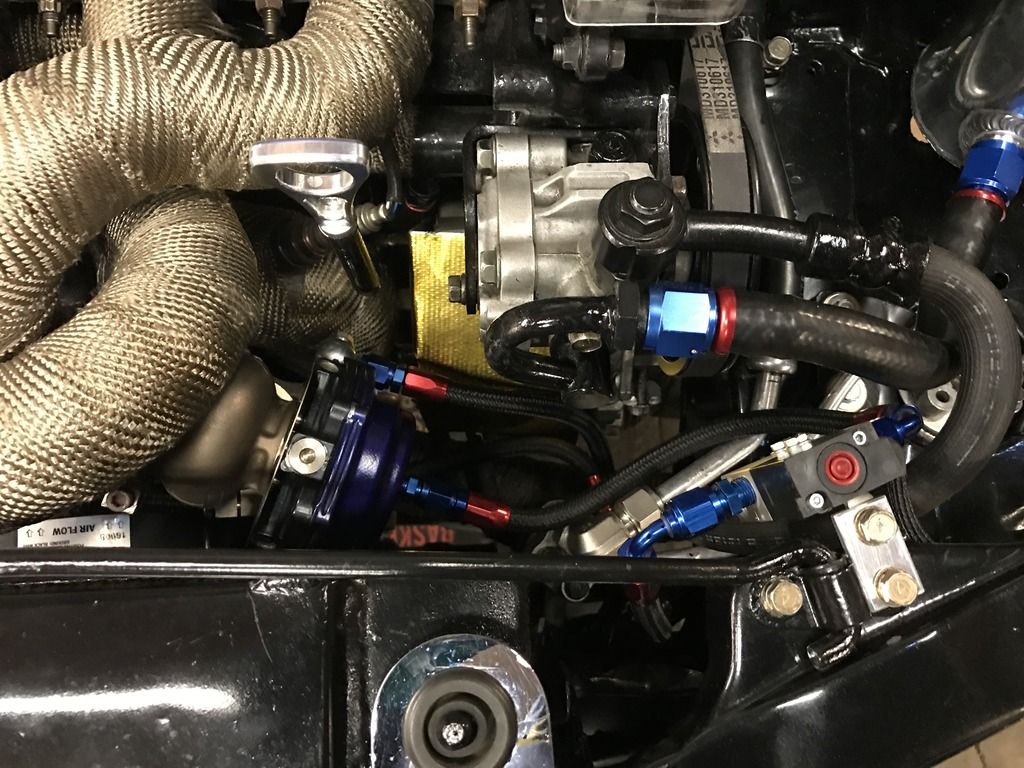

So I'm finally switching my boost controller from a manual to electronic, link controlled boost. So I mounted the Ingersoll valve to a small bracket I fabbed up and a piece of aluminum, to my rad support. It worked out pretty good, as this is where I needed it, nice and close to my WG. I'm picking up the fittings and line to finish installing it this weekend. Here's what I got so far.
Here's the finished product, this is looking in with the Dr side headlight missing.

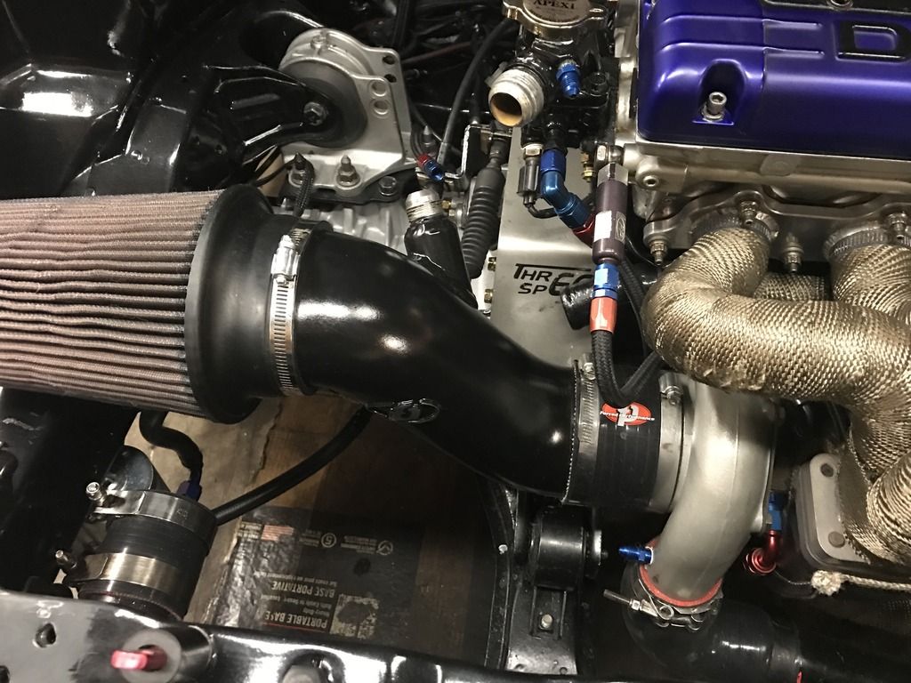

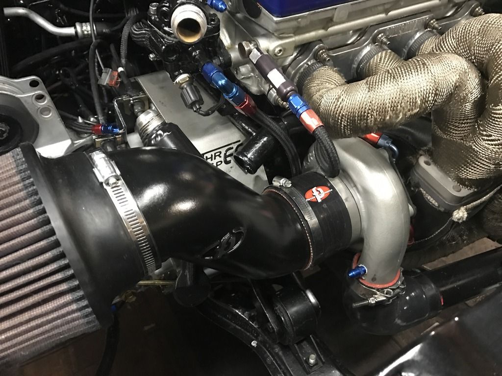

I'm switching my CC set over to a Calan can with two -10 in and one -12 out, all black fittings and black wrinkle on the can. Here's the Fp intake I actually bought by accident couple years ago, didn't notice the fitting welded on :ohdamn: from the way it was laying in the picture, and bought it. At the time I wasn't too pissed as I knew I was eventually going to run one of Calan's CC and this would be used then. Who ever did the fab work did a nice job. I should receive the CC in 2-3 weeks, I can still run my vented Front line fab CC if I get the car out before. It's starting to warm up and get nice up here and my cars is for once not broke, it usually is this time of year or in a million pieces from me changing something.

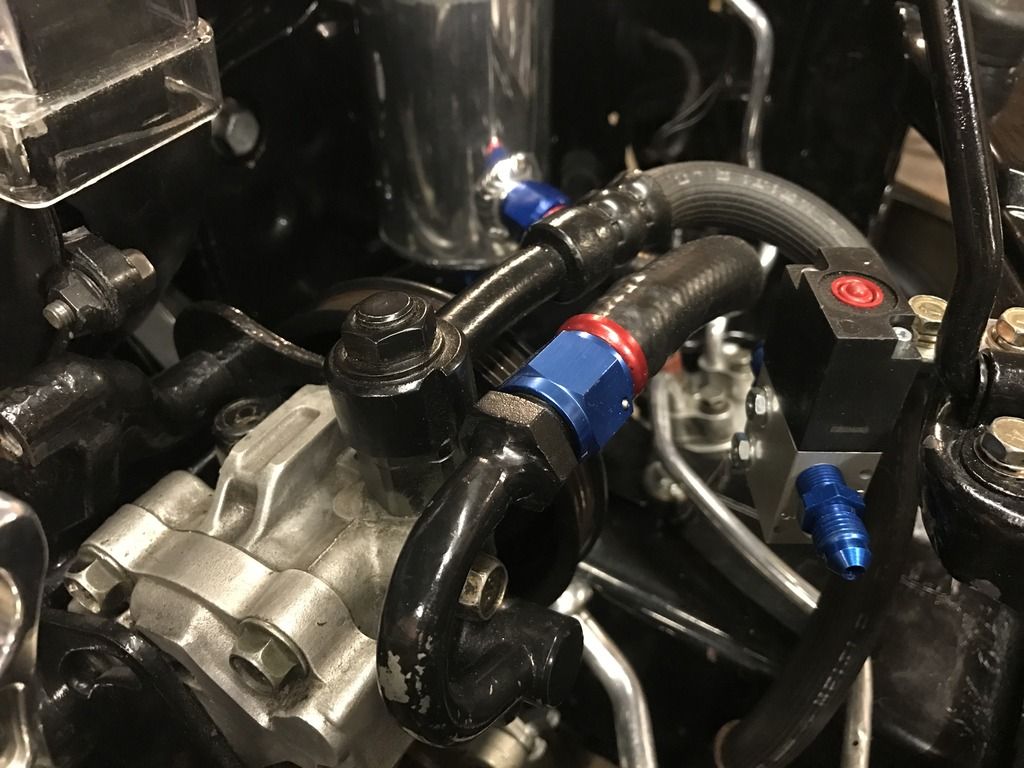

Used some loom and 3:1 heat shrink to get the line kit to blend in behind my intake. I hate the look of a bunch of stainless lines run every which way, with the loom they hide pretty good, you can't see them at all.
I'm switching my CC set over to a Calan can with two -10 in and one -12 out, all black fittings and black wrinkle on the can. Here's the Fp intake I actually bought by accident couple years ago, didn't notice the fitting welded on :ohdamn: from the way it was laying in the picture, and bought it. At the time I wasn't too pissed as I knew I was eventually going to run one of Calan's CC and this would be used then. Who ever did the fab work did a nice job. I should receive the CC in 2-3 weeks, I can still run my vented ******** fab CC if I get the car out before. It's starting to warm up and get nice up here and my cars is for once not broke, it usually is this time of year or in a million pieces from me changing something.

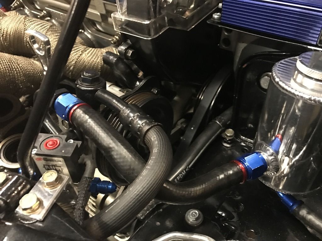

So my trans cooler/lubricator has an inline filter on the suction side before it enters the cooler, pump ect.
If the filter is to clog or start to clog it's going to limit fluid output obviously, so I've been trying to come up with something that I could check easily with just popping the hood. I sourced this piece of acrylic online and drilled and tapped it for a couple of 1/2" barb fittings but found it hard to see without a flash light. So I went on ebay and bought this small red led light that runs off the pumps power and lets me see the oil flow pretty easy.
It may be a bit ricey looking but serves a damn important role,
