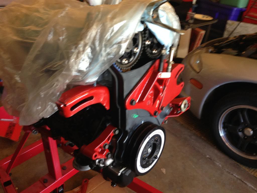

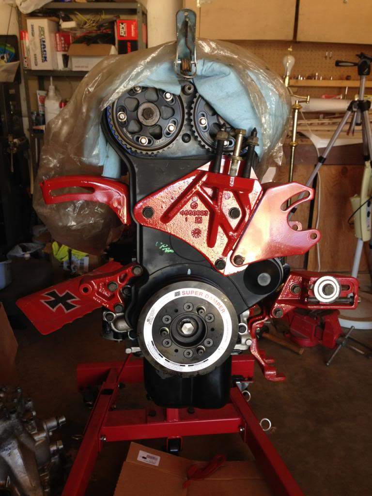

started painting some engine brackets today. going to get the valve cover powder coated in a few weeks finally. still waiting on transmission to arrive.

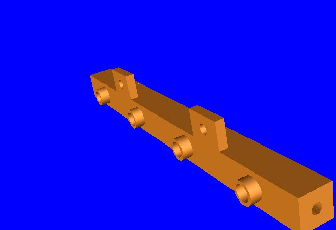

making a MAP adapter block to be able to add a hose barb since the intake i am using doesn't have a spot for the map sensor. also designing a custom fuel rail.

here's a look at the fuel rail i am developing for the engine that i may have made.
i know i bought the AEM fuel rail, but the injector holes are too close together and may not work.
back side:

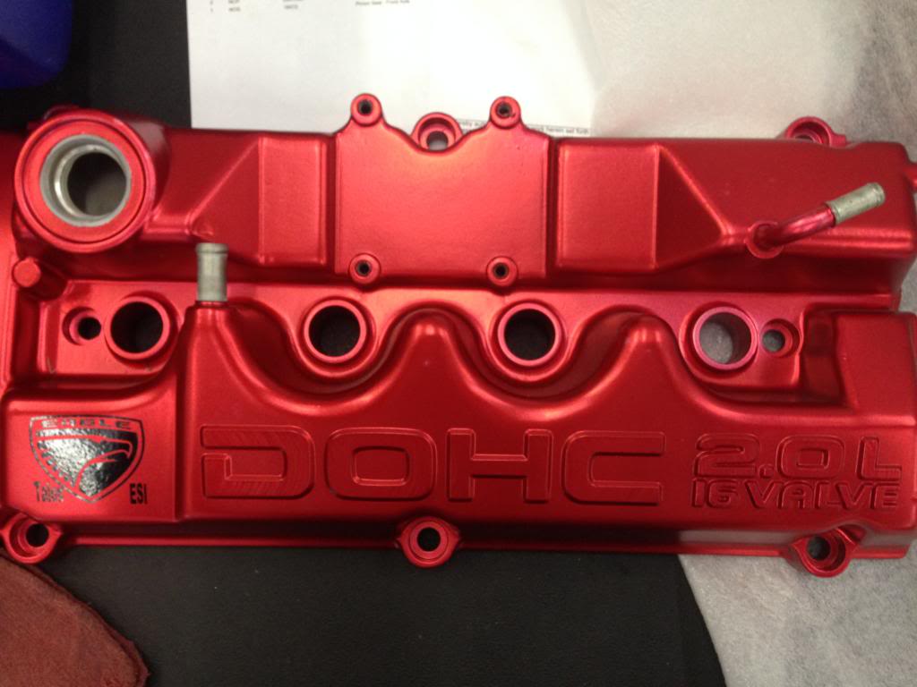

small update on the valve cover i am having powder coated. the valve cover has been fully media blasted to strip all the old paint off of it and it's ready for powder coating now.

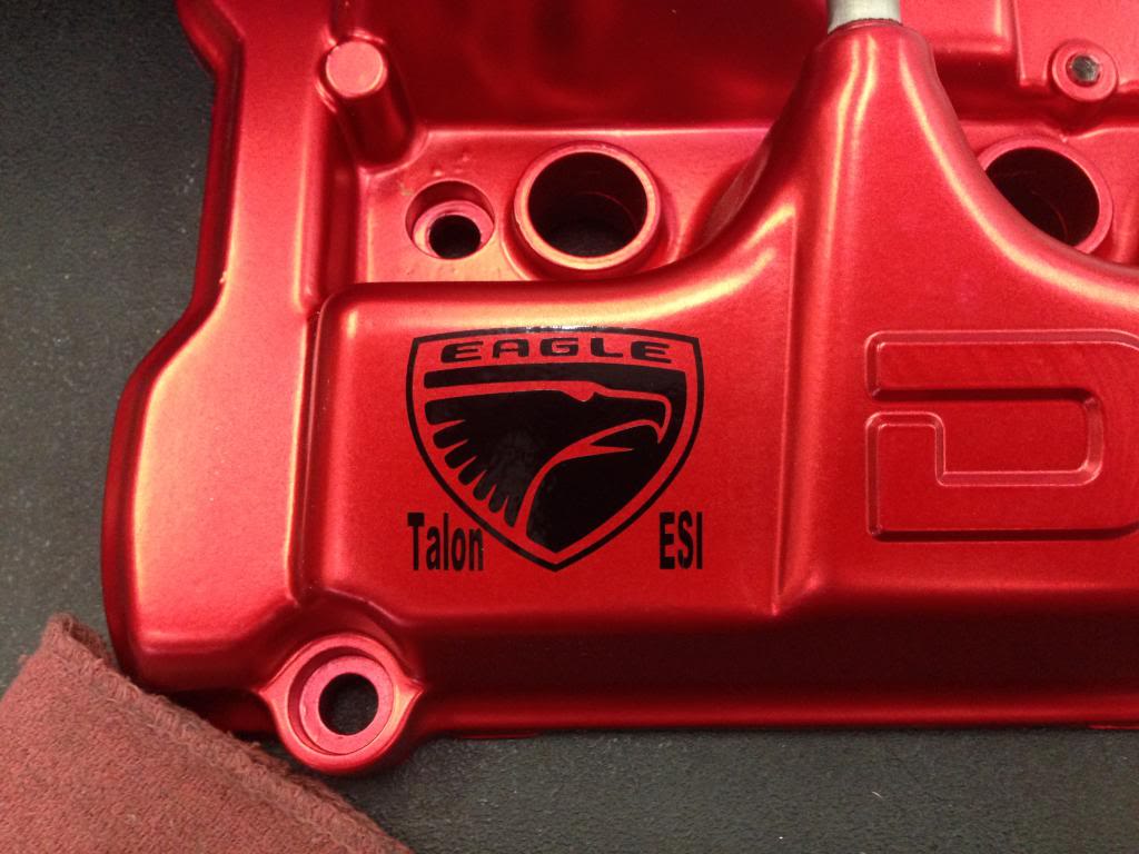

heres the finished valve cover. is a metalic red powder coating. tried to duplicate the same color as an anodize red.
here's on of the custome decals i had made for this engine:
