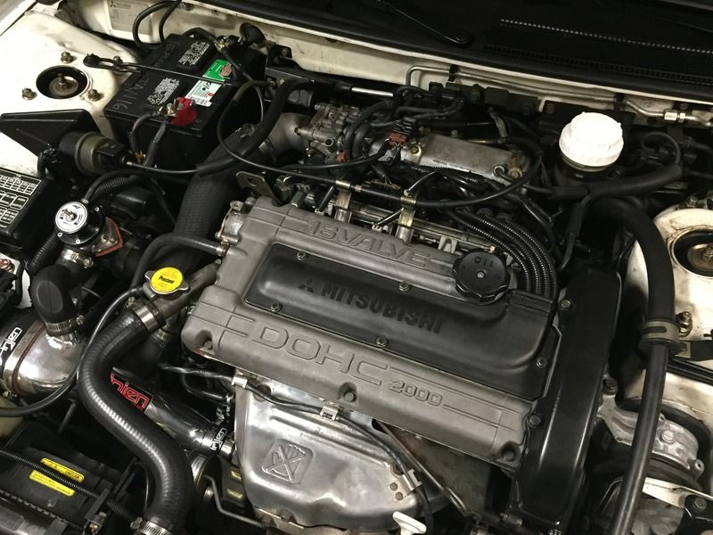

Was supposed to be a simple engine swap and some minor rust repair for a daily driver. Turned into a 5+ year restoration.

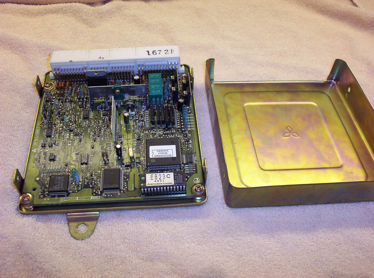

Picked up a recently refreshed/socketed 95 ECU, and ECMLink is in the mail.

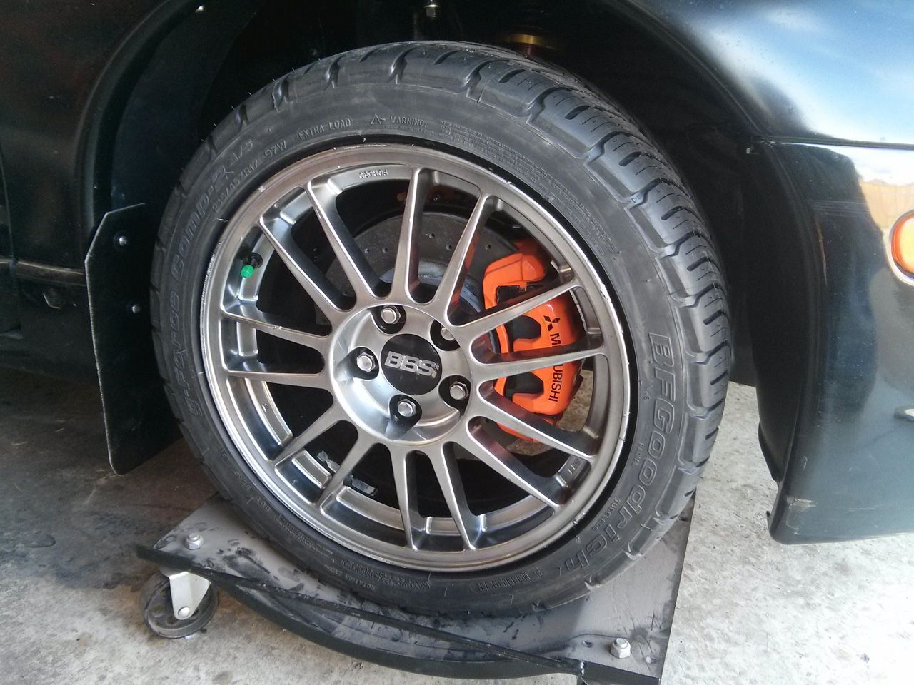

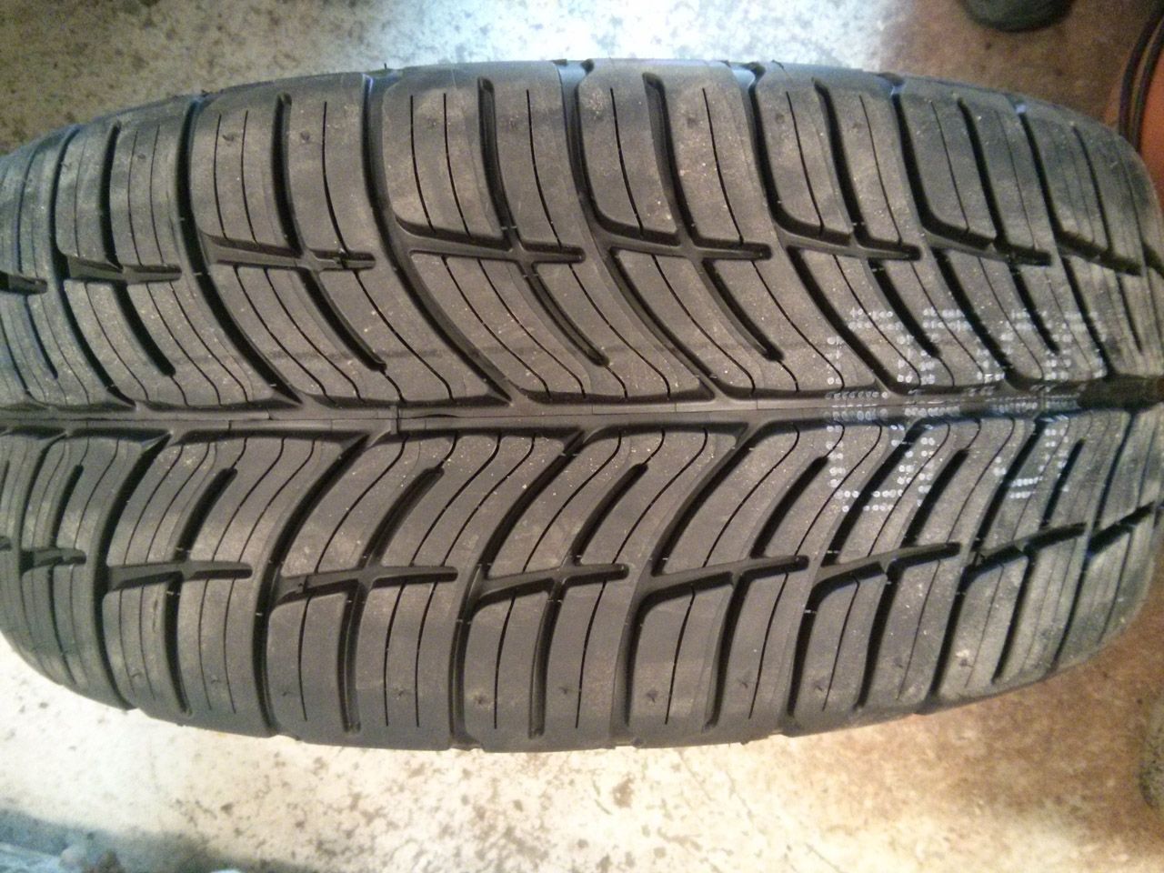

Tires for the EVO IX wheels will be BFGoodrich - g-Force COMP-2 A/S. 235/45R17. They seem cheap for a performance tire, user ratings seem excellent, and they are all seasons. We've had snow in late May, and early September the last couple years, so I'm not going to go with a dedicated summer tire.

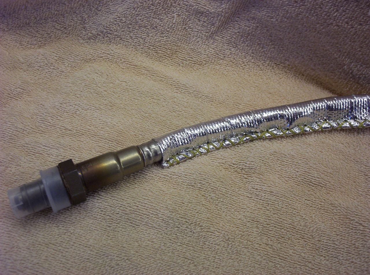

Finally put my sewing portion of home-ec to some good use. Made a heat sleeve out some aluminized fiberglass heat barrier with kevlar thread. The wideband wires run over the shield like oem.
I can install/remove the wideband sensor in the front O2 sensor position after I remove the top heat shield. Very easy for calibrating the wideband.

Installed the 95 ECU with Ecmlink.

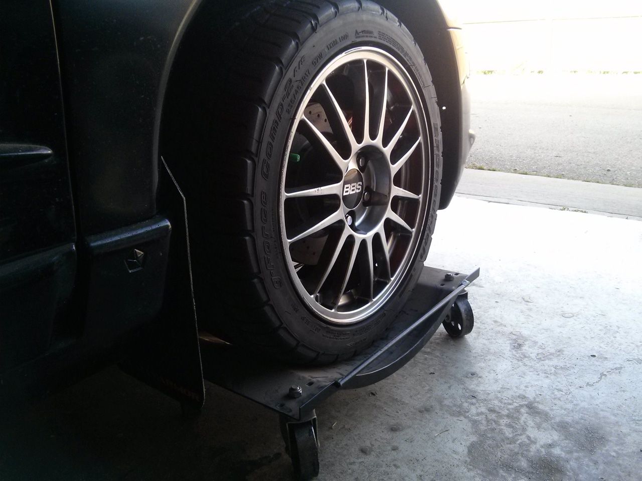

Tires have been installed. I threw them on the car for some pics. The car still needs an alignment, so my oem 17's with old tires will go back on before the car starts moving under it's own power.
Tire stick out is perfect with the EVO IX BBS wheels.
Looking good man! I recently installed some G-Force all seasons on mine. I really like them. Excellent performance tire for daily duties :rocks:
All Seasons were a good choice. It was snowing for a couple minutes today.

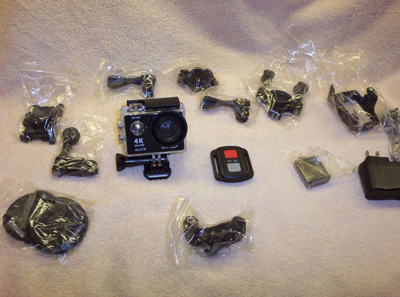

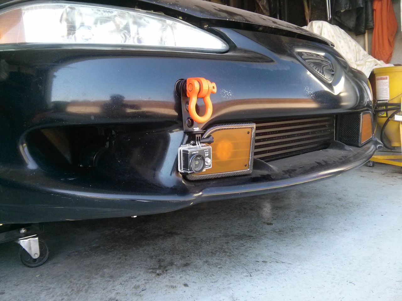

Ordered a 4K knockoff GoPro camera for road trips. It will be mounted on the front tow hook.
Akaso EK7000. Pretty awesome how much crap comes with it for the price. The online reviews all look good. Sound is not great, but I don't know how much you would actually hear with wind noise as the car is screaming around mountain roads.
Painted aluminum angle on edge of carbon rock shield with rocker guard.

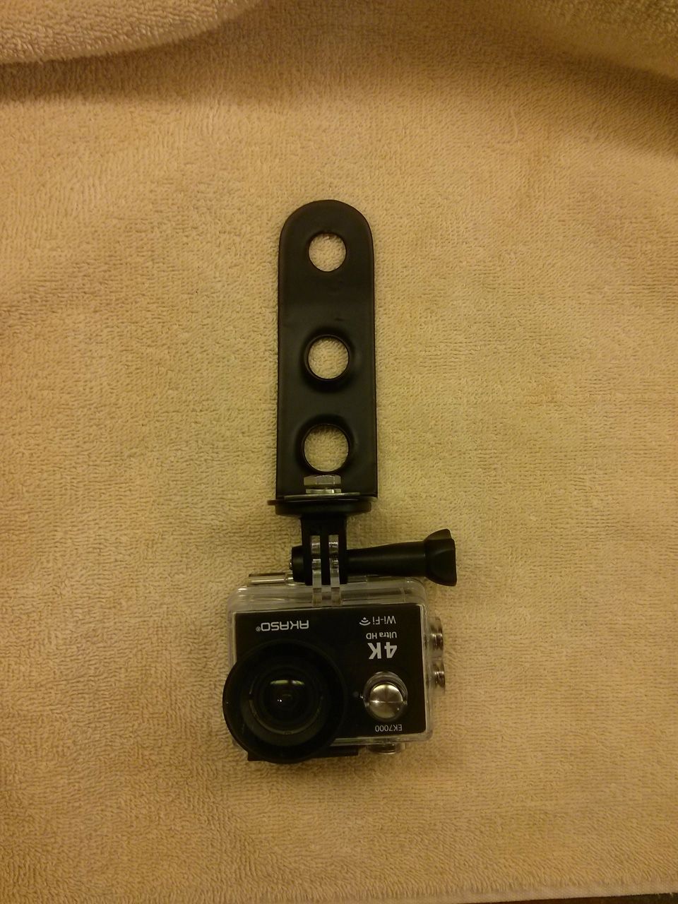

Make a bracket to attach the action camera to the front tow hook.

Opened up the ECU which was recently gone over by ECMLink: Everything looks fine (caps were all replaced, and none are leaking) Check engine light goes on, then off while cranking so it's working.
