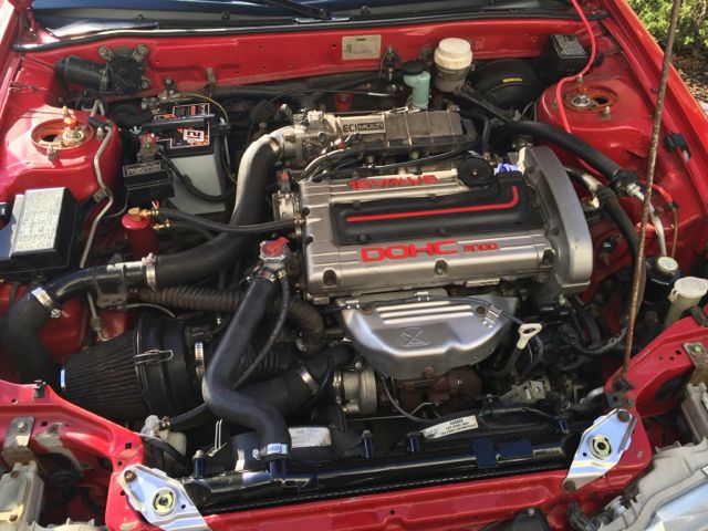

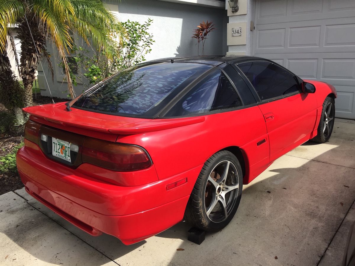

Hey guys. Felt like throwing a little info up about my distraction.
I've taken a short break from my 1992 Eclipse race car build to put together a street car I can enjoy in the meantime. It's ended up taking more time and money than I originally intended, be we all knew that would happen right?
The basics are...
1993 Eagle Talon TSi AWD - 5 Speed
8.5:1 Ross/Manley short block with ARP hardware
Fresh, stock head
BC Stage 2 cams
Fidanza Cam Gears
All New Timing Components
Competition Clutch Stage 3 with segmented ceramic disc
Competition Clutch Chromoly Flywheel
68HTA
2g Mani/O2
3" Exhaust
1100cc FIC Hi-Z Injectors
Wally 450
Buschur/SX FPR
K-Sport Coilovers
Ingall's Adjustable Rear Upper Control Arms
ECMLink
Here are some videos about the progress from picking up the shell in Alabama to firing it up for the first time a couple of weeks ago.
1993 Eagle Talon TSi AWD Playlist
Since these videos were posted, I finished the brakes with new pads, rotors, stainless lines and some powder coating. My new aluminum intercooler piping has arrived and will be powder coated and installed with my upgraded Dejon Tool Sidemount Intercooler.
In the near future, I'll be picking up an AEM Failsafe Wideband/Boost gauge and soon after I will upgrade my V1 to V3 with Speed Density and Flex Fuel.
Let me know what you guys think!
