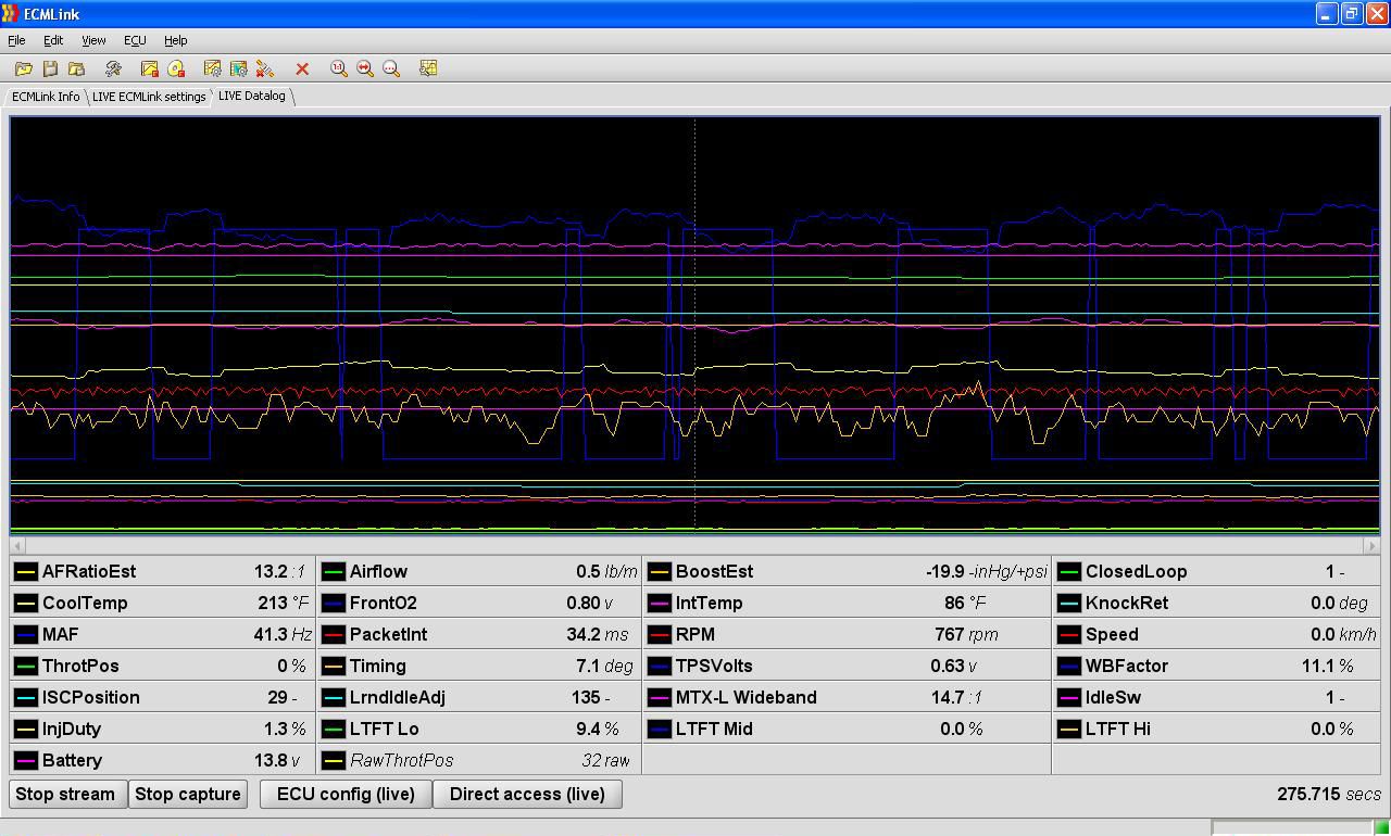

Set base idle timing to 5degrees.
Ran the car several times while making adjustments, and kept checking that the timing was still good. Still not 100% sure what happened to my timing last year, but with new OEM tensioner and arm it hasn't moved. I reused the belt, and when I made my timng belt adjustment, I put it on a little bit tight.

Adjusted the TPS like a hundred times. It was fluctuating between 0.63-0.65 when warm. It's now 0.63v when fully warmed up. Loosened my throttle cable. It was reading zero when cold, but once the car is fully warmed up it went to 1%, which was pushing the TPS even higher.

I've been making idle adjustments on the Ultra94 I put in last year. I have no idea what octane it is anymore, so it will be drained and replaced with new fuel.
I have to take a look at LTFT LO. I seem to remember it was reading O for most of my idling time, and when everything was adjusted I started getting like ~9%
Idle tuning complete. (I think)

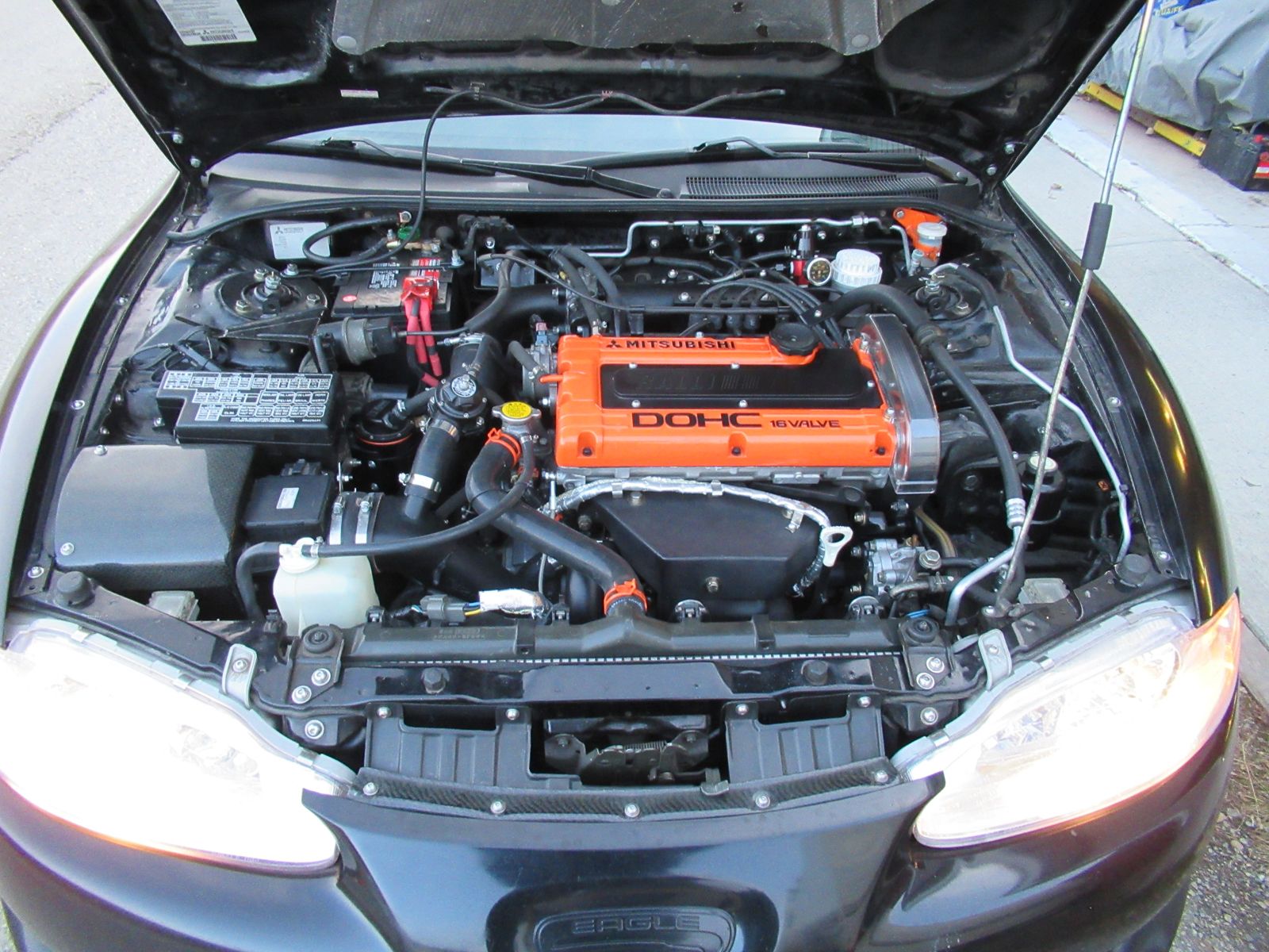

Put the hood on the car, which increased underhood temps.
Took it for a cruise. I've never seen a car overheat so fast. :p We called it a day when we got a CEL for coolant temp in under 6km.

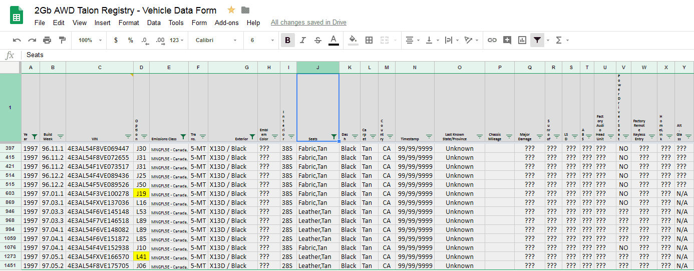

Excellent project! Is this car in my/the 2Gb AWD Talon Registry? I don't think it is.
https://docs.google.com/spreadsheets/d/1NVuEwEdVECIYprrfesZGBuvQnhOsfPFT-TIBSvHH754
You can fill out this form here to provide information about any 2Gb AWD you know of!

If that car came with tan seats, it was very rare - only six 97 AWDs built for Canada were black 5-speeds with tan leather. Another eight of them had tan fabric seats.
Every VIN is in the Mitsubishi CAPS database from which I extracted the information in that screenshot, but additional information about where each car is, when it was last "pinged", how many miles on it, what kind of condition it is in, whether it had ABS, LSD, sunroof, keyless entry, etc is the purpose of the Registry and the web-form. For some reason there was no information in Mitsubishi CAPS about whether a particular VIN had ABS, LSD and other things, so I am hoping to piece it all together myself with the help of the community!

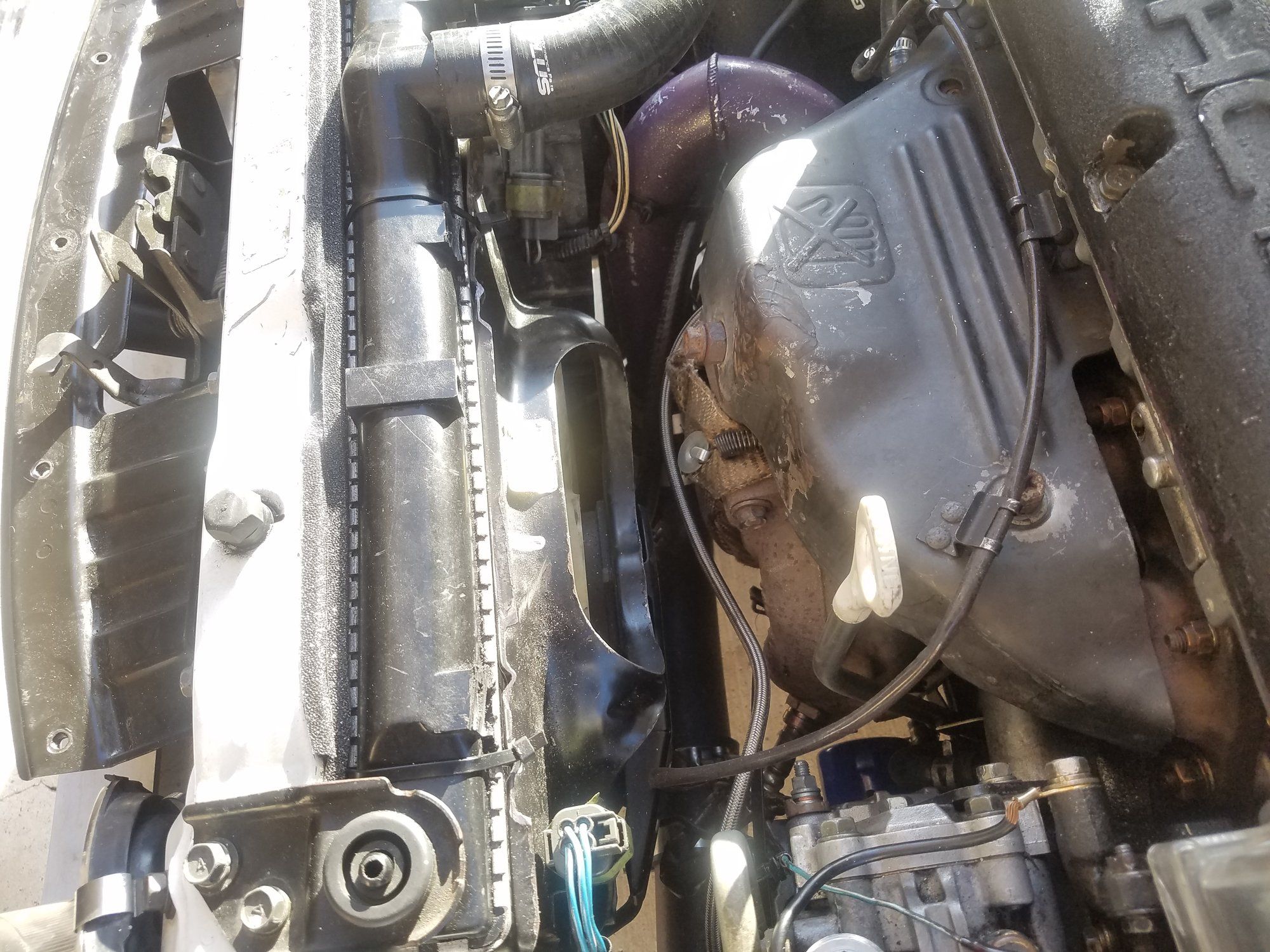

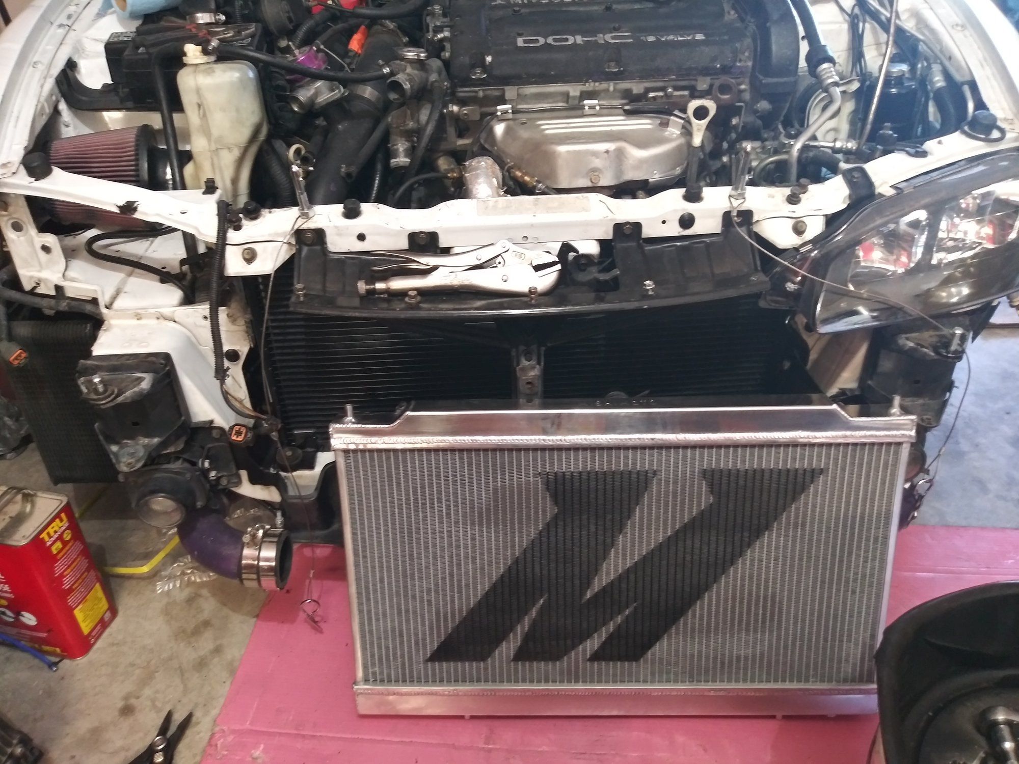

Mishimoto radiator swapped out for OEM? plastic tank thing and stock fans. Used closed cell foam to fill the gaps between the ac condensor and the radiator. There was ~1" of gap on the sides, and ~1/2" at the top.
Just so you know how much more capacity the aluminum rad has... the plastic rad holds 1/2 the fluid. We'll see if I can find some slim fans that work for the Mishimoto later. I want this thing on the road.

By far the cheapest thing in the engine bay. That plastic tank rad. :)

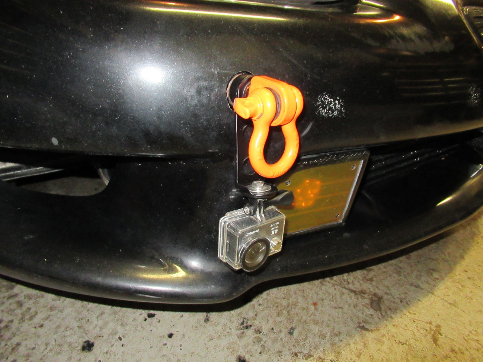

I will be testing out the front camera mount (below tow hook) and post the video.

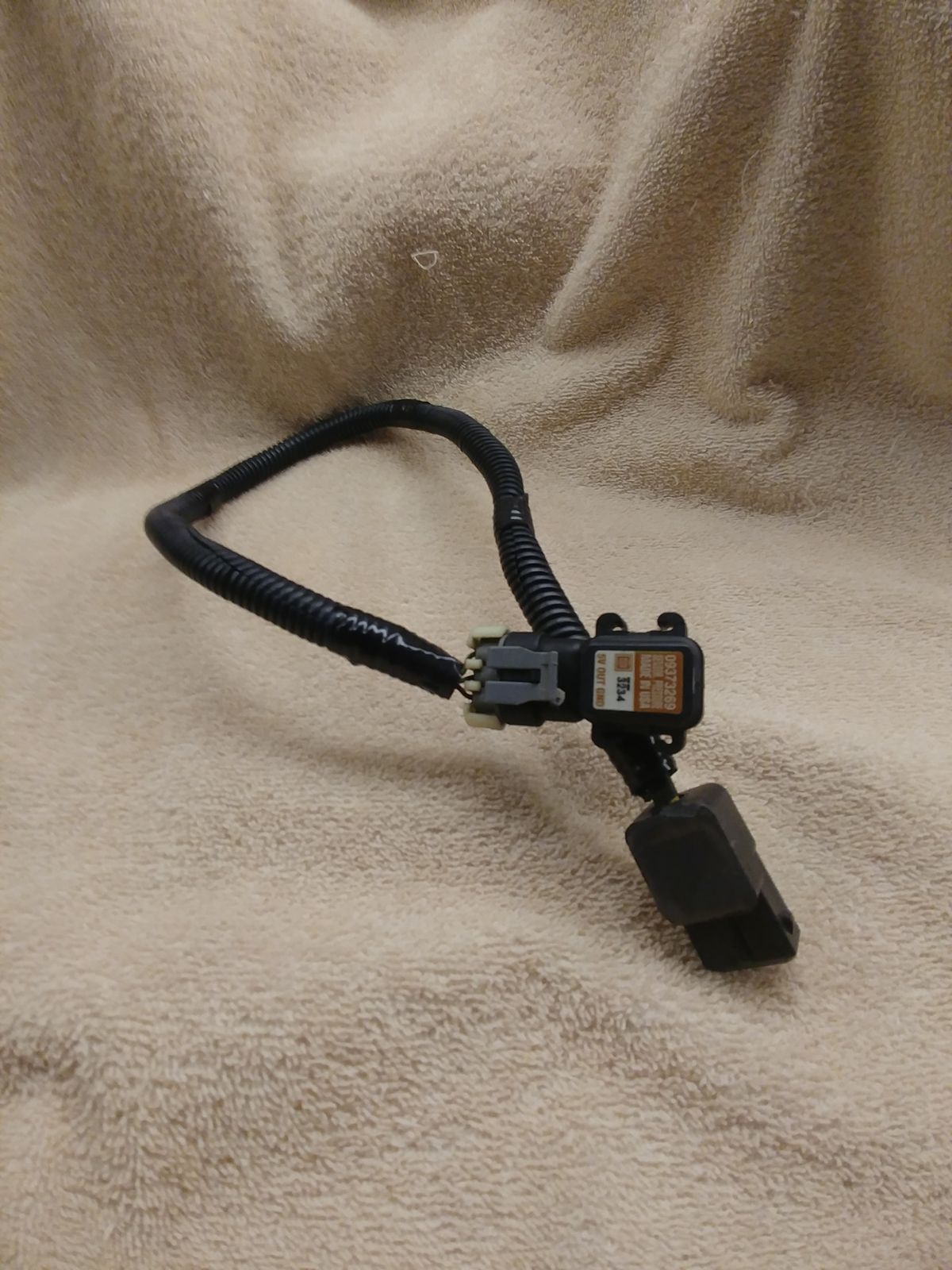

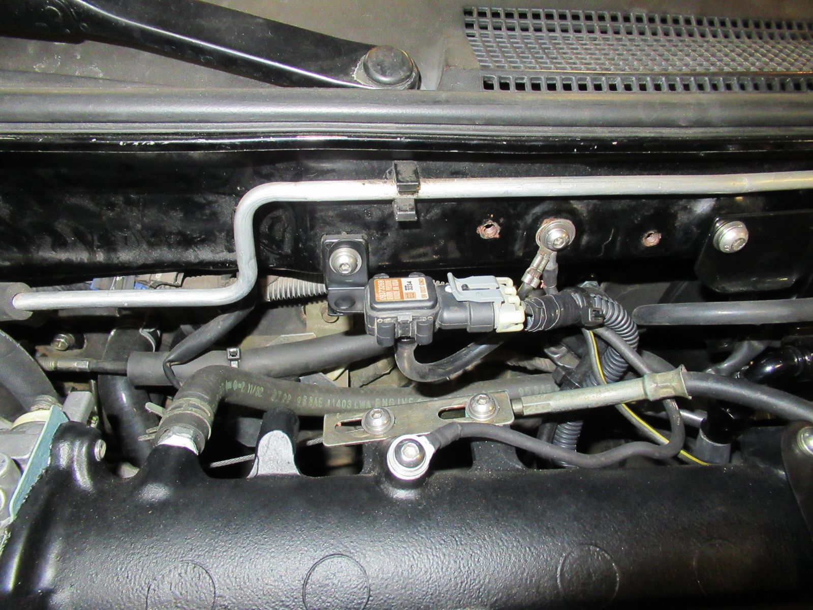

Picked up a free GM 3.3Bar Map sensor (09373269) out of a GMC Sierra 2500HD turbo diesel at the salvage yard. Unfortunately the wiring pigtail was cut off the harness, so I'll have to go back and find a pigtail from a different car. The plan is to hack up my unused MDP sensor, so it will plug right into the factory harness for logging boost through ecmlink.
Picked up a wiring pigtail and a spare MDP sensor from the scrap yard. Opened up the MDP sensor and removed all the internals. Soldered some wires into the inside, and permanently sealed them in JBWeld. Soldered and heatshrinked those onto the pigtails for the GM 3.3bar MAP sensor. Tucked my new adapter harness under the coil pack and temporarily mounted the MAP sensor on the firewall. I will make a proper bracket in the next couple days.
Enabled the MAP sensor in ecmlink and went for another 3rd gear run.

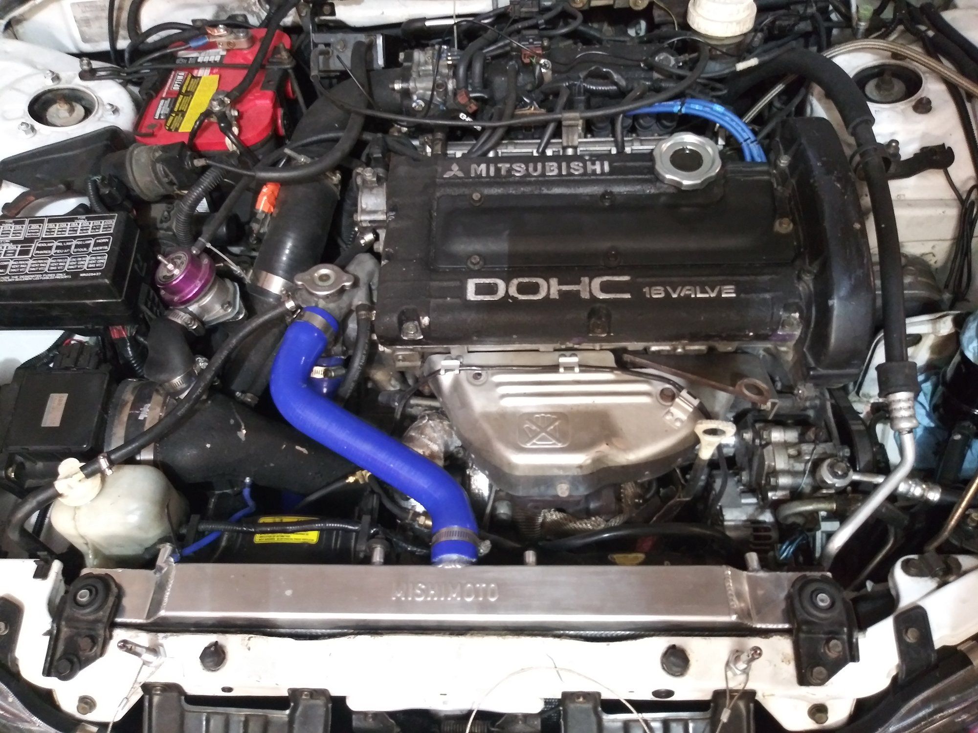

I think I have the same front mount setup, anyways for the mishimoto you need to cut off the mounting ears on the stock condensor fan and mount it using the pull through ties for radiators, or get creative with zip ties.
Mount the condenser fan first, then the radiator fan mounts slightly over lapping the condenser fan. Its a snug fit but they fit.
Personally I prefer the oem plastic tanks
I did the mod on the condensor fan, and was able to use bolts to secure it to the Mishimoto. The condensor fan fit fine, it was the main (passenger side) fan that wouldn't fit next to the J-pipe. Even trimming the housing down wasn't enough, I would have had to trim all the fan blades. I believe the Avenger fan I picked up from the salvage yard is approximately 1" thinner then our main fan. Everything is mounted on the stock radiator for now (including the Avenger fan) and I'll swap out the plastic tank radiator when summer returns.

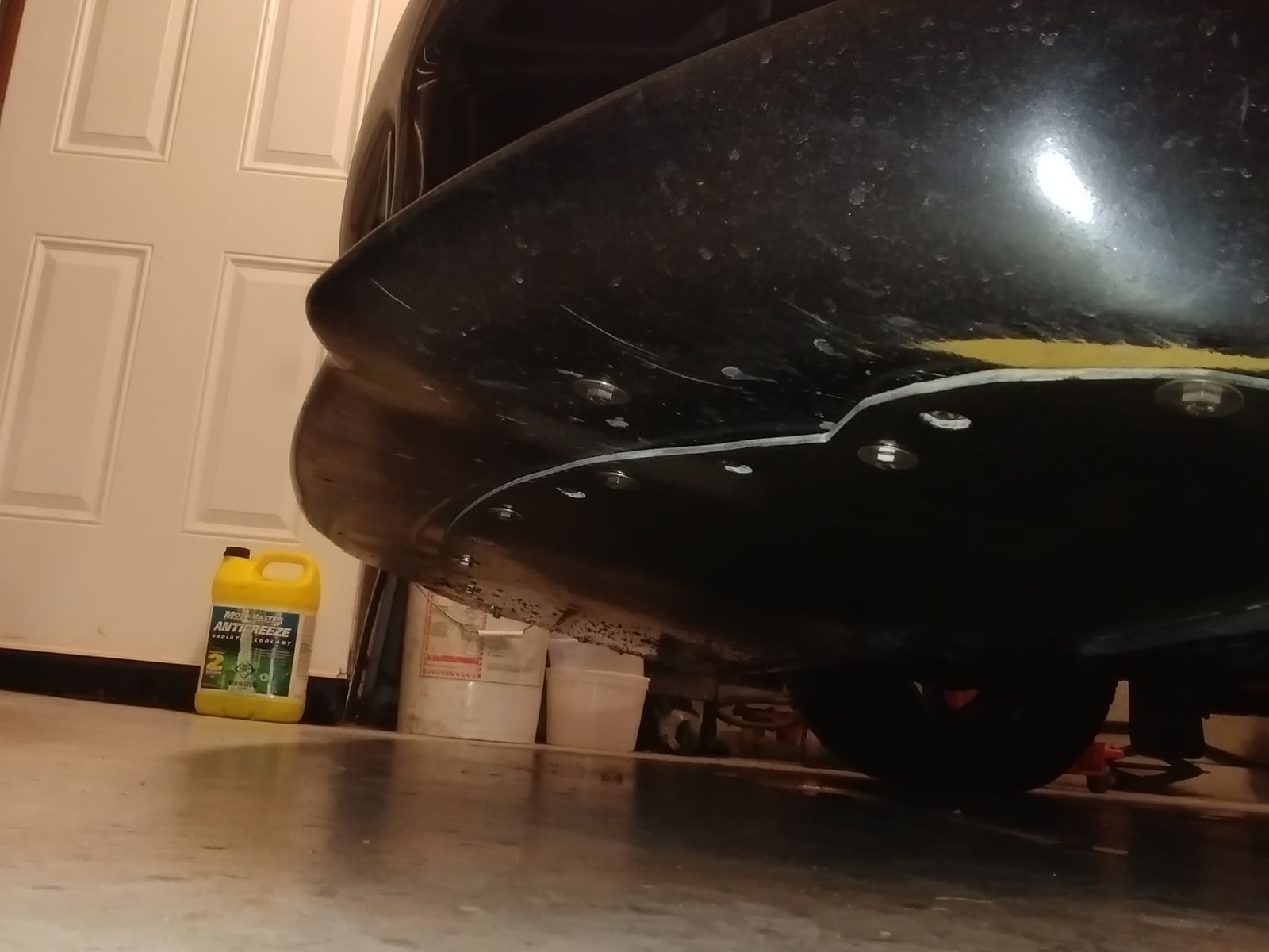

Semi-polished my carbon rock shield, installed it and went for a drive. I'll have to see if it rattles at high speed, but it seemed fine with a quick acceleration up to 80km/h.
It does an awesome job of transporting snow around. My garage should be full of water in the morning. :p

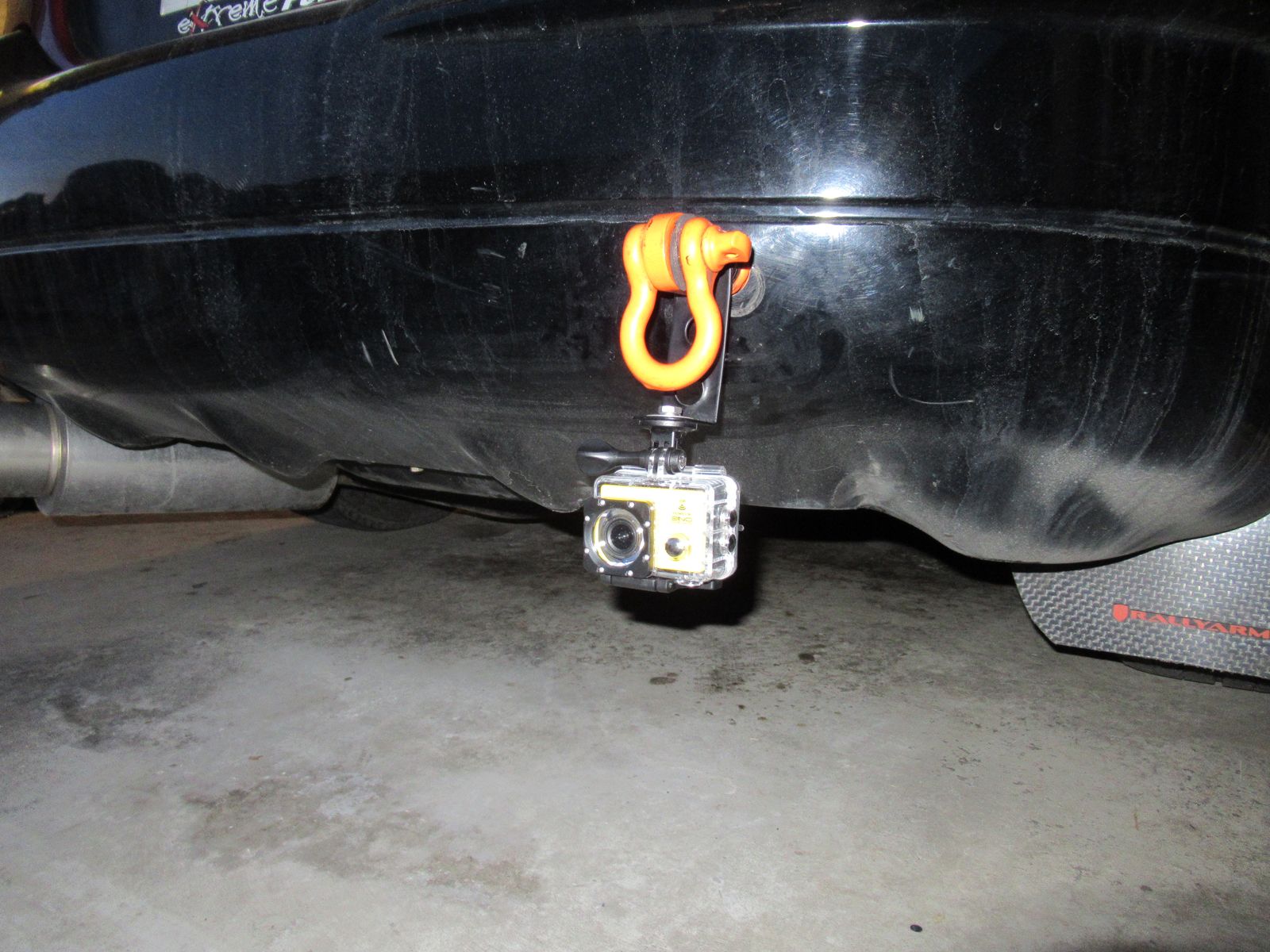

Akaso EK7000 action camera on front tow hook mount. The mark on left side is a crack on my old case. I did a test with my $38cdn Costco special last week, and the quality on the Akaso is way better. The costco camera will get moved with this mount to the rear tow hook. I'm going to make a stronger mount for the front.

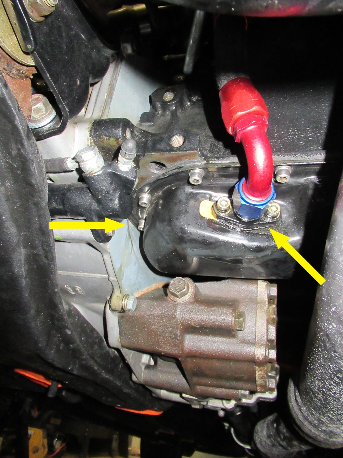

It looks like my motor oil leaks are from around the oil pan, and the AN-10 turbo return.
I hope it's not from the rear main seal (which was replaced) but I may need to drop my transfer case to see what's going on with the oil pan. All bolts that are accessible with the transfer case in the way have been tightened.

Made a proper map sensor mount out of the factory GM mount, and a some scrap steel.
Made a new, stronger front camera mount. It's identical to the old one, but has an extra bend of steel on the edge.
Moved the old front camera mount to the rear tow hook.
