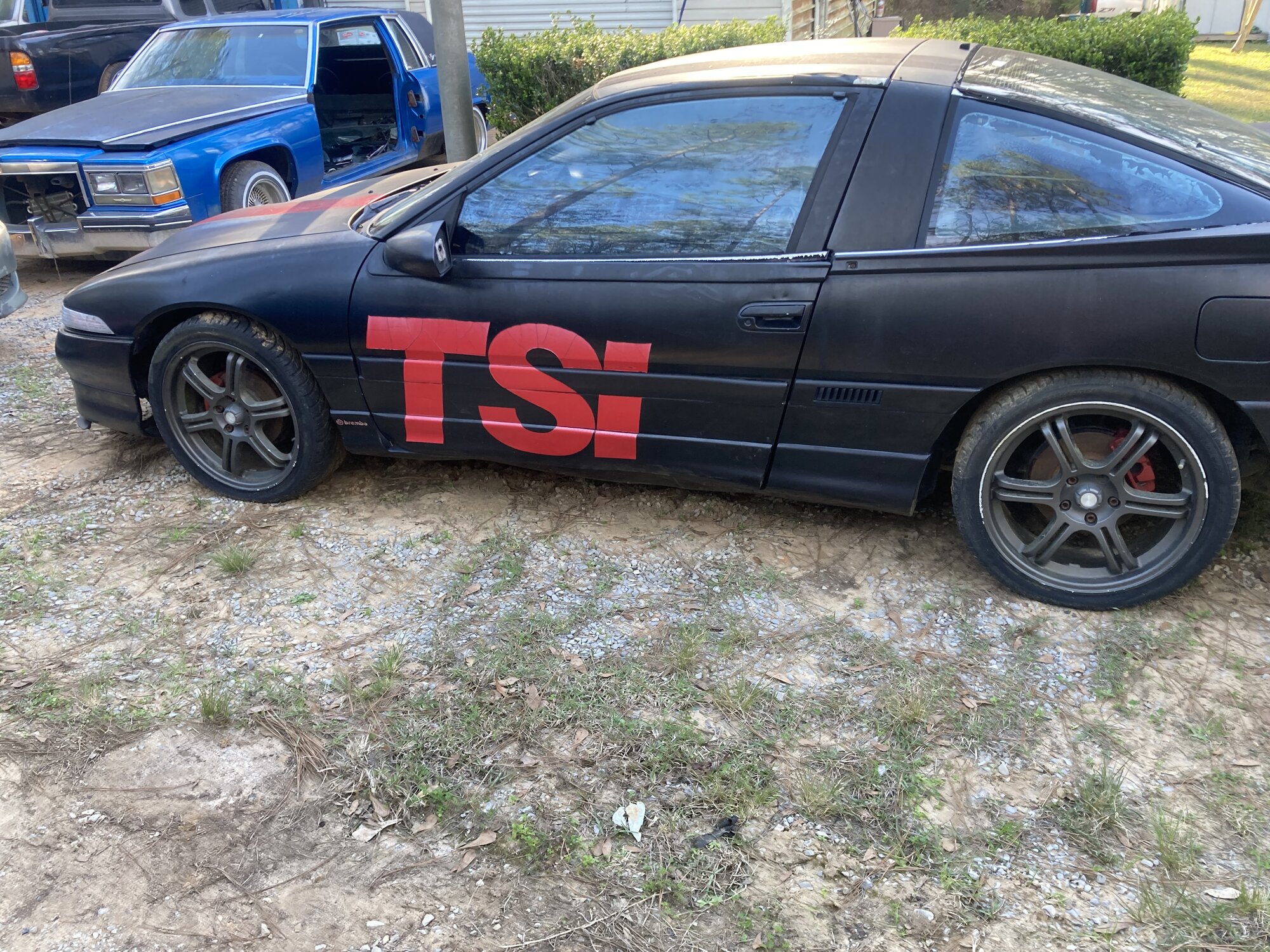

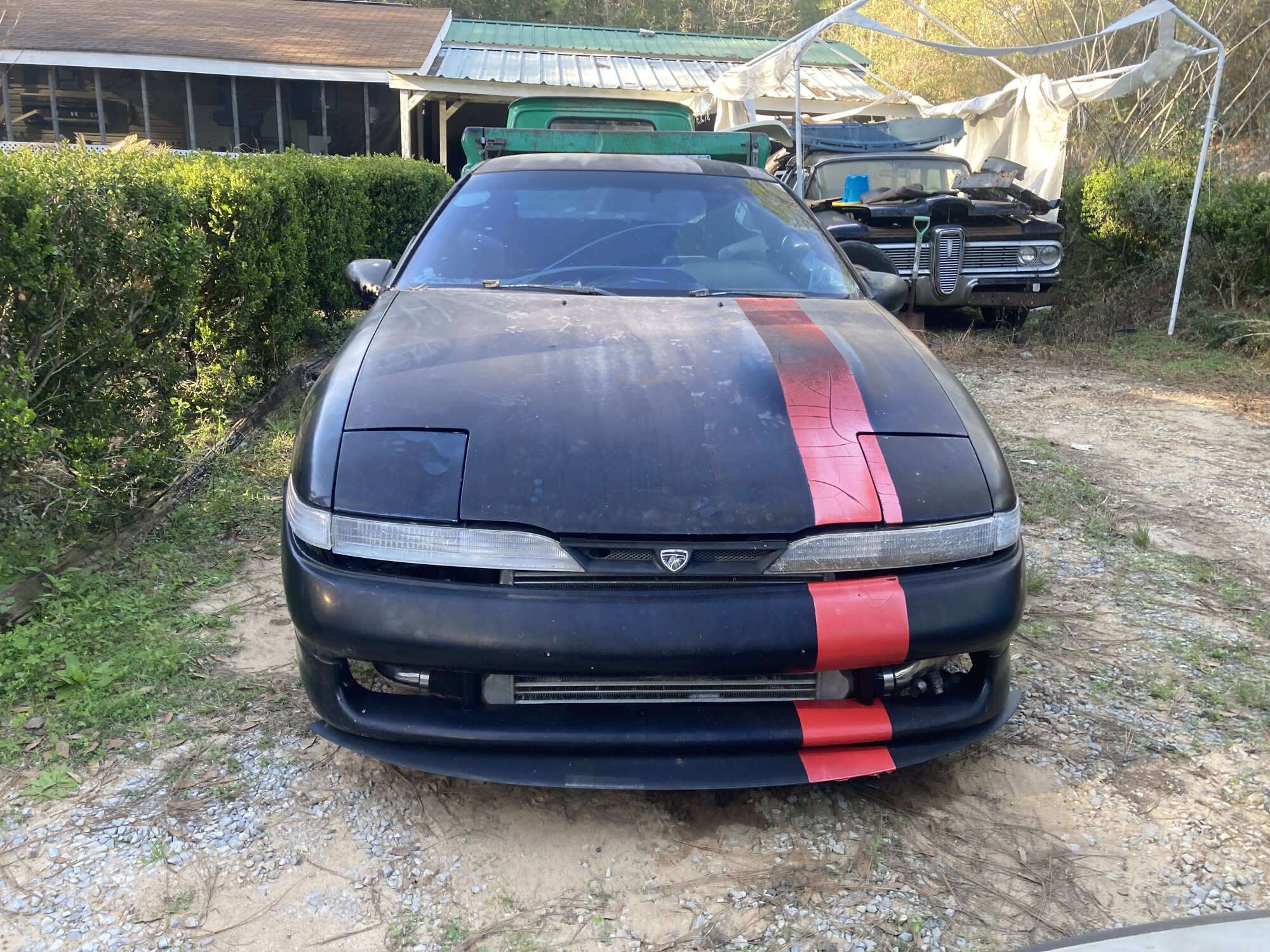

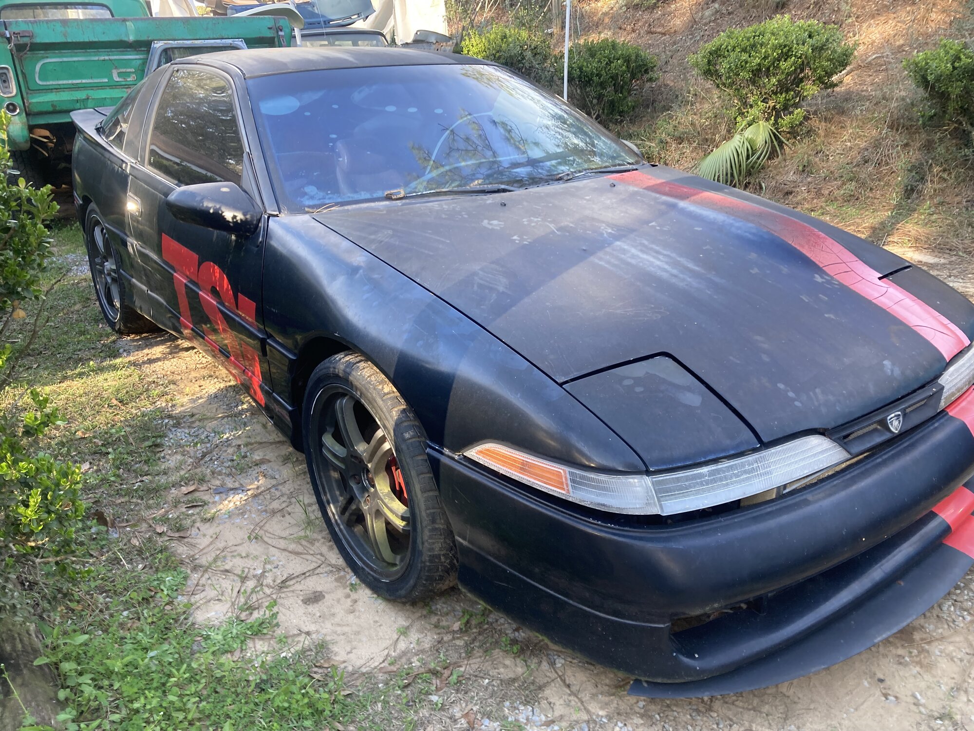

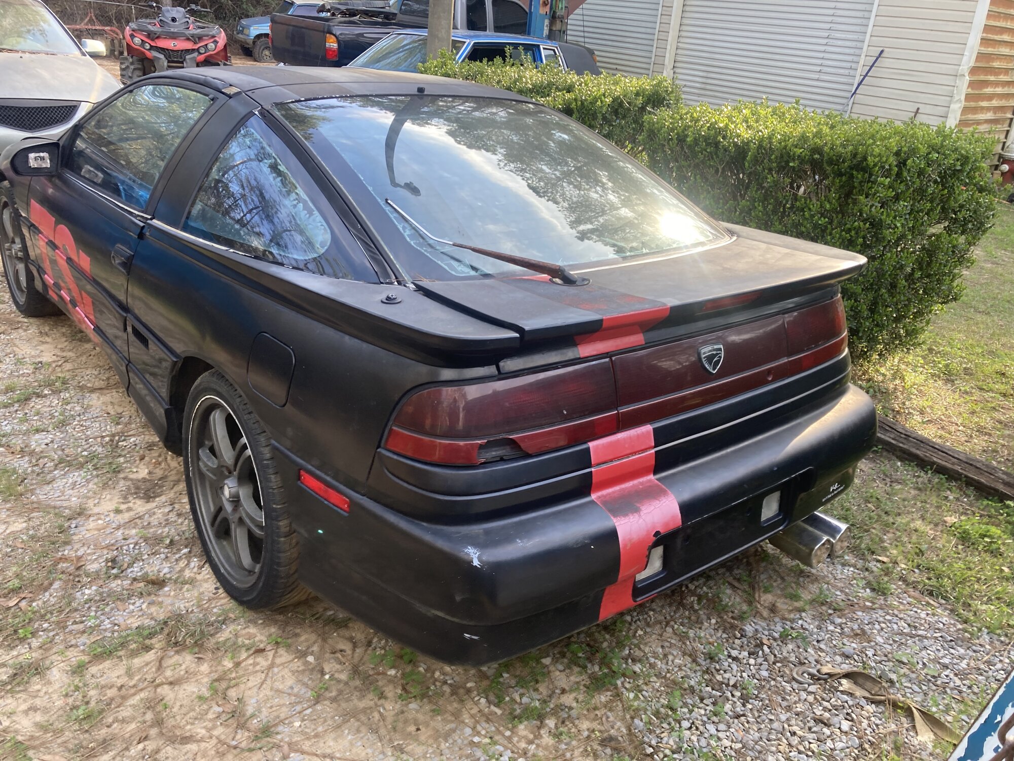

Well, I had a parts car stumble into my lap and it was a screaming deal. So I bought it. I paid $400 for it and I’ll post up pictures later.
I’m excited. :D It’s got really good bones. It’s a little too far gone to make running again, and it’s not got a title…but man this car is so straight.
Only caveat is it’s a 90.

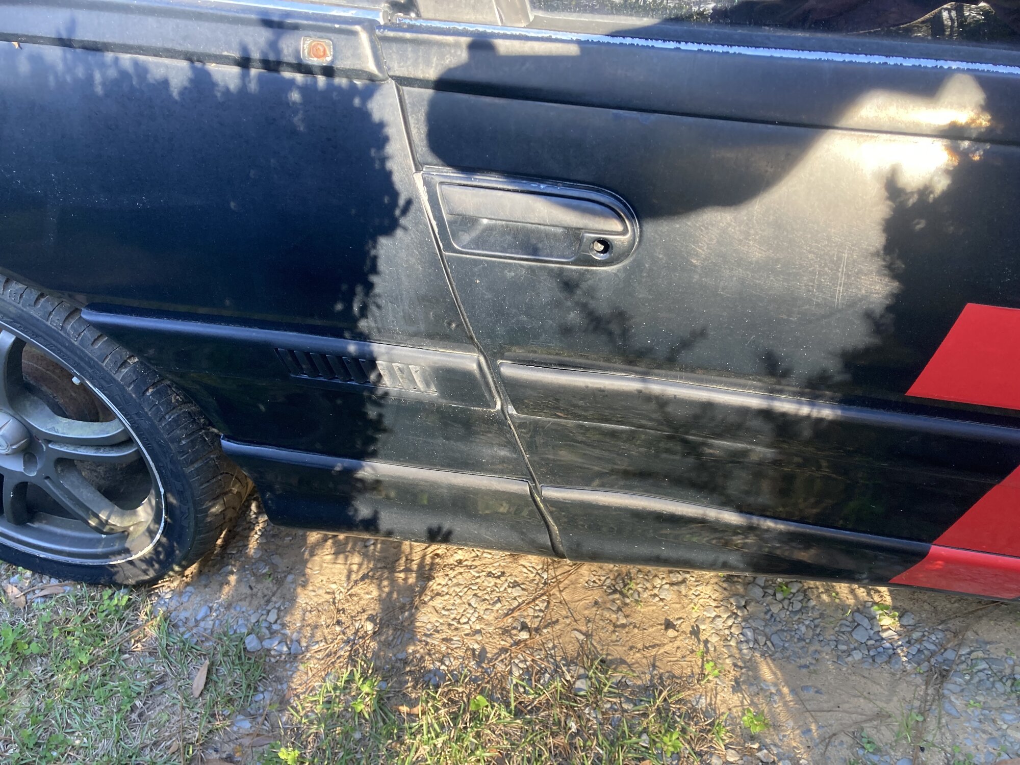

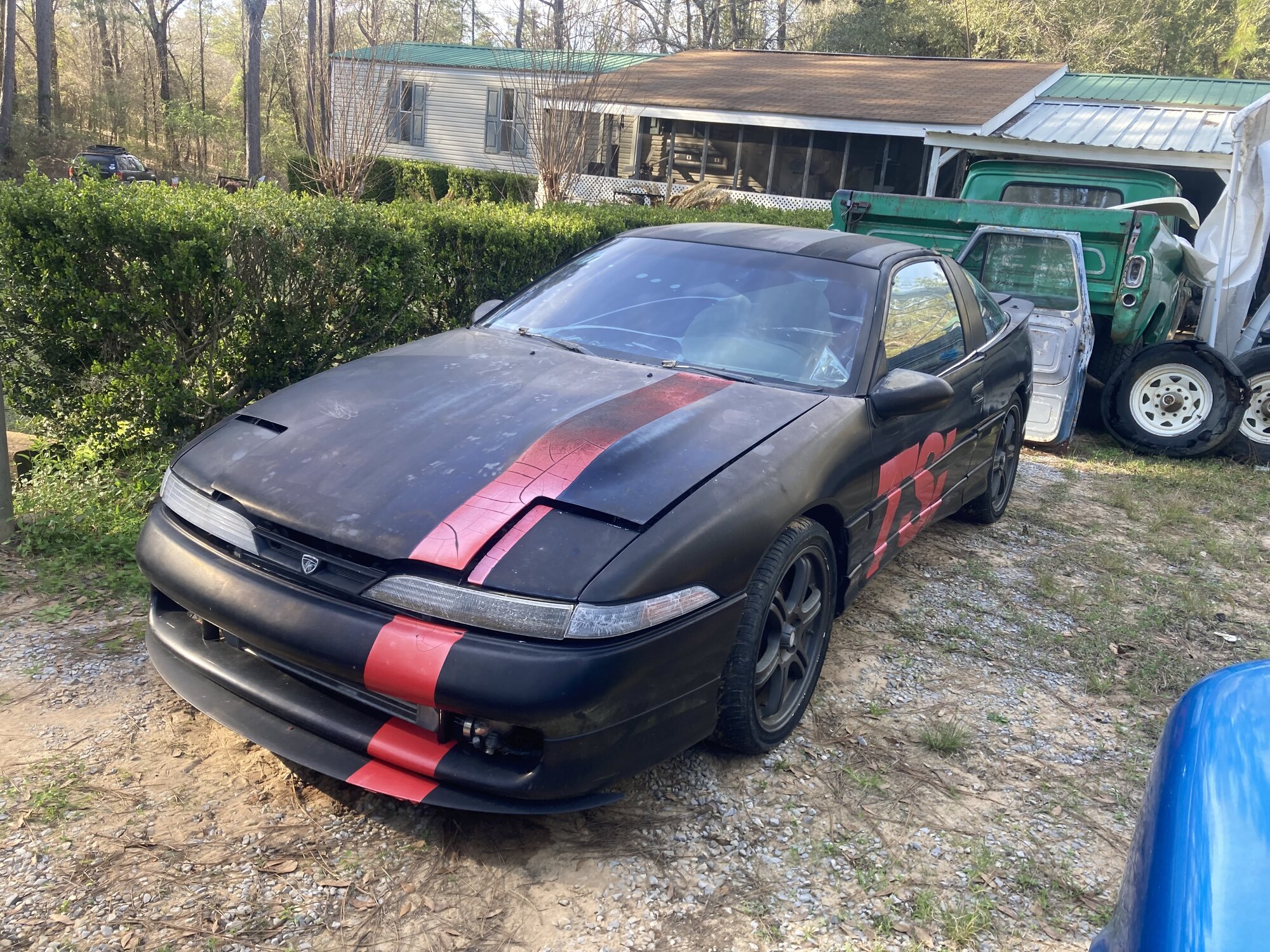

Here it is, and the more I look at it the more I scored. The guy I bought it from says he was told it’s a built engine and that it’s “locked up” but can’t prove it. But..yeah. Pictures first.
It's rough at first glance...but bro this body is SO STRAIGHT. The pinch welds under the car are PERFECTLY laser straight. No rust on any of the subframes, no major dents or dings except 1) on the passenger side front fender, looks easy to get out 2) One on the pass side rear quarter panel right near the exterior vent/trim. Also looks easy to pound out from the inside.

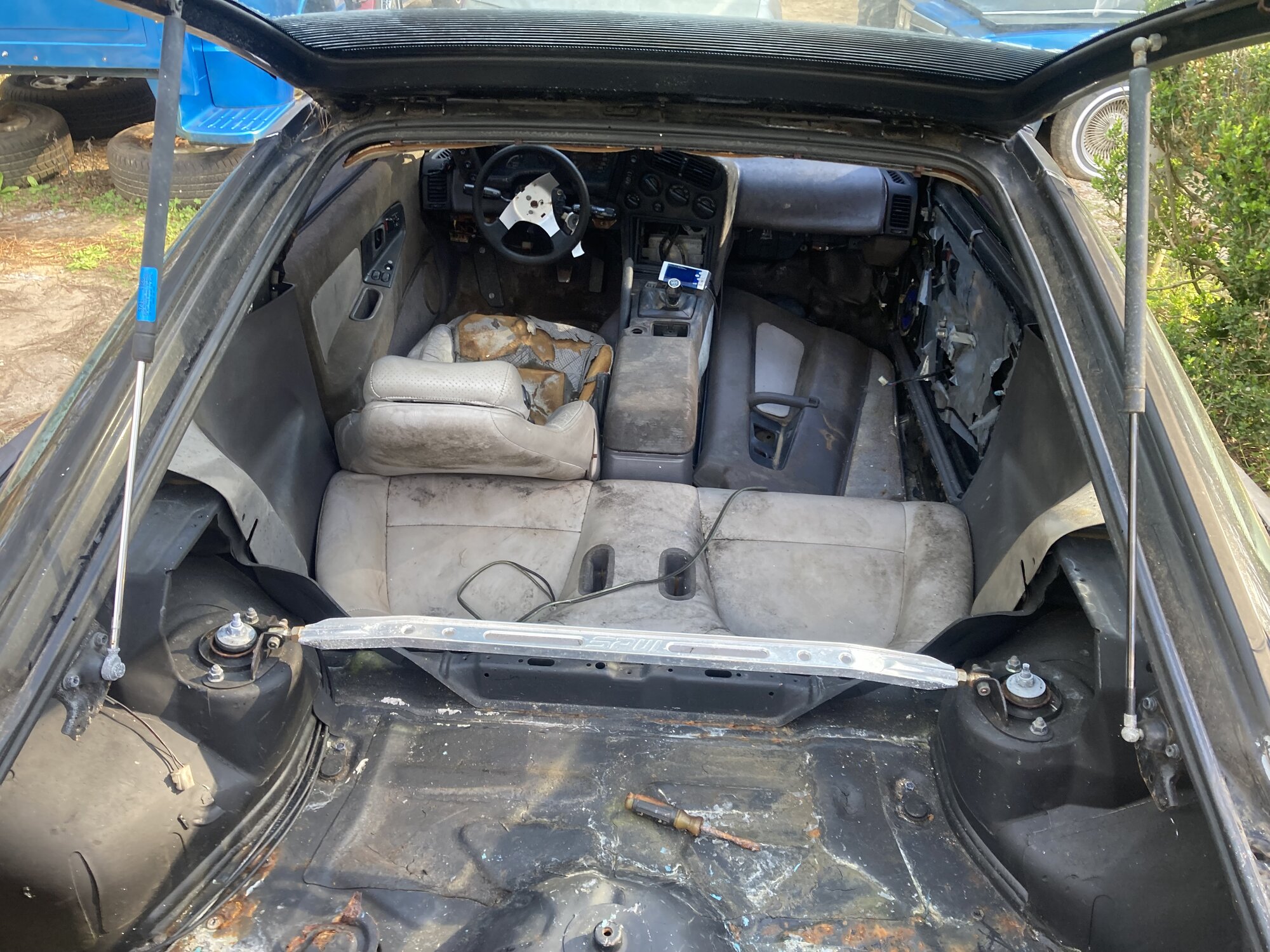

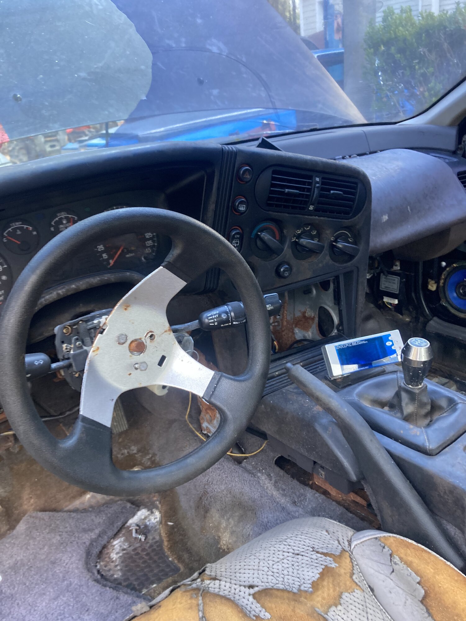

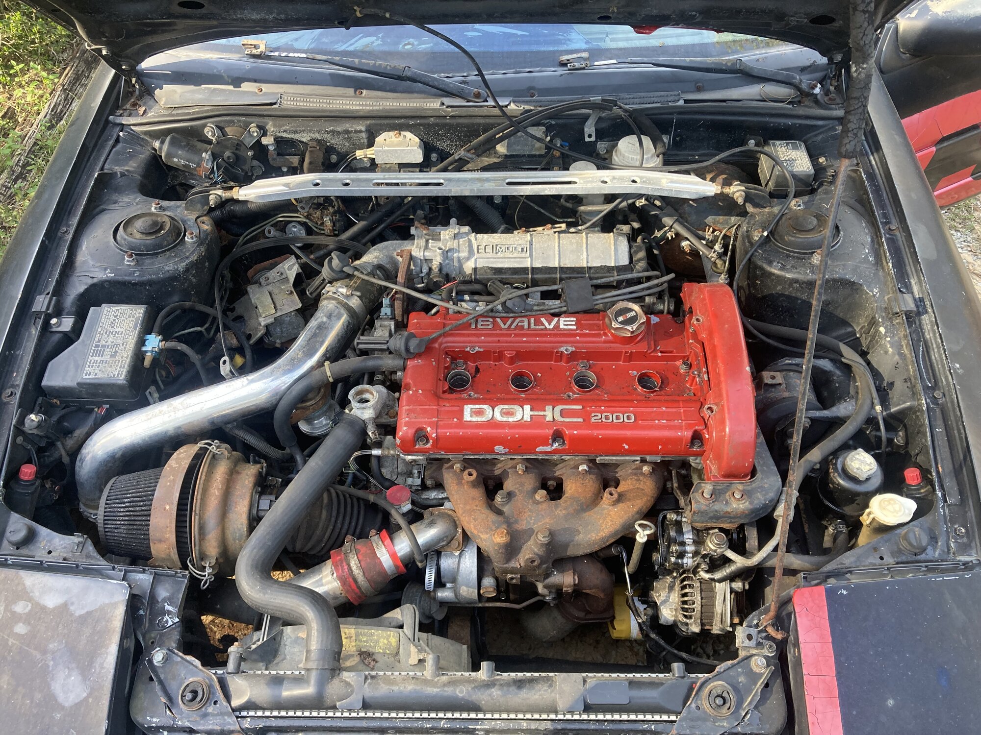

The interior is screwed as you can see, but it's got really solid bones. As I said, the previous owner said he was told the engine was built and transmission was "built" but couldn't prove it and was honest about it. He said he was told that "There's a chip in the ECU to help make it fast". This is important. First thing I did after handing him his $400 cash, was pull the ECU and pop the cover off. It has "rebuild and ship back" written on it, so I popped the cover off aaanndd..

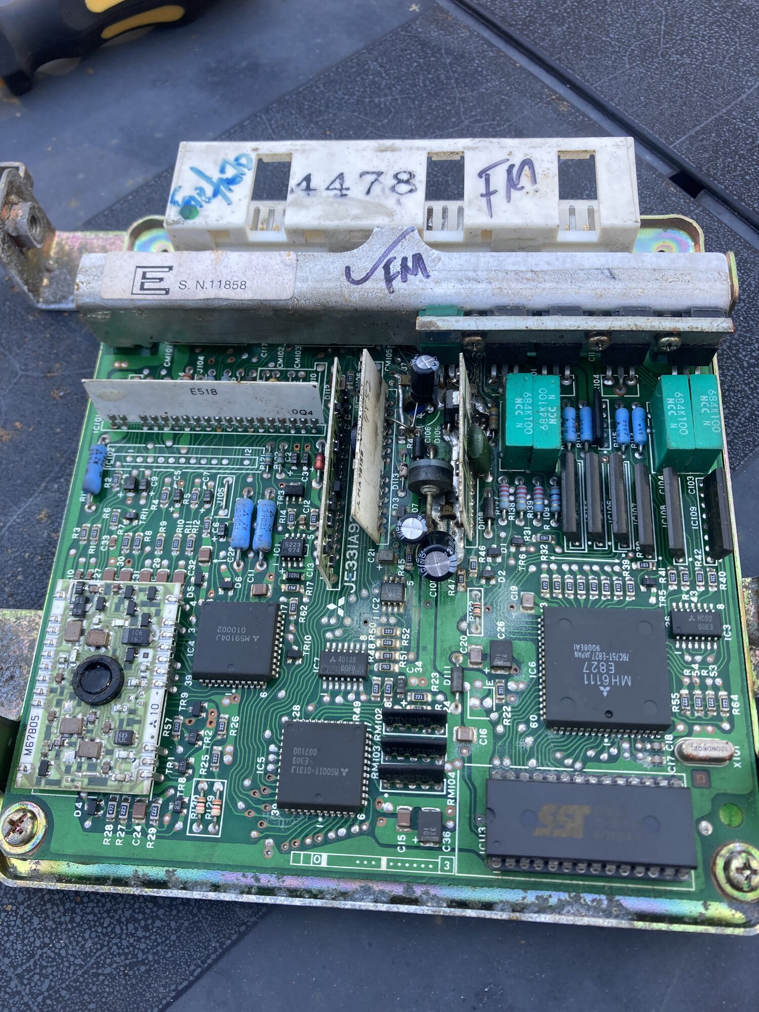

It's a chipped EPROM!! Already socketed, and there have been extensive repairs done. Since it's a 90 ECU I'm gonna test it in my Talon and make sure it works first. But this pays for half of the car alone if it's good. So that's one part of what he was told is true...let's rip the VC off and check that.

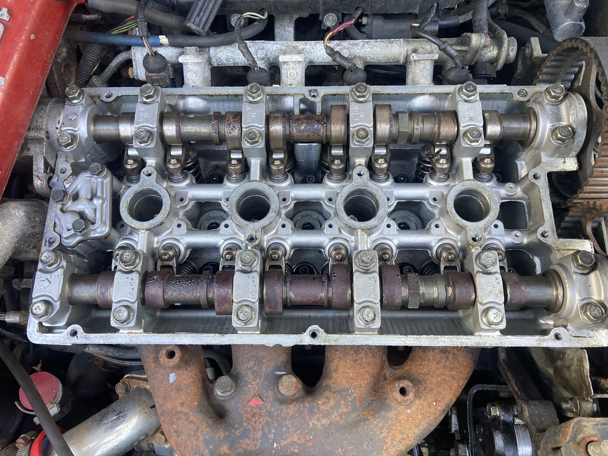

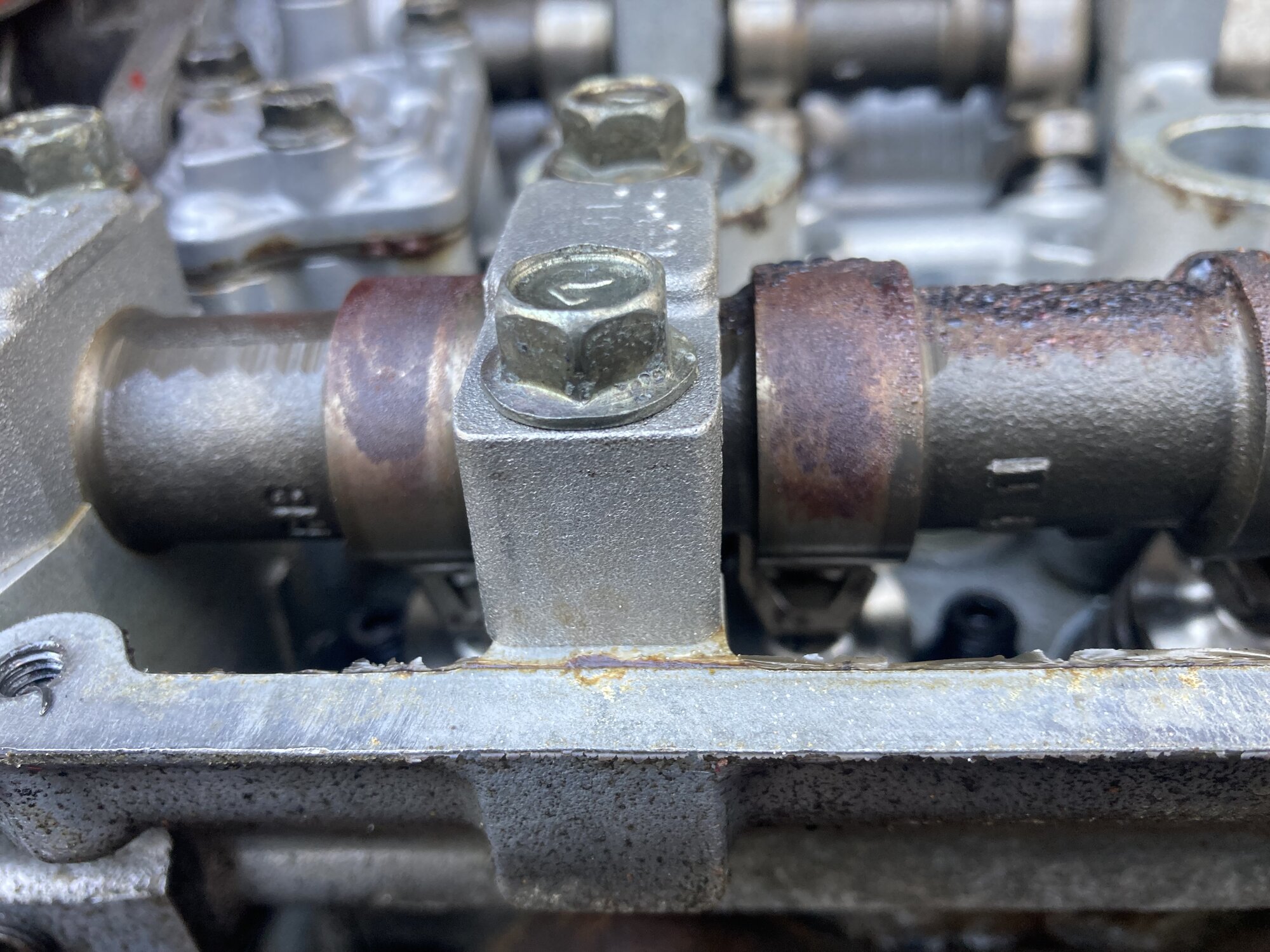

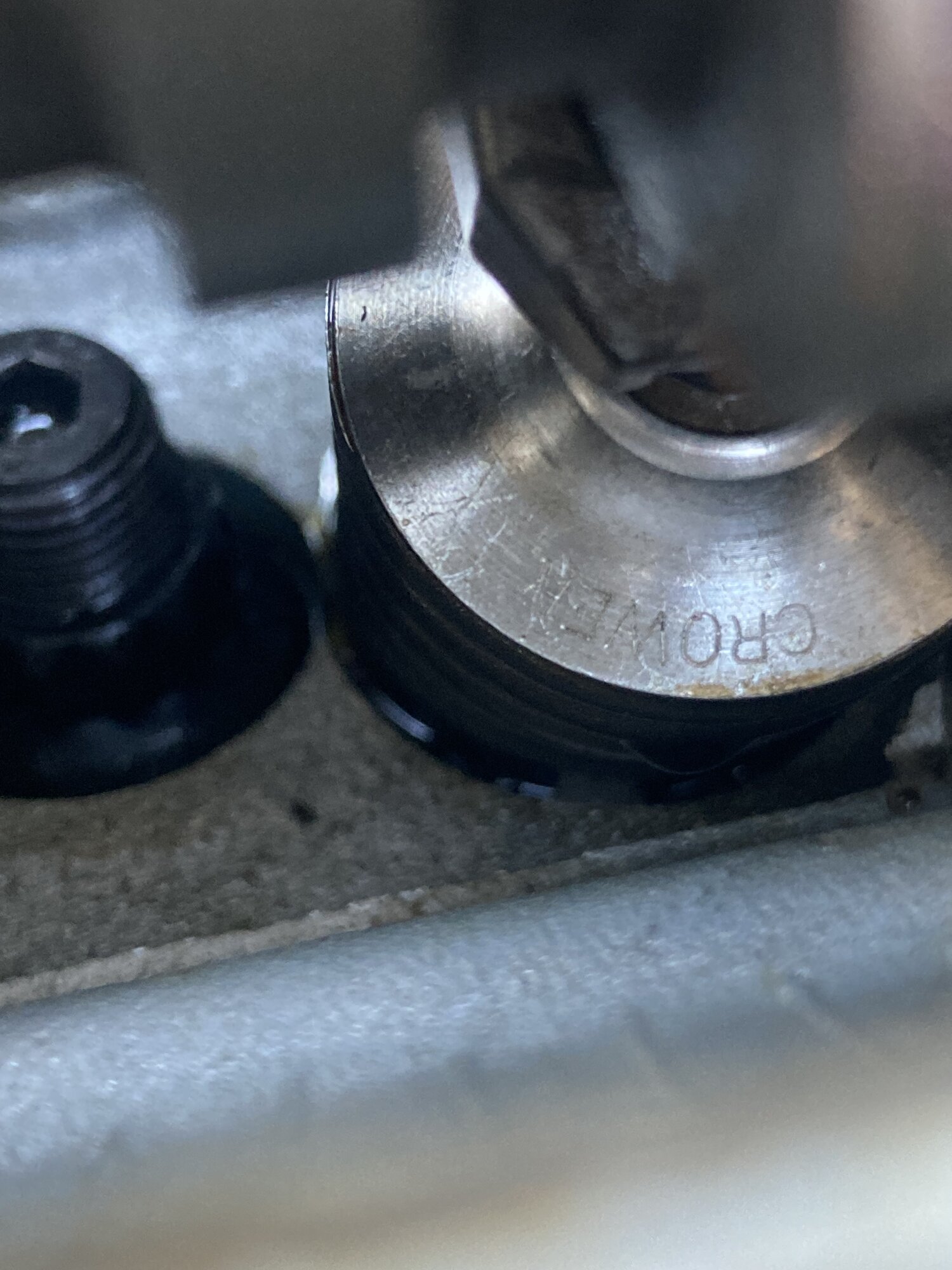

This head is brand new!! And those are not OEM DSM cams. It has ARP headstuds, and Crower (or brian crower, but it has crower stamped the retainer though, I think BC has "BC0101" on theirs) springs and retainers, and unknown aftermarket cams. I shone a bright light down one of the sparkplug holes and the pistons are shiny metal, not black or gray like OEM. I think this thing has a f*cking built motor! He said he was told it was "locked up" but I'm skeptical. Once I get the car in my hands, I'm gonna pull the pan and check out the crank/bearings. If it's just a spun bearing...that's a built engine, socketed EPROM ECU, and good 90 trans/tcase I got for $400. There's other plusses too including but not limited to:
1) absolutely rock solid ZERO shaft-play 14B that looks brand new. That turbine housing isn't rusted yet at all, and the CHRA ring clamp is still shiny metal. It doesn't move a millimeter and spins free and great.
2) The harness is old, but great. It's not hacked up, missing pieces, or eaten by critters. Interior electronics are also all there and unmessed with. Even if it's a 90...that's tempting.
3) The transmission goes into all gears smooth AF, and that shifter feels gated. It feels...new. IDK how to describe it.

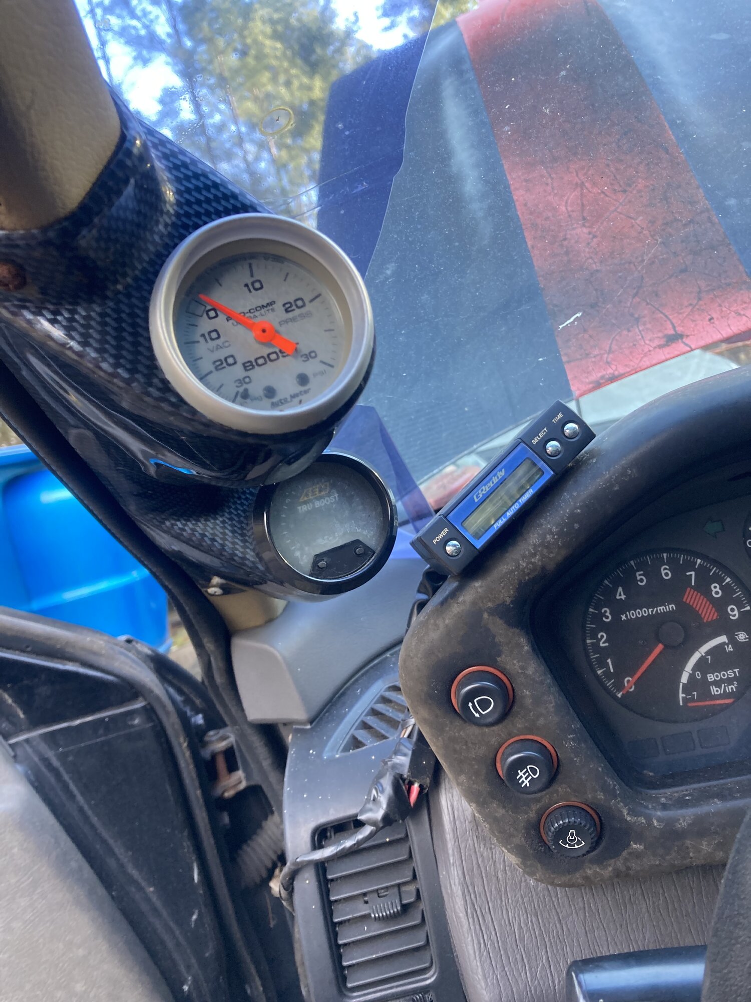

4) It has random electronics like an OG model AEM TruBoost with the solenoid and wiring. The gauge face is pretty rough, but I can get a new one or fix/polish this one.
5) The sending unit is mint, and not rusty or stripped out or missing anything.
And on and on and on. Overall...I'm not gonna lie to you guys...I am extremely tempted to fix this thing. I bought it as a parts car...but it feels like a crime to crush/strip such a clean shell. I can get a bonded title for it pretty easily. IDK. What do you guys think? Score a deal or nah?
Nice score. I'm glad you can see through the junk and to what's usable/valuable. I hope you thoroughly tear that ting apart before scrapping it. Or maybe even put a running engine in it and let somebody else take care if it :sneaky:
Honestly 400 bucks is a steal even with the condition of certain parts, and the ridiculous door graphic. I've paid that much at the junkyard just to keep shit around.

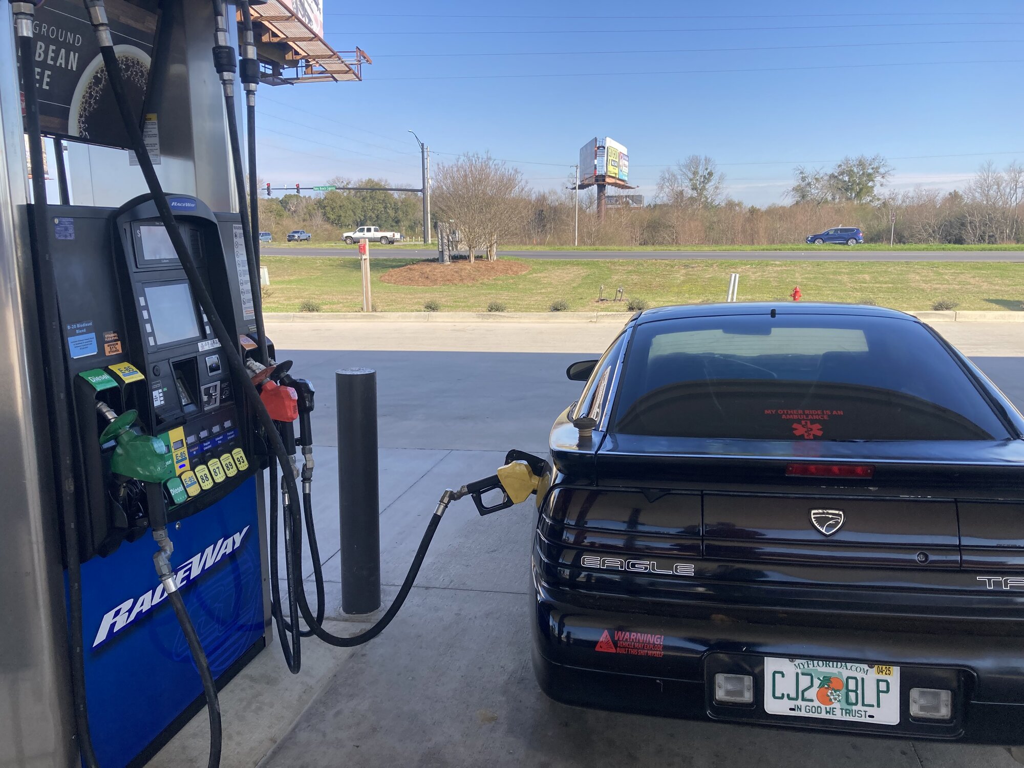

Well, she’s officially an alcoholic. :D
Only had to take some out of global, but otherwise it seems to love it. I’ll do some logs later and see how the IDCs are. Might have to step up to some 1200cc injectors.

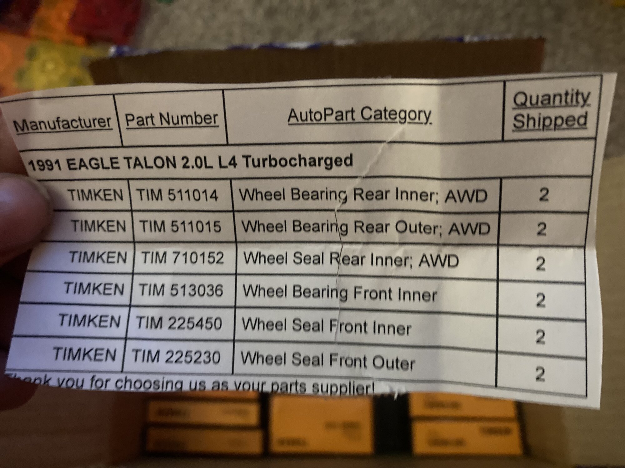

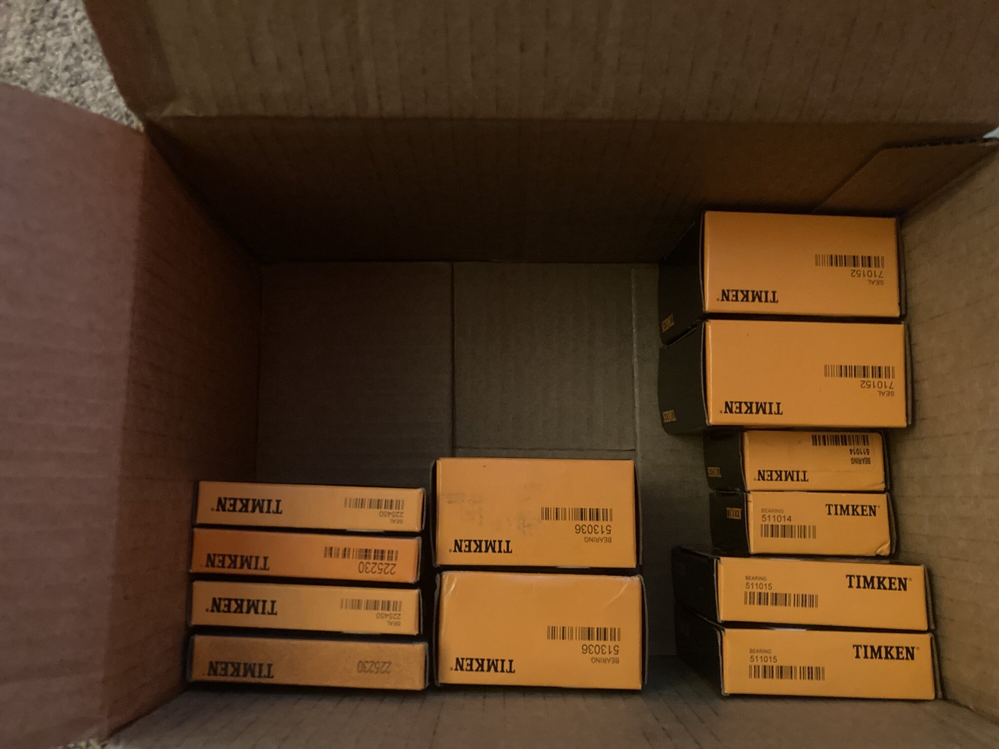

Parts came in today. :)
Kinda cool. The bearings when you open them all say KOYO on them. Seem super high quality. And that front wheel bearing is MONSTROUS. Heavy SOB LOL.
Can’t wait to see what difference this makes. Very interested to see how they look.
I have the outer dust seals coming too and are NOS OEM ones.

Since I have to wait another week to do the wheel bearings and stuff, I went ahead and ordered the rest of the suspension stuff too. Ball joints, inner and outer tie-rods. So that way it'll all be nice and tight again. If I had the cash, I'd love to get the Volk Metal Craft adjustable upper and lower control arms for the rear, but alas. Funds are looooow until the new paychecks from the new job start rolling in.
I will probably just eyeball the alignment until I can afford those, then take it to get professionally aligned since I'll have the upper/lowers from VMC. Either way, fun stuff.
