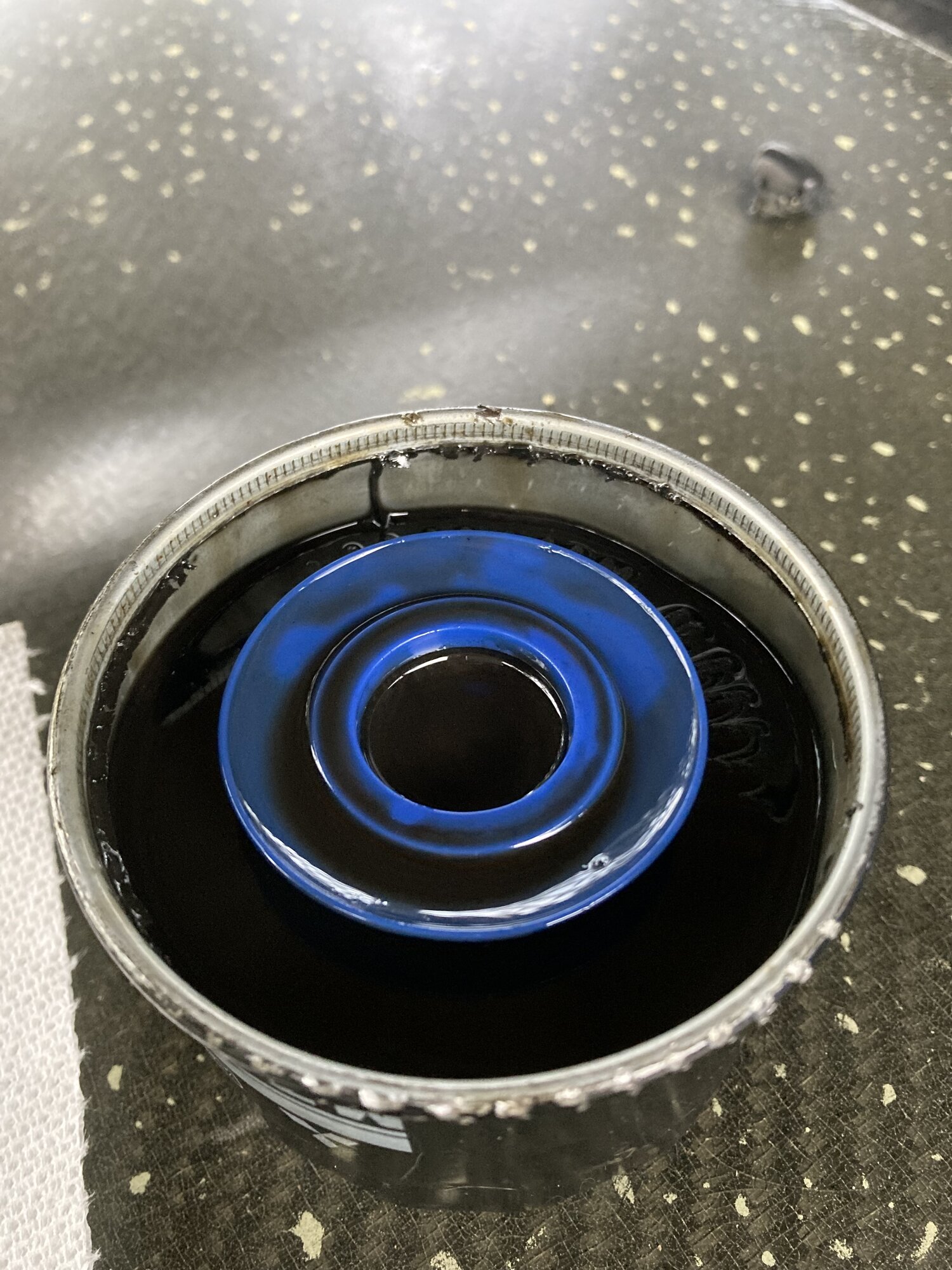

First real oil change was complete. No chunks or suspicious stuff in it, just your normal first 500 mile oil. I used Valvoline VR1 :) in there now. I really want to cut my oil filter open, but I don't have an oil filter cutter and I don't wanna use a cut-off wheel and catch it on fire. Lol.
Don't suppose anyone has a super duper old skool trick for cutting oil filters open do you?

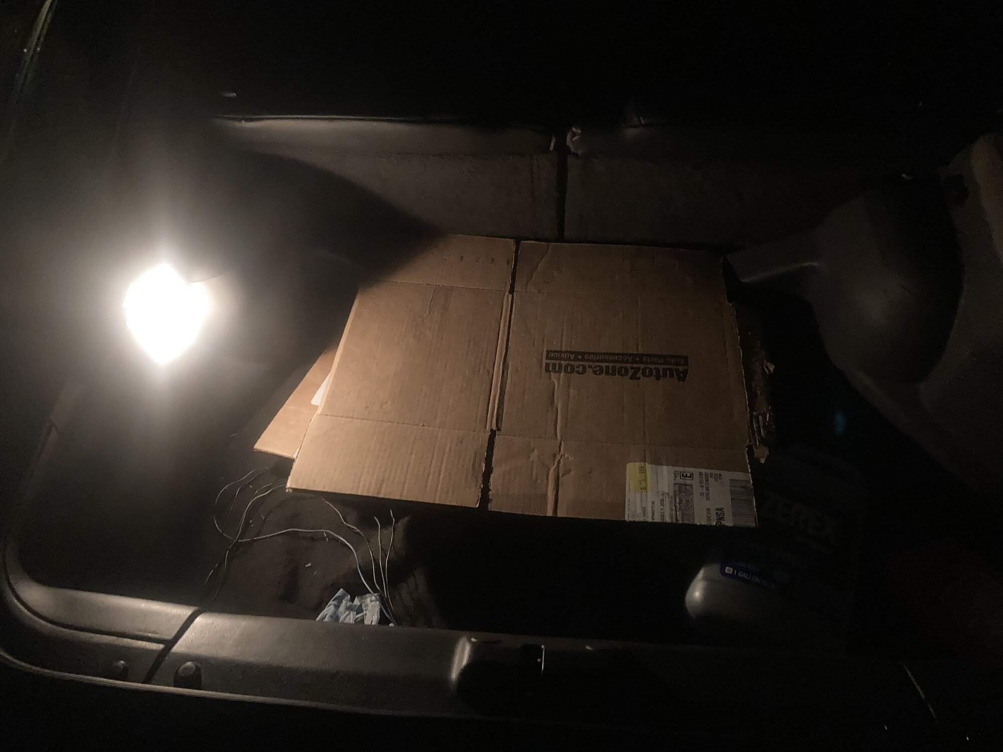

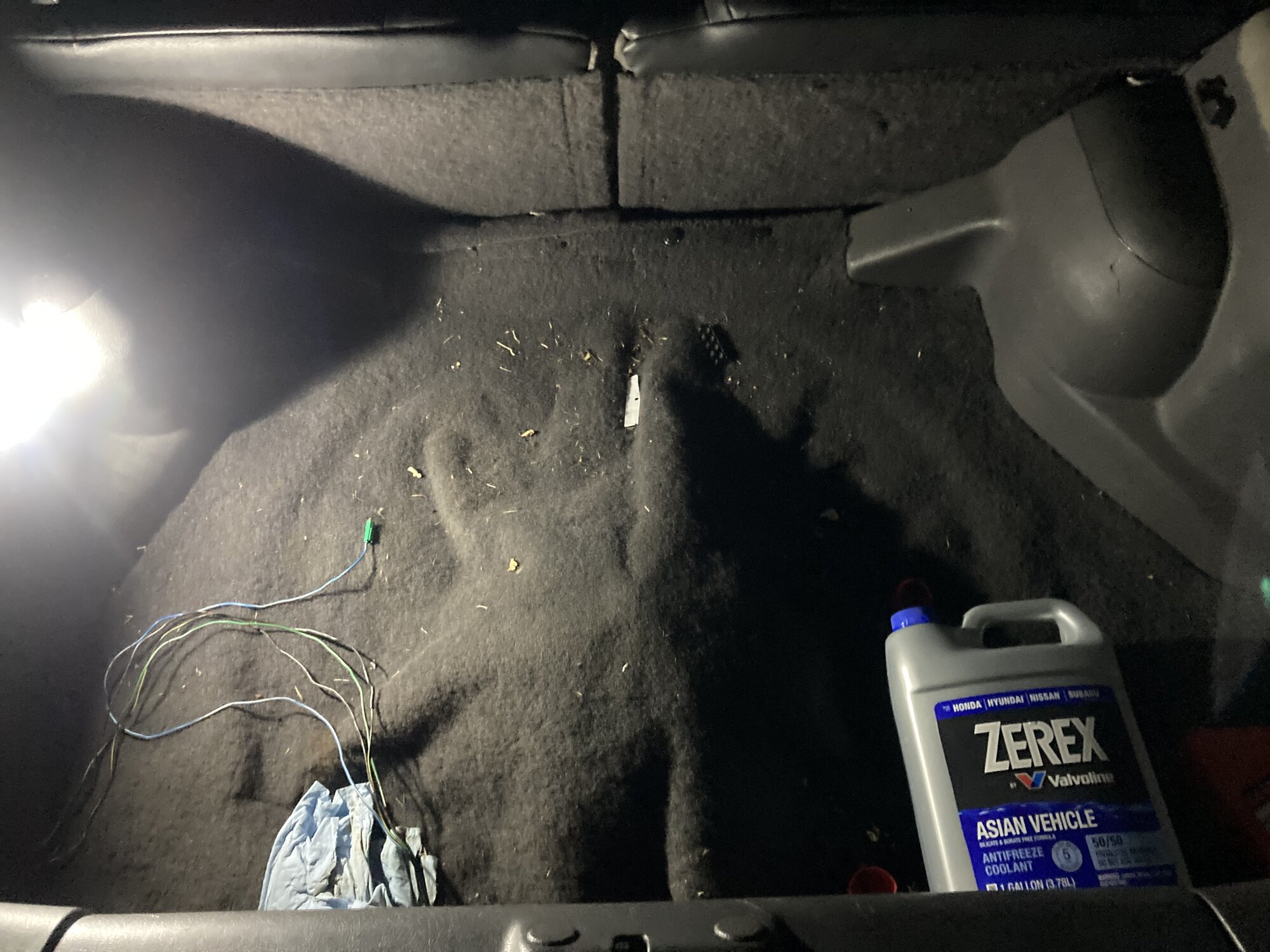

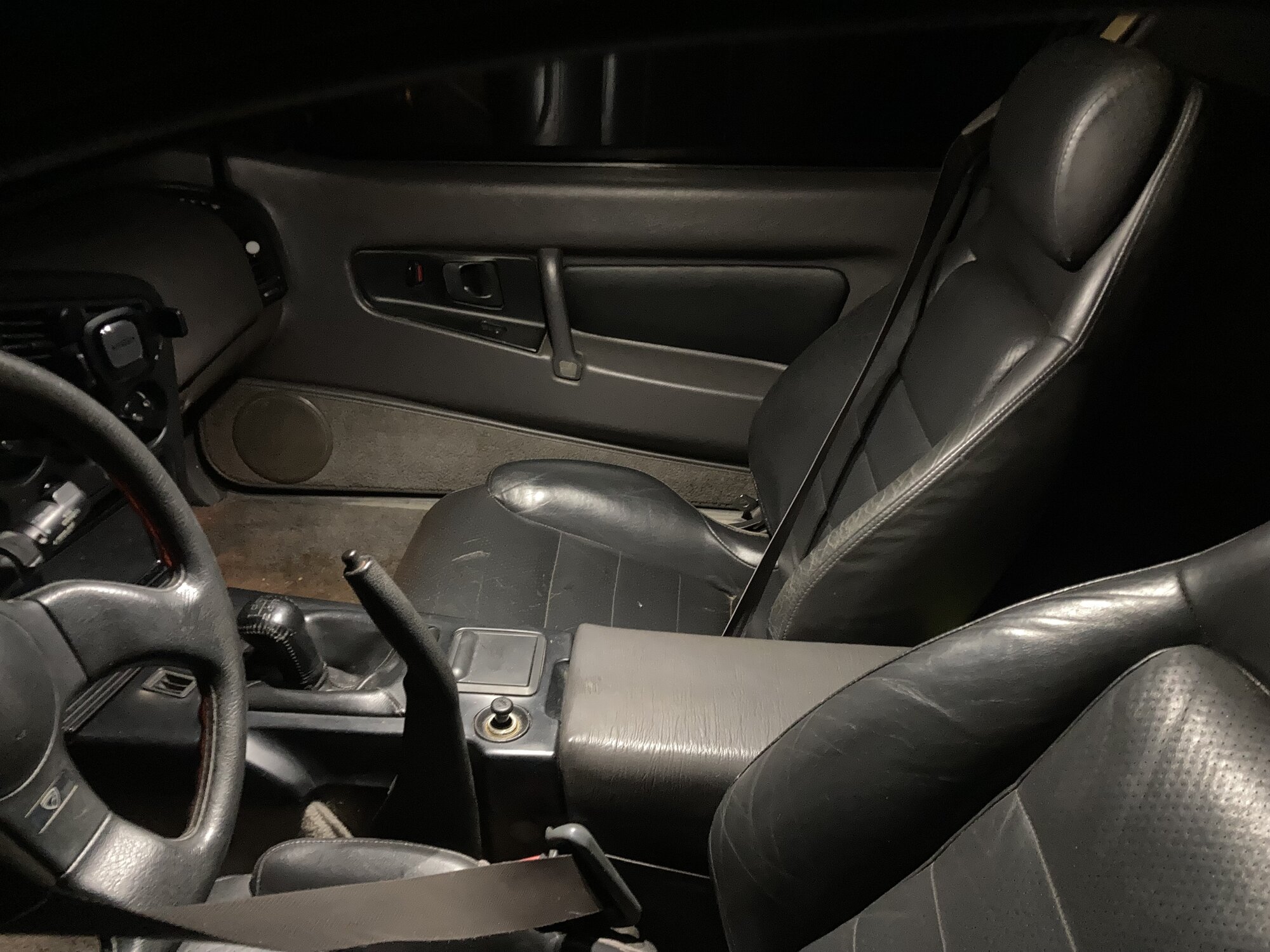

Also: I installed some LED lights for the dome lights and the trunk light. Looks so much more modern on the inside of the car now. Will take pictures later when it's actually dark outside.

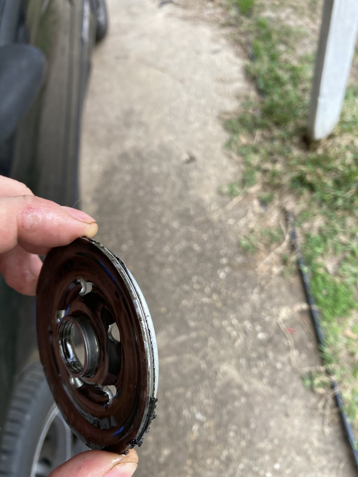

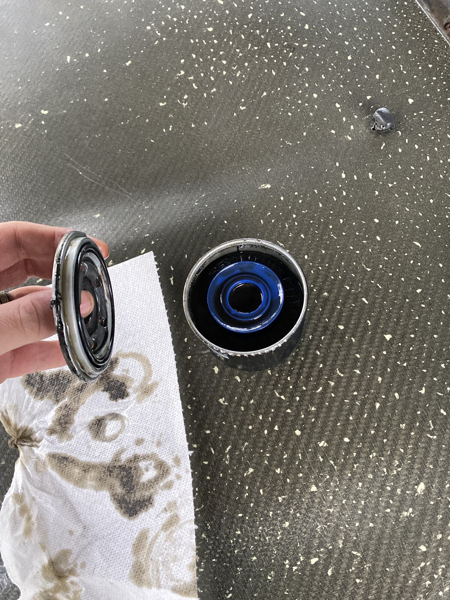

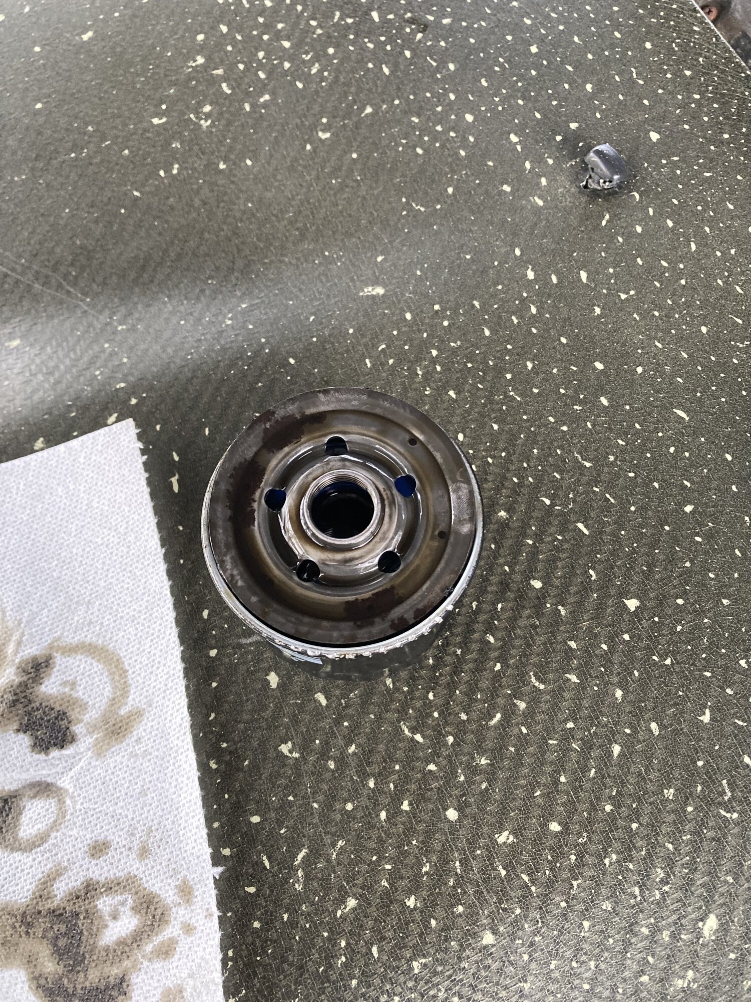

Feel like a genius here, fellas. I had a spare mechanical can opener, and decided hey an oil filter is kind of a can. Let's see if it works.
I'm here to confirm that it works beautiful and perfect. Easy AF, and this is just some cheap walmart can opener. Pictures for proof.
No muss, no fuss, nice and easy. No special tools required. IDK if anyone else did this before me, but man. I couldn't find anything on the interwebs. I feel like a very stable genius.
Unfortunately, I think that's the end of the good news. Got a decent amount of silver flakes in the filter element, so I think this engine is on borrowed time. It's been a long time since I've built an engine, so I can't remember what's normal vs what's not. But this oil filter has been on the engine since 0 miles. So it's got 500 miles of break-in on it. So IDK, maybe it's normal. We'll see though.
Look at these bright f*ckers. Lol. I am in love with the dome lights up front the most though. It feels like a modern cars lighting. It's bright without blinding you or being overwhelming.
Interior
Got a before and after for the trunk light too.
Before/Halogen
After/LED
So much nicer.
For anyone curious, you need 28mm DE3022 bulbs for the rear, and 31mm bulbs for the interior/dome lights.
Lots of glitter is normal, assuming there is truly only 500 miles since engine assembly. Large chunks are not acceptable, but glitter will be plentiful. Change it again in 1000 miles before you worry yourself to death.
Define “large”. ROFL
I’m not worried at all even if the engine is fully cooked. I’ll just build an engine myself with a 2G head like I wanna do.
This engine was assembled by a meth addict who is notorious about screw ups. So it was probably not even cleaned prior to assembly.
I’ll see how the 1000-1500 mile oil change filter looks using my super secret can opener technique. If it’s got bronze in it then we’ll call it and get a solid engine built.
I'm not sure what kind of bearings were used, but next time you do an oil change install a magnetic drain plug. That will (hopefully not) collect the particles you should be worried about. I've never run a turbocharged engine without one.
I’m not sure but I’d probably hazard that they’re King XP bearings. They’re a favorite of methhead.
