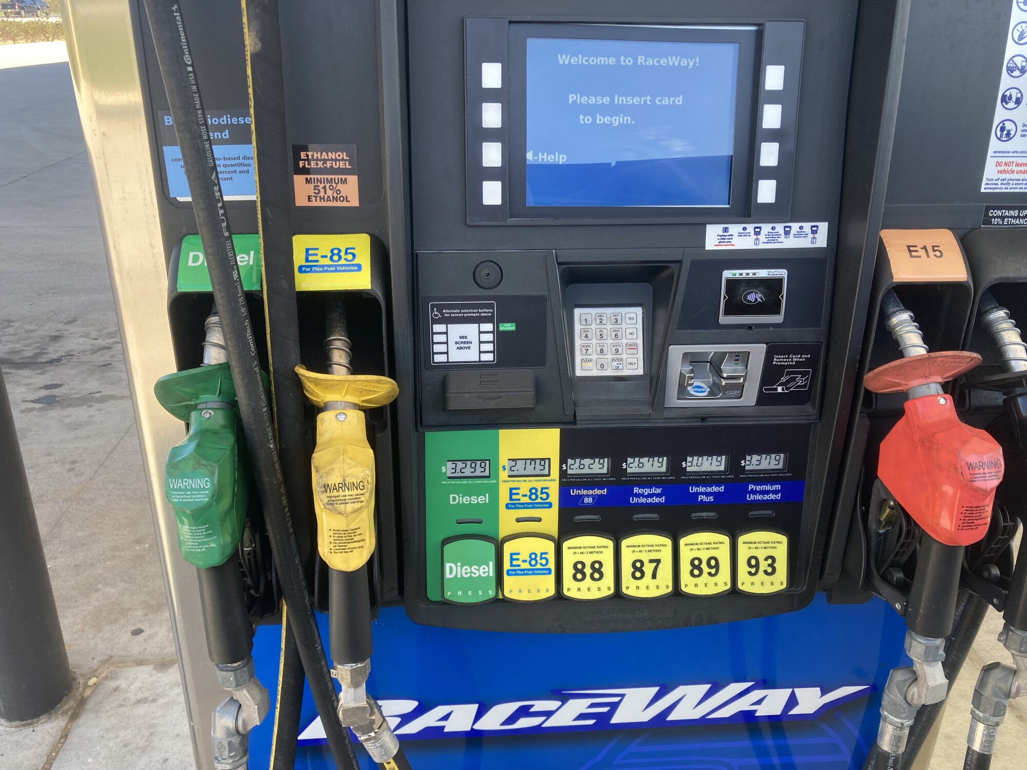

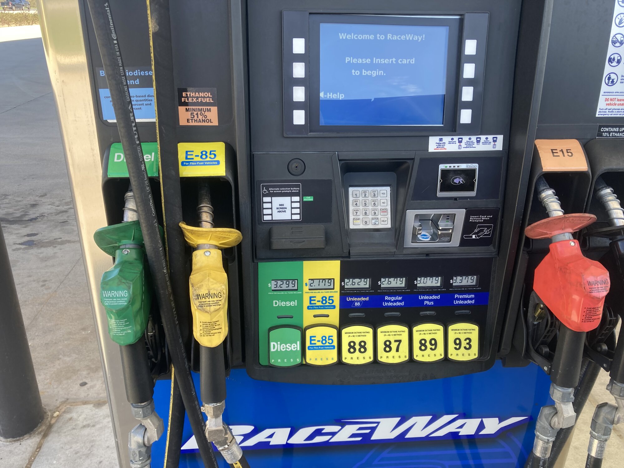

But, to update the thread I have spectacular news. I started a new EMT job, and that’s not the spectacular part. The best part is it’s 8 minutes from THIS!!
Freakin yes. I’m switching to at minimum E50 for the Talon. Full E85 if it can handle it. I’m so stoked because it’s not even out of the way. It’s on the way home!

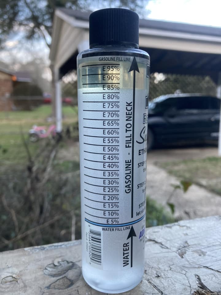

But, that's not the end of the good news. This is the "winter blend" and how it tested.
Stoked. E80-E83. Couldn't be happier, man.

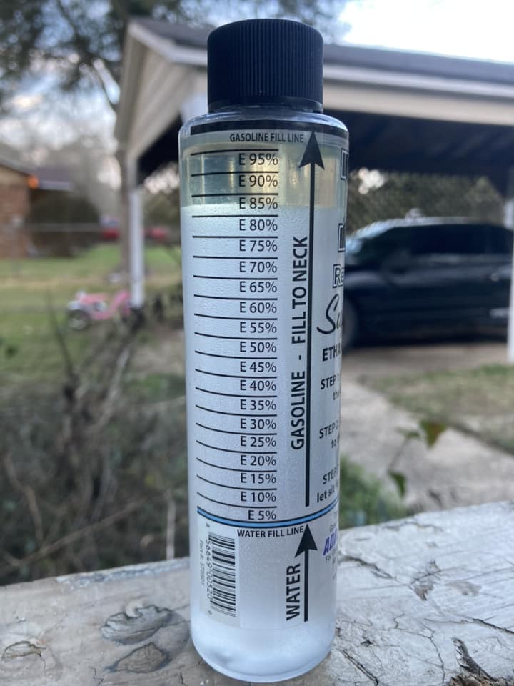

In Michigan we are told E85 and that's it. The reality is every source of it is different, and it changes seasonally.

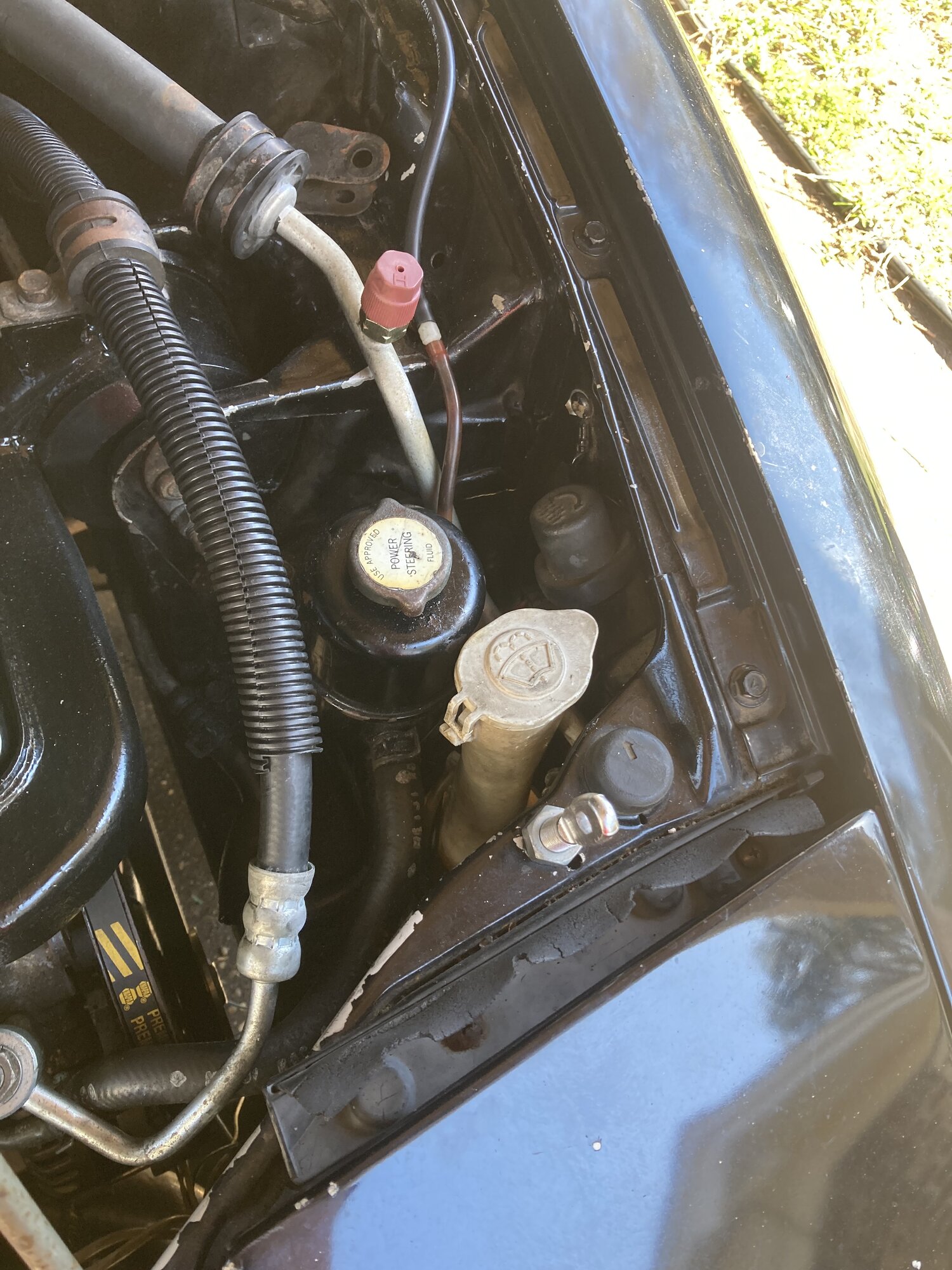

Edit: Also, I'm tired of this dipstick popping out. The tube looks like someone clamped it with some pliers but did it wrong, so its open more on one side than the other. I ordered the STM dipstick with the spring mod done, and just gonna be done with it. Lol.
Yeah that dam dipstick will cause a fire and make you open the hood and pee on it if you don't have a fire extinguisher in the car. I was THIS CLOSE to doing that, then threw Snow on mine. You'll like the dipstick.

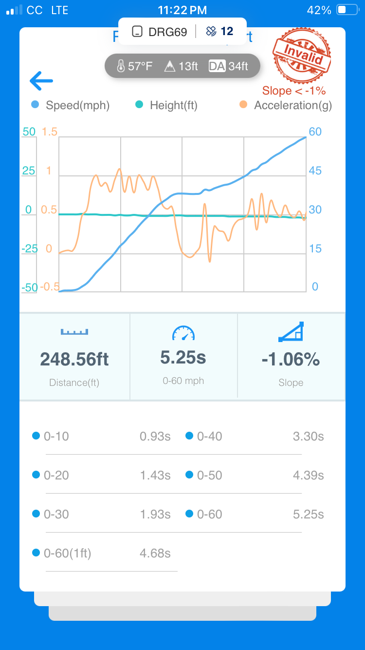

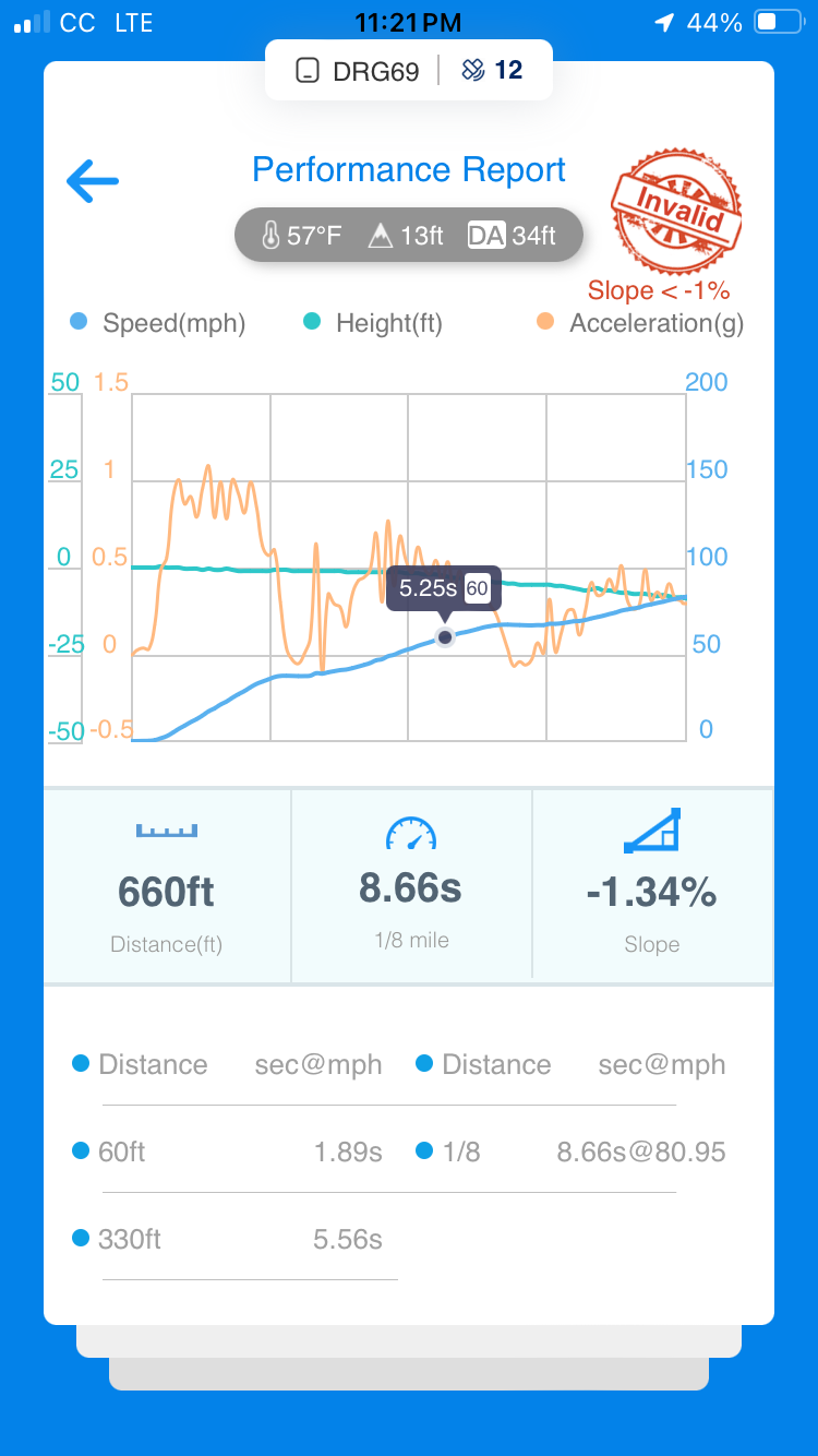

In case you don’t see what happened, this thing RIPS!
I pulled through the ebrake because I slipped it a little more than intended, which started the test early. I backed out of it and then launched it. I got an amazing launch man. It felt really good. So take .4-.5 seconds off everything you see here. And I let off juuuust when I hit 80MPH so the 1/8th mile is actually not even a full pass. It coasted to a 14.2 @ 62MPH ROFL.
But cannot be more stoked. This thing RIPPED to 0-60 even with the .5 pause at the beginning. And I was only revving to 7k.

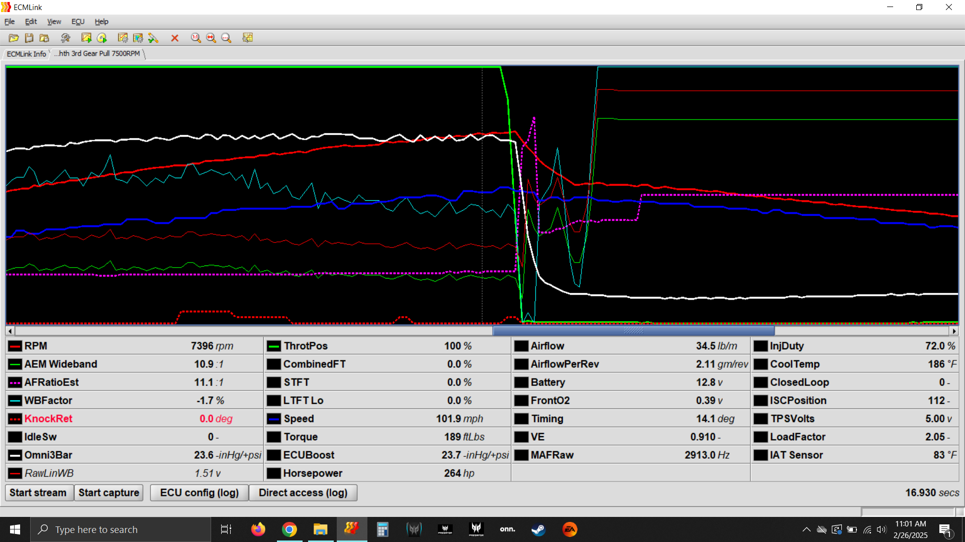

Love that it's flowing 34lbs a min now, and boost is only at 24. I want to eventually turn it up to 30 or as close to 30 as my fuel system will allow. Super happy with this. Now I'll start leaning it out and giving it more E85. :D
Trying not to be a dick, but you have a cork in that thing somewhere. My all motor car on E85 runs 7.40's at 93mph, or 11.70's at 115. That's a worn the f*** out motor too with a stock port head. If it runs that with boost at 24psi, you ain't going 11's with a rocket strapped to it. You have a large large problem somewhere. My all motor car is dang near 30lbs/min. yeah yeah it's exciting it runs, but from the looks of it, it barely runs. Fix it before you f*** it up good. Guys ran 11's on greens 20 years ago in full street cars with pump gas and an SAFC.
Is this ALS in ECM Link? I've never seen this actually working - I don't understand how it is implemented. Can you elaborate on how it is working for you?
You set the ALS to kick in like 500-700RPM before whatever your two step/launch limiter is. I’ve been told that the more timing you retard, the more boost it’ll build and the more rowdy it’ll get. I’m only at 5* in the ALS “set timing” window, and it builds like 14-15lbs on my green.
Try my settings. Enable ALS to kick in 500RPM before your launch limiter and put 5* in the timing box. Go try it out. :D
