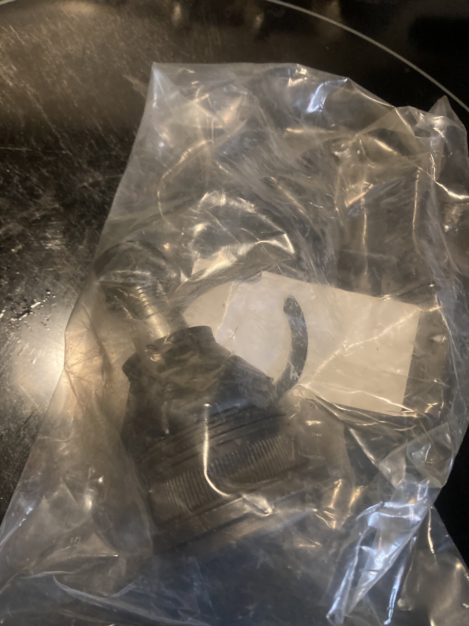

That’s a really solid idea. Thank God I have a parts car. And a spare new ball joint I can try.
Edit - I tested out the spare new ball joint I had, and it fits in the hole super firm and tight. I think I'd need some gentle taps on the knuckle itself to fully seat it inside or use the nut to pull it all the way, but the hole seems fine. That's a relief.

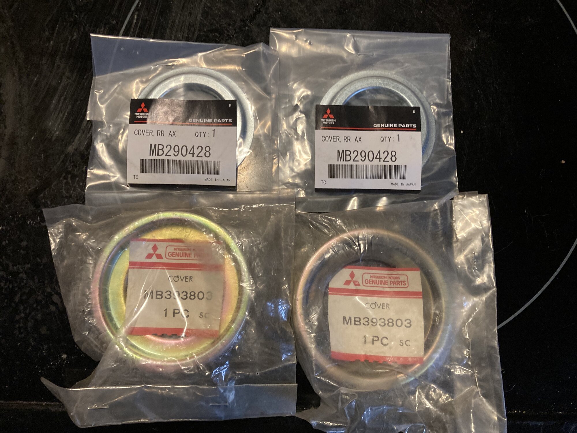

With this and the ball joints fixed I’m extremely curious how the car sounds and how it drives. Now I’m waiting on the rear dust shields for the hub side, and the ball joints to come in. Excited though.
There is something almost perverse about new in bag parts from Mitsu. My inner child is always so pleased when I do stuff like this.
Still waiting on a few more suspension parts and other parts I ordered, and I work the rest of this week. Hopefully though by the time this weekend comes we can slam it all in there. More pics later of all the new stuff as it comes.

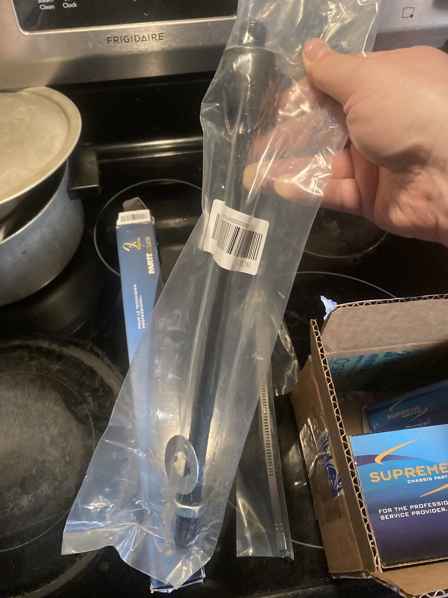

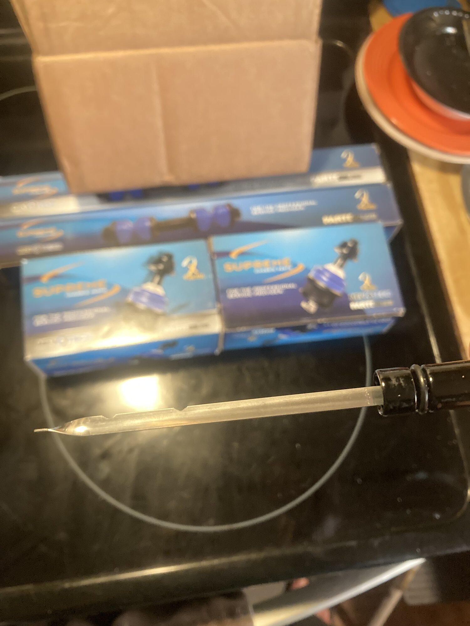

More pictures and details later but the dipstick came in before I went to work. Jesus I didn’t realize how loose my old dipstick is until I tried to pull this one out.
If it blows this dipstick out even without the spring on it, something major is wrong. LOL.
But yeah. Hopefully the ball joints and inner tie rods come in later today and I’ll get more pictures for you guys. This dipstick is so nice. I have the worst feeling it’s gonna be a huge pita to install though.

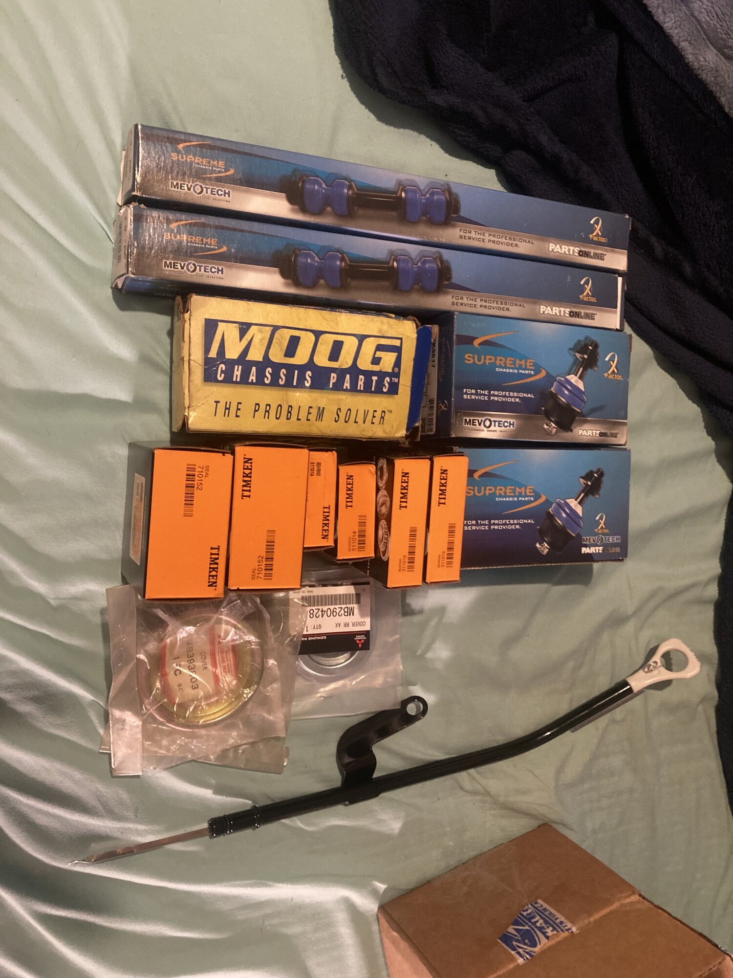

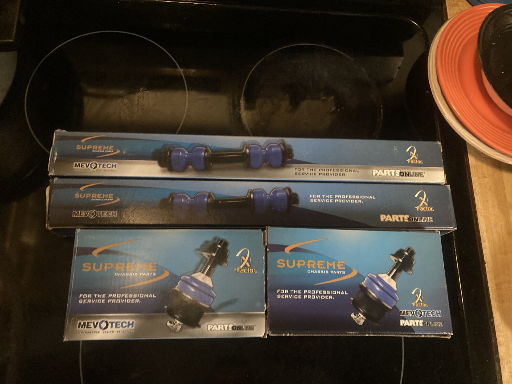

New parts pile came in. Feeling these new tie rods has me realizing just how loose and terrible the old inner tie rods are. Holy crap man. This is gonna feel insane…

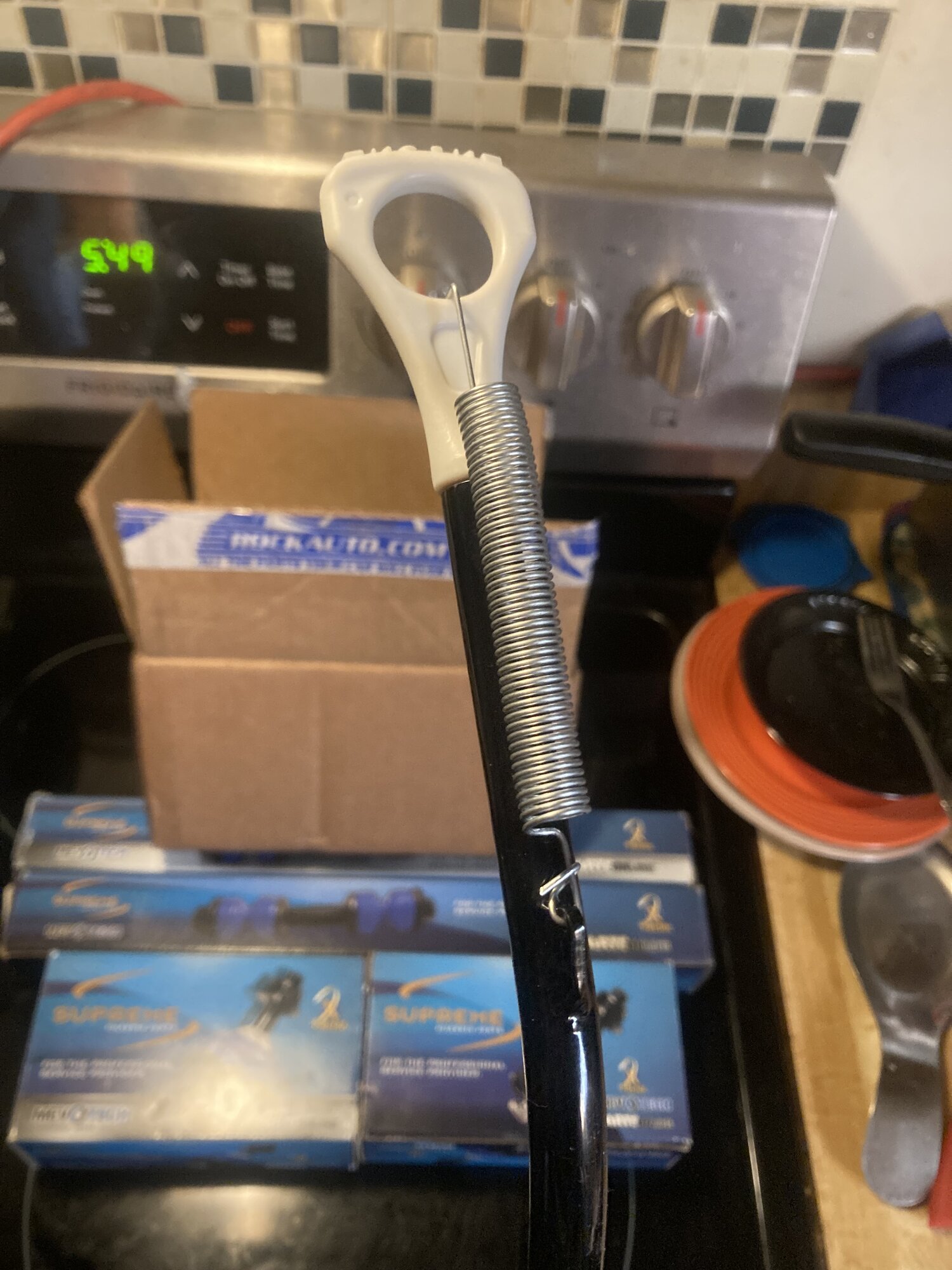

My favorite part is this though.

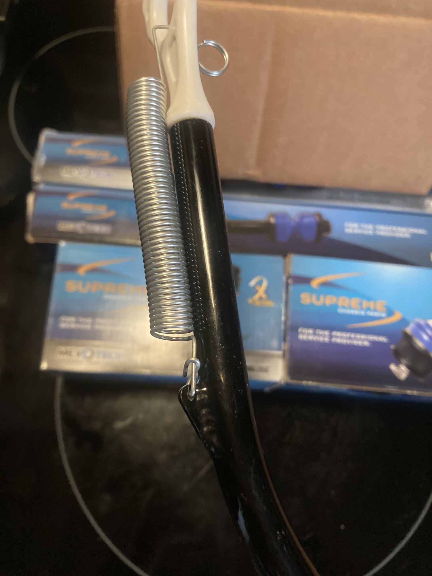

Look at how new the dipstick itself is! So shiny! And I love the powder coat on the tube too. But as I mentioned before this thing is in there TIGHT. If this pops out even without the helper spring we have major issues.
But yeah. Genuinely excited to see and feel the difference this all makes. I’m gonna end up doing the rear upper and lower control arms from Volk too. I’ll just pay for an alignment twice.
But yeah. Stay tuned!
What's with the spring on the dipstick? Is that for crank case pressure? I thought you had a catch can, so many questions. Your cars going to feel brand new after all that is on, I just have this weird feeling. I'm pumped for you!
I do have a catch can, but the lines going to it are the stock tiny sized lines and the current dip stick is so loose that it takes 0 effort to pull the dipstick out. So under boost it pops it out and sprays oil on the manifold. The spring is a bandaid to help keep the dipstick in place but man I don’t think it needs it with how tight it is.
