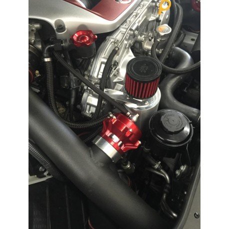

Speaking of nice parts I’m looking at this for mine.

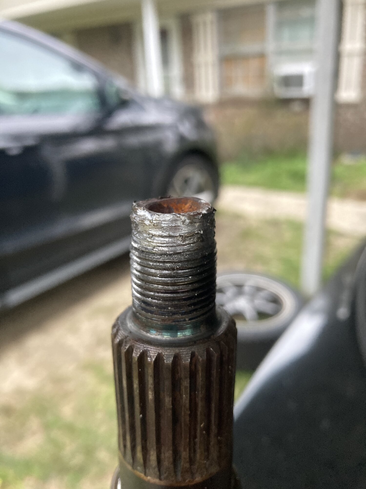

Unbolted the axle, unbolted the caliper and rotor and everything. Impacted the nut off and it came off suspiciously easy. Like it wasn't even there. I tried to put the nut back on to hammer it out like seen on youtube, wouldn't go on. Got tired of struggling with it, and ended up just using a slide hammer on the lugs instead. When pulled out, found that. I have no idea how the nut was even on that shaft or what was holding it in.
This day has been a failure from beginning to end. Parts stores were all out of the ball joint press tool and bearing separators I needed to even do this job.
I'm getting so tired of going to fix things on this car and breaking shit or finding shit broken to the point where the car is down for weeks. I feel like less damage would've occurred had I just kept driving the car and whatever was making the noise would've fixed itself or grenaded.

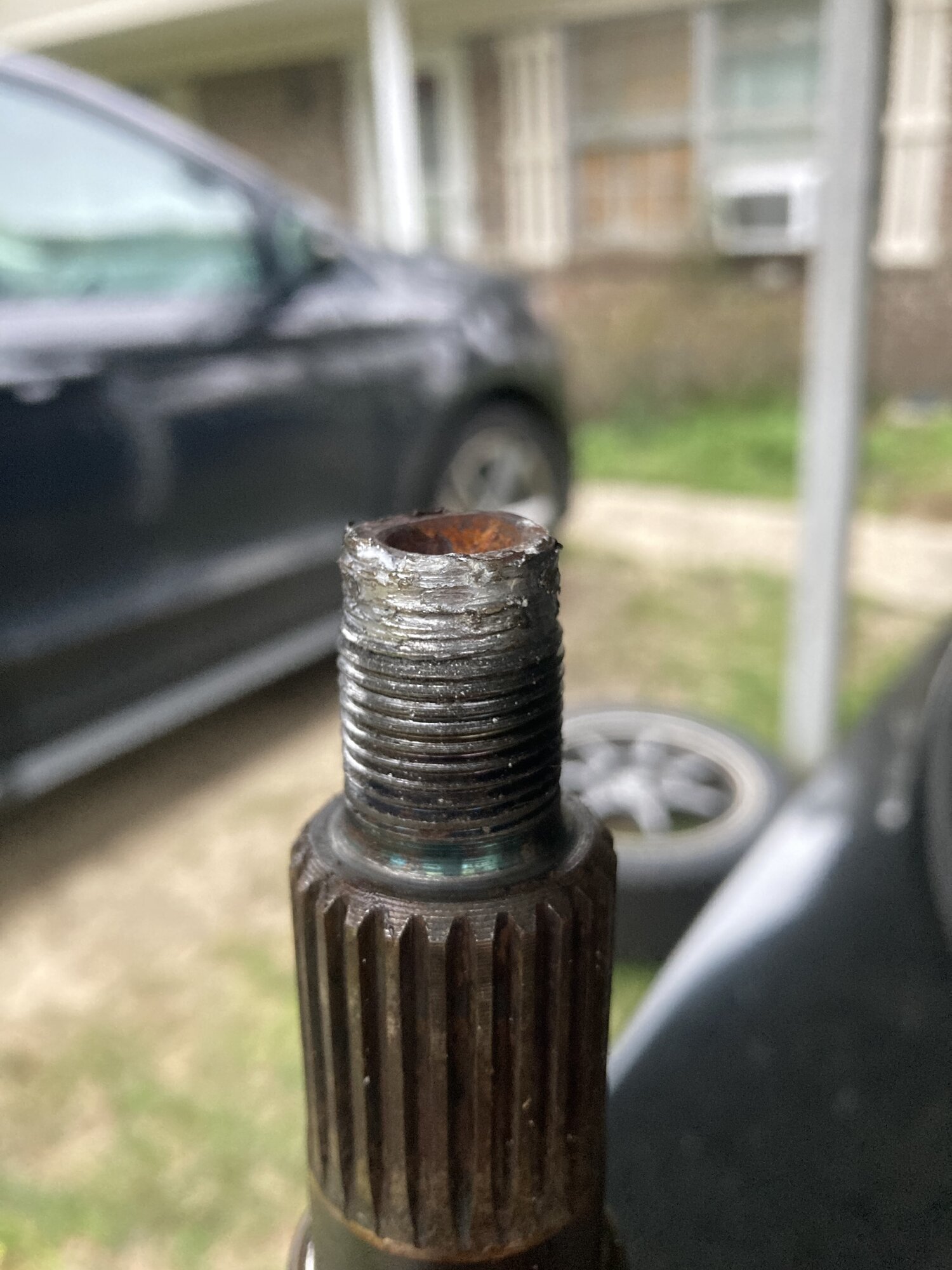

When you have a goal you want to achieve, getting slowed down with a repair is frustrating. IMO - finding this in the garage is your best outcome. Add it to the list. What you don't want to do is stop looking. Don't put blinders on to avoid repair work.
That's true.
The silver lining to this cloud, is that when I did get it out...the bearing has all kinds of dirt contamination inside of it. It's gritty feeling and there's dirt in the grease that was put around it. The dust shield on the hub side is dented inwards, so it wasn't shielding anything. So I guess that's good news because it was either the problem, or was going to BE a problem.
I've bought a replacement hub shaft already. I have another one on the parts car too. We'll see how tomorrow turns out and what I do. I have a local friend who has the ball joint press kit I need, and I may rip off one of the parts cars hub shaft and get it done. I also might not, we'll see.
