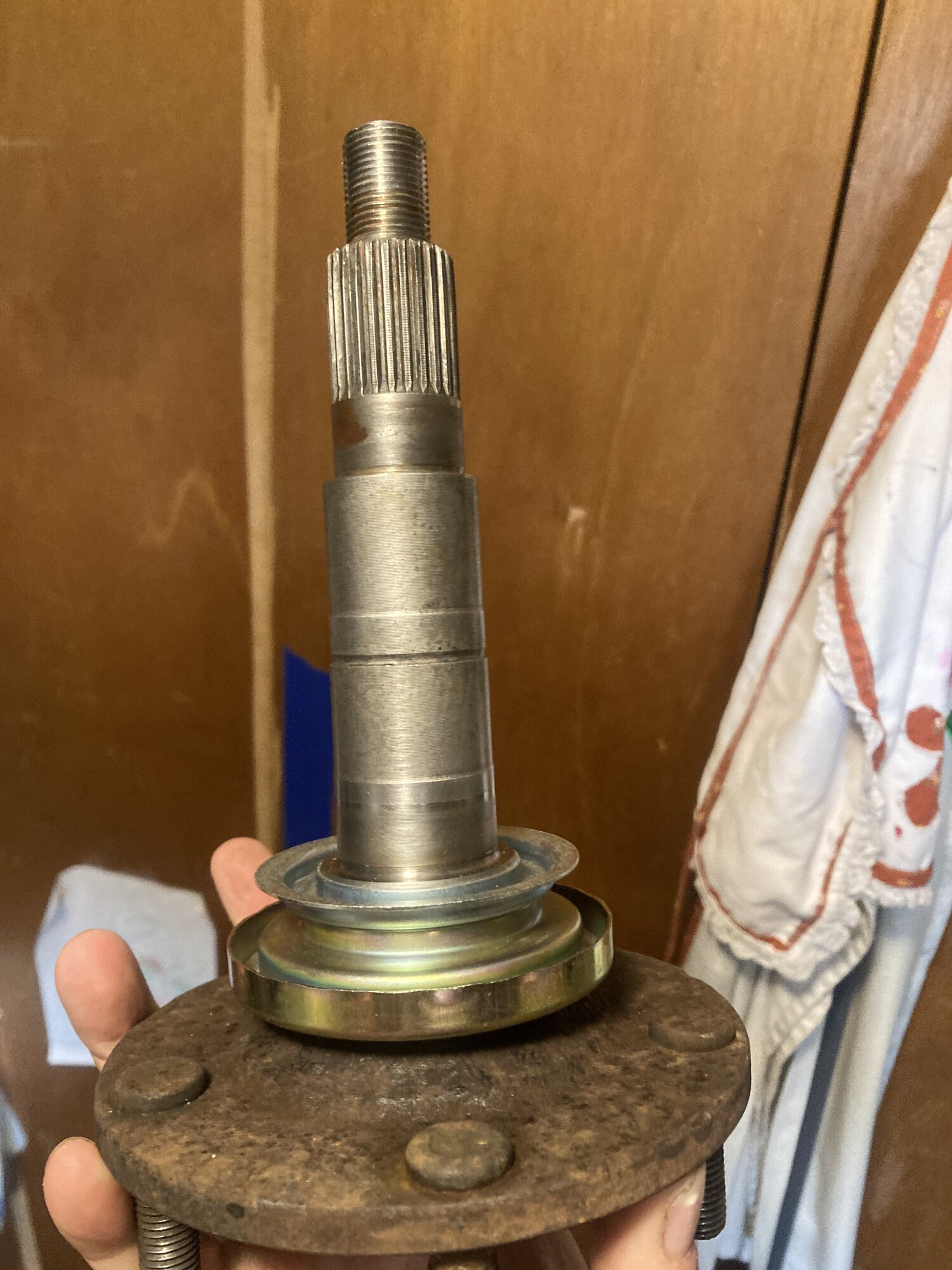

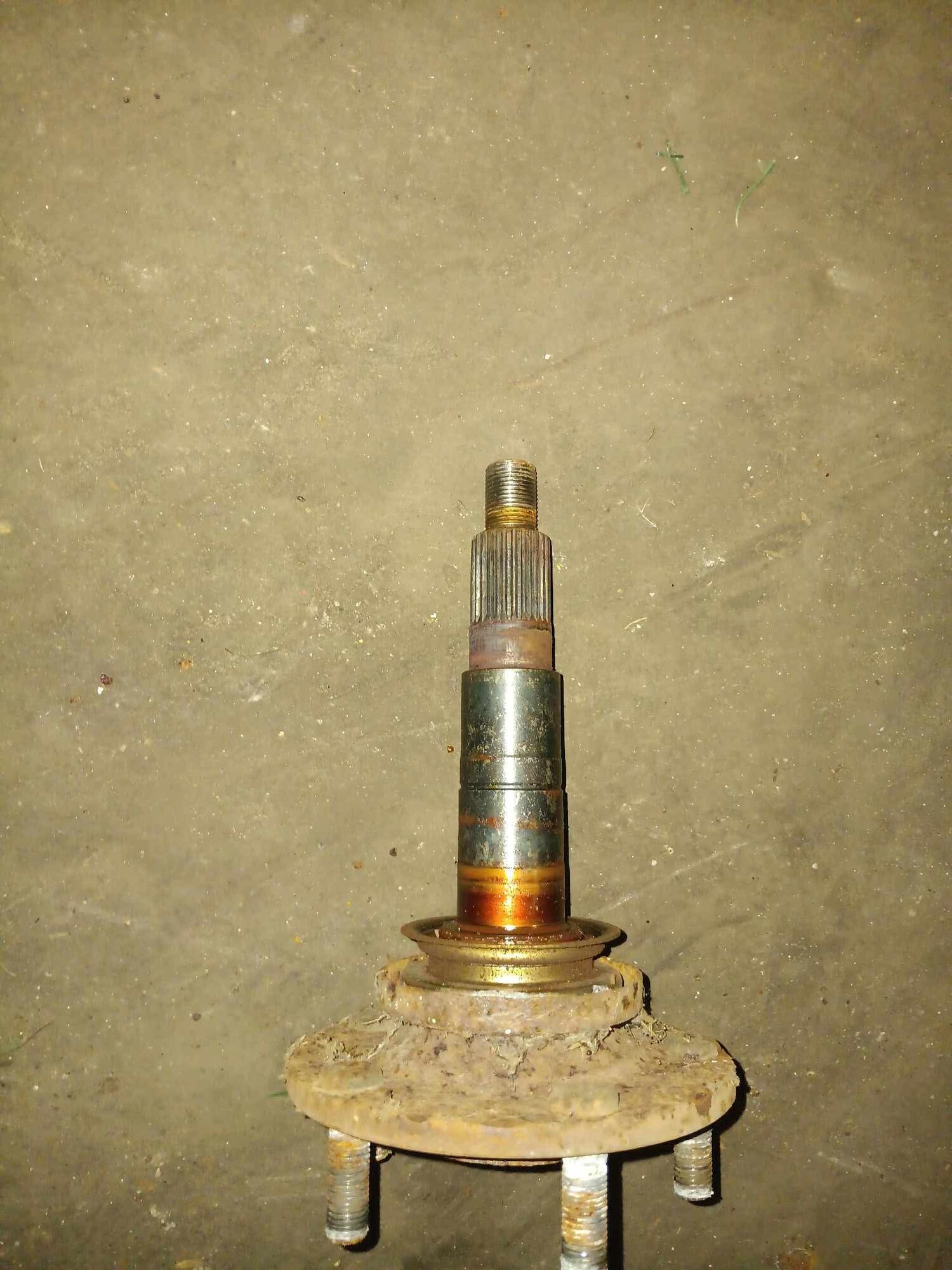

Yay! Boy this thing is dirty and has a little surface rust. Let’s fix that shall we?
Ah. Much better. OEM dust shields on and ready to receive those new bearings. Threads all chased and looking pretty. Now you’re ready for your new home.
Waiting on my tie rod boots so progress is at a halt. Plus it’s 80* here and humid AF. I despise living here, man. Fires of hades for 11 months out of the year and the one cold month you get is rainy so you can’t even enjoy the cold weather.

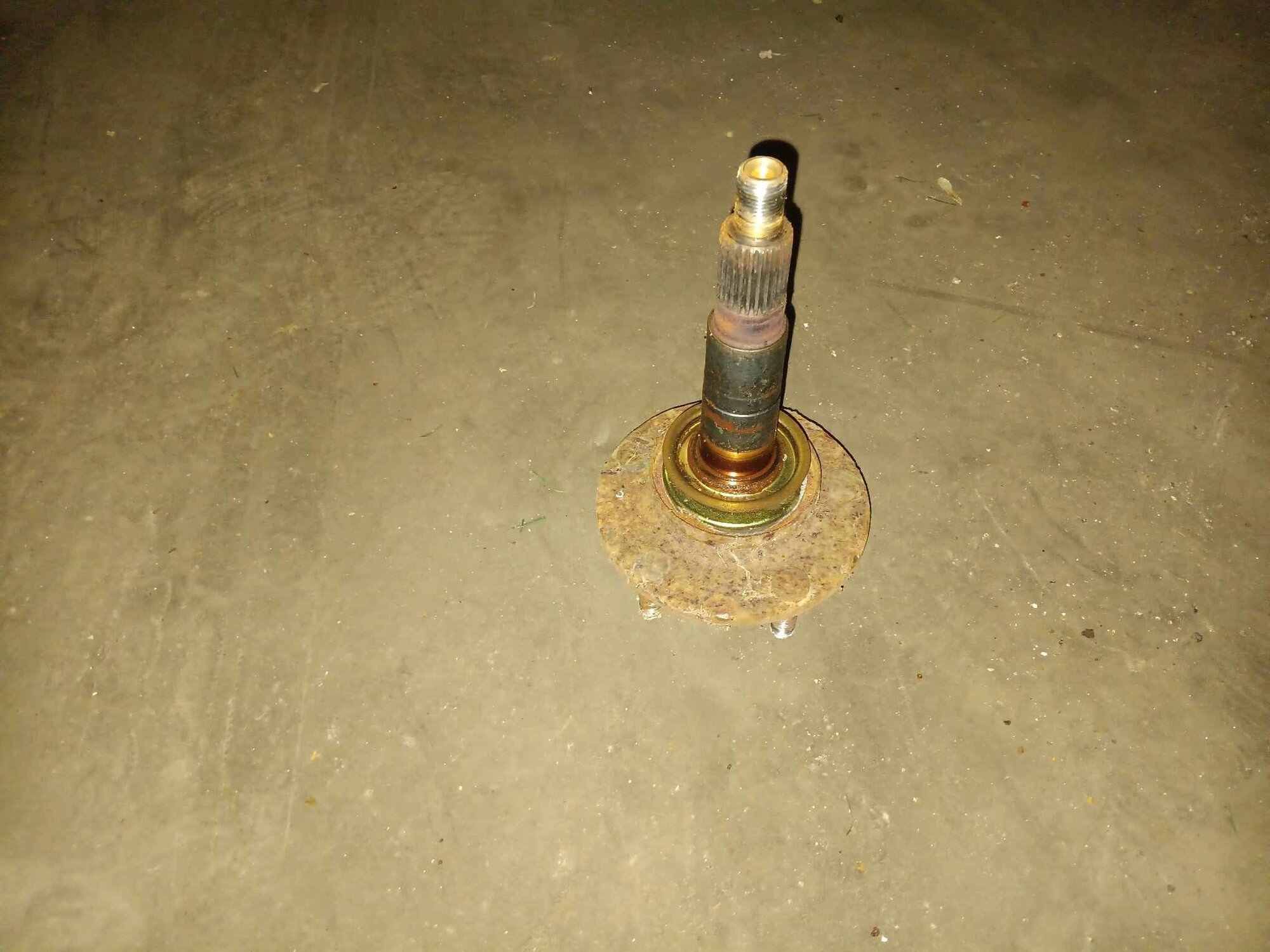

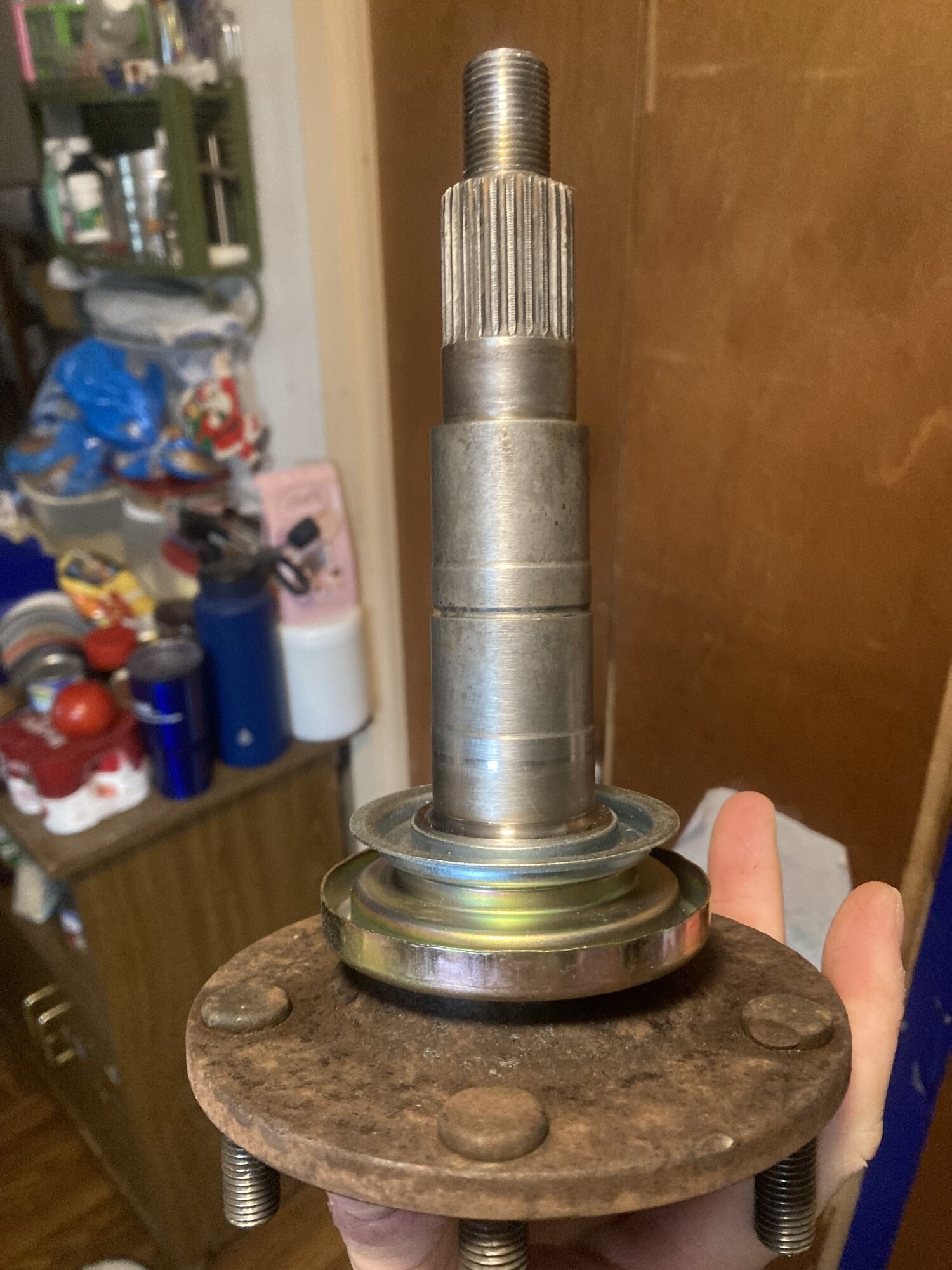

Anyway, I got the rear wheel bearings all assembled and the hubs pressed in nice and neat. Everything torqued to spec and ready to go for whenever I feel up to putting the rear brakes and wheels on.

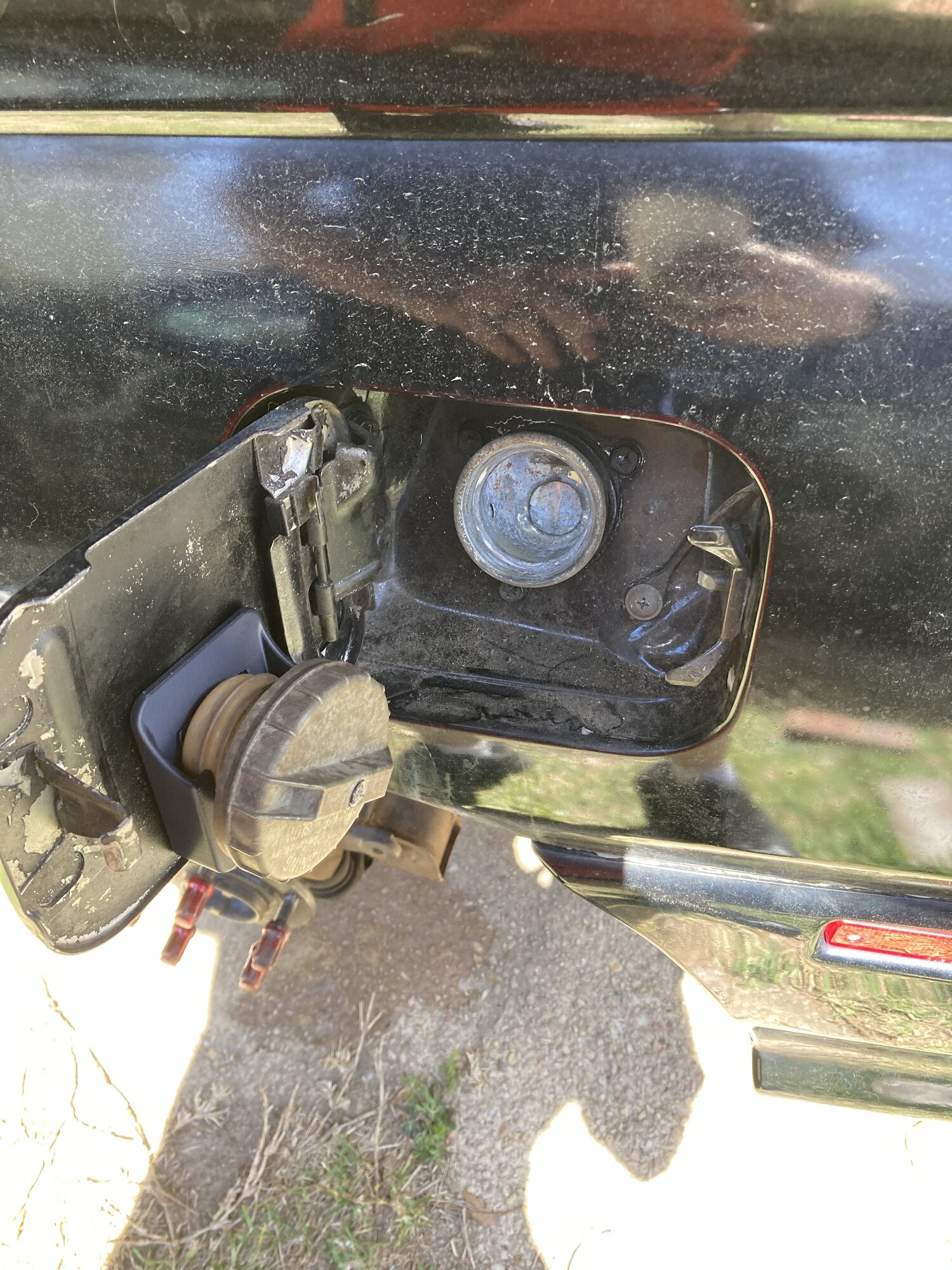

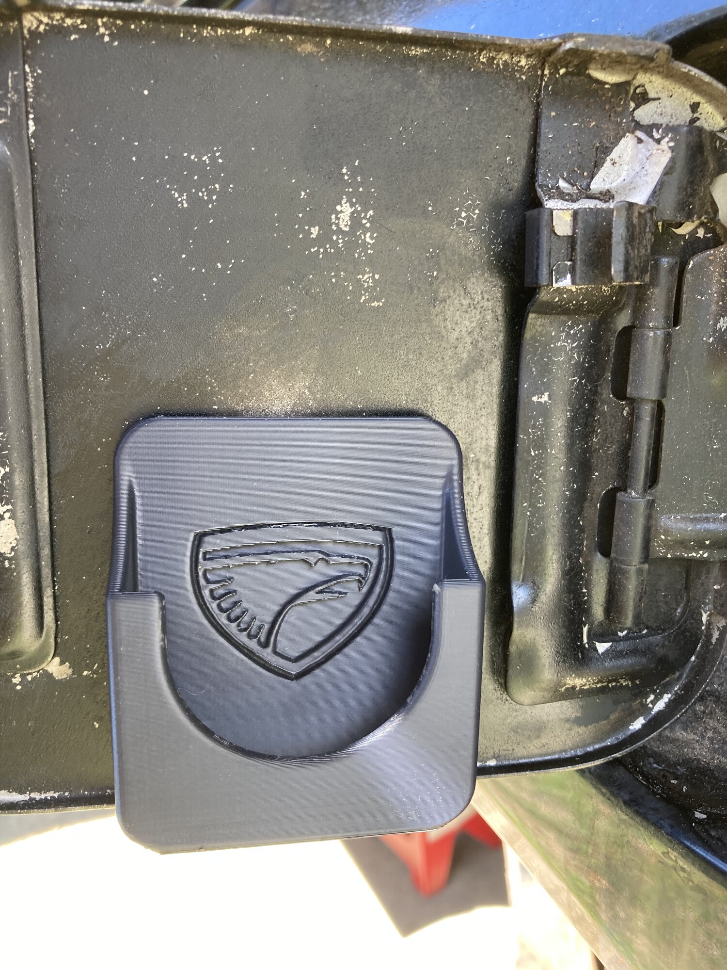

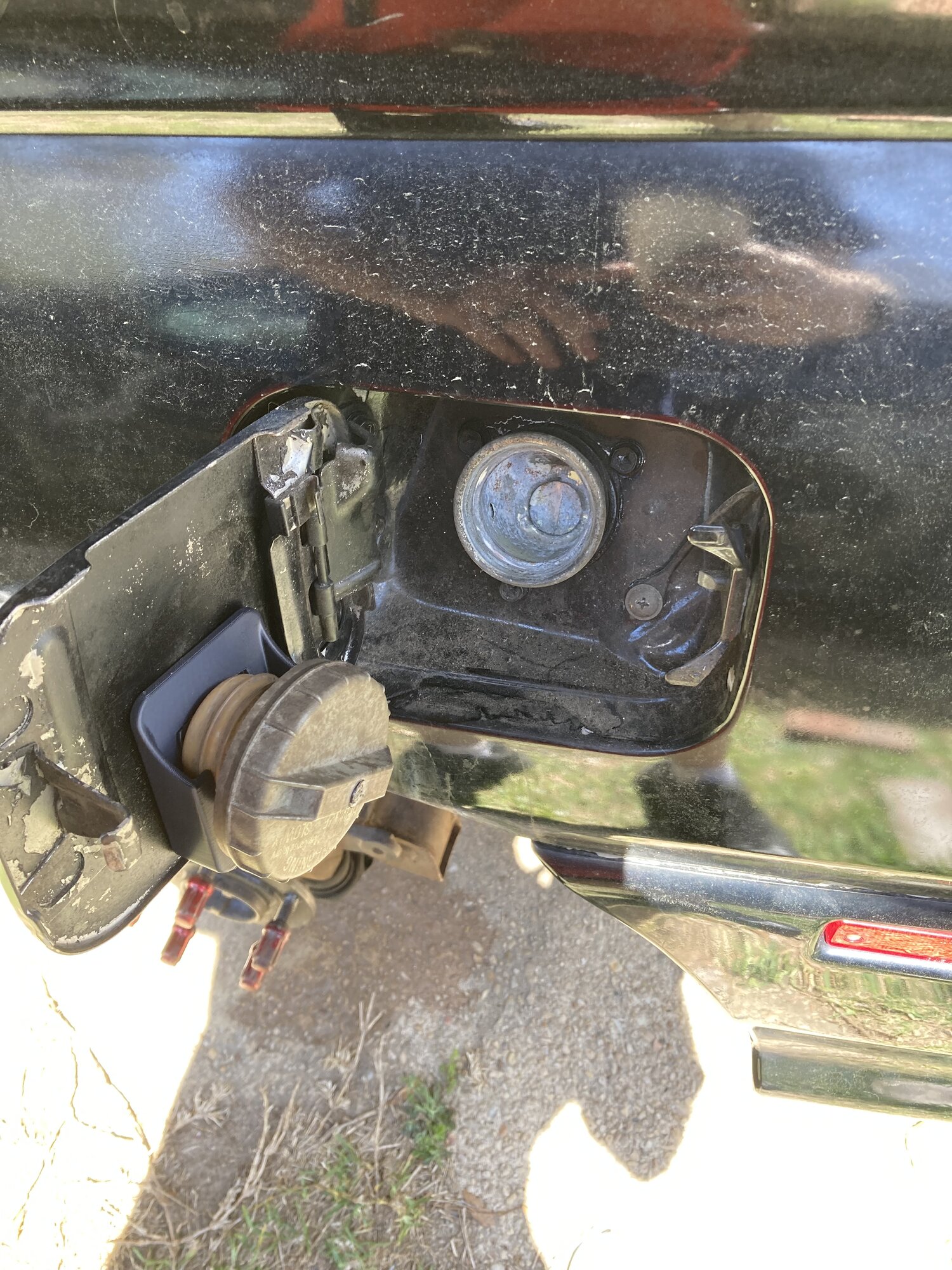

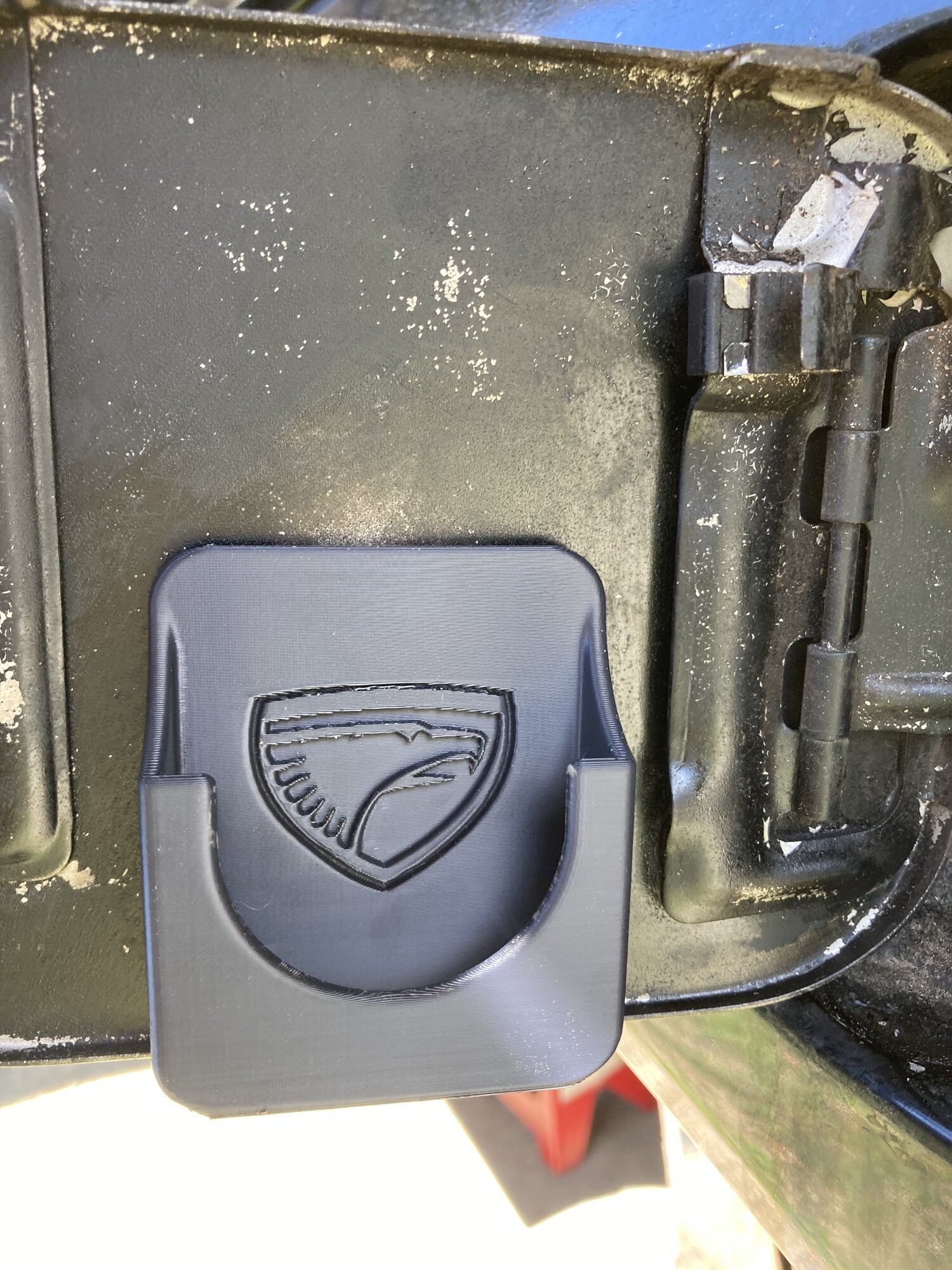

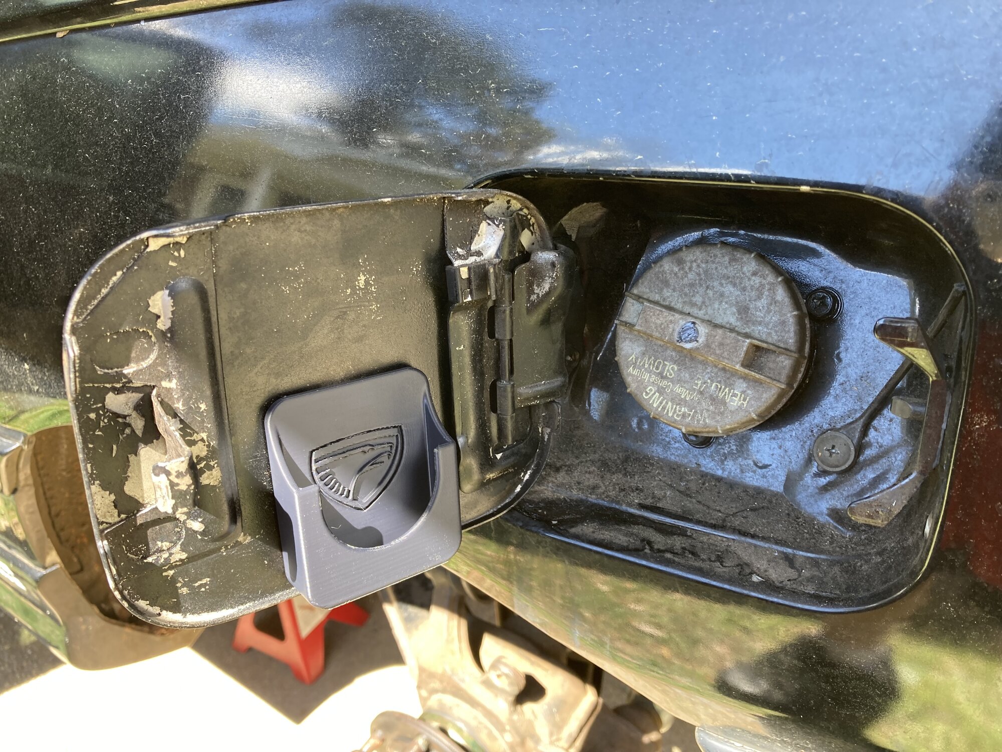

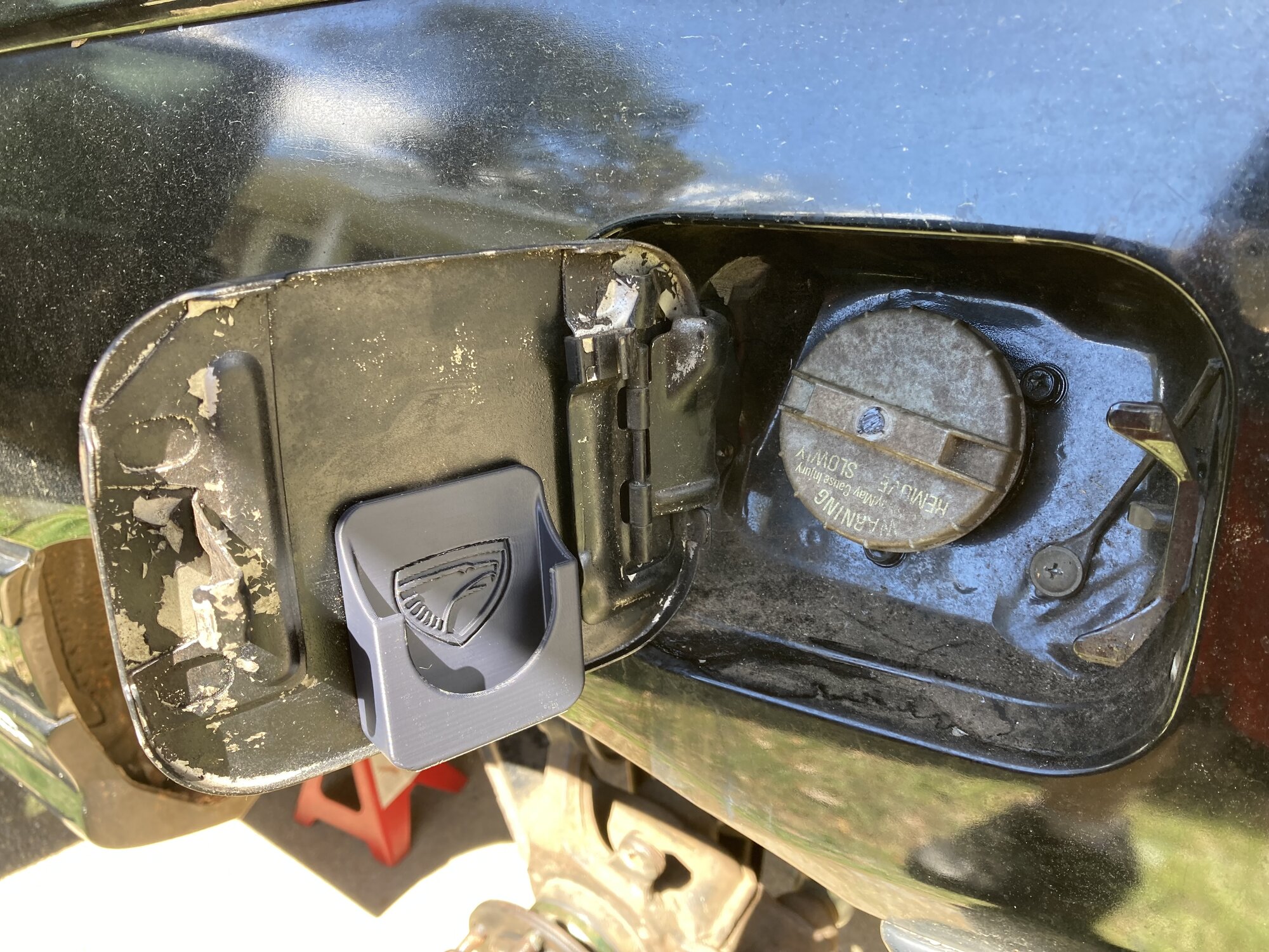

I also bought one of these things on Facebook.
My cap has long had the little anchor broken off and saw a dude on FB advertising one of these pieces. At first it was only a Mitsubishi symbol but I reached out and asked if he could make one with an eagle symbol. He obliged and that’s the finished product. Very pleased with fitment and how it looks too. Was only like $25 too I think.
View attachment 760122View attachment 760120
That's pretty neat.
I just bought a AutoZone special that had an anchor LOL
That's pretty neat.
Honestly I’ll end up doing that too, but I just wanted this. It’s the inner child’s ricer that lives in me.

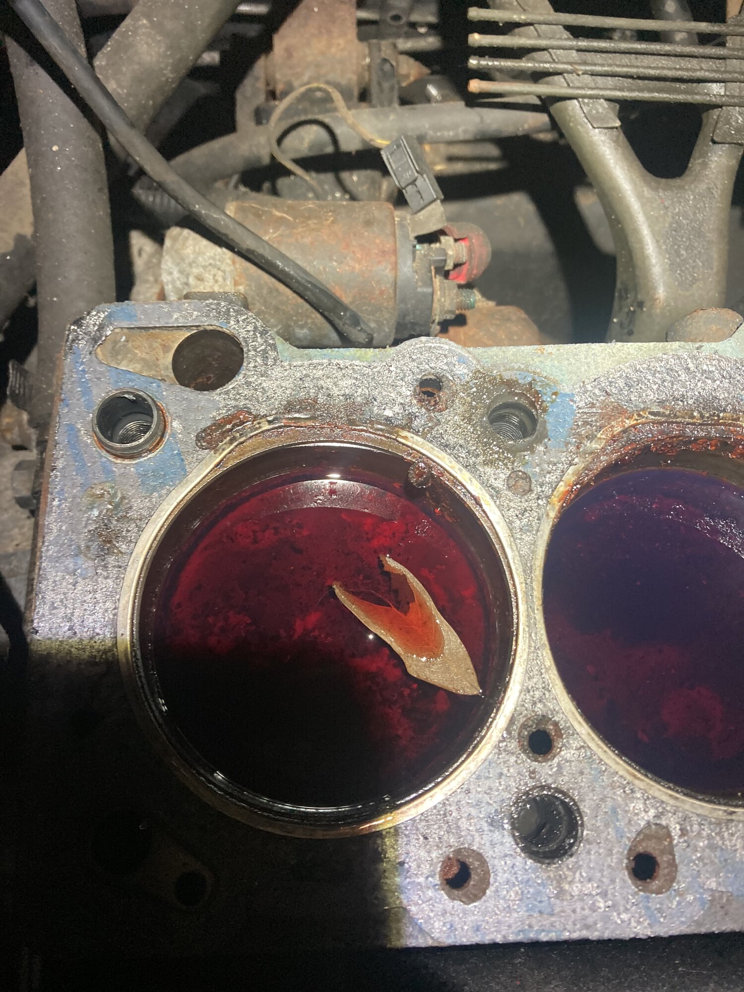

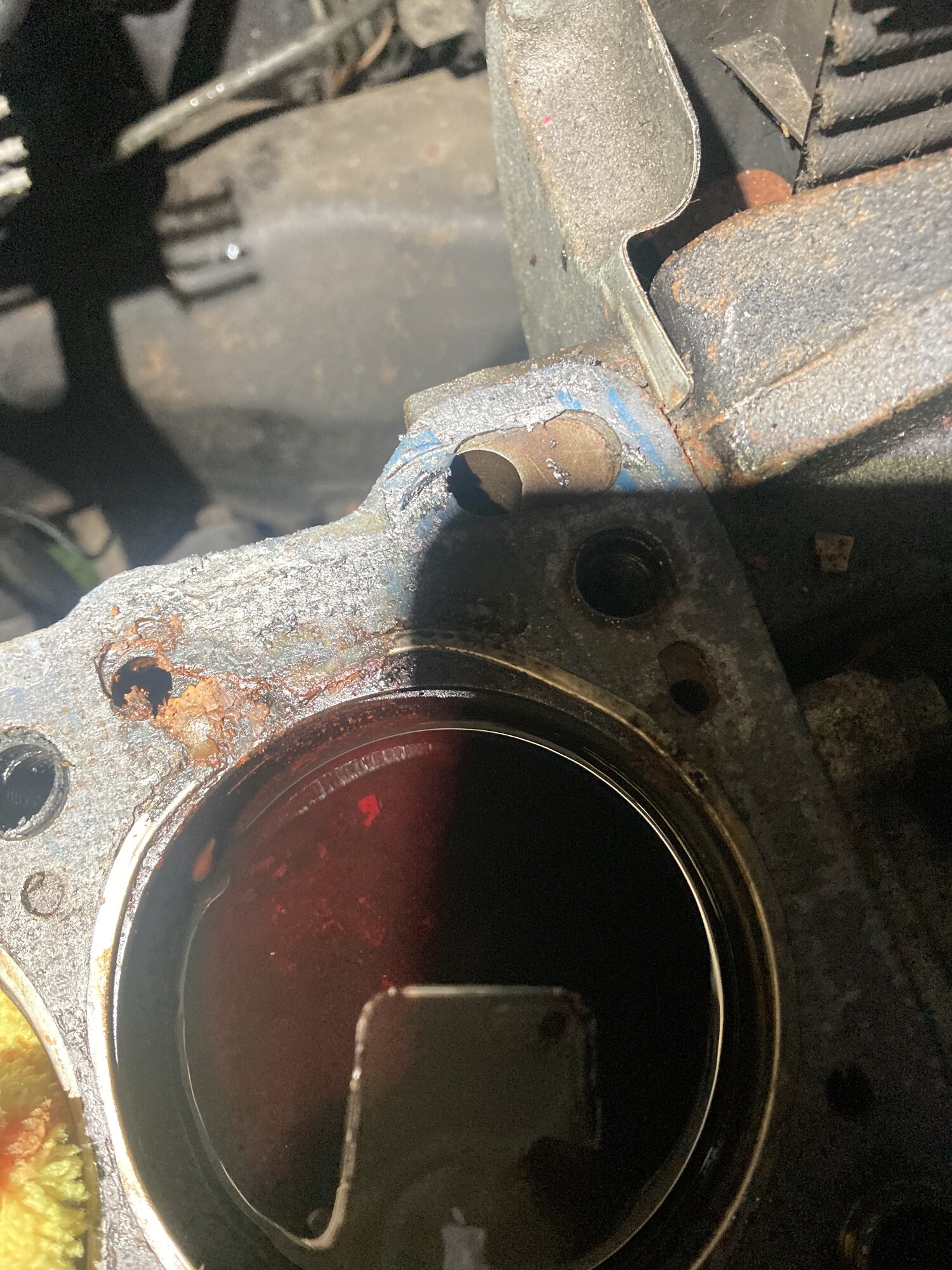

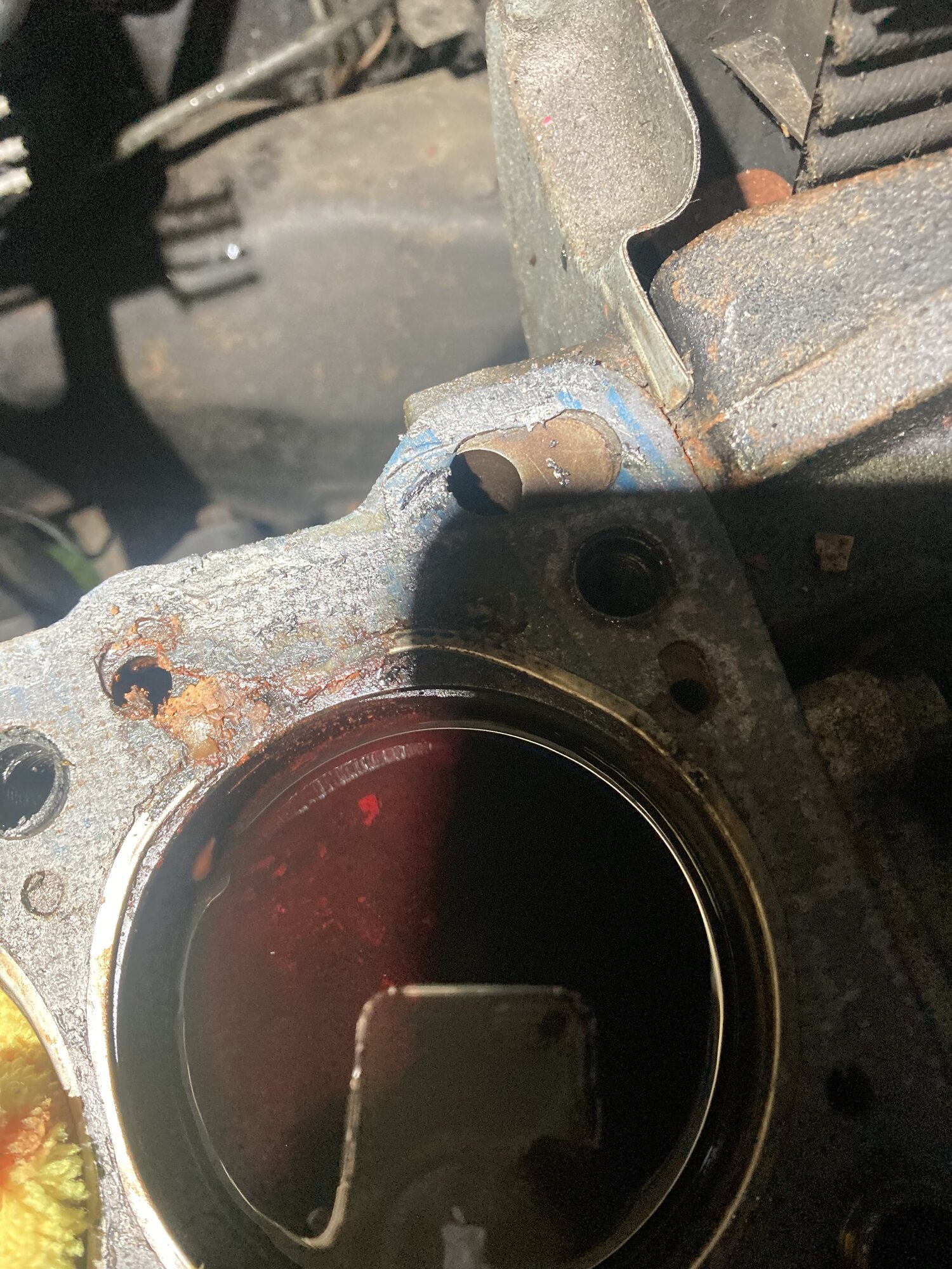

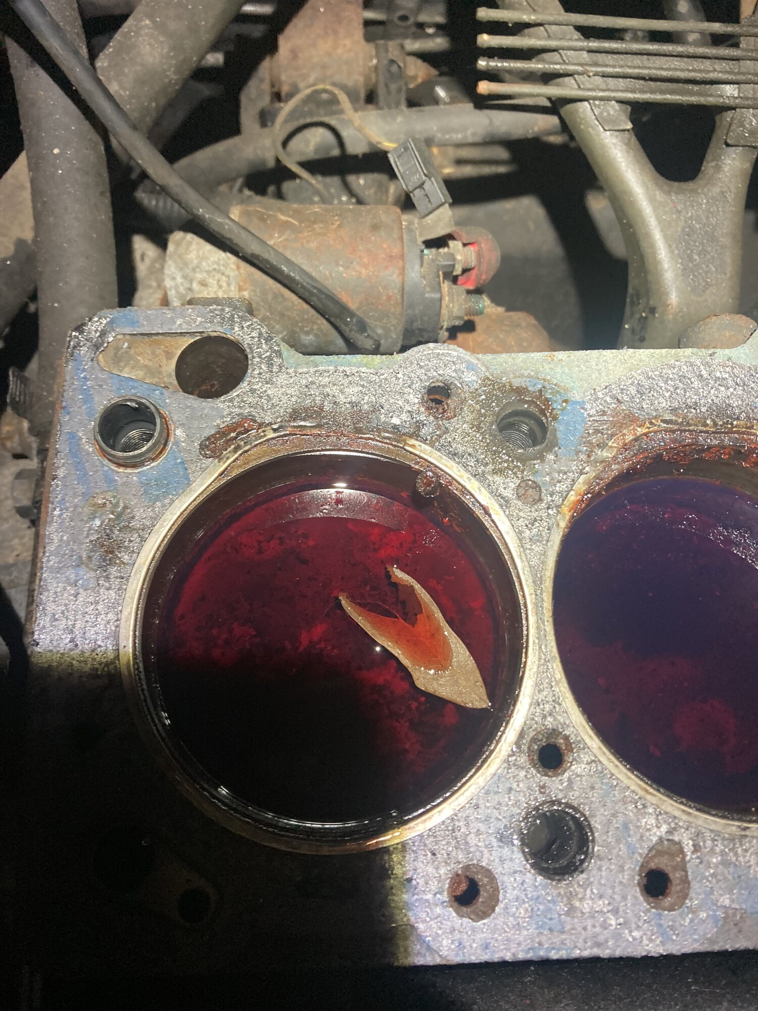

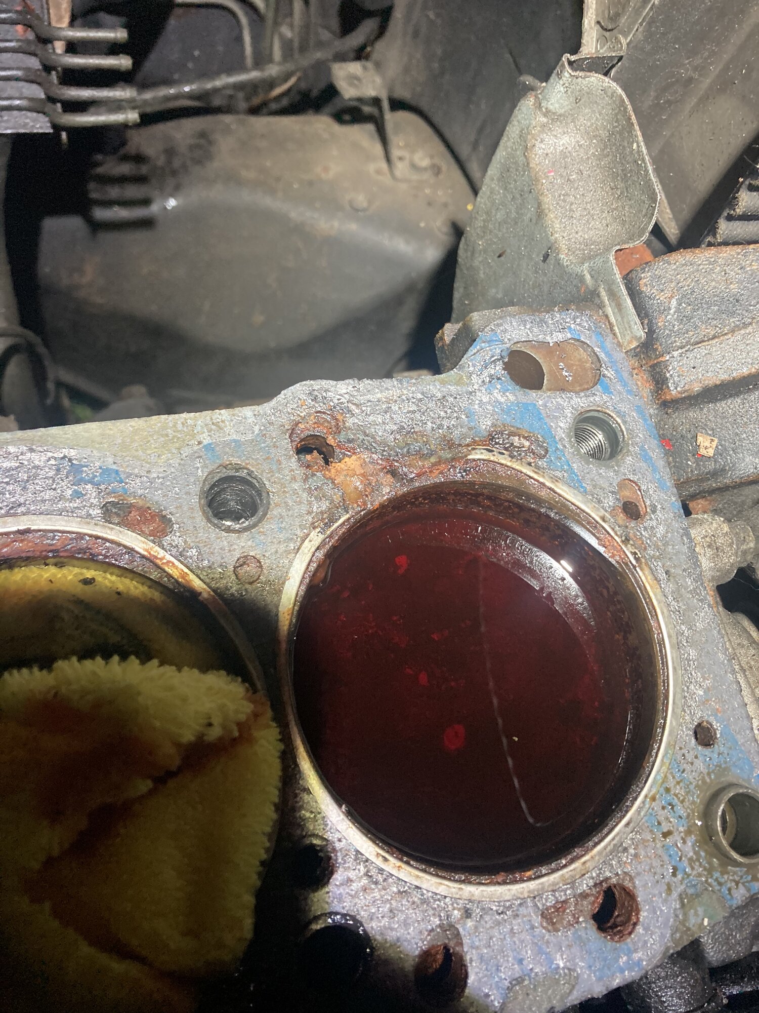

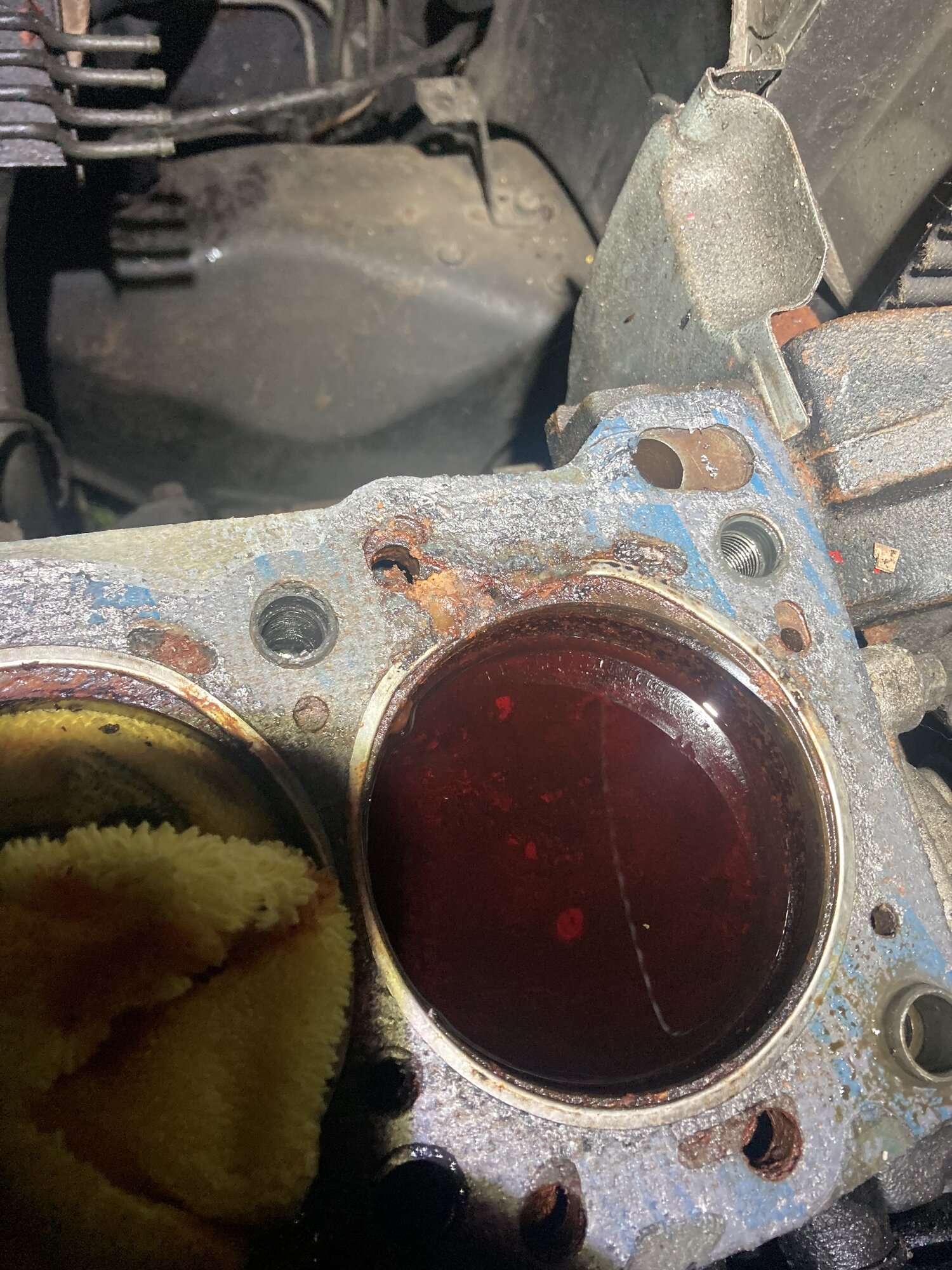

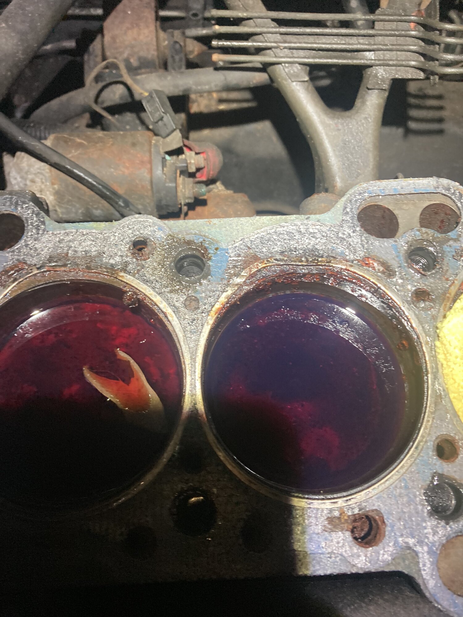

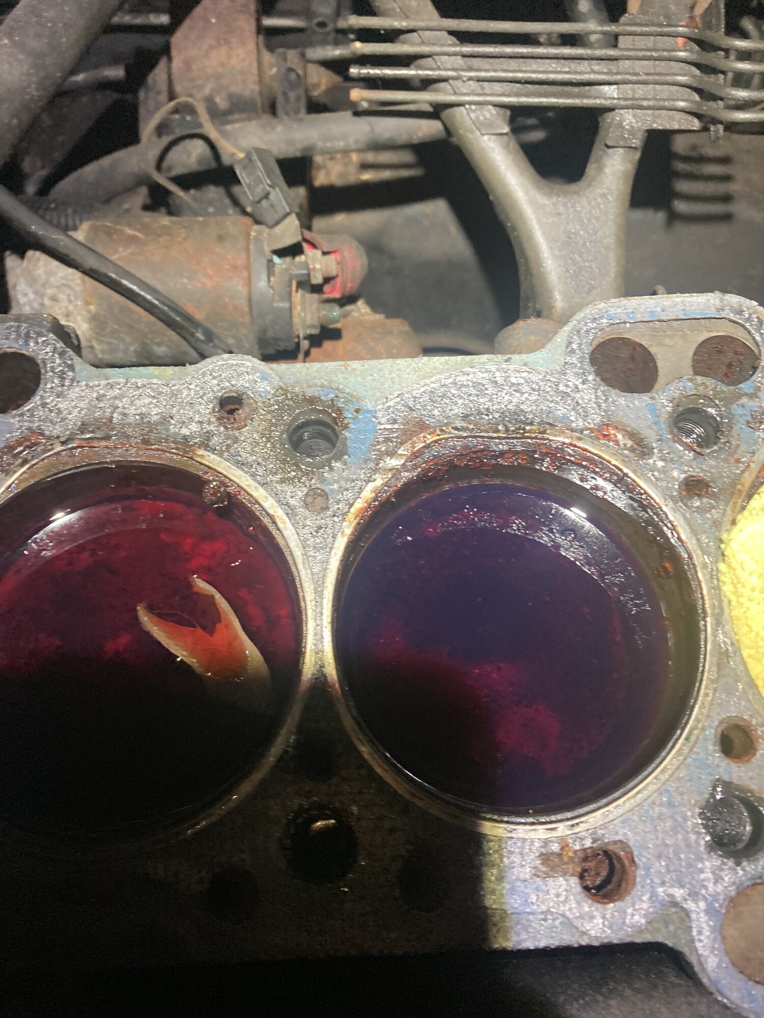

Finally yanked the head off of this parts talon. Found the interesting stuff by the boat loads.
Someone blew the SHIT out of this head gasket. Cylinder 1 is the most egregious as you can see the clear channel between the cylinder and coolant passage. But all the other cylinders just look at their fire rings.
Also discovered these are non turbo pistons. Might explain why the HG absolutely obliterated itself. The cylinders chock full of ATF made me laugh.
But yeah this car was kinda a bust. The engine is stock and blown, cams are stock, the head has two bent valves. The 14B turbo I thought had no shaft play is just REALLY locked up. Lol. At this point I think the only valuable thing from the car is the transmission and some various little interior parts. Possibly the wheels too.
But yeah. Next I’ll drop the oil pan and check the bottom end carnage. Very curious and anxious now to dig further into the transmission too.
View attachment 760719View attachment 760720

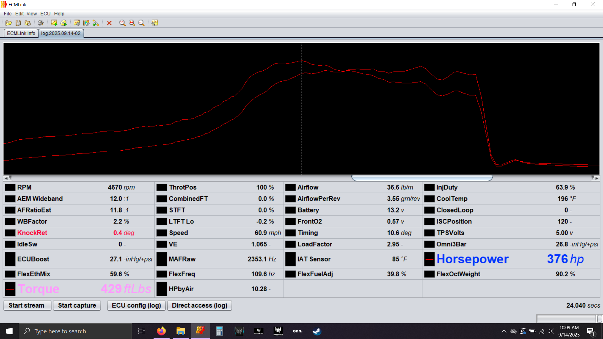

I'm on the fence right now on whether to switch to e85 or stay with 91. If my turbo isn't big enough to take full advantage is it even worth the switch?
How much timing? Yes.
Lol seriously, I put 42 psi through one of those gaskets and it didn't push that much.
My car just sits in the garage and springs leaks left and right and it hasn't really been driven at all. It's pretty sad when I find more joy wrenching and making it look good over driving these days. Maybe because the anger and frustration has been long gone for years now. I'll be a guys punching bag if you ever need one.
You get more bottom end power with E85 - not just top end. The lack of knock provides for a really different tuning experience - There is a learning curve, but nothing you can't handle. There is a new cold start behavior - it cranks longer before it finally catches on. After the initial warmup, it starts like normal gasoline. The only other thing to note is the miles per gallon is quite a bit less. If driving range is important, you should look at the difference, cause E85 is harder to find.
You can always switch back.
So the only real draw backs are availability and mpg? So if a guy were running a 16g, would it still be worth it to you? This is the last big hurdle I'm trying to overcome at the moment.
