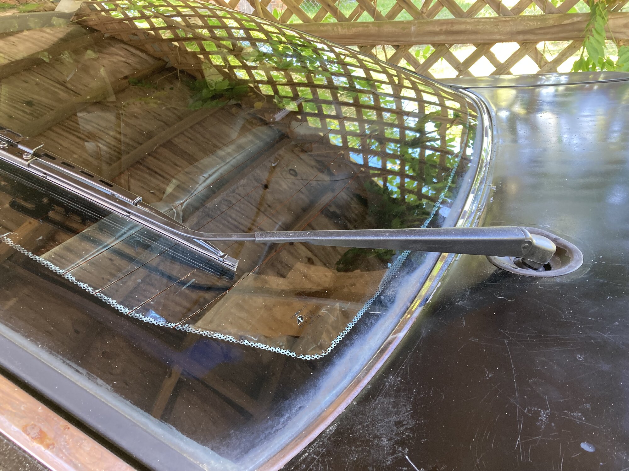

Finally got around to doing this.

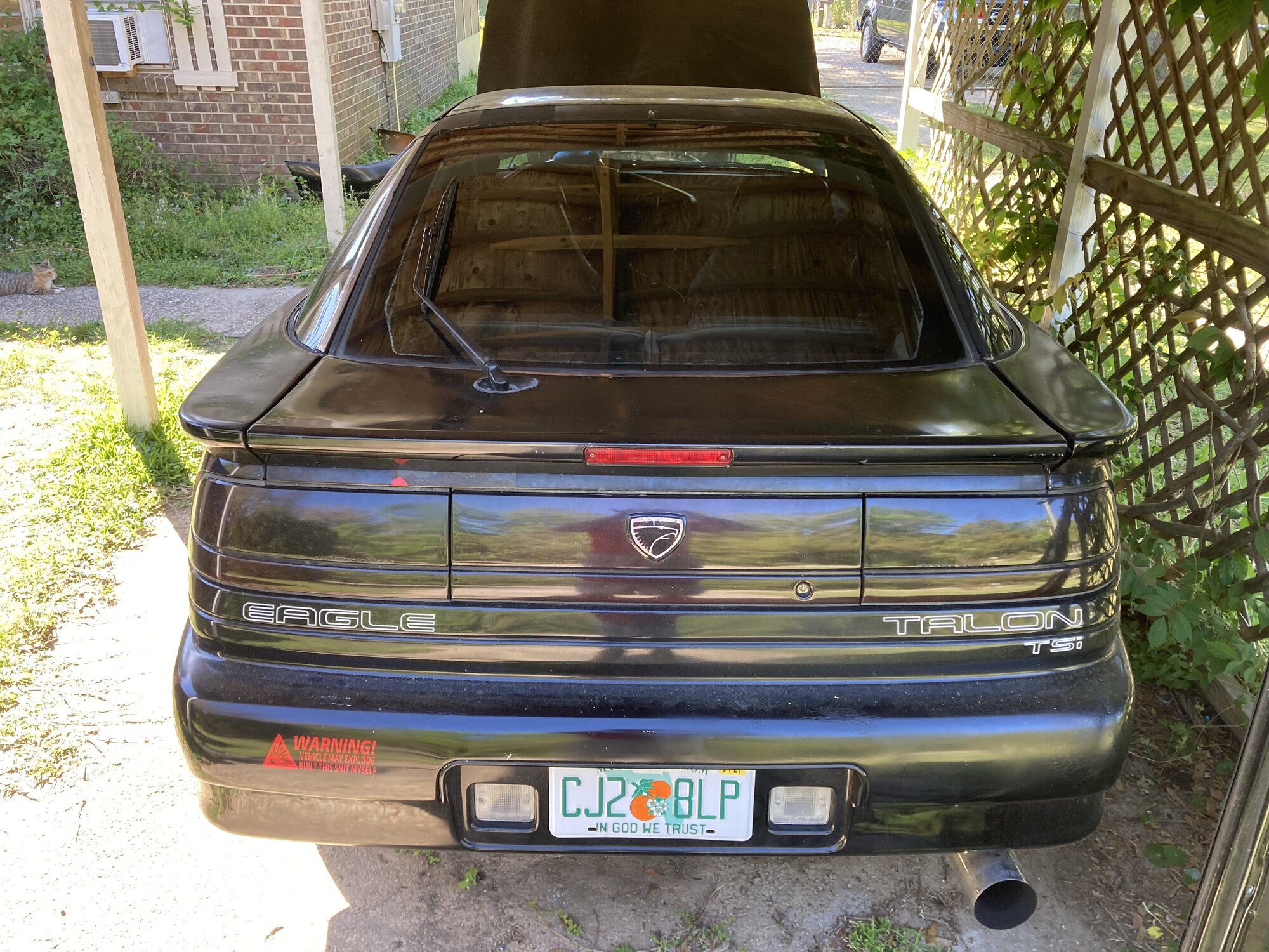

Rear wiper un-delete!! So happy with how this turned out. It was an absolute BEYOTCH because they patched the wiper hole with what seemed like concrete and fibreglass mixed. It was insane. I went and bought a Dremel just for this, and it exploded like six cutting wheels before I got it out.
But, it’s on and functioning. As an added bonus, I got rid of the flaking hazy tint too. So the window is crystal clear now. Woot!

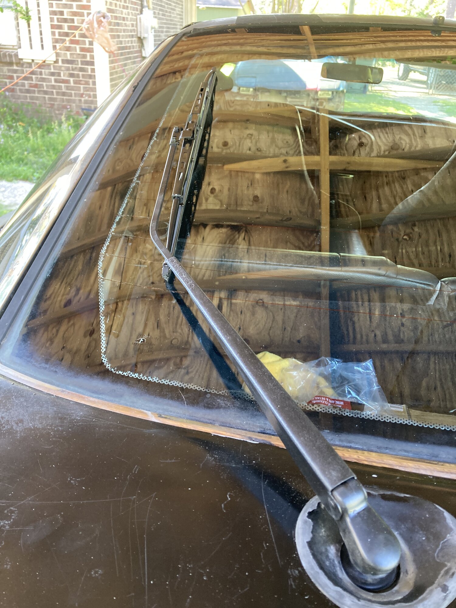

Here’s how the wiper arm itself turned out. Plastidip ftw!

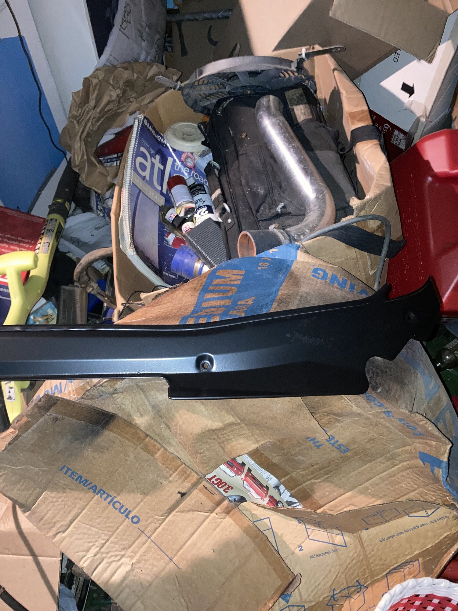

Also: currently plasti-dipping my spare wiper cowl. I think it’s gonna turn out great. Very excited to swap out the one that's faded and rusty. I've been wanting to do this for awhile because it always bugged me when I noticed it.

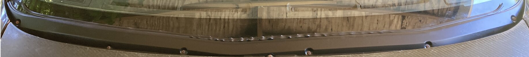

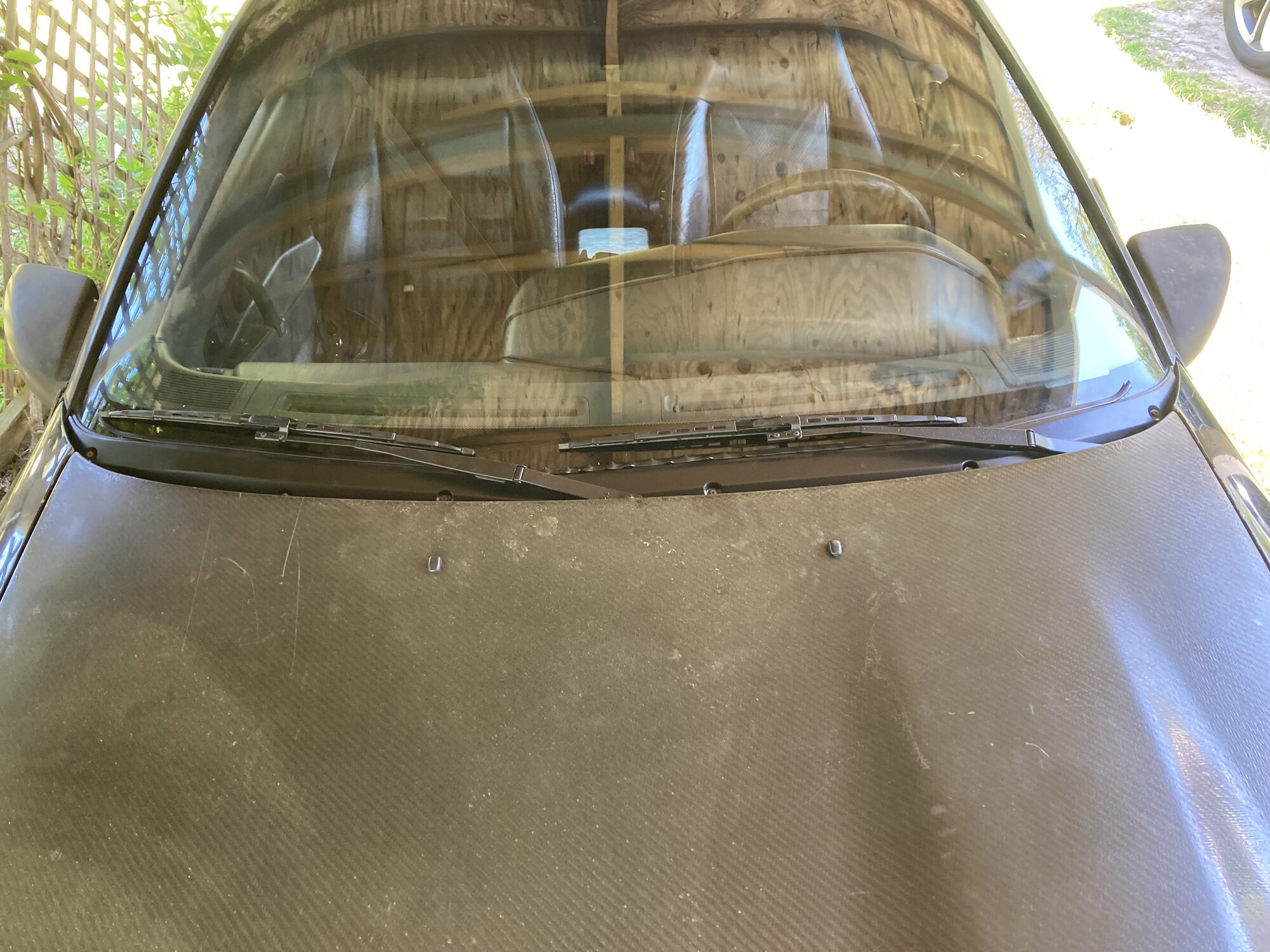

How it appears on camera is how it’s gonna stay looking. The hood hides a lot, but those aren’t blemishes in the paint, they’re blemishes on the cowl itself. I didn’t want to go full crazy and sand it smooth so I legit just cleaned it and coated it.
It’ll look amazing hidden by the hood and the wipers. Much better than before.

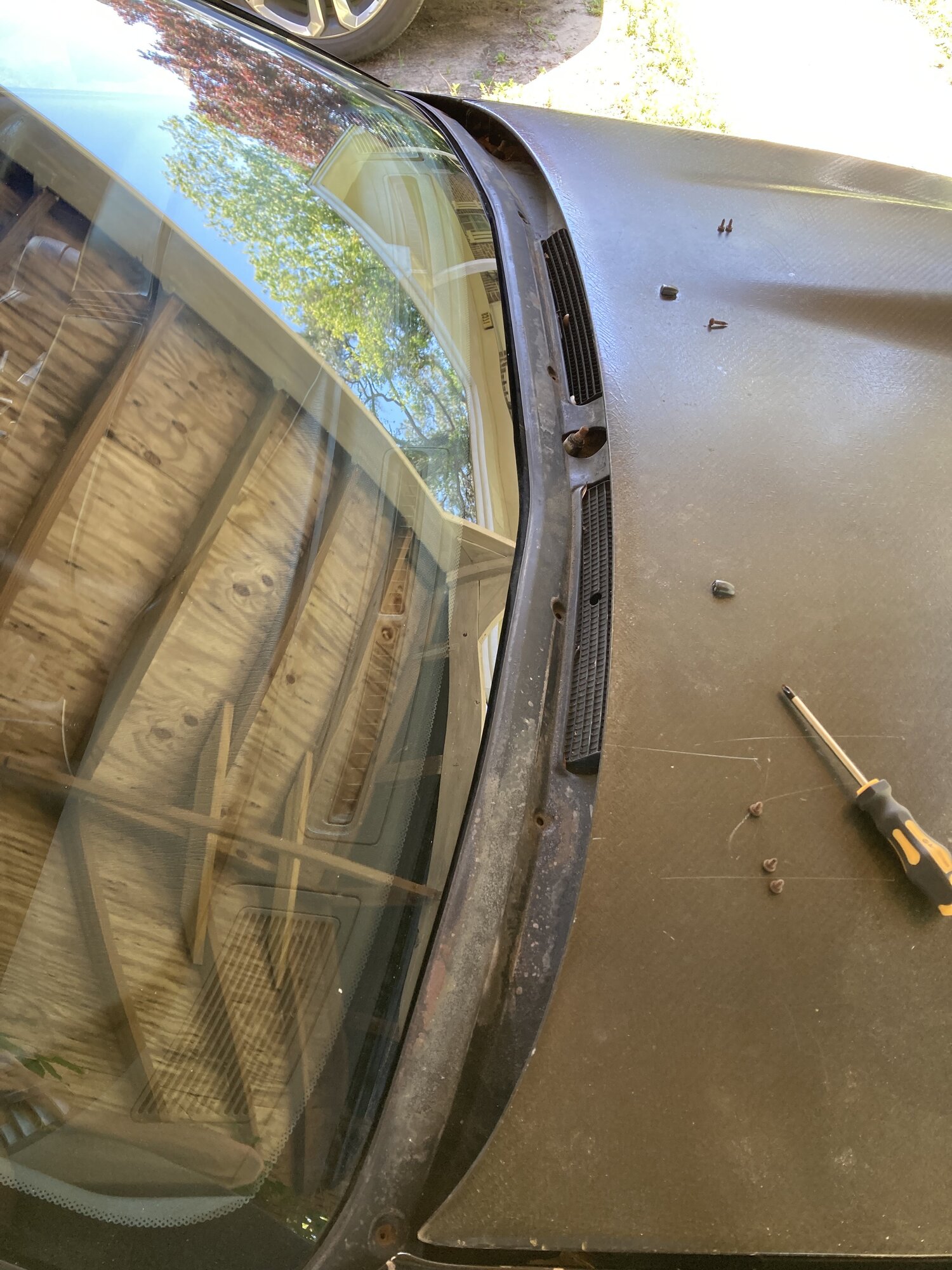

You can kind of see it before here.
Stoked! Next up is painted and fixing all the rusty things in the engine bay and making them look new.

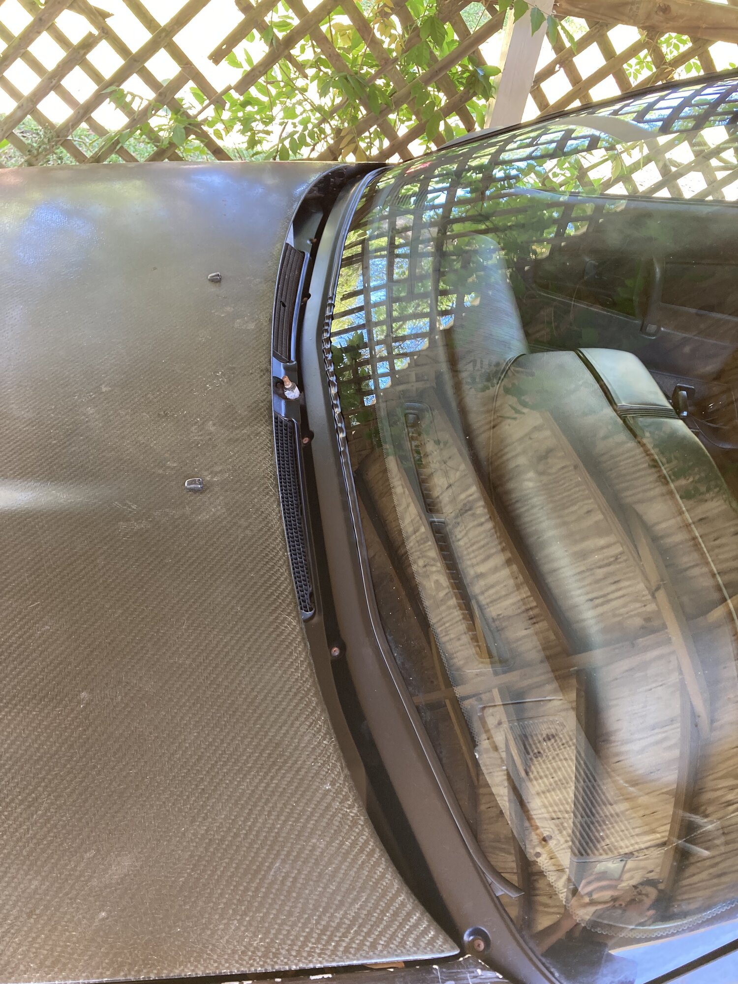

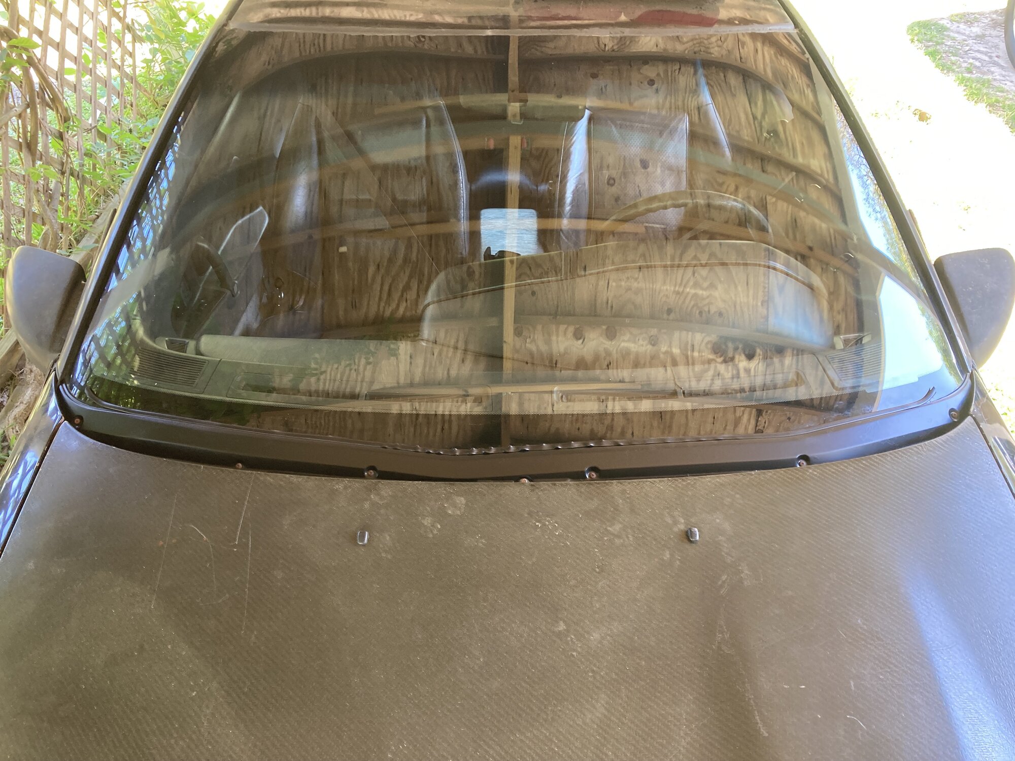

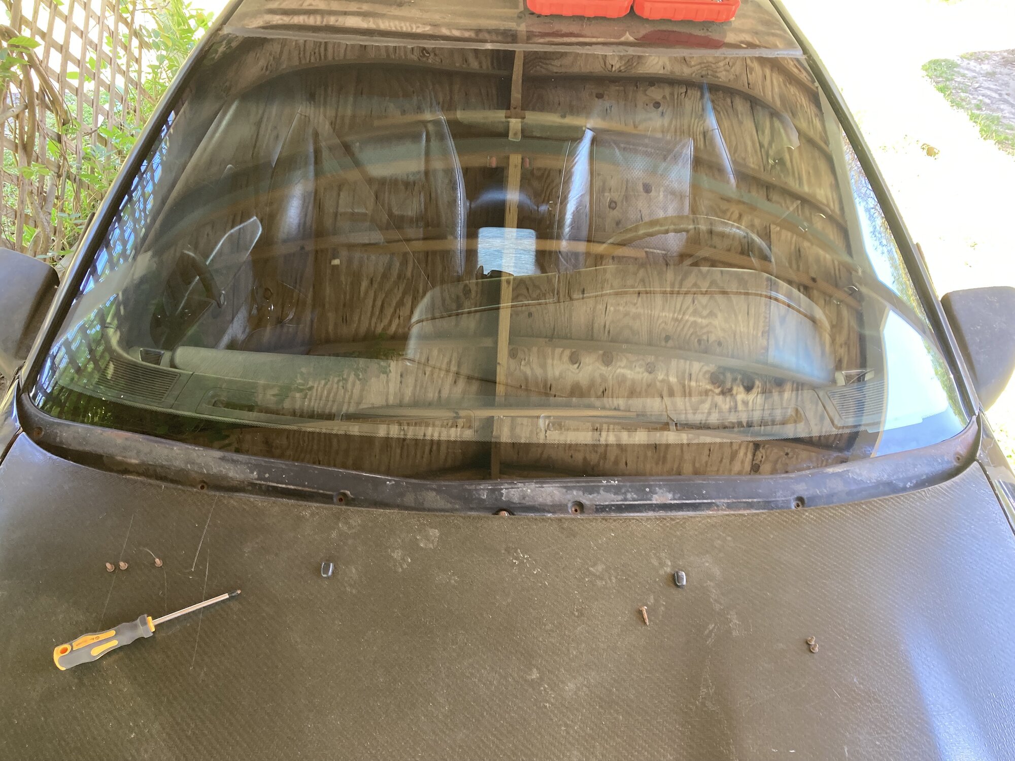

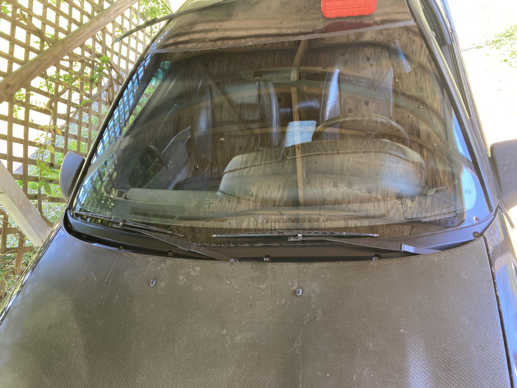

Alright, installed the cowl today and man it turned out awesome. It looks so much better.
Before
After! :D
It looks brand new. And I've plasti-dipped wiper arms and exterior trim before and it lasts forever, never weathering or fading. It always turns out awesome. While I was there, I took the wiper arms off the parts Talon because they had the "hook" mount for wiper arms, where as these wiper arms had just a stud. So I plasti-dipped those and installed them too.
Not only do they look better, but they sit on the windshield a lot better too. The wipers were suuuuuper slow before, and now they're normal speed. Not struggling at all. I think those "studs" were holding the wipers too tightly to the windshield. Huge difference!

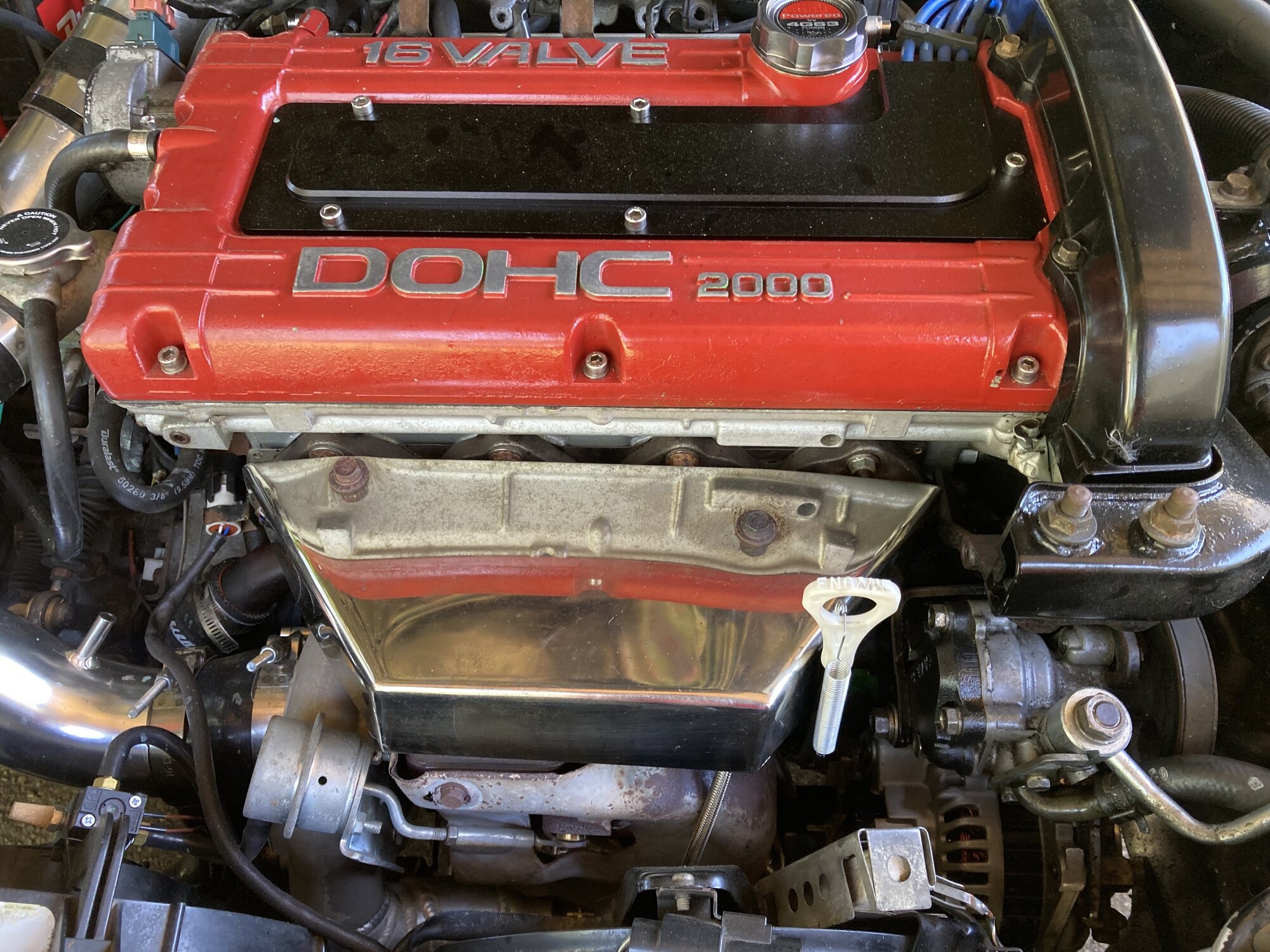

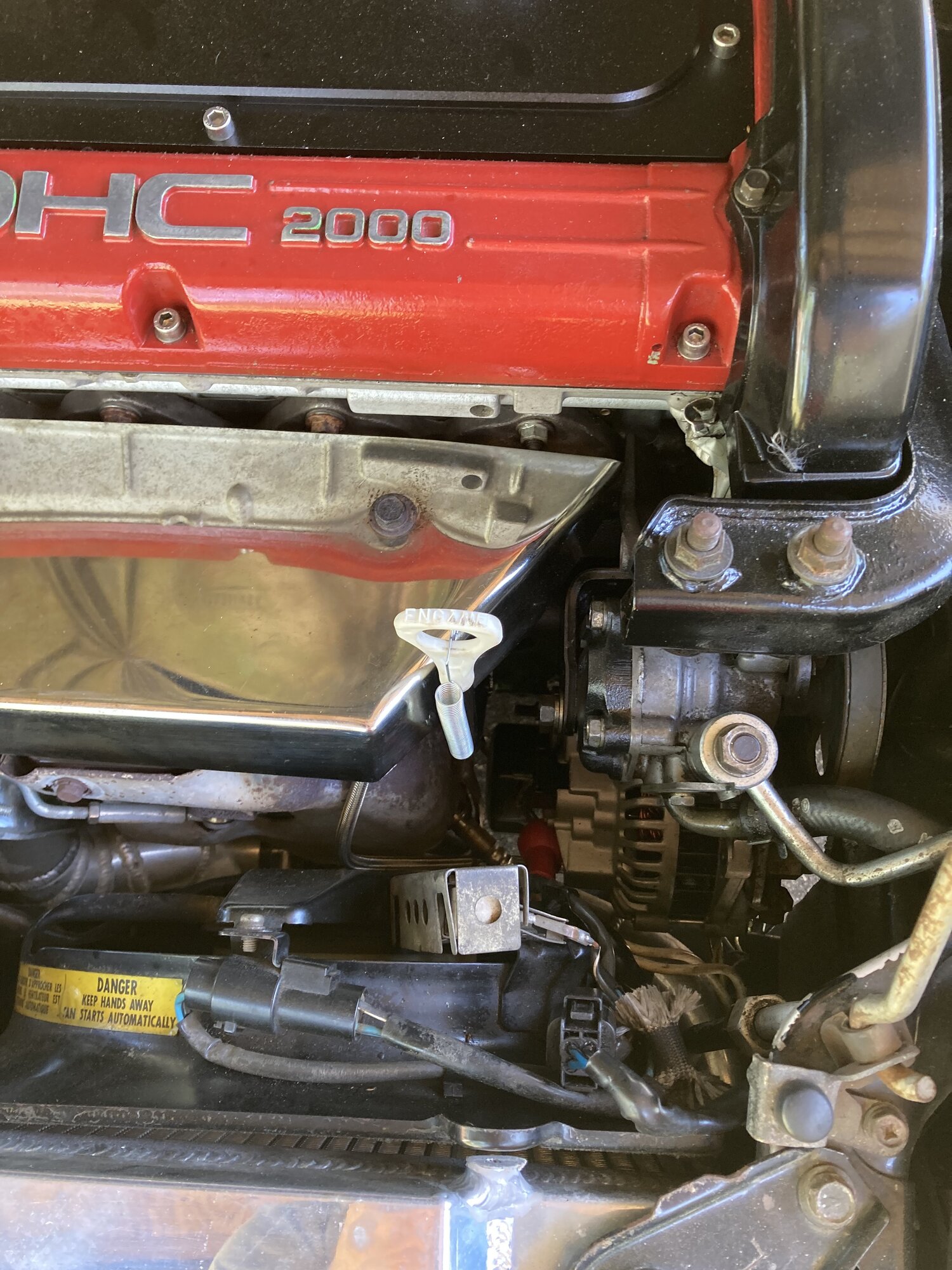

While I was here and messing with things, I went ahead and installed my STM powdercoated/modified new dipstick. It actually didn't go as bad as I thought it would, but you 100% need to remove/strip the powdercoat completely off the bottom tip of the tube, or it interferes with the fit.
However, it looks(and functions) amazing now. Gonna take it for rips later and see if the oil spray is gone.

Dude that rubber seal between your cowl and windshield is ick. Go buy the smallest diameter black rubber vacuum hose you can find on the planet, slice it long like a hotdog bun, and put the metal cowl edge into the slit you cut on the hose.
Nah.
That turned out excellent. I’ll have to pick some up. Did you also plasti-dip the cowl?
Sorry, not trying to hijack
Hijack away. People hijacking the thread have created three really good spinoff threads of information so it doesn’t bug me.
No. I followed the absolute best way to paint plastic guide - using sem trim black , and satin clear topcoat.
I’ve actually heard of the SEM trim black. It looks great.
I am actually planing on painting the wiper arms using SEM Trim Black 49143. Maybe I’ll just do the cowl while I’m at it so it all matches. I’ve used “restore black” type liquids and it makes a big difference, but fades after a few months.
Wiper arms are metal - you can do what I did, and have Rich powder coat them?
Again, plastidip or rustoleoum vinyl wrap matte black work incredible and won’t fade for wiper arms.
