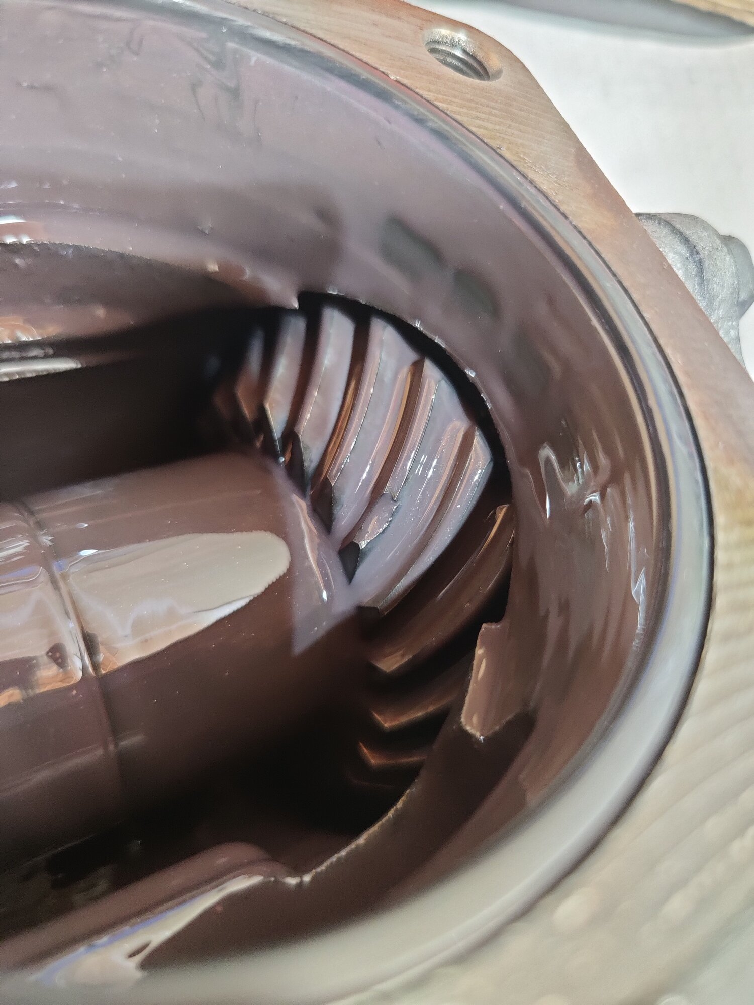

Only reason I can think of why it would stop happening in decel is how the forward facing gear lash fits forwards vs backwards if that makes sense? Here you can see the pinion is slightly "C" shaped. When you let off, it goes away because the backside of the teeth are now getting all the load? This is the t-case pinion.
I don't have any guesses why it would be only 60mph though.
My opinion is either transmission, t-case, or rear diff. I'd start my checking fluid if you haven't already.
