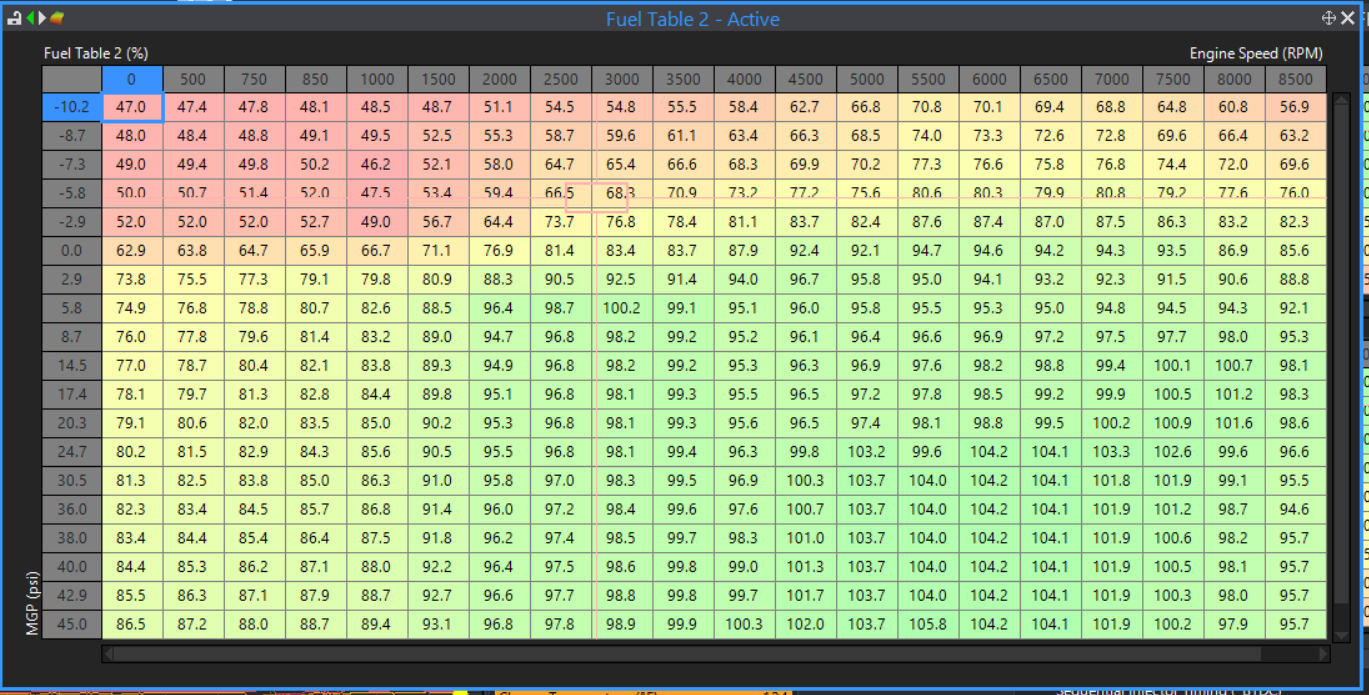

Ill throw this out there too but this is what MY VE table look like in my car with a big turbo and s2 cams. Please dont copy this LOL its obviously going to be different but i just wanted you can see how early my VE jumps to 90+ percent as well. This is on a Link G4+, not ECM link.

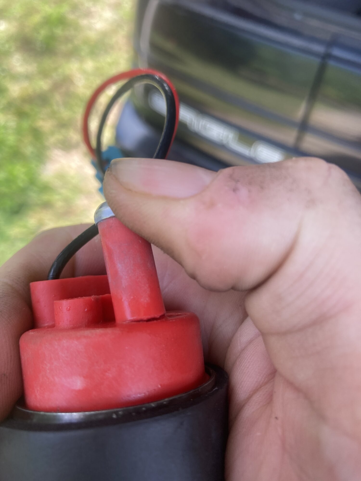

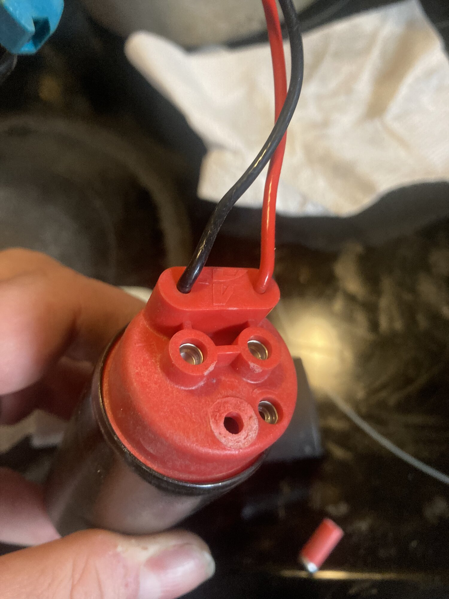

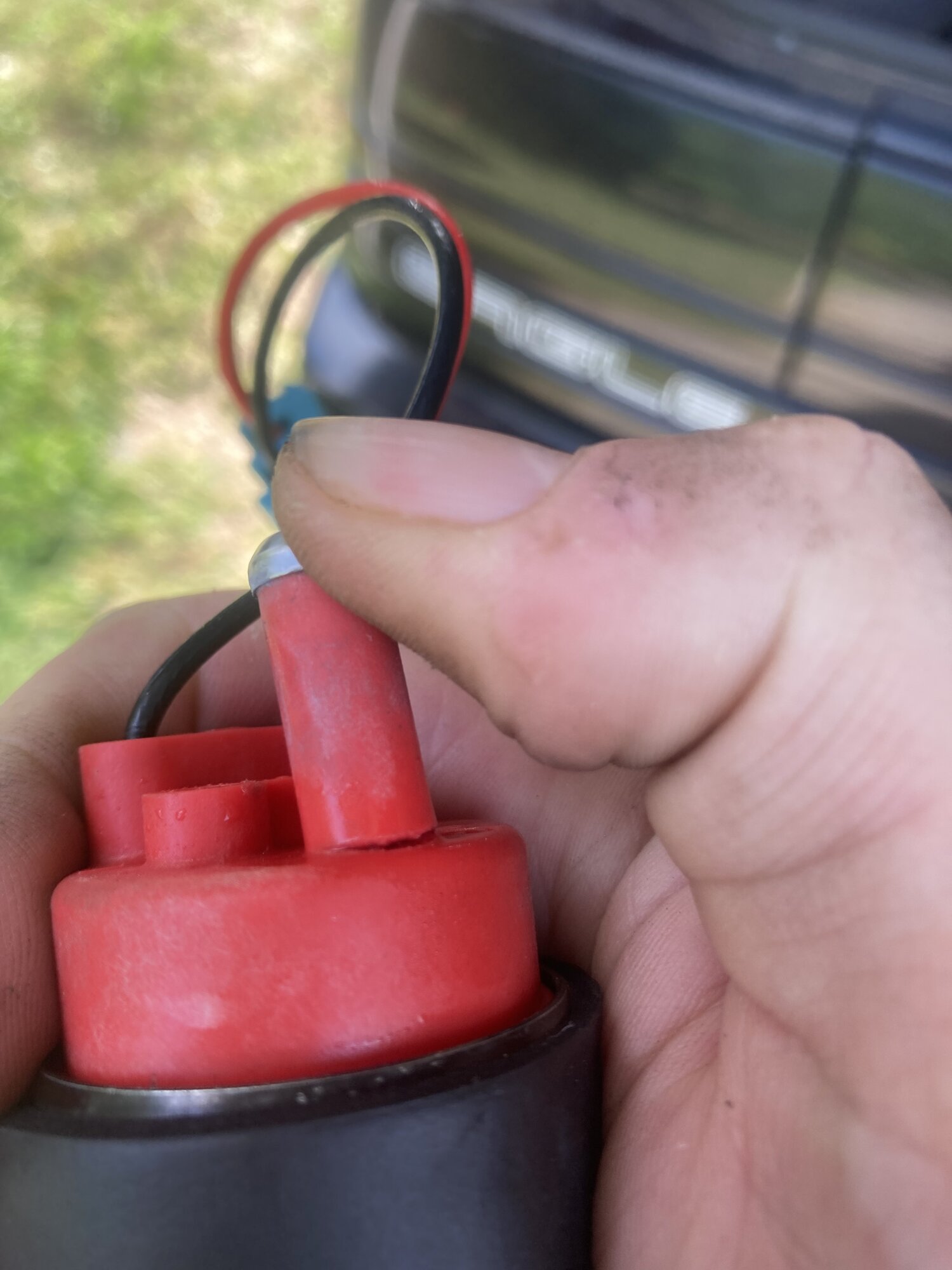

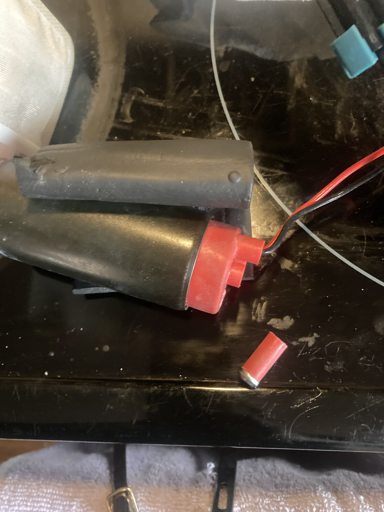

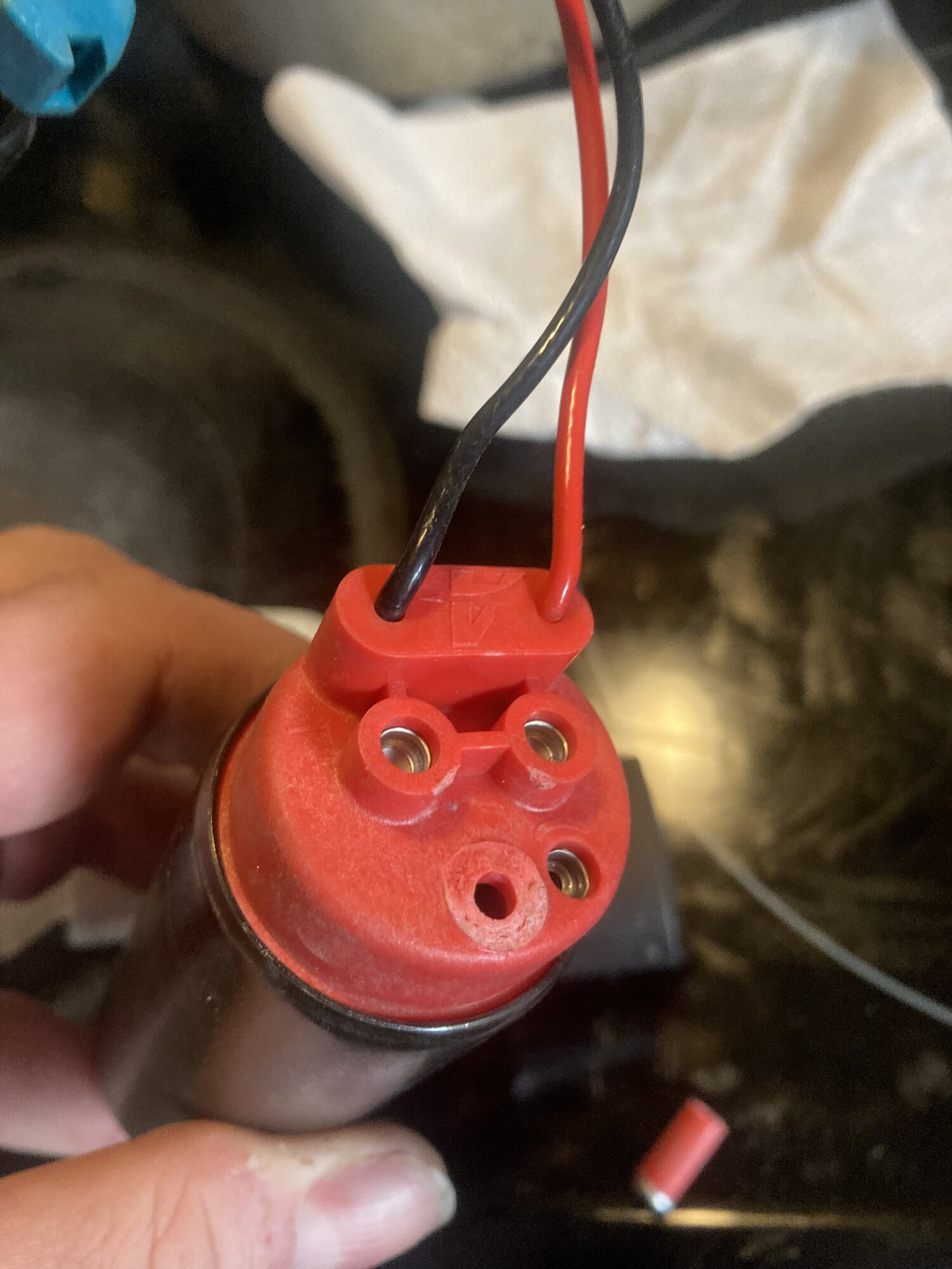

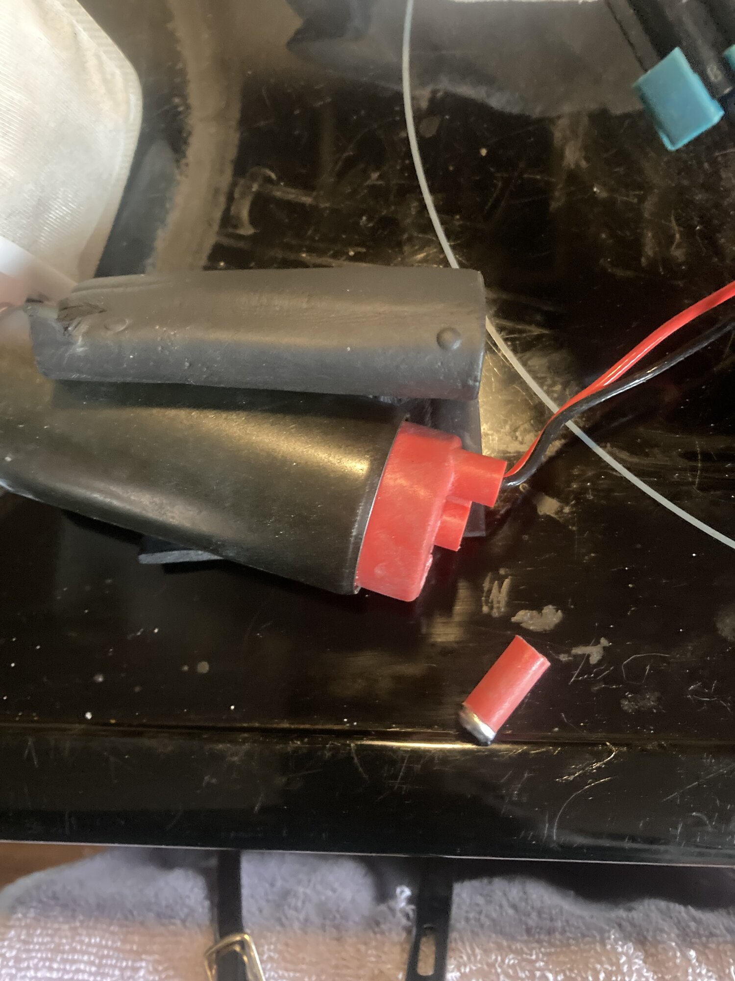

Found my lean issue.
What absolute junk and garbage. There’s no way it vibrated itself into snapping that snout. I had it mounted tight as a MFer to the sending unit.

Well that's honestly the best answer you could have gotten. At least you KNOW what happened.

Hardwired? What do you mean? Fuel pump rewire? If so, that was one of the first things I did was rewire/hot wire the fuel pump because it wasn't done before.
And I 100% agree with you. I'm annoyed it happened, but man I am very relieved I found a true smoking gun. It just blows my mind how this even happened.
So yeah, DO NOT BUY the Aeromotive Stealth 340 pumps. They're JUNK. You're better off with the knockoff eBay units, or just upgrade once to the Hellcat 525 pump and be done with it.
Are you saying the cheap kemso 340 from ebay might be better? The color of yours looks literally exactly like mine except it was a plug and Play unit. I'm still on my first one I ordered 3 as backup 3 years ago, and the first one still hasn't died. I even ran it out of gas and it sounded like it straight up was about to explode. Maybe I got lucky who knows. Those were the years of me being cheap, I promise I'm not anymore.

You are exactly who I was thinking of when I said that. LOL. I was warned the Aeromotive branded 340s were junk but I didn’t listen.
Ah well. I got there in the end. Now I shouldn’t need to upgrade pumps ever again.
Seriously? Guess thats something im going to have to keep an eye on...
2Gs have a different style sending unit so maybe that’s easier on the outlet of fuel pumps. Or maybe I just had dumb bad luck.
Either way, definitely keep an eye peeled. If you start having a random fuel pressure drop or lean issue in boost that gets worse with the more fuel you command, you know what to look for.

So I'm guessing that's why your fuel pressure was bleeding off so fast?
Yep. Because originally when I installed this I had the same issue. Turns out it was a loose hose clamp, that I fixed. After that it would hold fuel pressure for a pretty long time. Then randomly one day(noted a few posts ago actually, Lol) it started having the issue.
