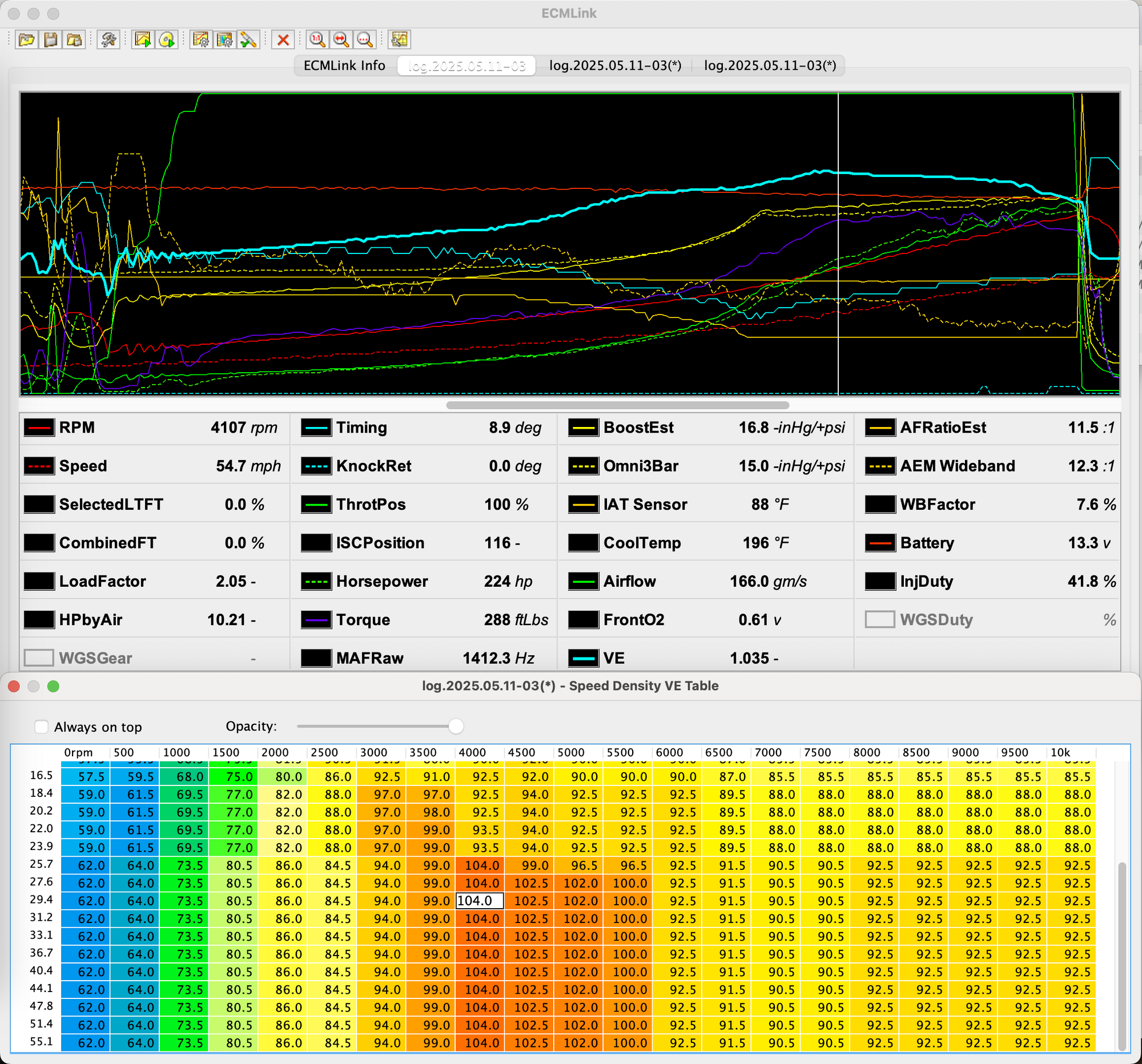

Fuel issue is fixed. With the hellcat pump, and it rewired properly this time( :ohdamn: ) I am now running rich up top. Before I was running lean. I think I'm gonna take a tiche less fuel pressure out from the AFPR, and adjust the VE map a little more. I took some fuel out a little bit, but didn't wanna make a large jump. So, I'll adjust the AFPR and take another rip and see where she is.
Log for anyone curious. This car runs so much better, I cannot describe to you how much better. There's so much more torque down low, and part throttle is just superb. God the "tune" before was absolute trash. It barely ran, man. Insane.

This is looking pretty good from my own non professional point of view.
Looks like youve got the fuel dialed in pretty well, a little rich up top, and a little lean from 4400-4800 but seriously fueling looks solid.
Just keep physically adjusting the afpr and leave the SD table alone for now. The only objective at this point is wb=afratioest at 5500rpm. Looking at your log above, from 4800rpm to 6200rpm you will see that whole area tighten up to afratioest nicely, and you may be surprised on the effect that does to 6200+.

And yes, you're about half point rich. Lower the base fuel pressure until wb=afratioest at 5500rpm. It will probably be minimal like a quarter turn counterclockwise. I would mess with the afpr until you got it as dead nuts on as you can. It's a fine adjustment there as you have 360 degrees to turn it. Global fuel % is a garbage adjustment in comparison as that only allows you to adjust every 10th of a percentage.
I haven't touched timing yet, I wanna make sure the fuel system is dialed in first. I adjusted the AFPR, and honestly I think I'm really happy with how it is. I need to give it more fuel down low, obviously, but I'll let yall look it over and critique it. I'm gonna let the car cool down before I take a long 3rd gear pull. With it being mothers day there's a ton of traffic. I might drive it to work tomorrow so I can get a good long 45 min cruising log to adjust fuel trims/VE map. I'll also get a full 3rd gear pull too because where I work has back roads to drool over man. Long, flat roads for miles with zero police presence and no homes. Man. Anyway.

I see you are above 100 in your VE table, and the VE peak is not at all where I would expect to find it. It looks like you need more global fuel?
Another thing I noticed is your IAT temps are fixed at 88deg? That's awfully consistent for a 3rd gear pull. I was expecting it to move a little.
