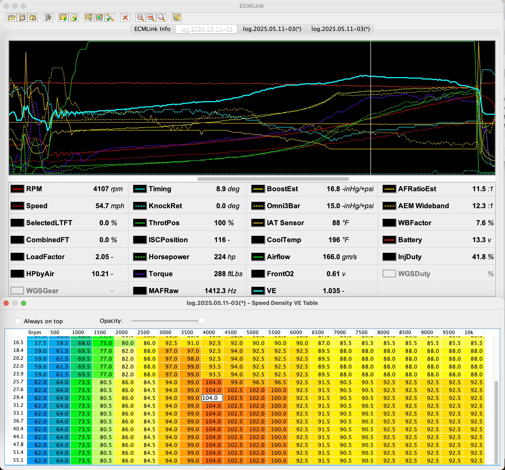

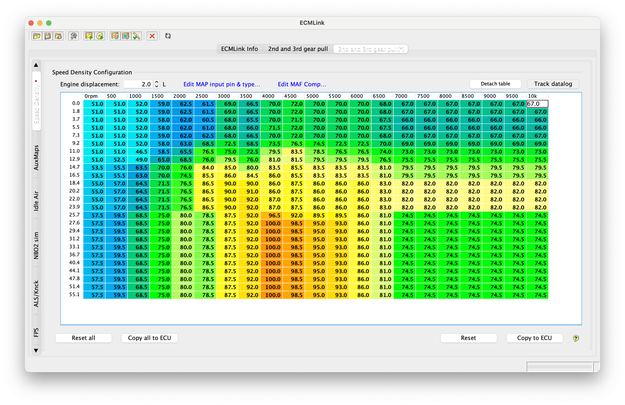

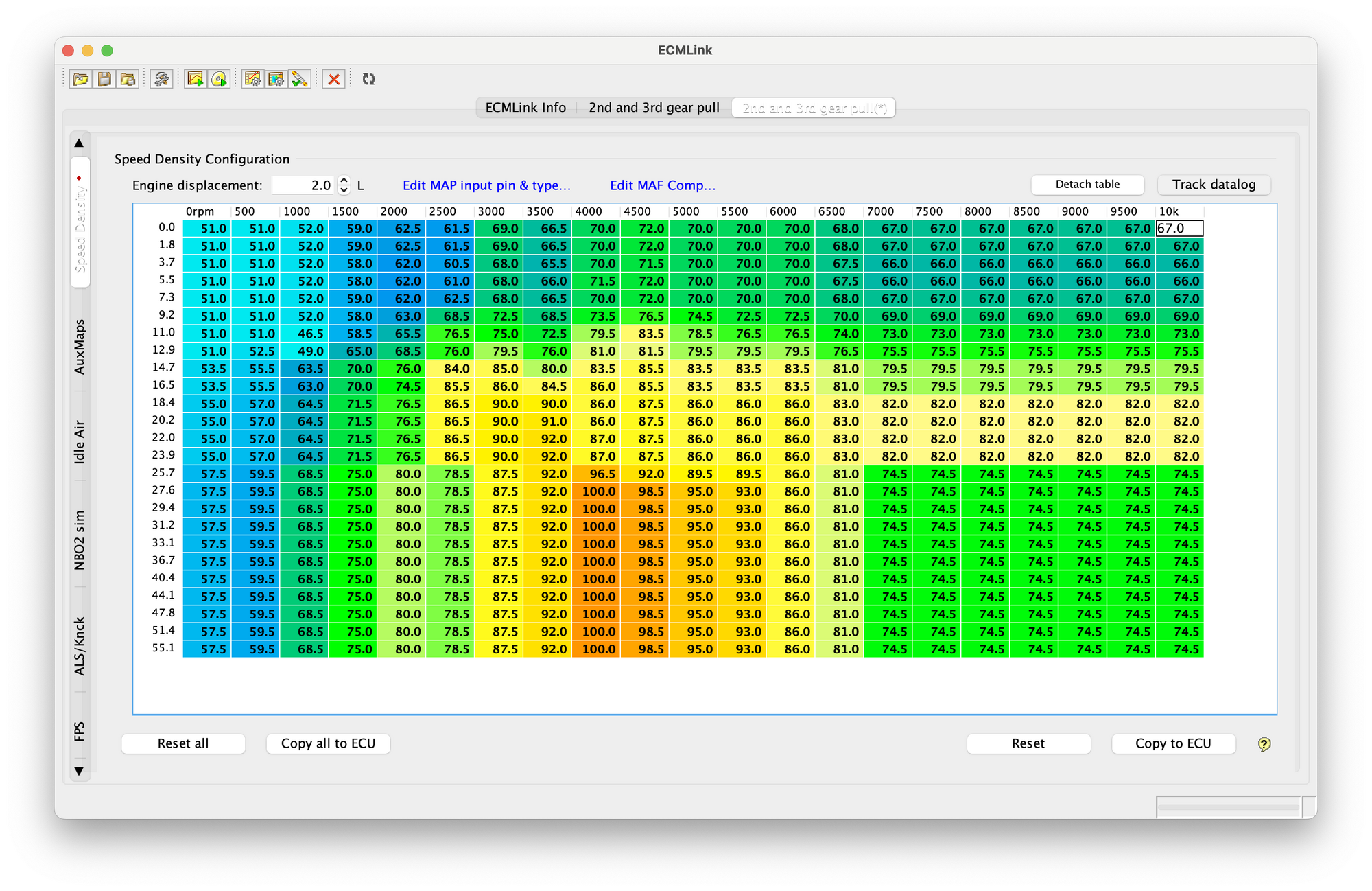

I see you are above 100 in your VE table, and the VE peak is not at all where I would expect to find it. It looks like you need more global fuel?
Another thing I noticed is your IAT temps are fixed at 88deg? That's awfully consistent for a 3rd gear pull. I was expecting it to move a little.
Back on topic: I always just assumed my intercooler was just really good. Is there a way to test my IAT sensor? Like back in the restaurant days if you wanted to test a thermometer you’d dip it in ice water to see if it said 32* and put it in boiling water to see if it read 212*.
Unplug it and see or is there some kind of better process?

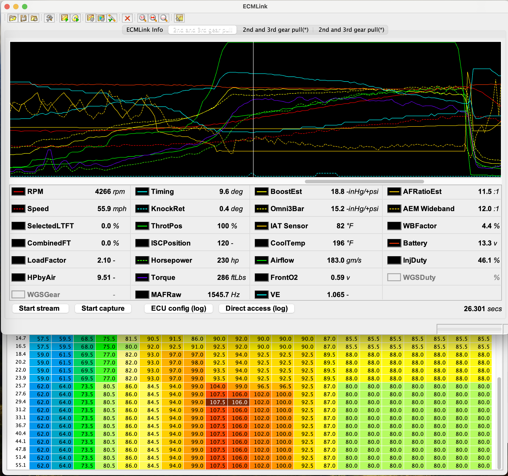

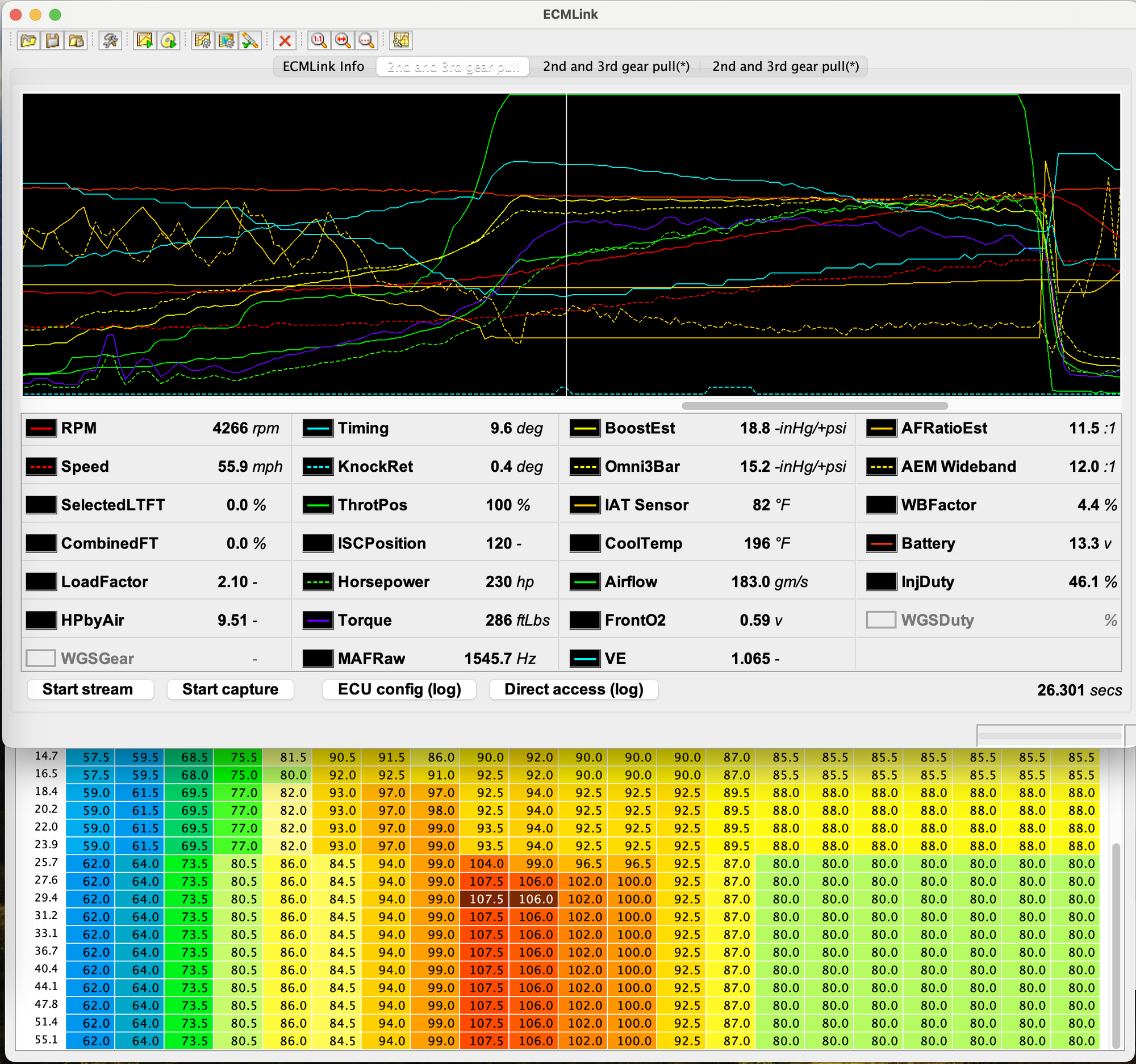

Did some more tweaking of the fuel maps tonight. This thing freakin' riiiiiips on the new aggressive timing maps. It's still a little rich past 7500, but honestly I'm rarely if ever gonna go past 7500. It is faster in its current form than it was on 24+lbs. And its on 16lbs creeping slowly to 20 at redline. I can't wait to turn it up to 24 or 30lbs, or as close as it'll get. I'm a big chicken though, I'll be real. I'm gonna keep it at its current boost and see how fast I can go on Dragy. Eventually. :p
Here's the log. It's a short 2nd and 3rd gear pull to check AFRs in both gears. God I love this new/proper tune.
Also! To @Justin DuBois , I tested my IAT sensor with a hairdryer...this ETS intercooler just really is that good at cooling! It got right up and responded no sweat to the heat from the hairdryer. Maybe it's a combo of my OCD for heatshielding, and a bad-ass ETS intercooler. IDK. I'm sure this FP Green compressor wheel is super efficient too. I bet on a 16G above 20lbs it would be way more of a struggle/way hotter. But this Green is on 16-20lbs. Barely working.
Log below. :)
One question though...is it normal to have to take so much fuel out up top? Like past 7000-7500RPMs? Is it my turbo running out of steam or is there are a larger problem? It's a stock turbo throttle body, stock IM, 2G unported exhaust manifold and o2 housing, BC 272 cams. Normal or should I have more oomph up there? Lemme know what you guys think.

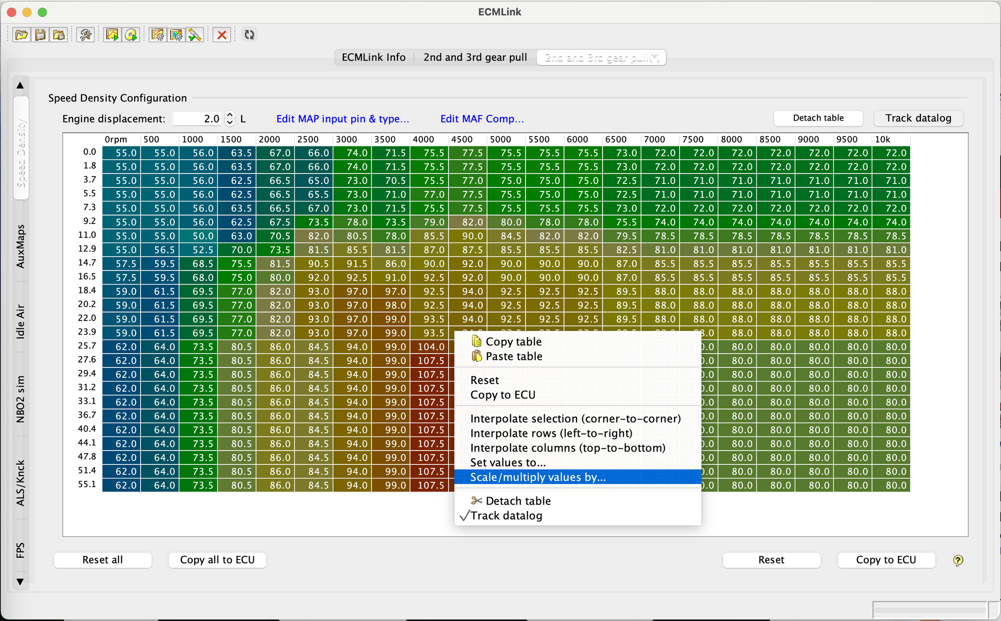

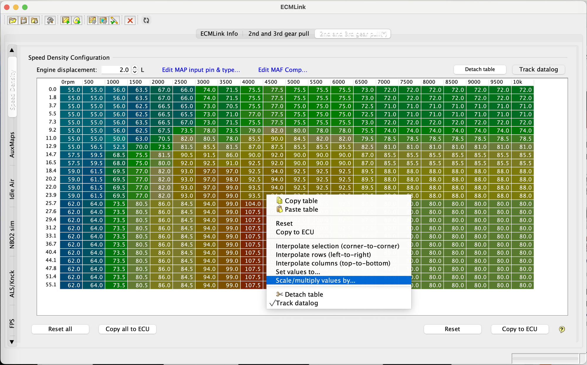

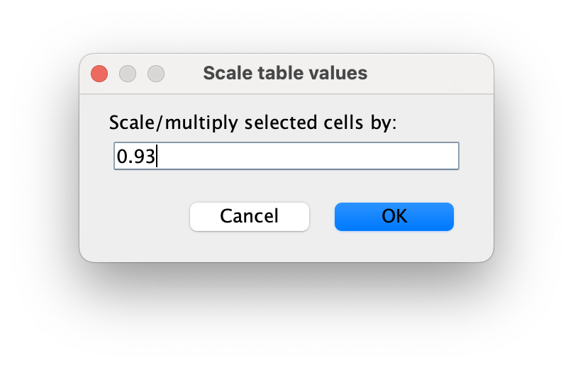

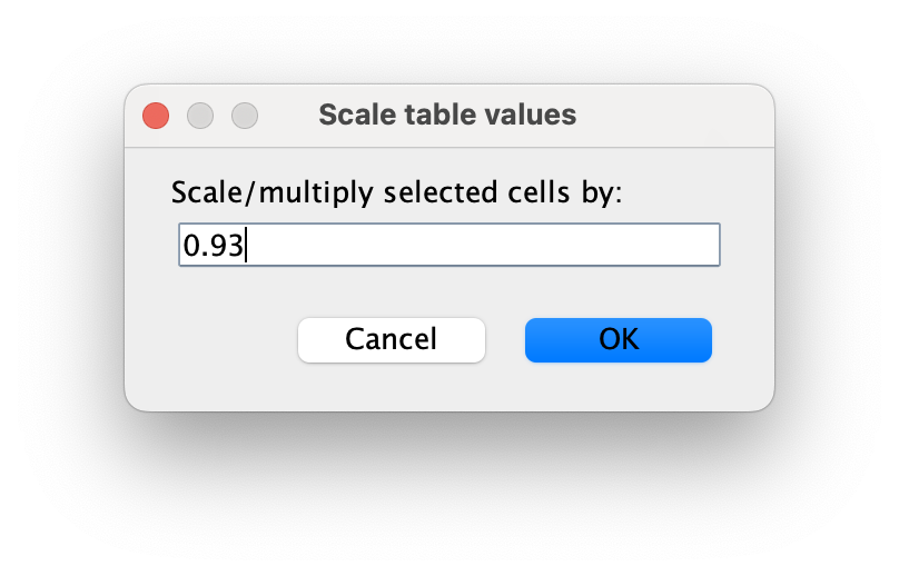

You can use the scaling feature to re-index the entire table. If you multiply every cell by 0.93, it will lower your VE peak to 100, and maintain the relative relationship of all the cell values.
Good stuff, I didn’t know that was a thing.
But, can you clarify why you’d like to see me change the VE around? Not challenging you, just strictly for knowledge sake.
Perfectly normal for you VE to drop last your peak, especially with a stock intake manifold.
Big cams, turbo and intake manifold would get your peak VE into the upper areas.
Awesome. Good to know! Thanks broski.
If you decide to do this don't forget you'll need to adjust your global fuel to offset the lowering of the VE table like @Justin DuBois mentioned here:
Your SD profile is interesting. You need more global fuel, and your VE peak is close to 4000rpm.
I recommend -31 as a new global fuel, and start lowering the SD fields that are above 100.
It's really just to get your max VE value fuel set to 100 so they aren't inflated.. There might be other reasons behind it as well but I'm not sure what those are LOL
Yes. It's similar to adjusting global fuel so that your MAF Comp sliders return to center around 0.

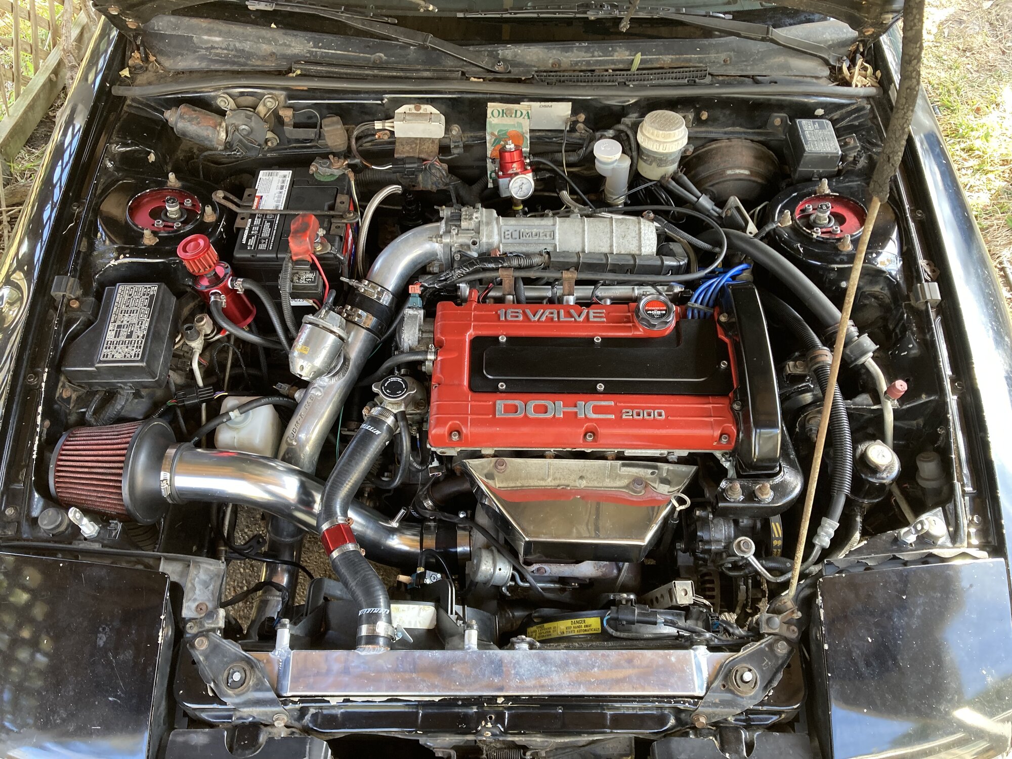

In an attempt to get the oil spraying out of my BOV when letting off under control, I'm gonna make the lines coming from the VC bigger. Right now I'm using both the stock PCV valve and stock breather port running to my catch can, and I just don't think it's enough. Especially how tiny the PCV valve fitting is/how small it necks down to.
Temporary solution before going full retard: Ordered two 1/4 NPT to 1/2" Barb fittings and a 1/4 NPT tap/drill bit combo. I'm gonna drill and tap the holes for the PCV and the breather ports, and use these fittings. Also gonna get some 1/2" line, and thankfully my catch-can already came with 1/2 barb fittings as a spare. If that doesn't help, I'm gonna just bite the bullet and dish out the money to have some -10AN fittings welded onto my VC and probably get it powdercoated at the same time. Same color it is now. Really want to get this excessive crank case pressure under control, as I'm terrified it's going to cost me a turbo or something.
I am already starting to consume oil, and that disturbs me. It's only like 1/4 quart so far but still...I don't like that. Hopefully getting those crankcase gases evacuated will help.
Who built your engine? I was in my early 20s when I built mine and it was with little care. I don't think I remember gapping the rings and one cylinder had a nasty scratch from me being careless putting the pistons in. Those were the days of me just being in a hurry and careless to say the least. The scratch was bad enough to catch my finger easily. I don't think I've ever told anyone this story just because it's embarrassing and I've made so many mistakes it's hard to swallow some of them down.
Anyways Even with those issues I don't have oil spraying from anywhere and zero dipstick popping out, so either I got stupid lucky slapping the b together or my time is coming. Obviously now if I built an engine it would be with the most kind of care. The older I get the wiser one becomes.
if you're engine bay is still the same as this:
Your catch can is vent to atmosphere and unless you've got some CRAZY blowby from the rings, id wager it's probably just residual oil from your intake pipes / intercooler from before you switched your catch can setup.
I'd bet it's really just from the oil stuck to the inside of the piping getting warm enough to be able to move around due to boost, and getting pushed into your BOV flange and getting stuck, only to be released when the BOV opens under pressure.
Personally you probably have nothing to worry about but it might be worth taking the piping off and cleaning it out, and if you're feeling froggy maybe the throttle body and intake manifold and cleaning those out too. I'd bet they're caked with sticky oil
Have you got any pictures of how much oil coming is out of the BOV?
Hmmm. What's weird is this was never an issue before I fixed the dipstick blowing out under boost with a new dipstick tube w/ a spring. Either it's been happening the entire time and I only just now noticed it(possible) or it's because I have some crazy blowby. I need to compression test the engine again, but honestly I don't have super high hopes for this engine. It sat non-running for almost a decade in brand new/freshly rebuilt condition, and I screwed it hard by starting/stopping and letting it idle for extended periods before it ever saw any attempt to break in the rings.
But to answer your question yeah, engine bay is still the same/can is VTA. I don't have a picture of the amount of oil, but it's not enough to be visible on the intake tube(BOV is pointed right at the intake tube) but I can feel it. If I stick my finger in the BOV hole, a tiny bit will be visible on my finger. I can also smell it after a hard pull. Oil burning smell. Similar to when the dipstick would pop out and spray a bit on the heatshield.
I'll probably end up paying a local shop I trust to do a leakdown test since I don't have an air compressor and the necessary stuff. It's had enough miles put on the engine compression should be good. Curious what the leakdown finds.
A crackhead built my engine, sadly. He's part of these forums and used to be the go-to guy, but years of Meth abuse has robbed him of his skill, or at least his ability to take his time and do things correctly. Half of the cam cap bolts were finger loose, and a bunch of other things wrong. So legitimately, I wouldn't be surprised if it's 150% some crazy amount of blow-by from terrible over gapped/incorrect sized rings/engine builder error.
Oh dang well that's unfortunate to say the least. I do feel blessed to have gotten lucky on mine but I do still kick myself for everything I continue to get wrong. That's why I try not to get upset or complain because I know everything that I do can be avoidable. Sorry for the rant about myself. Maybe one day I can get something 100 percent without mistakes instead of pretending to be Stevie wonder everytime I work on something.

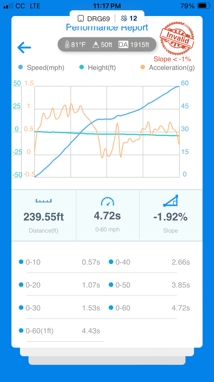

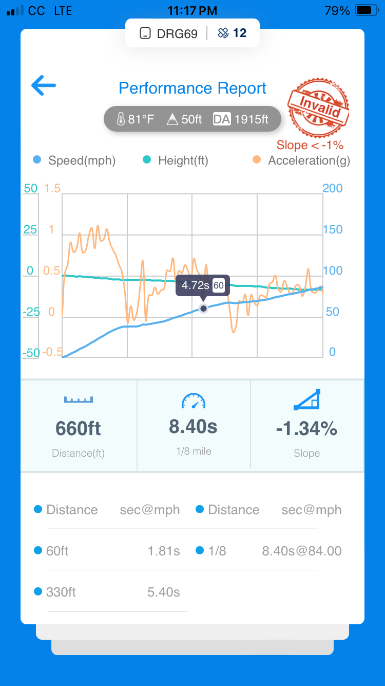

Turned the boost up to 24lbs, and holy crap does it rip man. I drove the car for like 20 mins and decided to try an AWD launch. That was a mistake. It slipped the clutch in 1st gear. What’s weird is it just grabs for days in 2nd and 3rd though. I don’t hear the wheels spinning so I’m assuming it’s clutch slip.
I’m gonna let it cool way down and try again in a few hours. It’s a full face ceramic clutch so it shouldn’t glaze or whatever. Curious to hear y’all’s thoughts. Is 1st gear in 1G DSMs just that quick that it feels like it’s slipping?
Either way, God this car is magic at 24lbs. Gonna get a log later and see how close my injectors will let me get to 30lbs. :D
This thing rips so hard, man. I went out and checked the 1st gear holding capacity and it seems fine. This time I actually heard the wheels spin but it boogied out of the hole.
I’m so stoked with this. Again, it’s not world beating but it’s a huge improvement over what it was at the same exact level boost wise a few months back. Also, I was 150% shifting like a grandma. I'm attaching the log from this run for your enjoyment/critiquing/whatever. With these Dragy numbers I've officially hit a goal of mine, and that's to make this thing faster than the Edge is on full kill. 2nd and 3rd gear are just freakin' magical. I'm only at 70% IDCs, so 30lbs is coming soon as I get the crankcase pressure under control.
I'll spoil the log a little though and say, from 1-2 and 2-3 both took .51 seconds each. ROFL LOL Granny shifting to the max. But yeah, 21lbs creeping to 24. Love it. I wanted to hit that magic 400hp number but eh, IDC. I really feel like this car is in the easy 7's if I could just break out of the "Grandma driving to church on sunday" shift pattern I have right now. It's a mental block because I don't want to rape this car into gear and it hurt the transmission...IDK. Either way, stoked. Guess the clutch holds fine. :D
