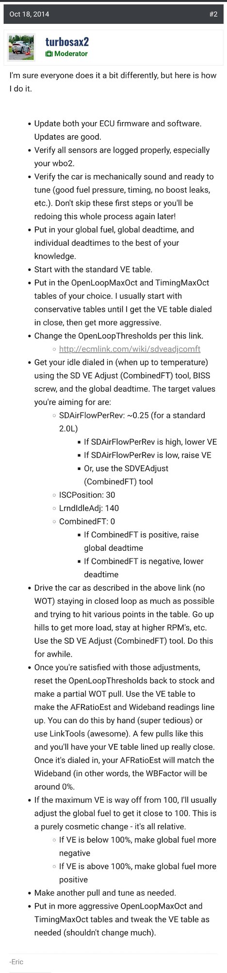

I cannot for the life of me find what post I got this screenshot from but this is what I followed to get my car squared away.
*edit* - Found it LOL
This all seems to make sense to me.
As far as I know, LinkTools is no longer *widely* available either.
Basically it's this:
Determine global via the process I said above. Then never change global % or base fuel pressure again. That is it's own completely separate thing.
Put in your 7v - 19v values. The reality is the only values used of those is like 12 and 14. Maybe lower if the battery is half dead. But I view that table as a shape. That shape is tattoo'd to the injectors as their operating personality. What values you choose to use may or may not determine how the injectors do in fact behave. Anyways, that is to be set in stone.
So we have global set in stone and 7v-19v set in stone. What's left? The VE table or the global deadtime adjustment on the fuel tab.
Well, I'm very conservative with leaving the SD table near "stock". It can be smoothed out for sure, it can be shifted for peak VE on a larger turbo for sure, but the ECU is SO reliant on the airflow values being realistic it's a cascading effect of shit being wrong when that is messed with too much. And ironically that is the table everyone messes with extremely because it's instant gratification.
Now it's boiled down to global deadtime, and the only way to adjust that would be on the fuel tab. You'll either lock it in open loop and make afratioest=wb during idle by adjusting the deadtime on the fuel tab, OR, you can leave it in closed loop and look at combinedFT as enriquez suggested above to get combinedFT hovering at a value of zero. I'm not a fan of using combinedFT because it's a clouded value using fuel trims. I guess it's fine if you do it over a period of time and constantly go up to "reset fuel trims" while making any single adjustment.
The amount - or + you can go would be the limitation of 7v or 19v in relation to the top or bottom of that chart. Perhaps it could go more extreme but you'd be way out in the weeds with that.
Understand that the global adjustment on the fuel tab is the same as the 7v-19v adjustments. Putting 100 in deadtime on the fuel tab is the exact same thing as raising ALL 7v-19v values up 100. Putting -500 on the fuel tab is the same as lowering every 7v-19v value down 500. I guess if you were a masochist needing the value on the fuel tab to be 0 or never negative you could do so but there's no need.

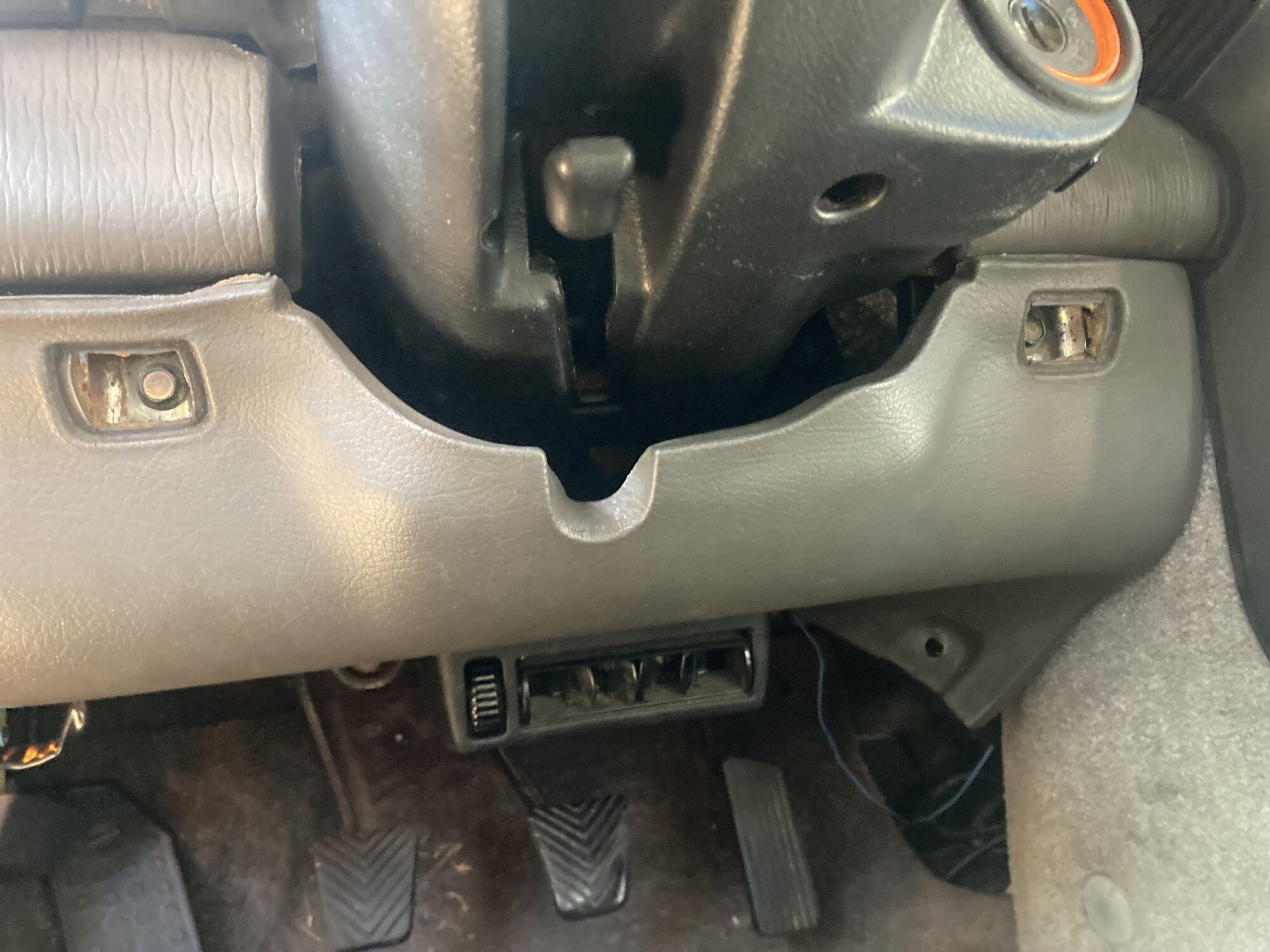

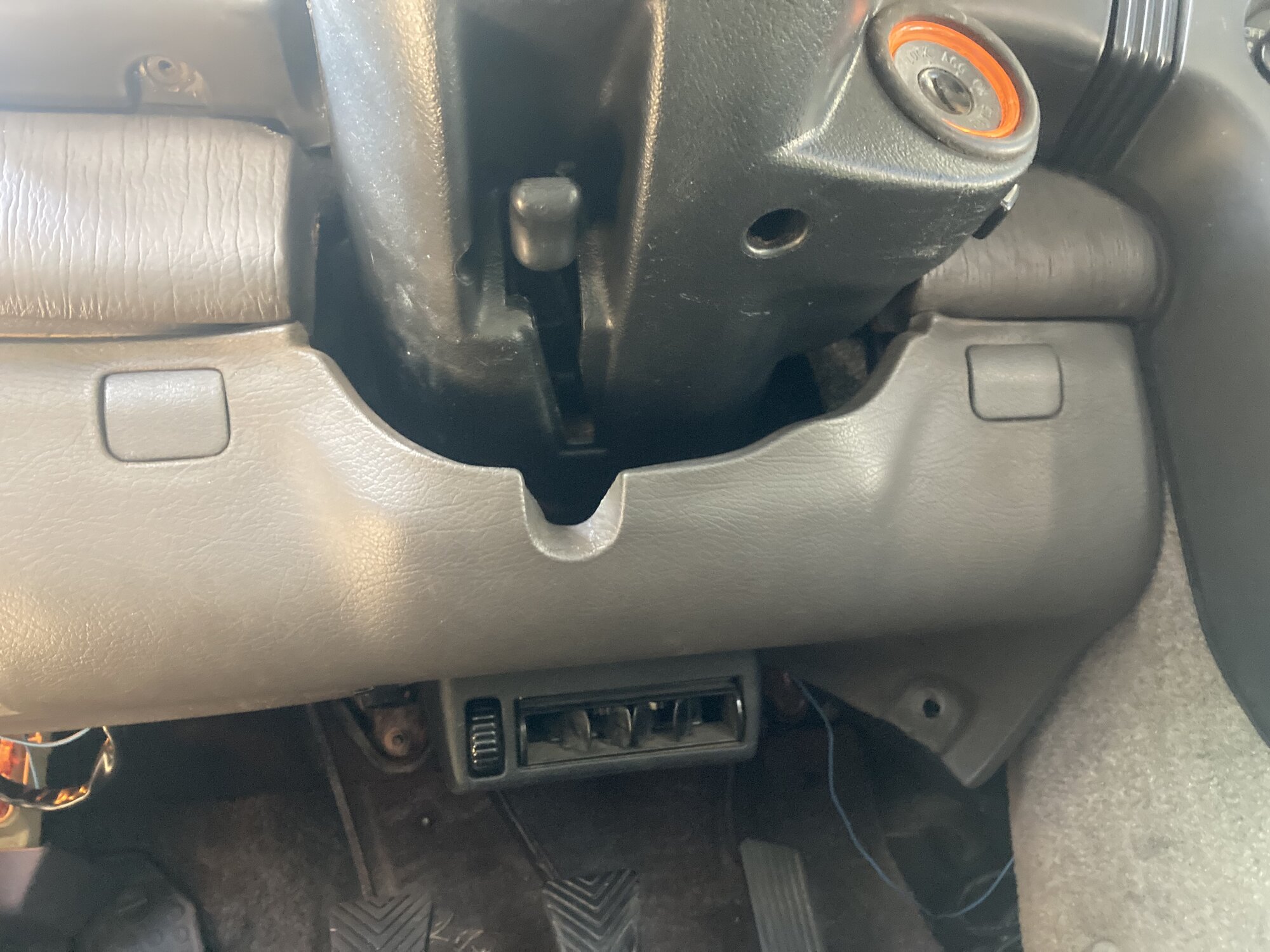

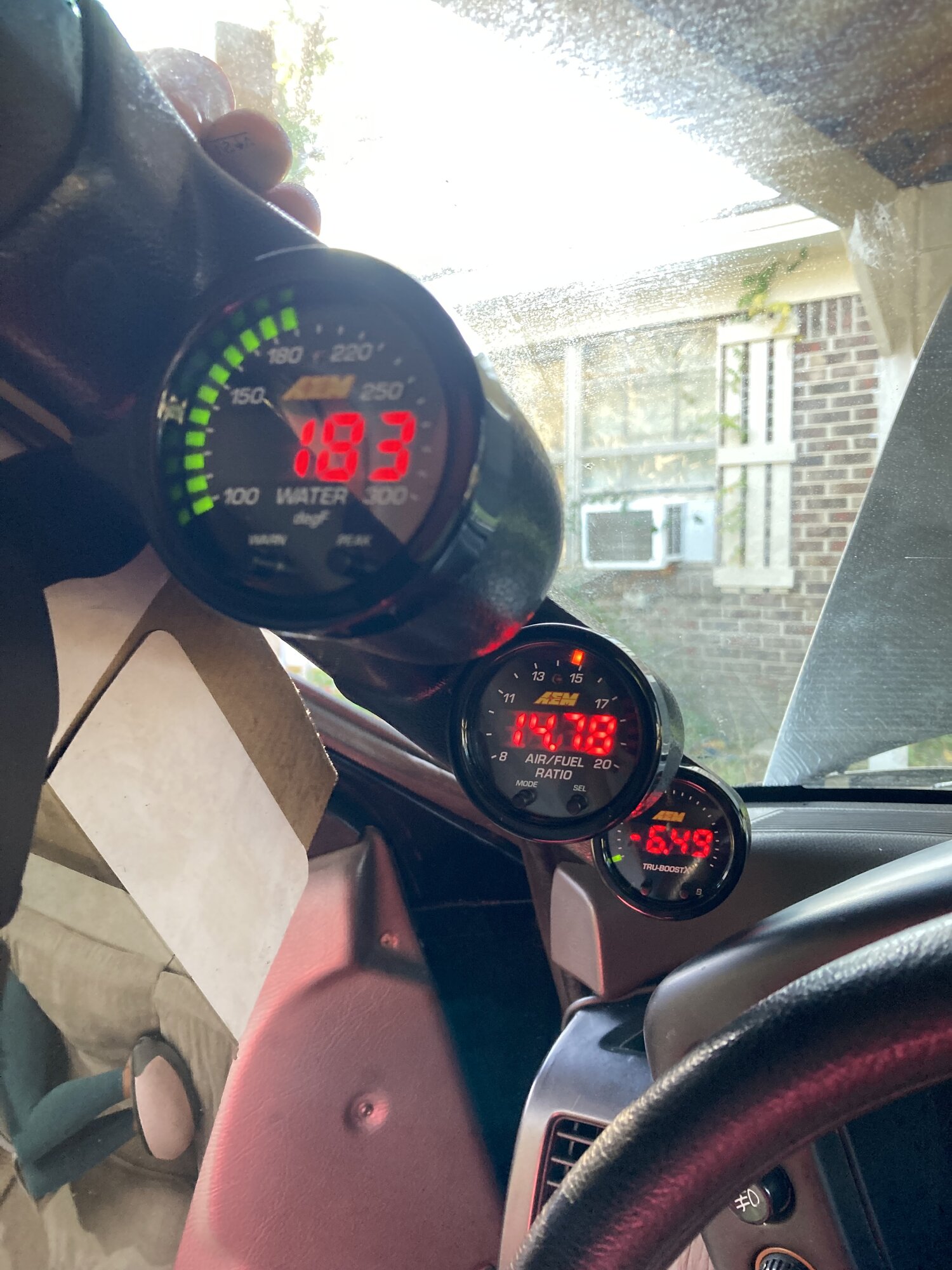

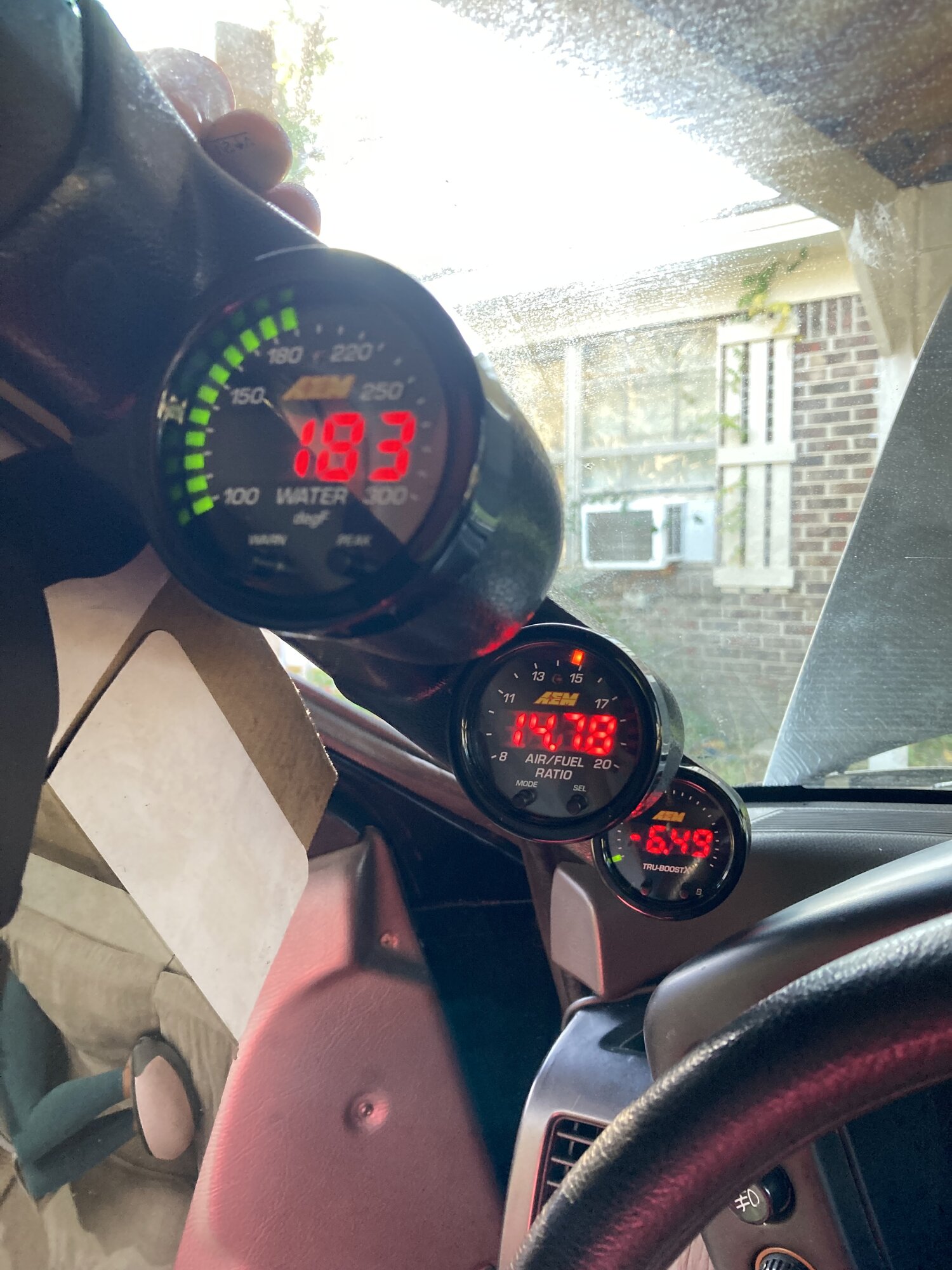

Thankfully, only had like 3 wires to solder and do before I could install the gauges. Got that done pretty quick, mounted the gauges, and super happy with the results. I need to go into 'Link and put in the WB settings so it logs properly, but I'll do that later. For now, just enjoying my hard work.
I hate running wires. Lol. But, eh, like I said. Super happy with it.

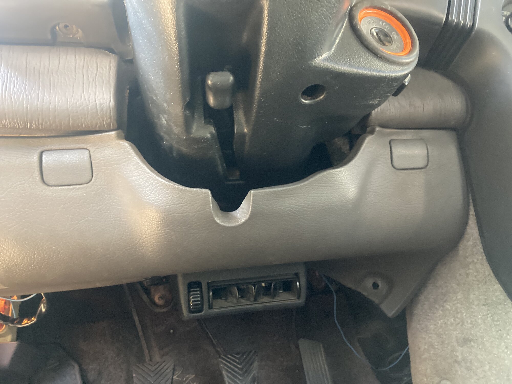

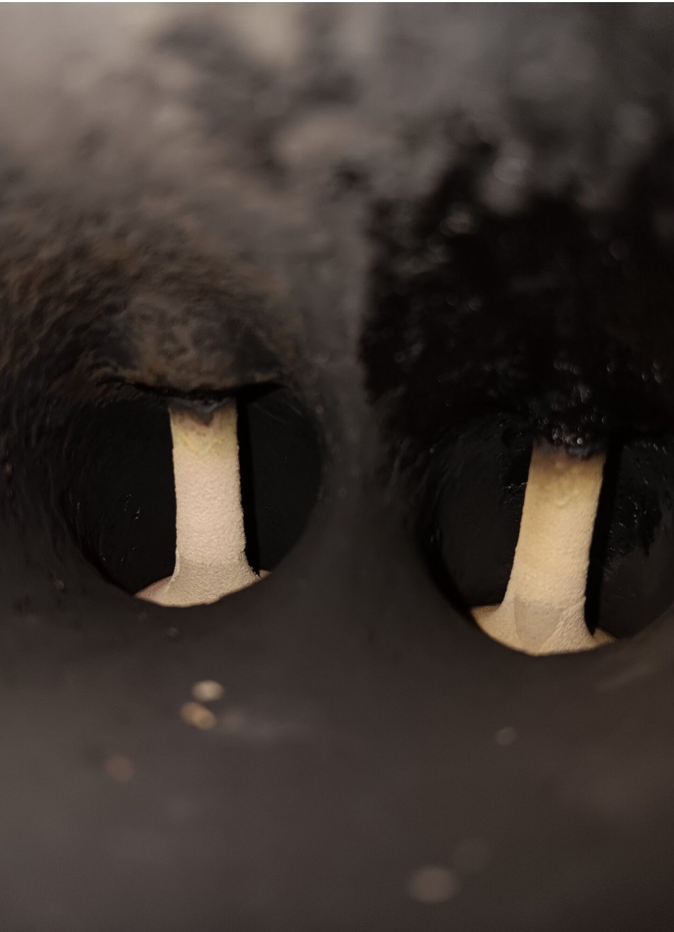

Best way to tell if it's valve seals is to look at the exhaust valve stems. Oil will burn out of the exhaust manifold but the valve stems will stay damp, just look in the ports and see. I've seen this a ton with old Hondas and DSM's. Smoke on a cold start that clears up after a minute or two and doesn't reoccur until the next cold start. No signs in the exhaust system besides expected carbon from burning oil but the visible portion of the valve stems makes it obvious. If the seals were replaced once or twice that doesn't mean they seal well. Sitting for a prolonged period of time makes the rubber portion of the seals harden, and hard seals don't really seal. They don't have to be even a decade old, just not enough use in that decade or less. Modern oil is more than a lubricant - it's a conditioner as well. If seals haven't been conditioned for a while, they will harden/dry rot and leak. Rubber seals in a way are comparable to human hair. With no cleaning and conditioning for extended periods of time, they become quite brittle. The only way to solve brittle hair is to let it break off or cut it off and let the new soft and conditioned hair take over. Same with rubber seals, once hardened it's time to remove and replace them with new. High mileage oil has those extra additives that get absorbed by rubber seals to cause expansion and softening, but that's only a band aid as once they're gone they will need replacement. I'm sure you know this but the thorough explanation should give you something additional to think about and look for.

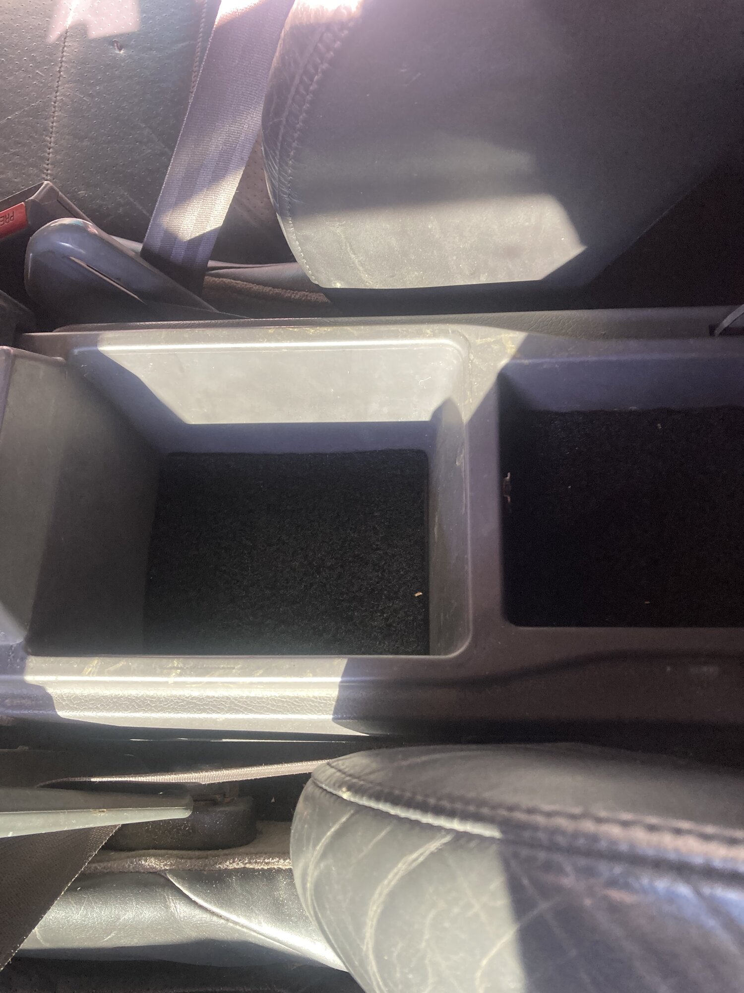

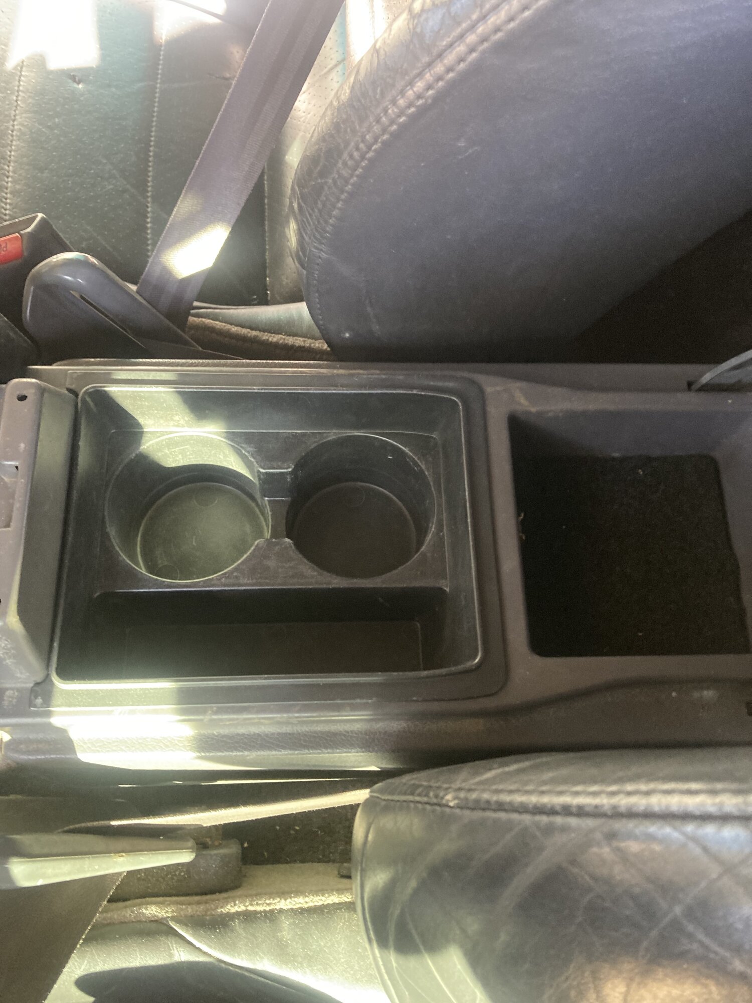

I ain't diagnosed SHEEIT, but I bought some small trinkets from my main man @jersygsx and being the awesome dude he is, he threw in a couple of small but REALLY rare/hard to find screw covers for me.

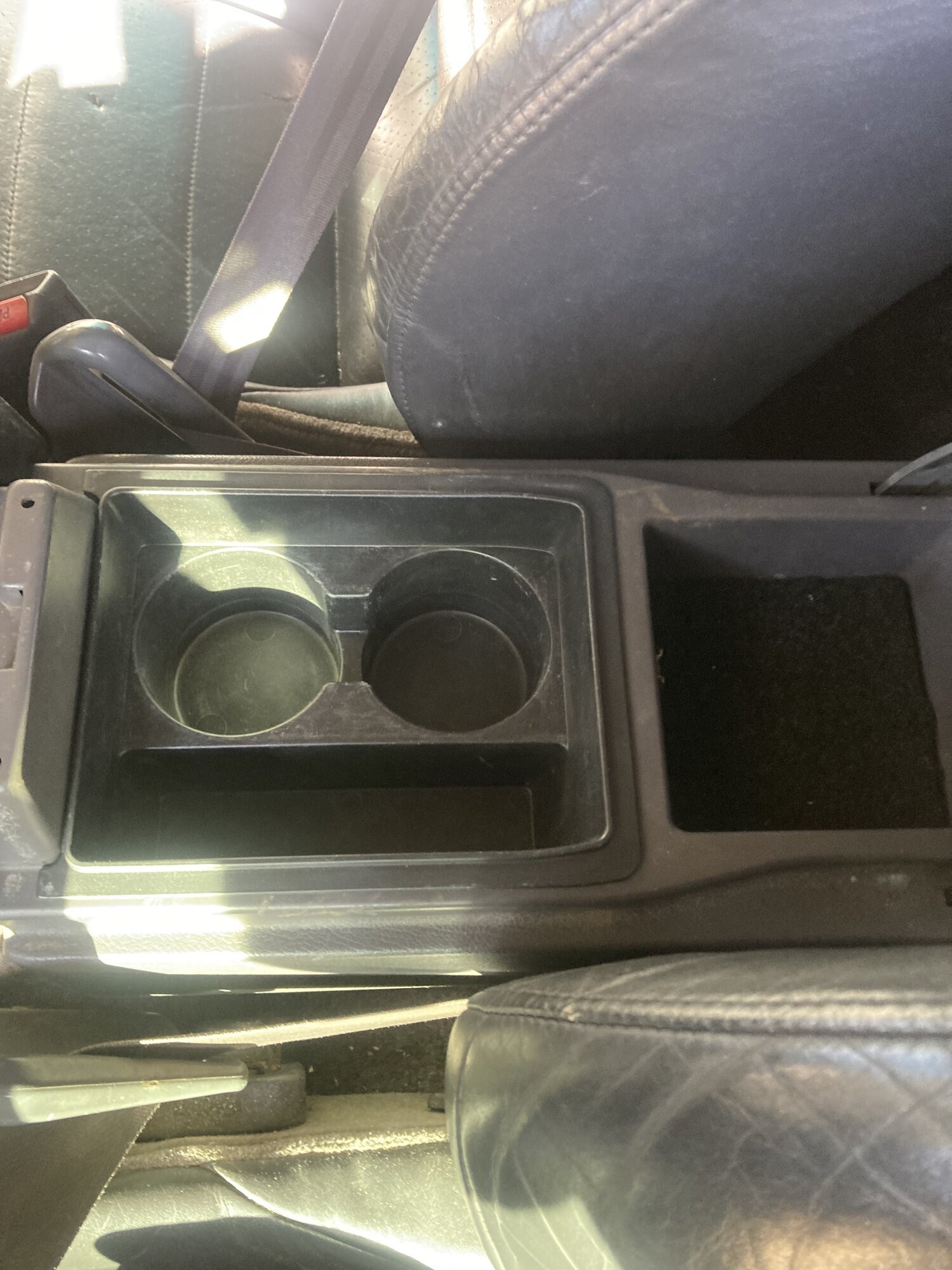

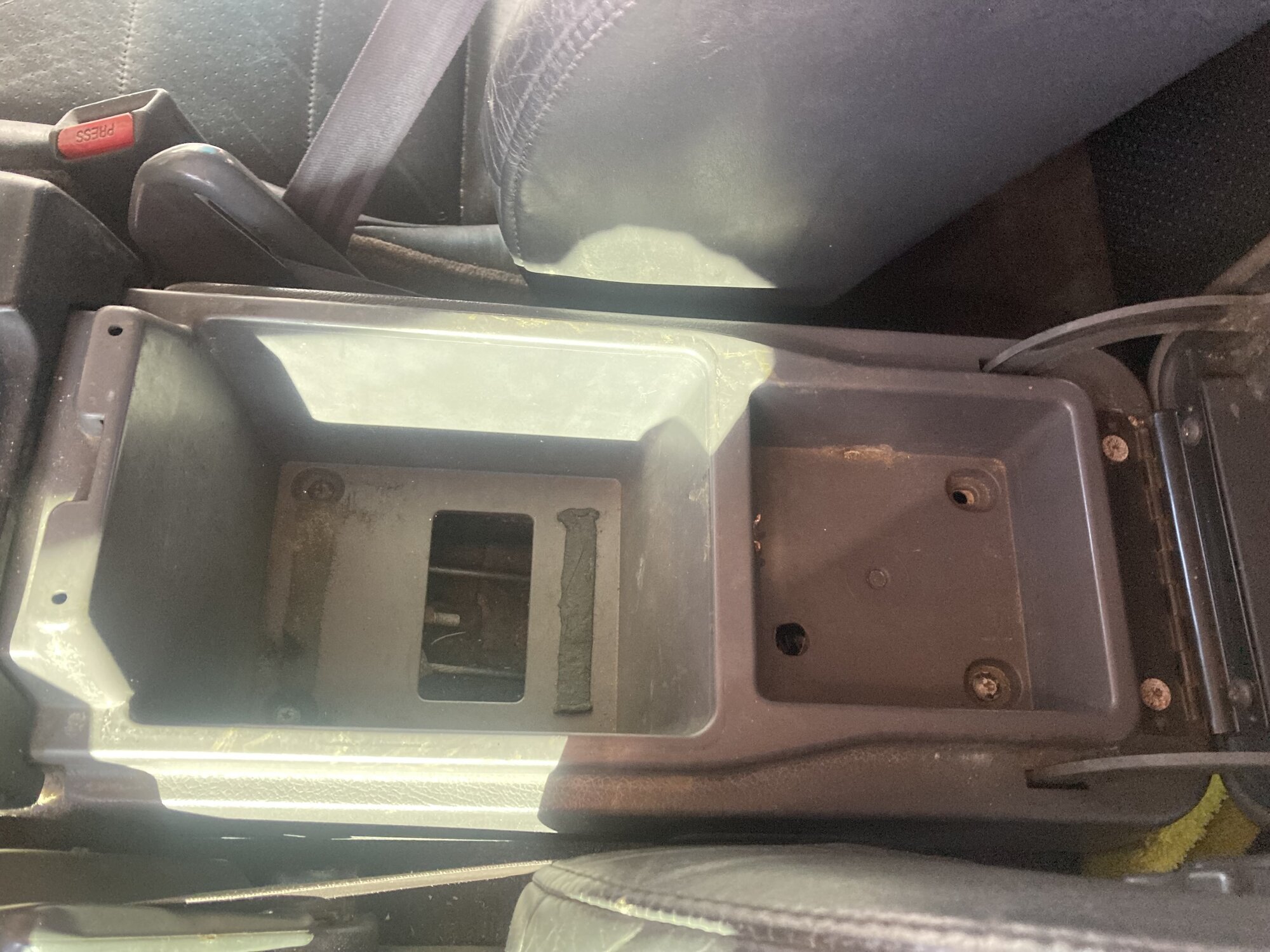

Ugh. Bare and sad.

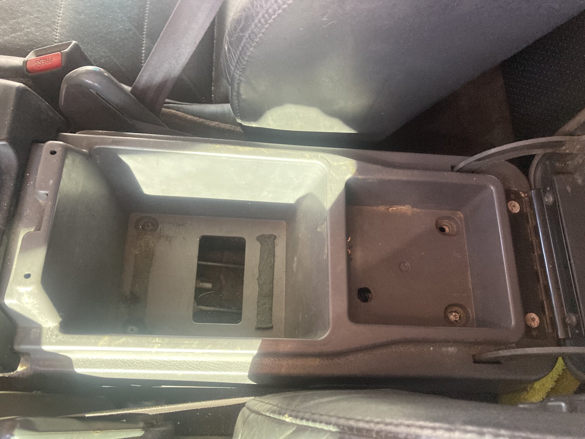

Much better. Happy and comfortable.
I'm gonna clean it up, but I don't really plan honestly to use the cupholder, I'm just throwing it in there because it was an option and it feels right.

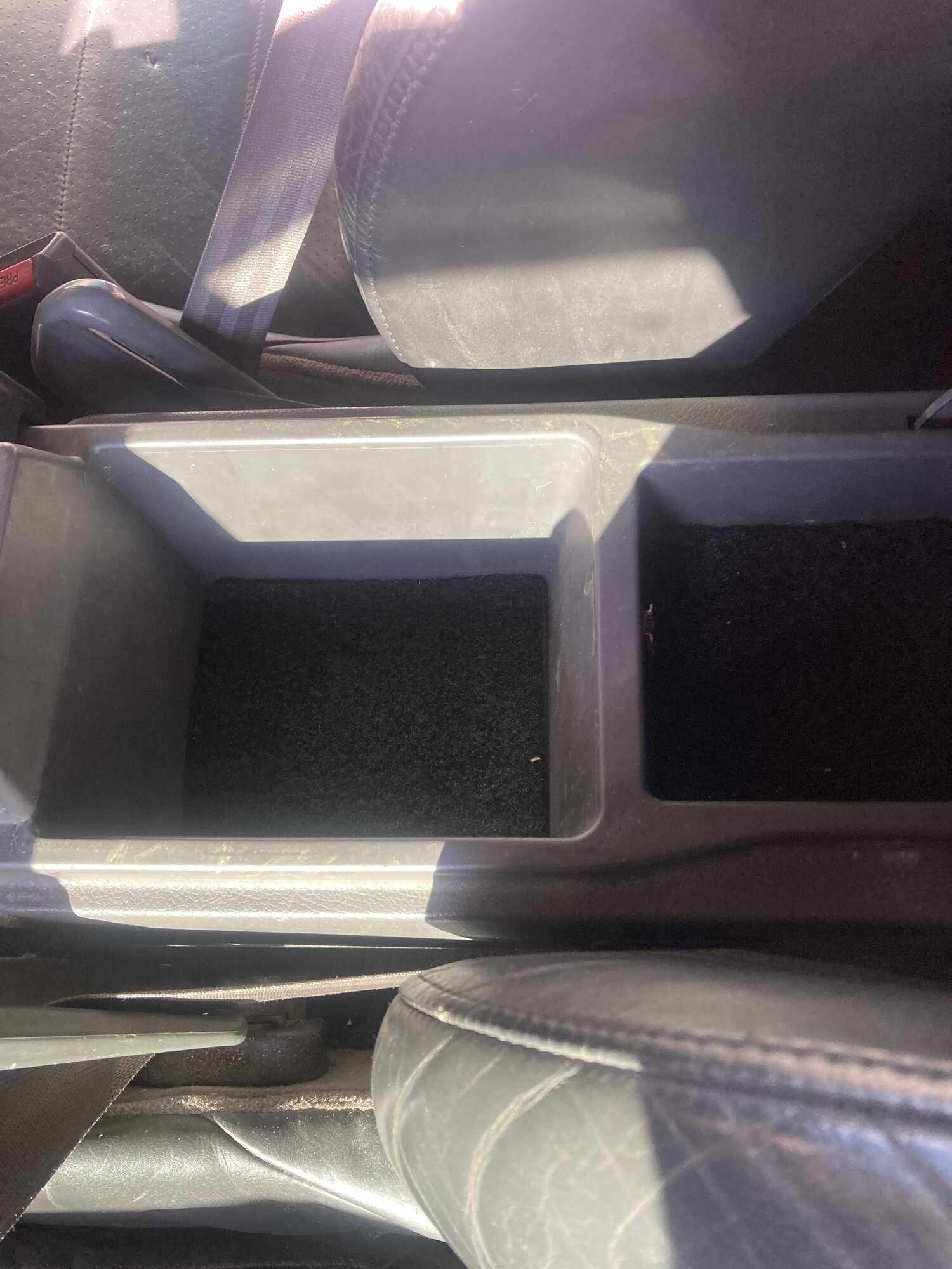

Ugh. Bare and sad.

Other than that, I tried to input voltages in Link to properly log the AEM X Wideband, but it was stuck at 4.98v. After researching, apparently you have to ground the brown wire to the ECU, or to the shared ground source of the wideband. I didn't know this, but now I do. Lol. So, I'll do that later when I have freetime next week because right now the brown wire isn't grounded at all.
Yeah the gauge needs sensor ground or you'll have a ground offset between what the gauge sees and uses for ground and what the ECU uses for sensors.
