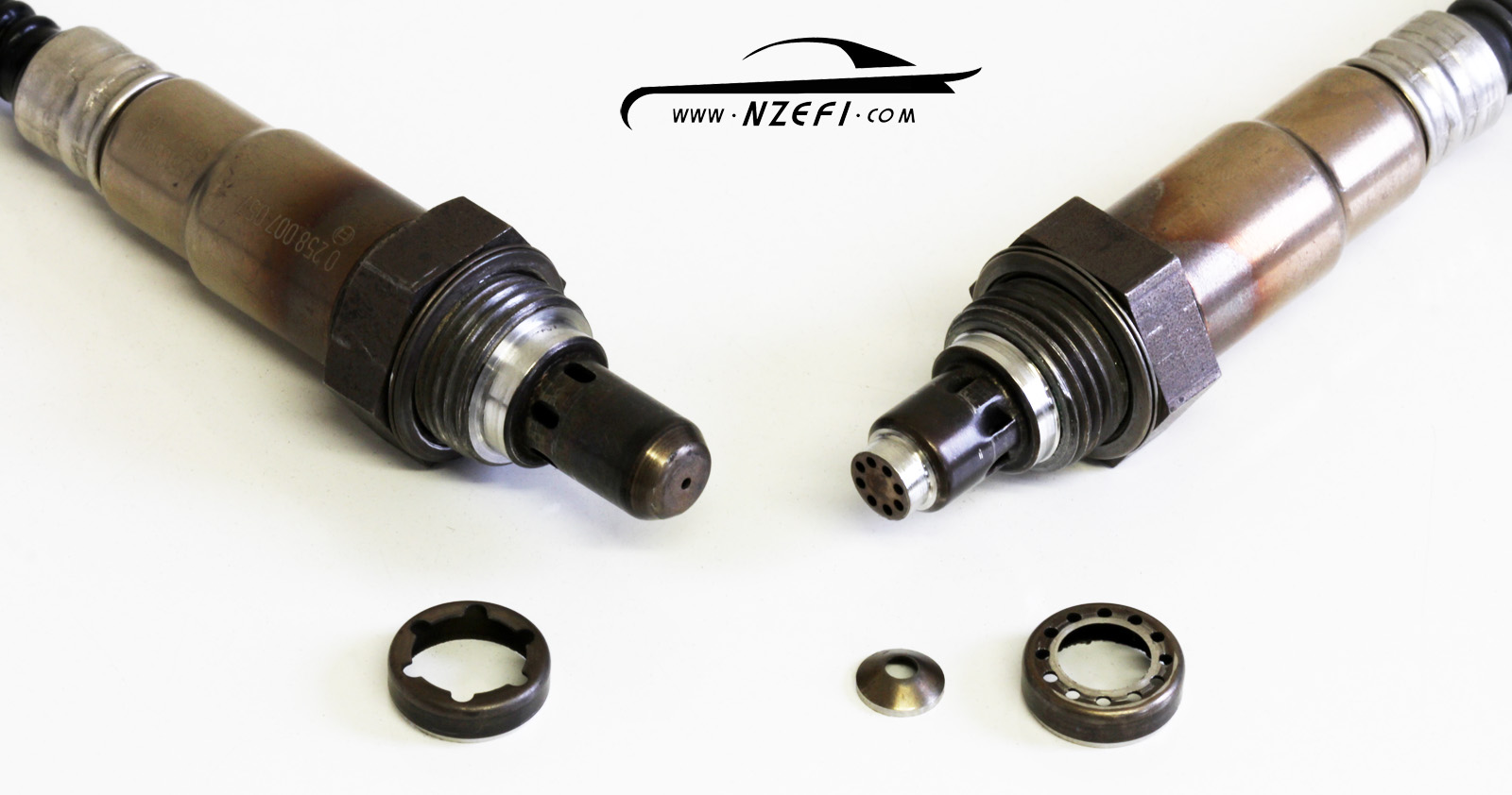

Somewhere in this forum I talked about how daily driving with my innovate mtxl killed sensors every 3 days. I dont know why everyone thinks they are the bees knees but I switched to cheapy prosport and never had another issue.
Weird. Mine has been good so far. It's an inch away from the turbo and is simulating the front O2 but I do have it wired up using a relay it pulls power from the fuse box and I have a good ground on it.
Most likely the newer style 4.9 sensor going out. They are quicker reading than the old 4.2 sensor but their lifespan is crap and are really hit or miss in my experience.
I'm not 100% on this but I think all widebands use the 4.9 sensor nowadays.

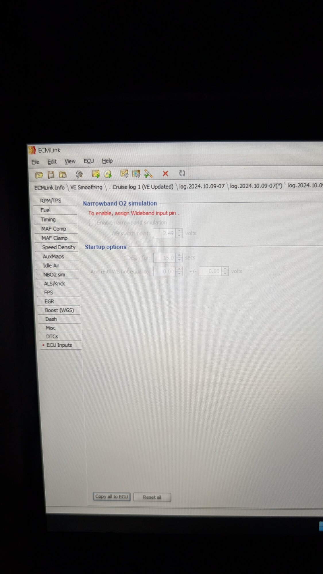

Most of the reason people kill sensors is because they turn the sensor on right away and the sensor heats and then gets blasted by cold air from the engine.
IIRC link has an option for delaying the sensor startup which is what everyone should do. I've been running the same 4.9 sensor for the last 2 years with literally issues. Stock front O2 sensor location too.

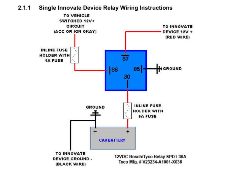

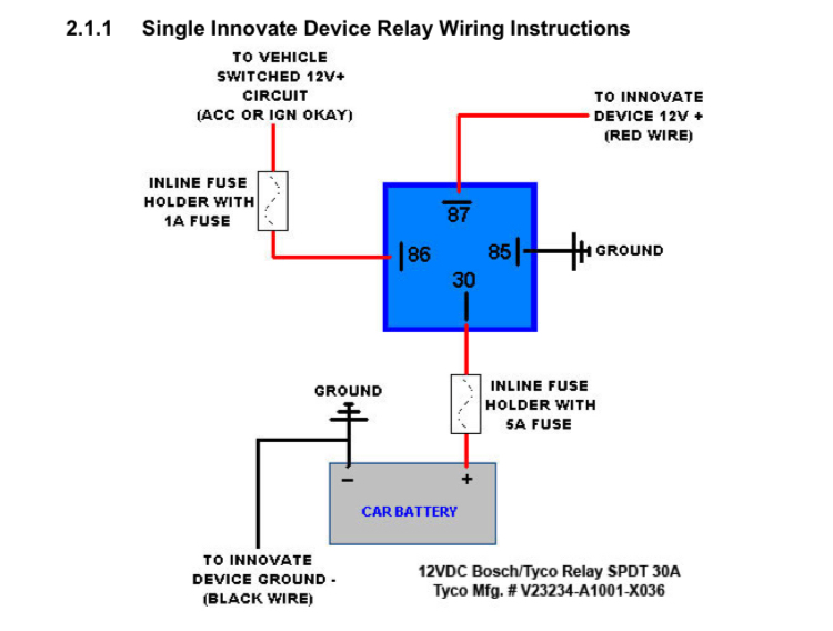

But, I wonder if that's why Chrisman mentioned the relay. Hook power to the relay and have the relay triggered by maybe a switch or a timer with ECMLink powering the relay so it doesn't turn on power to the gauge until like 30 seconds or etc? You don't really need a wideband while the car is warming up.
For what it's worth, the Innovate wideband can be seen in my logs how long it took to "warm up" the sensor, so I think even innovate tried to program that feature into their wideband and it just didn't work. The 12v power I have hooked up to all my gauges cuts power while cranking, so it can't be warmed up before the engine is running.

Yeah the delay is under ECU Config, NBo2 sim, and startup options. This should delay heating of the sensor for however many seconds you set.
While you're in this table don't forget to get your switch point voltage too.
I have mine delayed for about 25 seconds. That’s roughly how long it says it’s heating for when ignition is on.

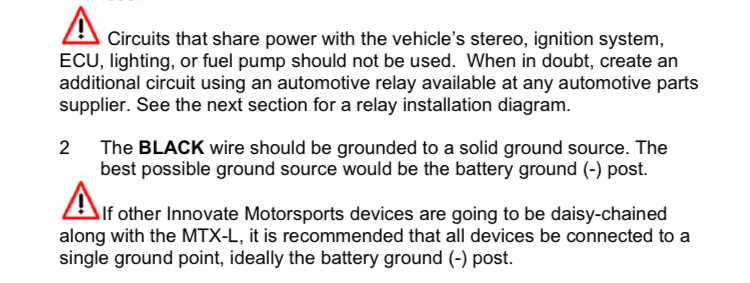

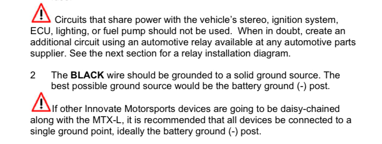

I think the instructions said to use one. I had a bunch of spare Mitsu relays so that’s what I used. It isn’t pretty but it works.
EDIT: Yes
EDIT: Yes
I forgot those have their own little control box. i assume the power is sent to the sensor by whatever is powering the box.
+1 for the relay then if going with with Innovate.
Having the innovate makes this a bit more challenging since it's on its own circuit and doesn't use the stock narrowband setup to be able to delay the sensor.
I'm not entirely sure how it works but maybe there's a way to utilize the factory heating / switched power or ground (however it's setup) to activate the relay for the innovate controller?

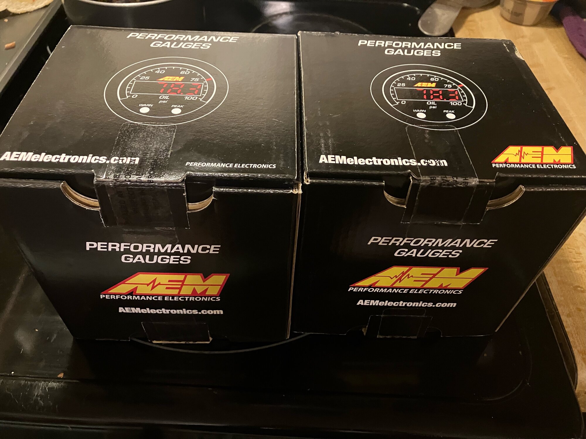

Some goodies arrived today, like 3 full days before they were originally scheduled to arrive. UPS ftw.
The temp gauge sensor/sending unit and harness is identical to the one that's currently in the car, so I am not going to swap it out. LOL. If I did, that'd result in coolant leaking everywhere and then trying to reseal it would be annoying. This way I'll have a spare water temp sensor though as a bonus. Woo.

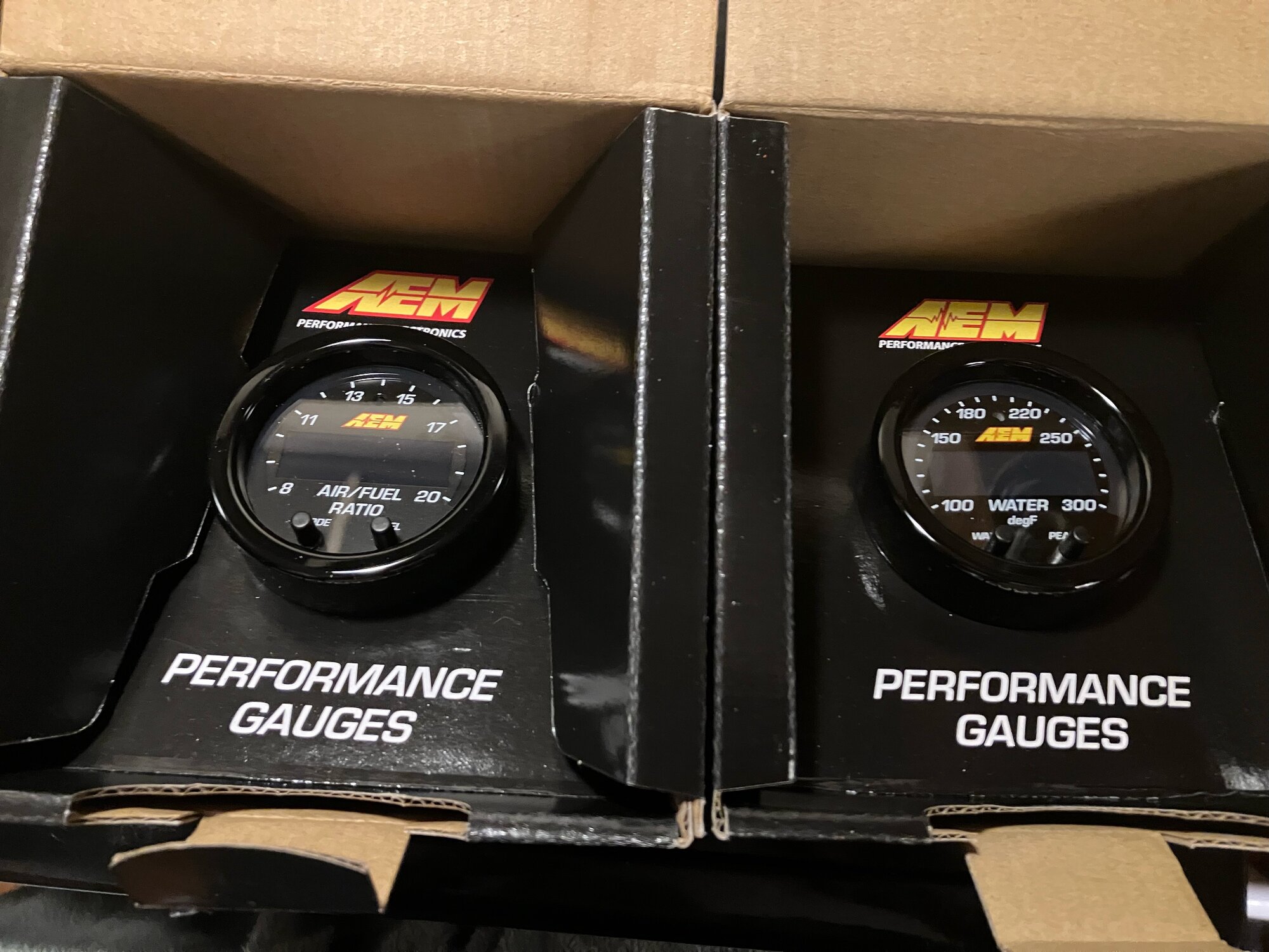

The Wideband came with the AEM/FAE sensor which according to the instructions is supposedly an improvement on the Bosch LSU4.9 sensor. Supposedly this FAE sensor is rated for leaded fuels and high temps. Curious if that's just marketing BS or if it holds up good. The good thing is, the gauge itself auto detects either sensor, so if this one doesn't last I'll try out a bosch 4.9, along with the innovate heatsink that @jdxnc recommended in another thread.
Looking forward to matching gauges. Not looking forward to fighting the wires up through the dash and out the a-pillar though.
