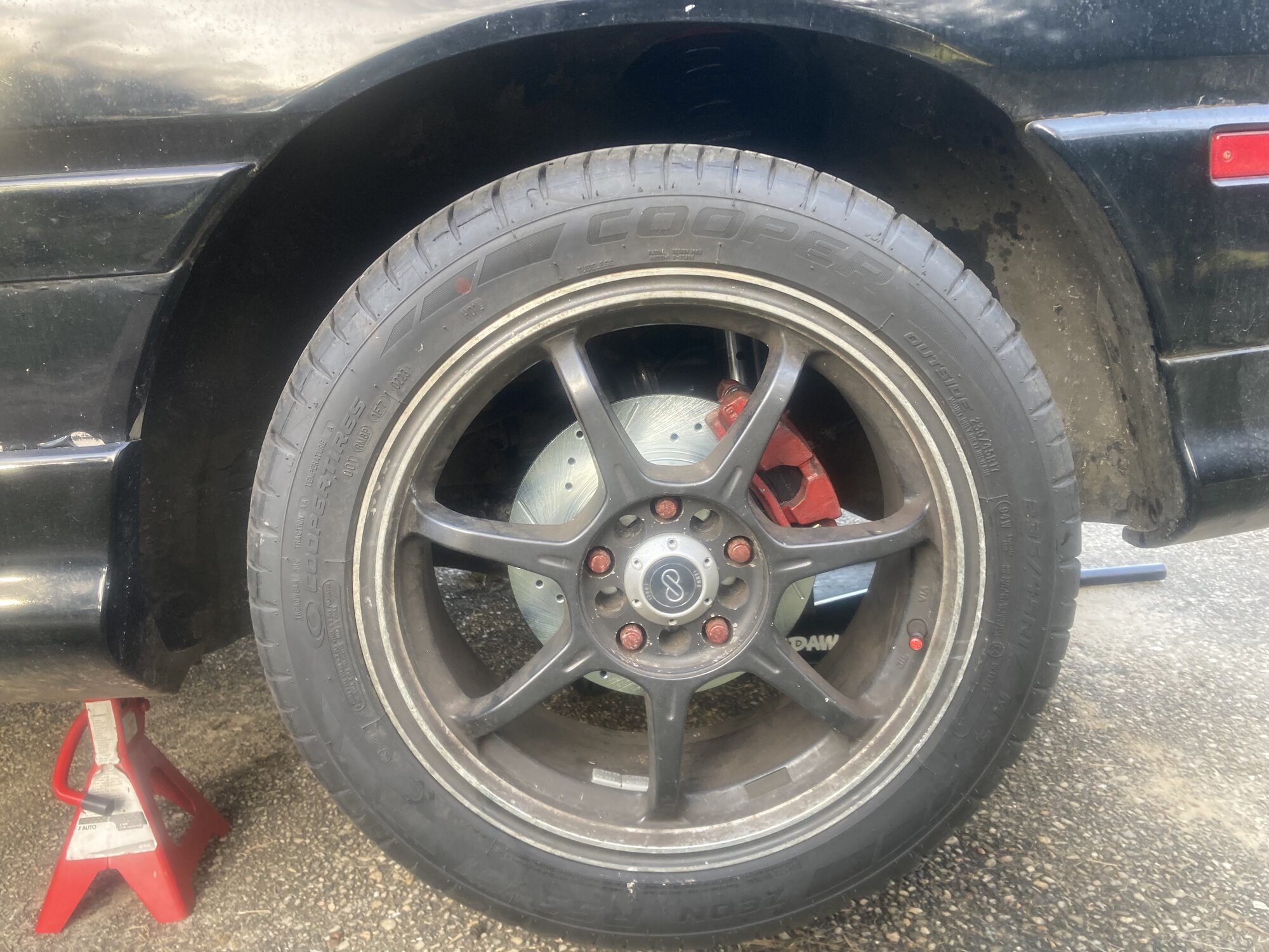

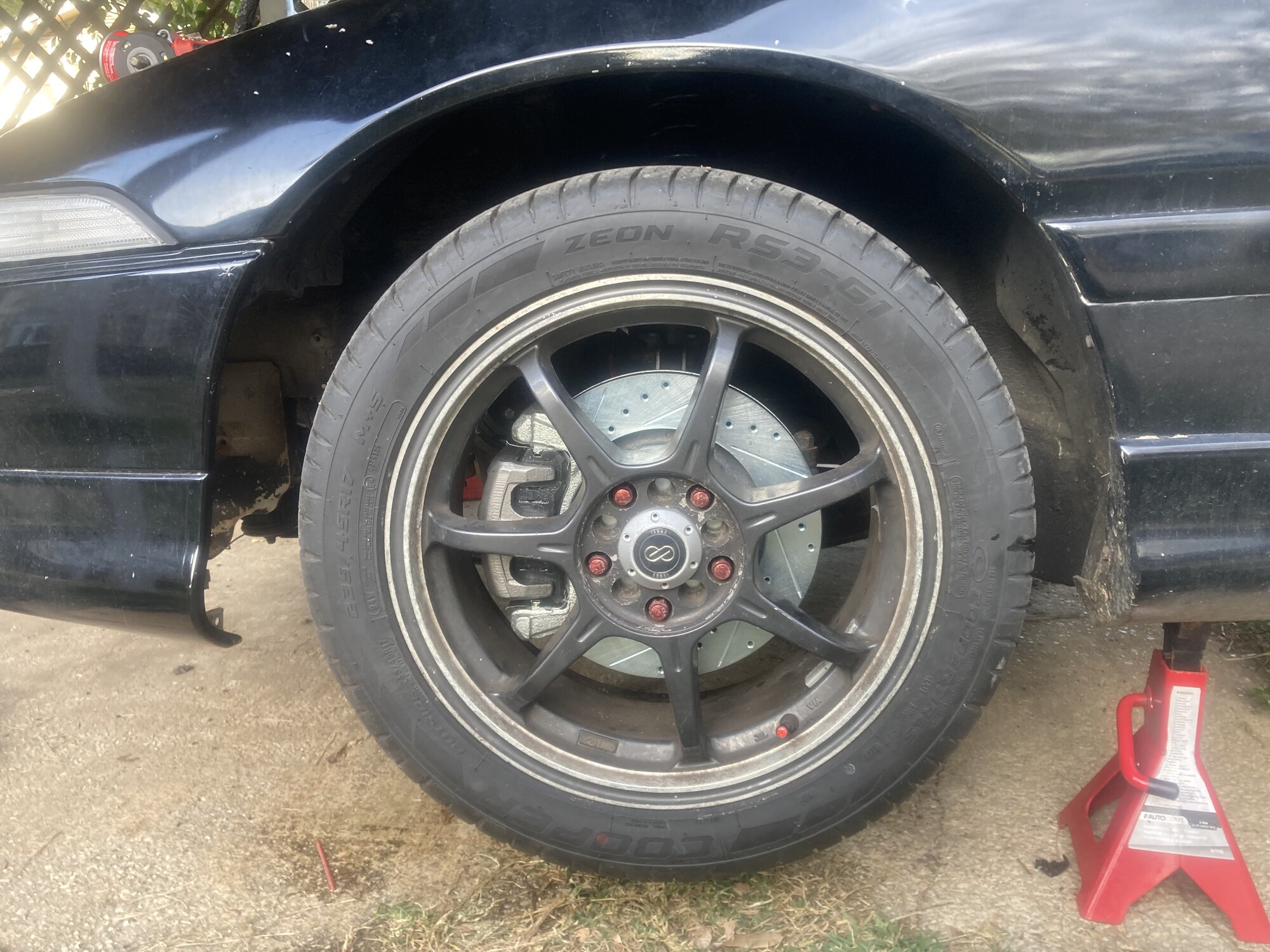

Having some rear caliper issues, so I got desperate and decided to see if the FWD rear caliper I had would bolt up easily and what I'd need to do to make it work...pleased to report it bolts right up. The e-brake cable I made work by just bolting the AWD e-brake bracket on the opposite side of the caliper(on the FWD the e-brake bracket itself is longer, and mounts underneath the caliper. On an AWD this will hit the entire hub/arm assembly). Bolts right up no sweat.
While doing this, also made another discovery. On a working, good condition rear caliper the piston should just spin with minimal effort using the proper tool, AND it should thread in very fast. I was shocked at how fast the FWD caliper piston threaded in, and how easy it was. No wonder I kept reading comments about how easy the piston was supposed to spin and etc. The AWD calipers I had would just spin and spin and spin and spin. I'm gonna take one apart next week to try to rebuild it, and also see if the mechanism is stripped out or something. Because the one this FWD caliper replaced will not thread in past a certain point. Period. It'll spin fine, just won't go down any further.
But, all in all, I'm pleased with the results. I'm gonna probably order a replacement FWD caliper for the driver's side because while it did eventually compress/spin in, it was nowhere near as easy as the other side. I'll probably just buy two new ones so it'll have brand new calipers on all four corners.
End result was this.
This thing stops absolutely phenomenally. I need to fully bed the brakes in, but even 1/2-3/4 of the way down with moderate pedal pressure results in some extremely rapid stops. It stops as good or better than my Edge, which has phenomenal brakes. Crazy. Need to do a bunch more soldering and wiring on my next day(s) off, but that's for a future post.
