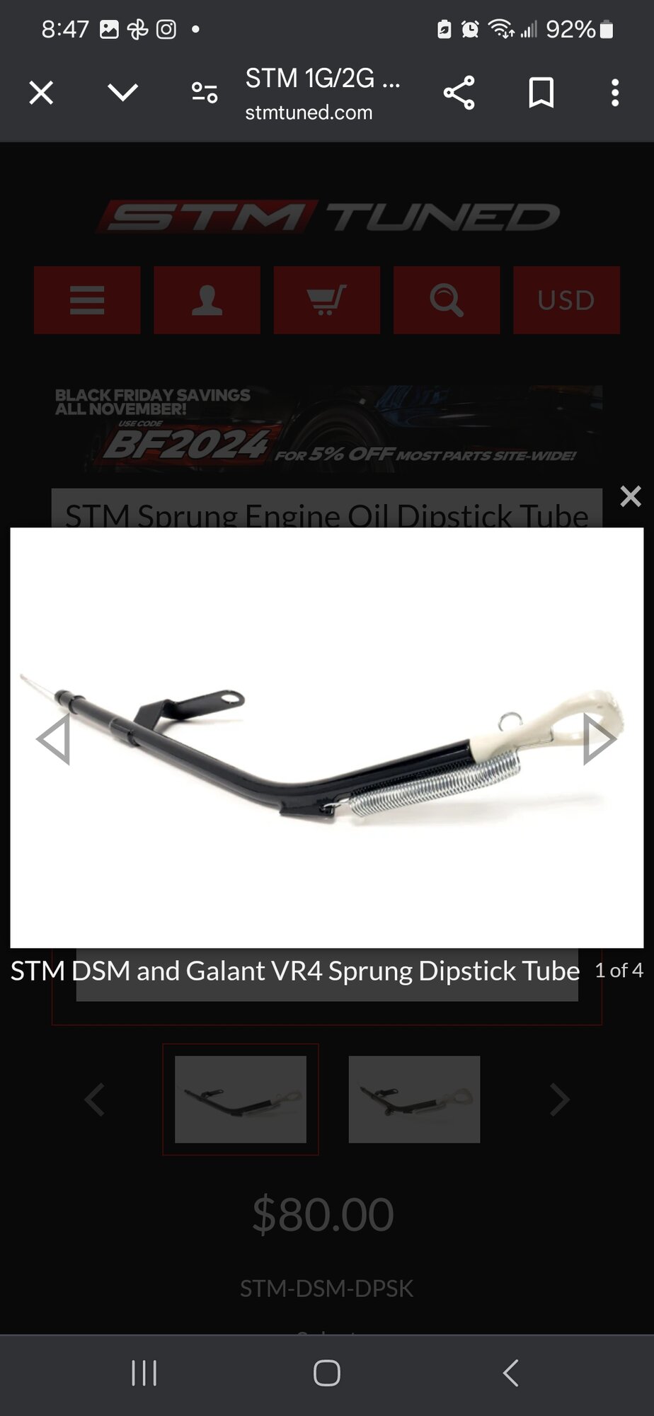

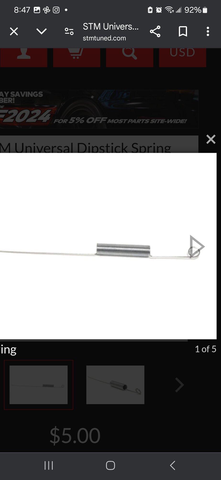

Put a small spring on your dipstick with one end held onto the tube with a hose clamp and the other end slipped onto the dipstick handle.
Dump the PCV system and run draft tube's (snot tubes) off of the pcv valve and the crankcase vent with 3/8" hose to some out of the way area OR run both to a vented catch can. It will relieve some of your crankcase pressure.
The dipstick will use a spring like this that STM sells but any hardware stores will have them also.
