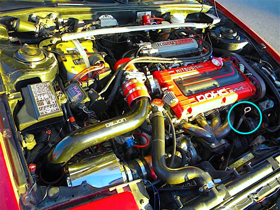

So did you ditch the pcv all together and just run one line to the can from the valve cover, and one line from the manifold? Or am I missing something, because I may end up doing this.
I’ll take a picture. :) recheck this post in a couple minutes, I’ll edit it with the picture.

Ordered a 1/8th NPT to 3/8ths Barb fitting to delete the factory PCV entirely. Not gonna lie, I am extremely tempted to order a low profile 1/8th NPT male to female 90* fitting so I don't have to fight the hose on and possibly touch the TPS but we'll see.

Don't forget that the threads on these cars engines are BSPT.

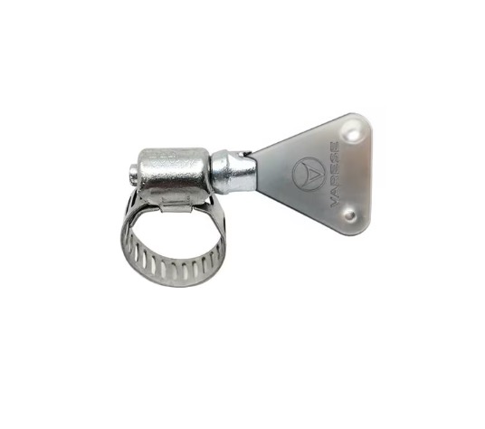

Did you just tighten the metal tube down with the clamp so it squeezes it shut, or is there more wizardry? Kinda hard to tell from the picture.
After switching the can to a vented setup, the dipstick has yet to pop out. But, wouldn't mind a little preventative measures.
