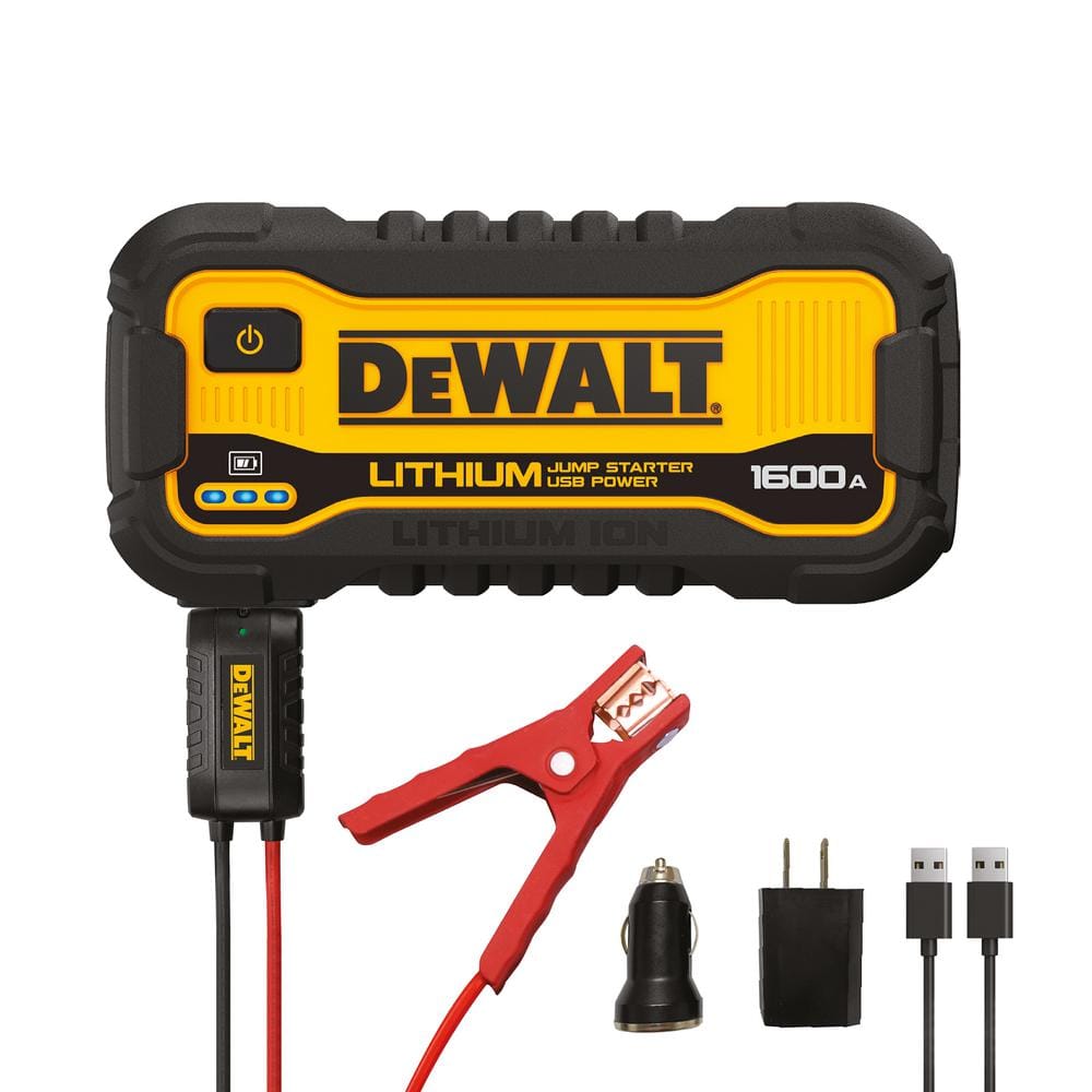

IDK. But yeah, lesson learned here. Gonna have to spend a decent chunk on a spare key from Ford, and a portable jump box like Chad/DreamChaser posted above. Still can't believe this damn thing made me bust out the window.
