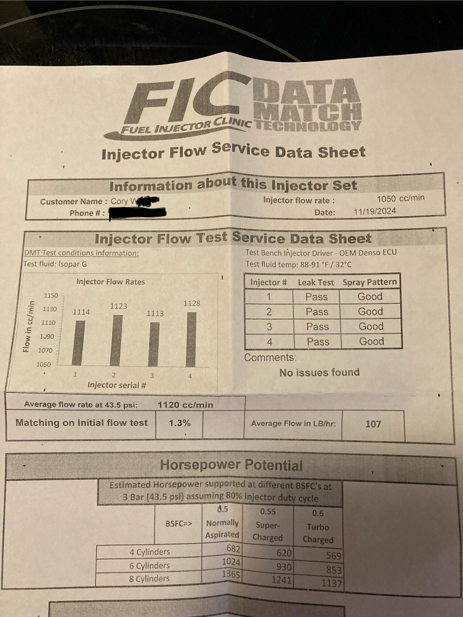

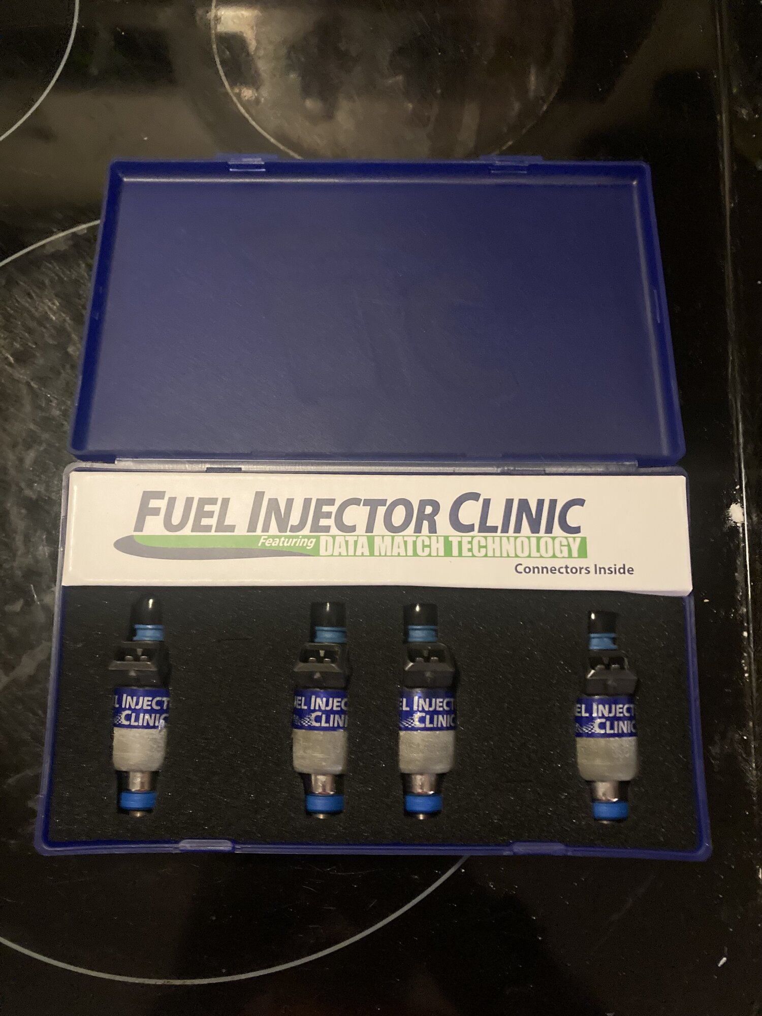

Injectors came back from FIC today. I can’t say enough good things about them honestly. I asked if I could buy one of the neat little blue boxes that new injectors come in, mentioning how I've never gotten one before, and they threw it in for free. I know it's not like a big expensive item, but I am so about the small things like this. This is the stuff that shows you give a crap about customers happiness. FIC fan for life from now on.
But, aside from that, I found the flow test to be quite fascinating. These are supposed to be 1050's, that's what they say on the side...but look at the flow numbers.
So these are actually like 1150's more than they are 1050's. Intriguing.
Again, look how cool that is. I love memorabilia like this. So cool.

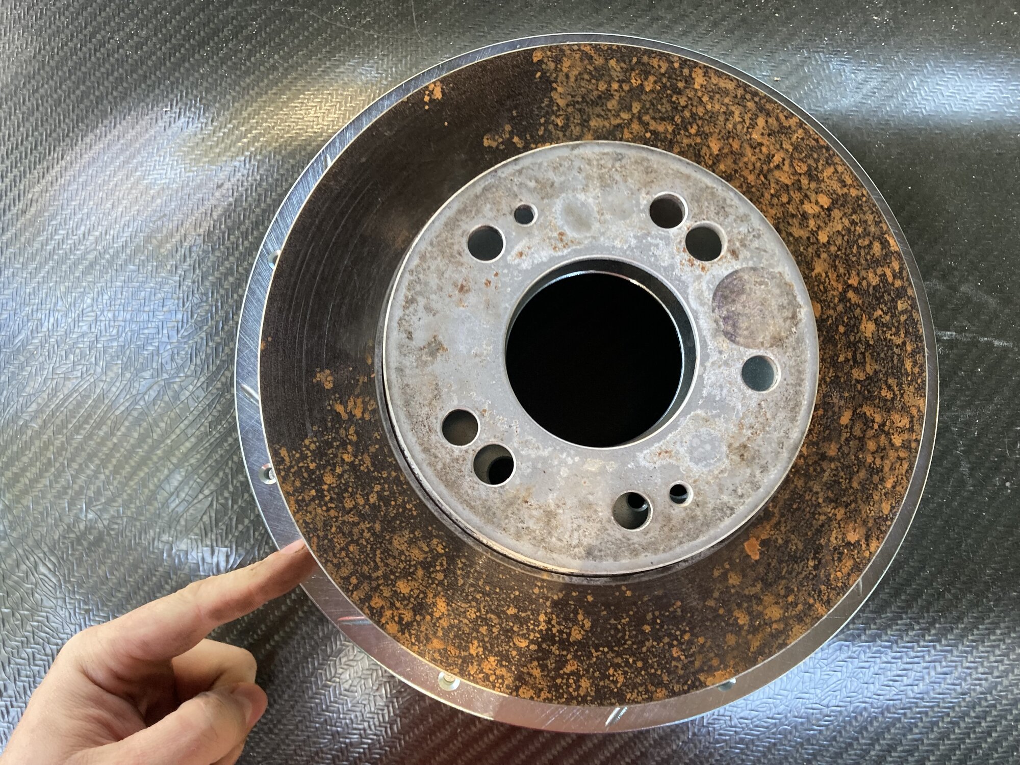

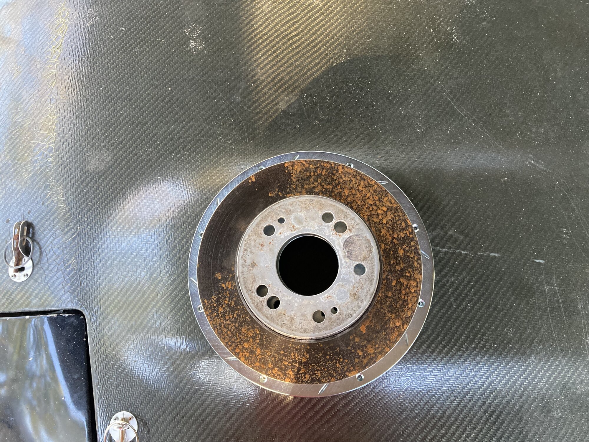

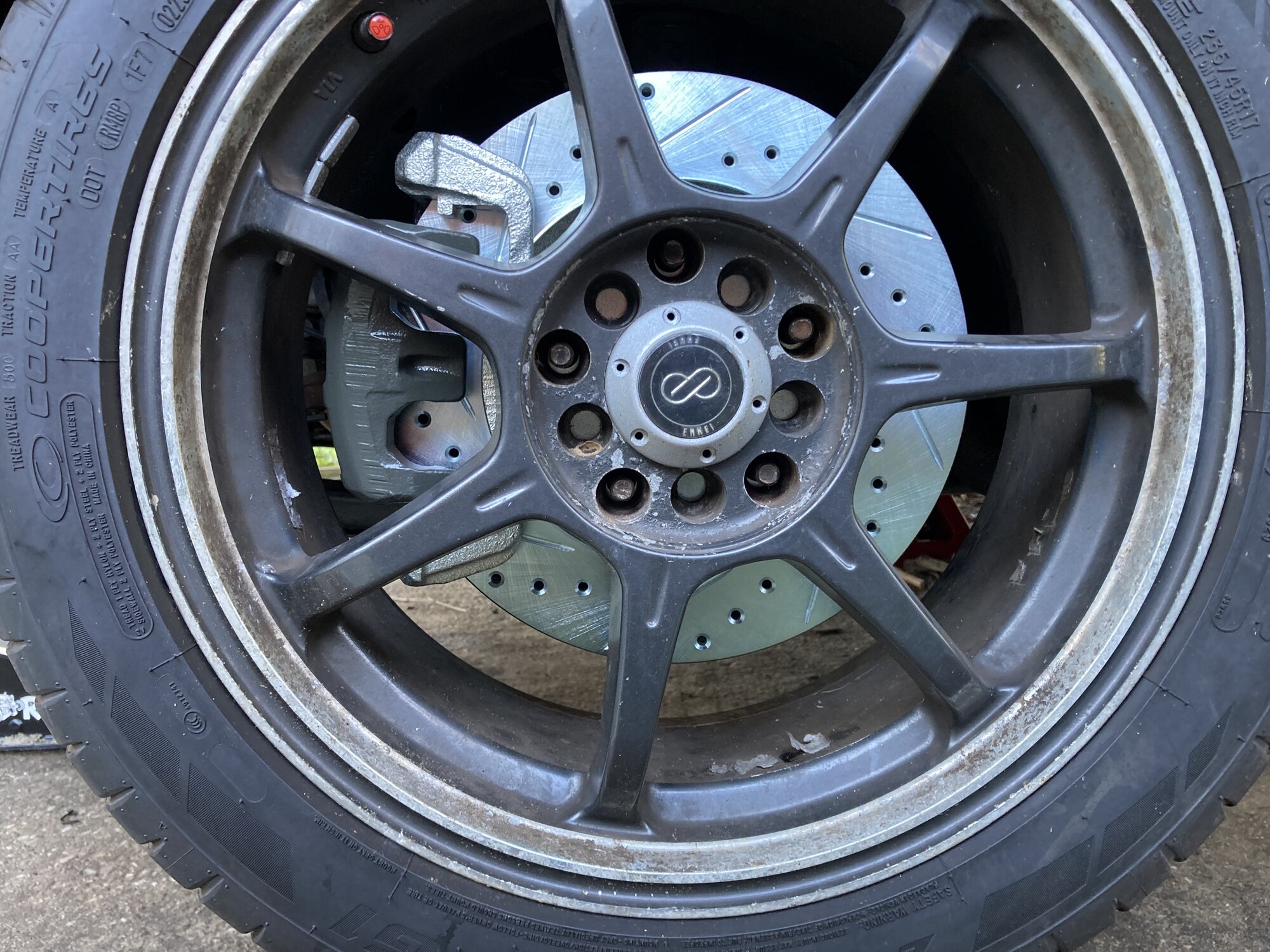

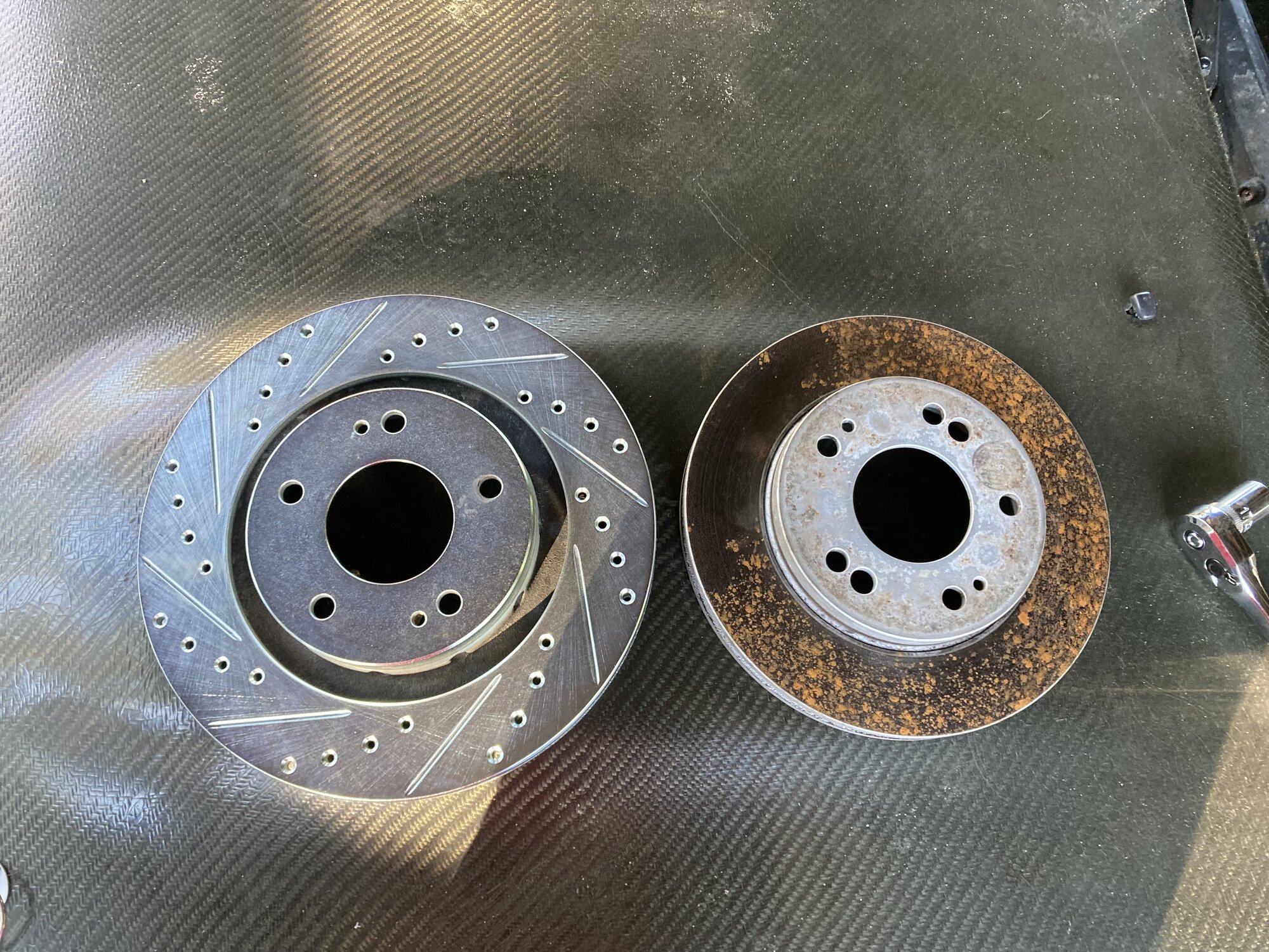

Probably gonna paint the caliper and bracket red, but either way I think it looks awesome.
It's definitely bigger. Full inch bigger diameter wise. And as I tell my wife constantly, that extra inch matters!
How long did the whole process take? Thinking about sending mine out to be cleaned before I start trying to tune.
They arrived at FIC very late Friday evening, and they were back in my hands today. So honestly, it only took like 3-4 days(not including the weekend because duh) once they had the injectors in their hands to inspect, flow, box, ship them out, and them get to me. And I didn't even check the box for "expedited service". They're fast AF.
