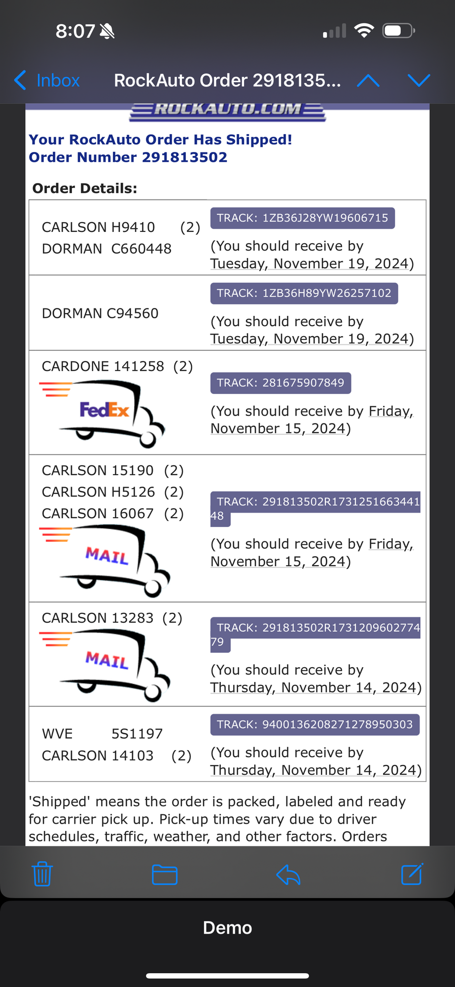

Kinda cool, was checking around on the status of my order from RockAuto, and discovered that the price of the caliper + bracket that I just bought, legitimately just went up to $51.79. I paid $39.79. Crazy. They weren't even marked as discounted or anything. You gotta watch RockAuto prices like a hawk I guess.
Still, stoked to have these coming. Looking forward to some nice stopping powah.
Also: I added a couple rebuild kits for the rear calipers in there. I think the driver's side functions fine, but the passenger side caliper is suuuuus.
