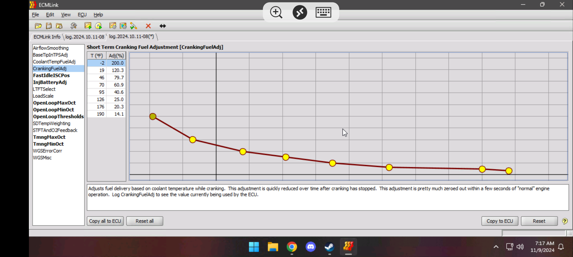

Quick question, is there anything in a tune that can make these cars hard to restart when hot? Is there like a cranking enrichment table where I can add or remove fuel on cranking based on temps? I’d be curious to try to pull fuel when it’s hot and see how it restarts VS adding fuel.
Because I swear on the maf tune it was never hard to restart. It only got hard to hot restart on SD.

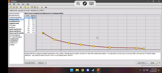

There is a cranking fuel adjust table in the DA page based on temperature.
Also log "fuelcrankingadj" and that will tell you where in this table you'll need to adjust fueling while cranking when hot. I'm honestly surprised you have issues with it firing on gasoline. Should just light right up honestly

In my case, if I do not have hot start enrichment, it is hard to start. Without it, it would barely catch, and the o2 would read close to 14.7, and slowly catch a bit more each time until the idle stabilized. Had to nurse the throttle just to keep it alive.
With the hot start enrichment enable, It fires over quite strong, and the o2, goes rich, into the 10’s and then settles back to 14.7.
