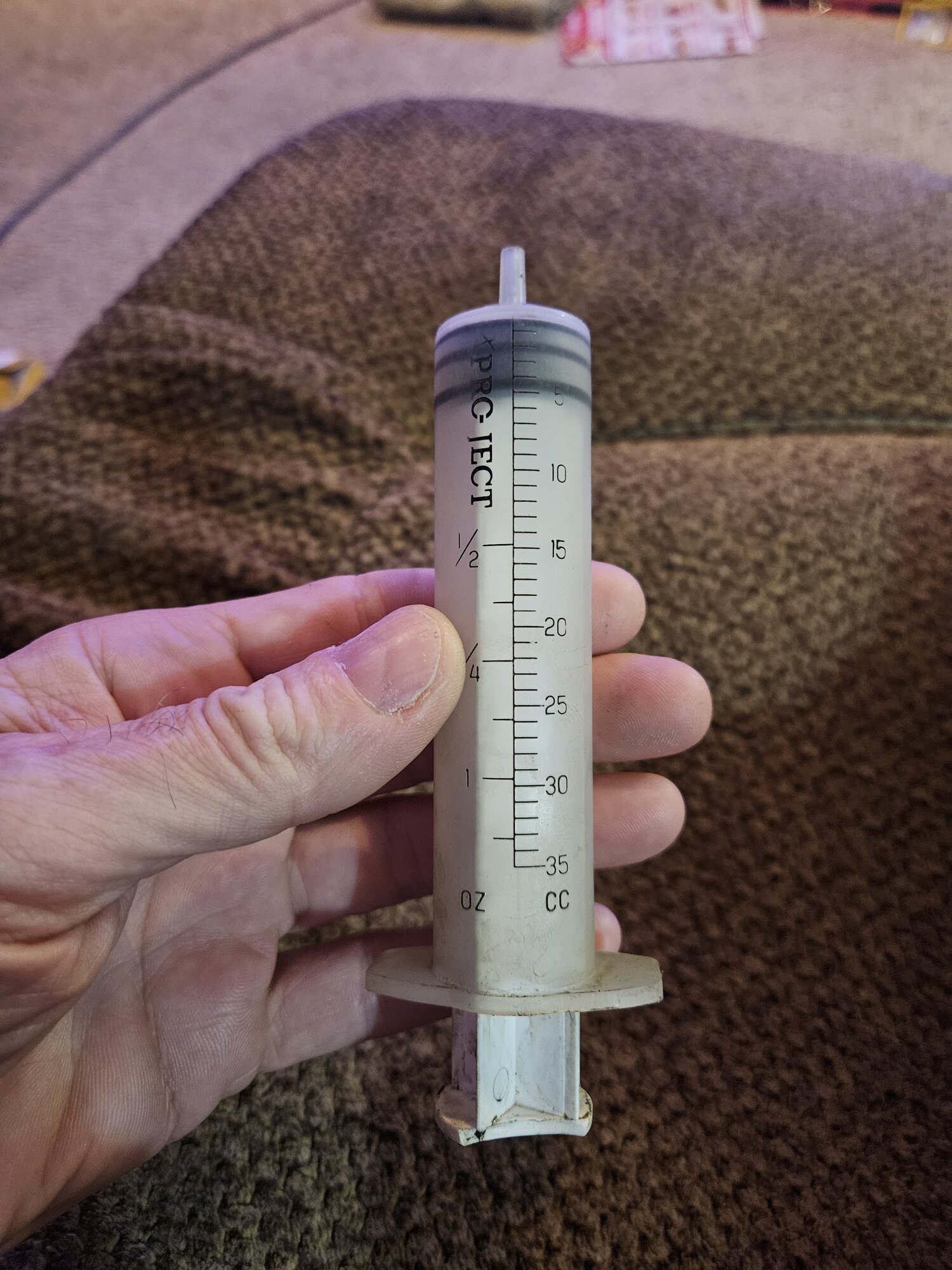

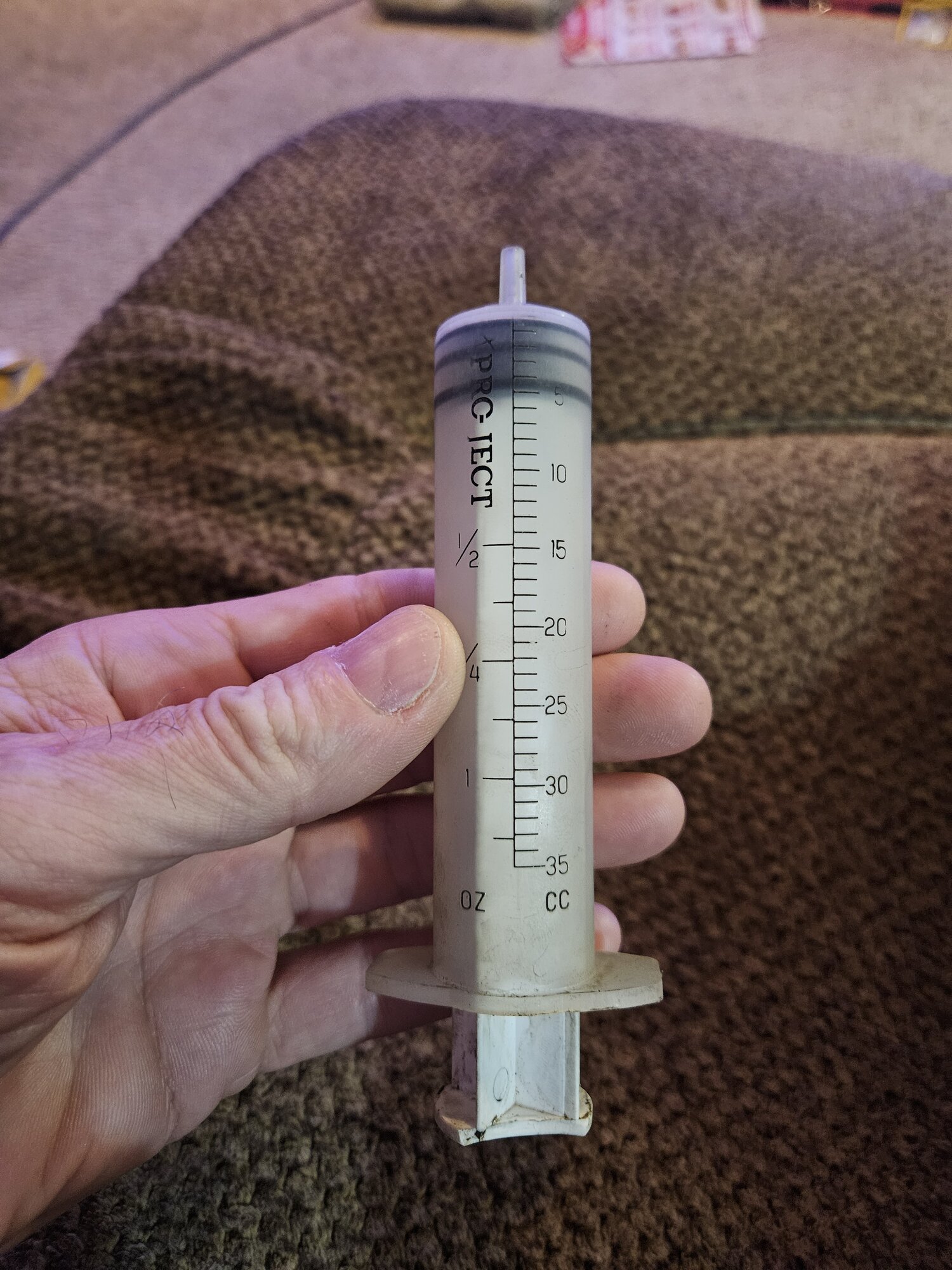

Hey.....you drive an ambulance? Don't you have access to a big syringe like this? I suck brake fluid out with it and you can get one at a animal supply store (Atwoods, Tractor Supply, like some of those that sell livestock supplies and vaccines etc). It will pull a vacuum super easy.
This is also a great idea. I have access to medical supplies of all kinds including syringes.
All jokes aside, I did suck/blow on a mechanical pressure gauge once. It was the first boost/vacuum gauge I ever bought, and I quickly realized that it's not meant to measure pressure from a human. I couldn't get it past -1hg and not even creeping to 1 psi. That was obviously a light hearted joke but I've been there LOL
My "vacuum bleeder" often gets repurposed from bleeding hydraulic systems. It's really nice to own one.
I inherited the one I got from my Father, its not deluxe - its plastic actually - and the lid to the fluid container has cracked - but the hand pump still works. 🫡

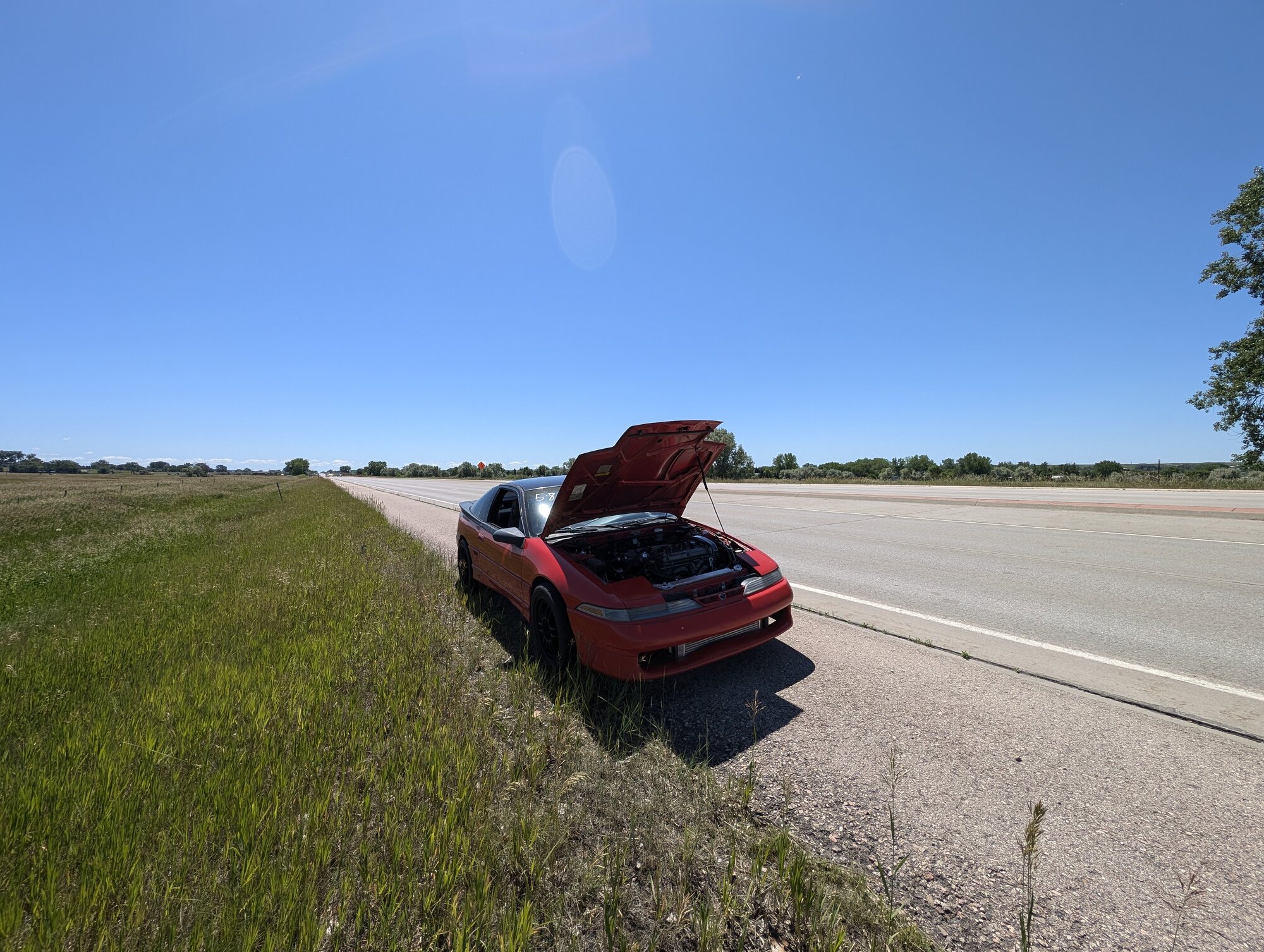

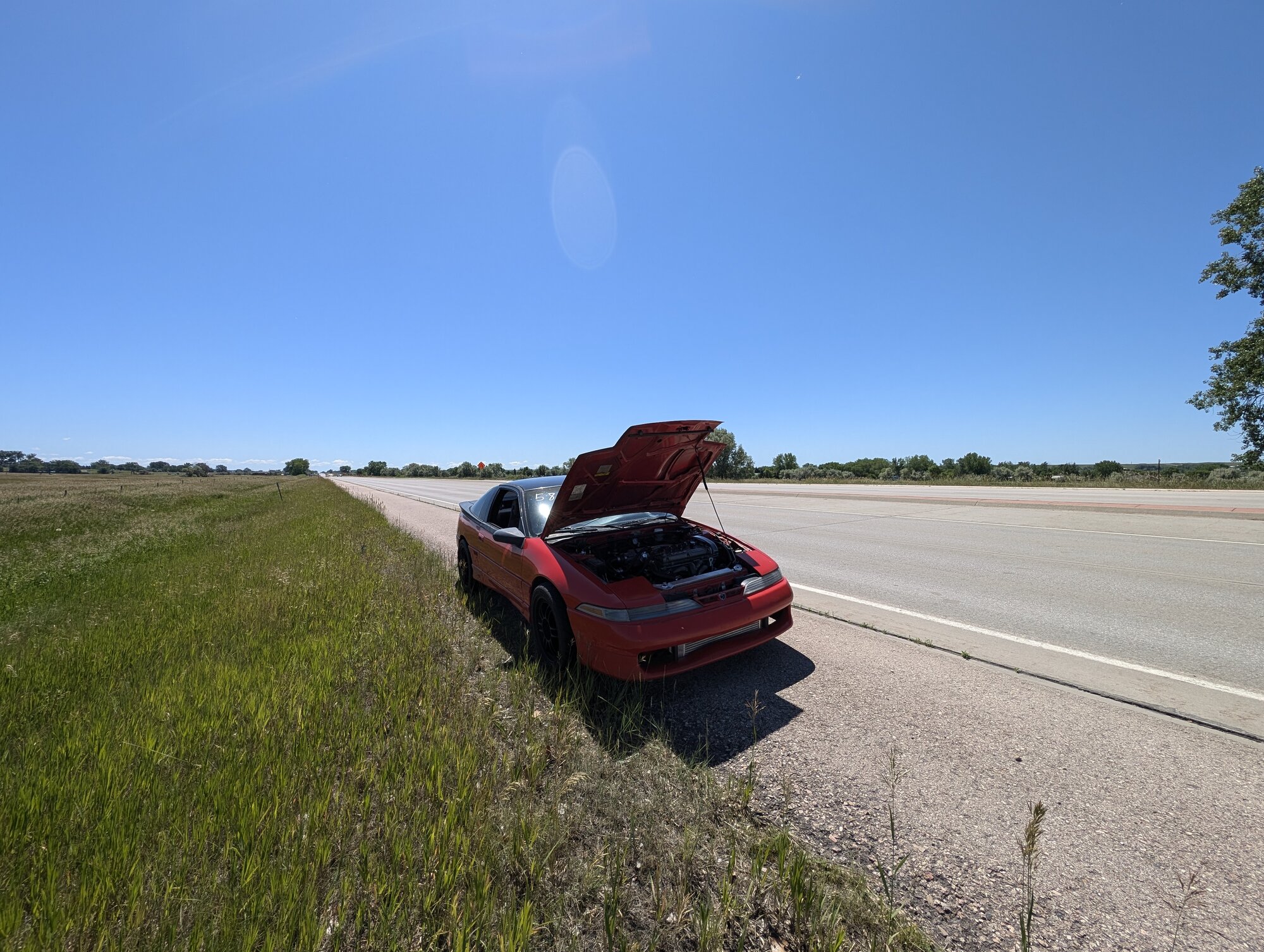

So, think I should drive the car to work tomorrow or just let it sit? It seems like it's not wanting to die randomly(at least not more than usual), and it did great today. But I'm conflicted. I feel like I should drive it, but don't know if I feel like it. It's not a lack of desire, but it is a little bit of obligation.
So I'll let yall decide. Drive the shit out of the Talon to work, or just let it sit until I can mess with it some more two weeks from now.
Depends on your tolerance to work on it on the side of the road or parking lot if something happens LOL
Personally I would be letting her sit until she was happier with my actions, but I don’t want to roadside mechanic if I can avoid it.
I have too. That shit brought back memories immediately. LOL.
I’m not like afraid of working on it on the side of the road, but the thing is when it comes to my work showing up late is essentially abandoning a patient. You’ll be fired immediately. So if the dsm leaves me stranded I’m screwed.
That's a very compelling reason then, you made the right choice then!

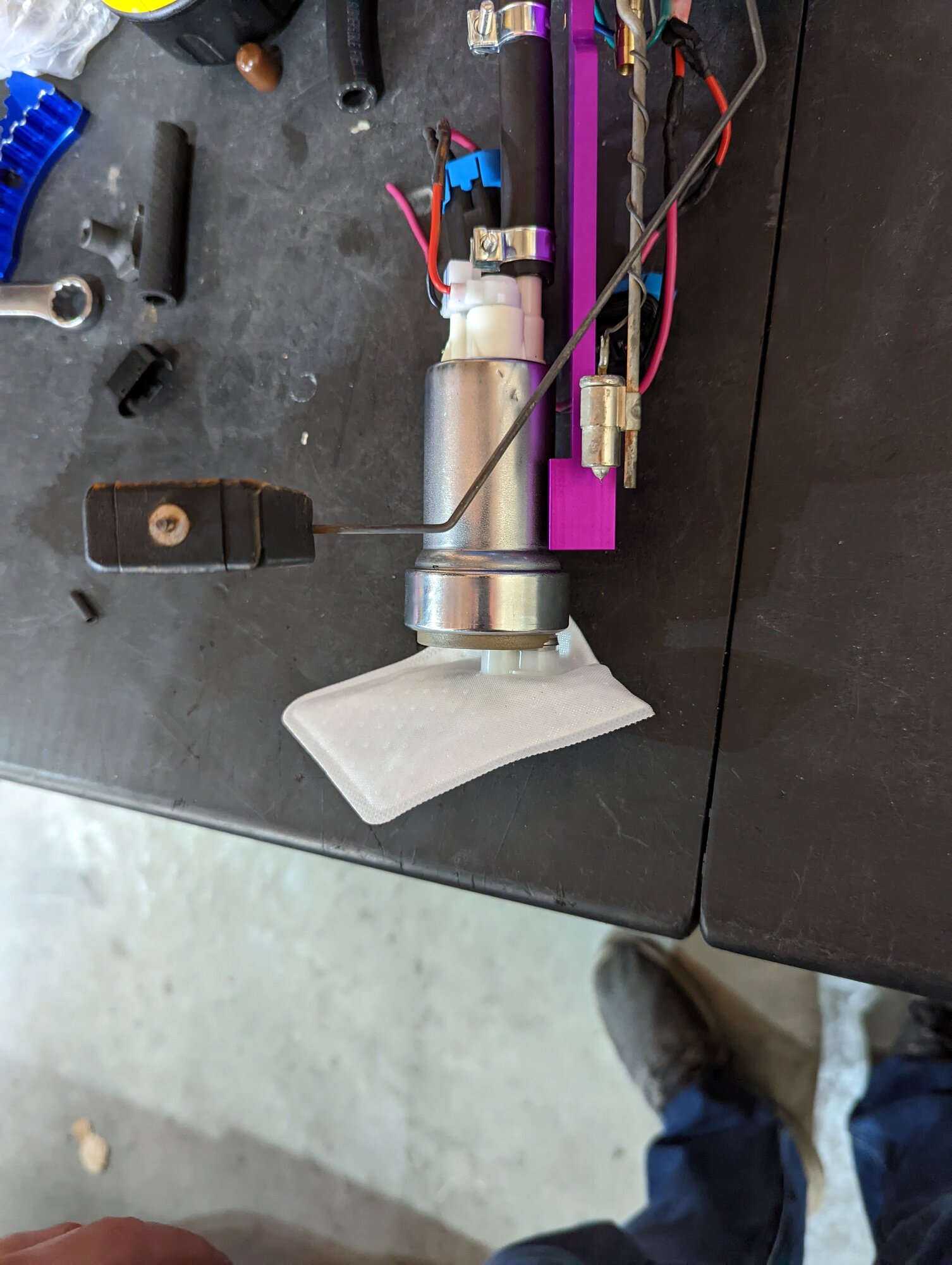

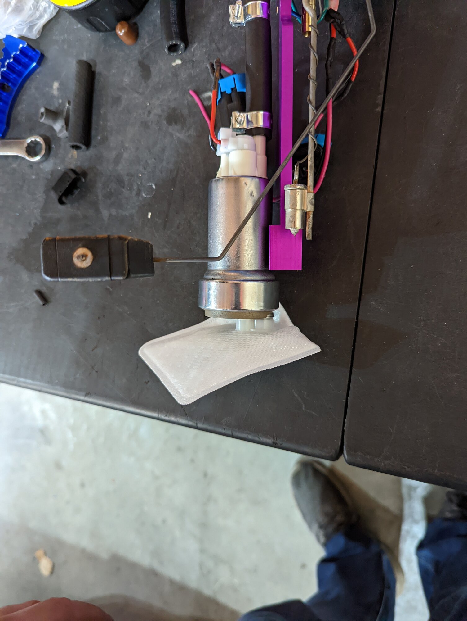

Also have a new sending unit coming my way to replace the bad fuel level sender on my current one. So that’s exciting as well. I need to run a wire from the new unit to the gauge cluster though so the idiotic low fuel light goes away. The wiring on this poor car really does need to be completely gone through.

IIRC the light comes on when the fuel falls below the little node on the sending unit which I think closes the loop and turns the light on?
I'll be 100% honest pulling the dash is not bad at all. Once you know where the bolts/screws are it's like maybe a 20 minute job. Just be sure you've got room to open the doors a good big.
Yeah it does. It’s a thermistor. Mine works and I checked it with my multimeter but the light won’t ever go off. Lol. I’m gonna ground the wire later and see if the light goes out. (And by later I mean in like a damn week when I have time off LOL)
