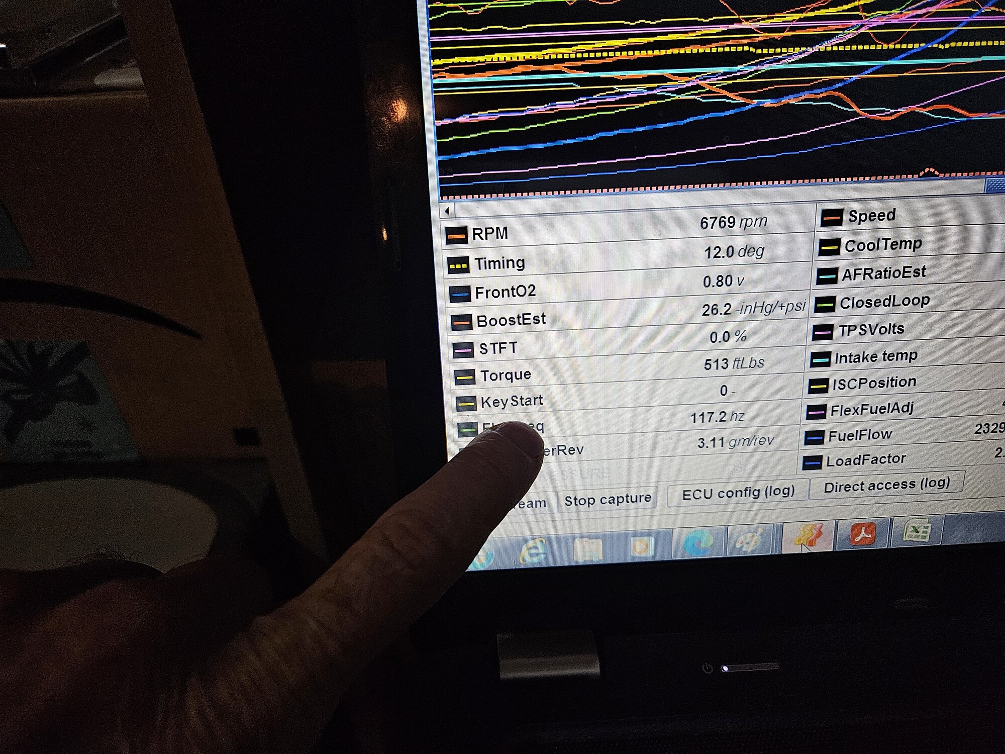

Is "Key Start" working when it's hot. That's the only time I had trouble getting my car to start. It's very important. @steve helped me figure that out, and thank God. It was almost impossible to get to start when it was hot and it wasn't working. I can't remember what he proposed, but whatever it was, it cured the hot start issue. It's been a while since we dealt with that. Log it and you can see it change from "0" to "1" on your cold starts. It should remain the same during hot starts.
