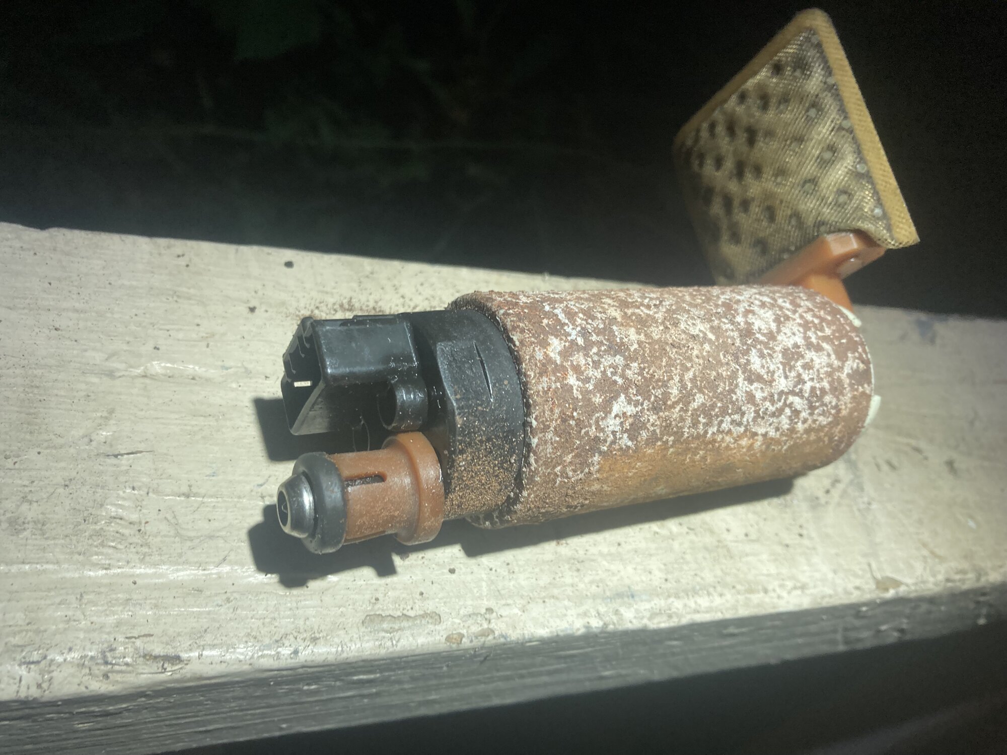

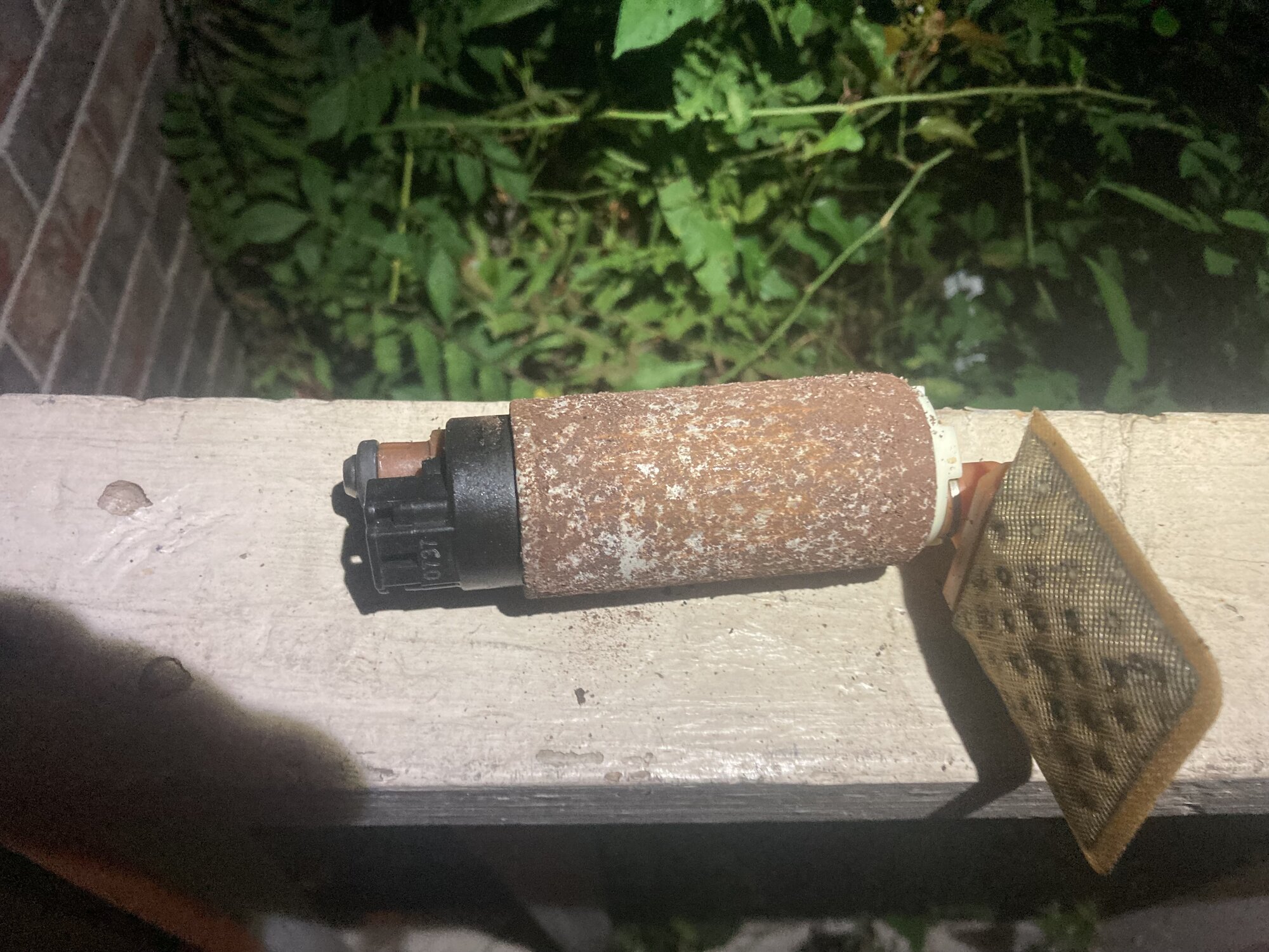

Not being coy here but does anyone see a problem here? Turns out the fuel gauge isn’t a liar and the tank is legitimately half full. But the fuel pump is rusty AF and there’s only one o-ring at the top.
Why would it act like it was super low fuel? Bad fuel pump?
Ordered an Aeromotive stealth 340. Because this one is so rusty and I don’t know if it’s a 190 or 255, and there’s just too many questions honestly. So yeah, now I know what’s gonna be in there and it’s room for me to grow a bit.

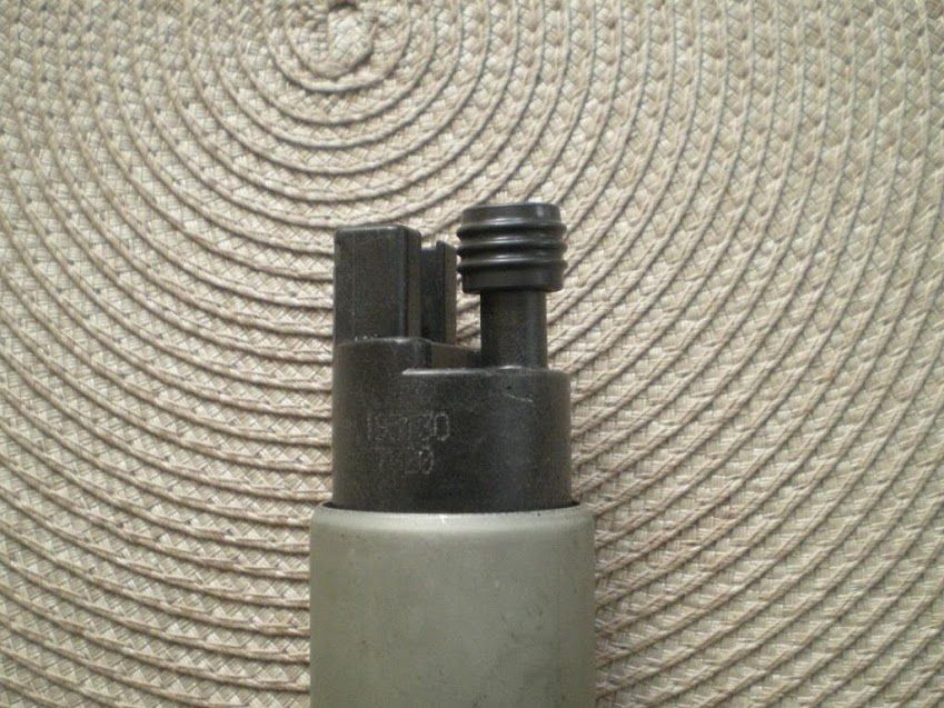

You are missing the hat that goes on top of the o-ring. Also... Did you put that pump in? Looks like it had been exposed to a lot of water then left to sit.
This could explain a lot of your fuel/ tuning issues. What does the inside of the tank look like? My tank is spotless and I still had crap in my 3 year old injectors on a running car with a perfectly clean fuel lab 818 paper filter.
I would recommend a new pump and sock, filter and having your injectors cleaned and flow tested. Along with a flush of the lines.
This could explain your rich/ lean mess.

I knew there was something missing! Now to try to find it for purchase…
But I did not put this pump in. Previous owner did and then the car sat with an empty tank for like a decade.
I’ll plan to get the injectors cleaned and flowed in that case. New pump, sock, and etc is on the way. I honestly may go with new feed lines as well because I hate the current ones and the OEM fittings are still there.

A New hat comes in the walbro install kits... But that's 33 bucks from STM for 1 part needed.
You sure it isn't wedged in the assembly? There is also a comment on the Aeromotive 340 that they had to modify the rubber spacer that goes on the bottom of the pump and the kit didn't come with one.

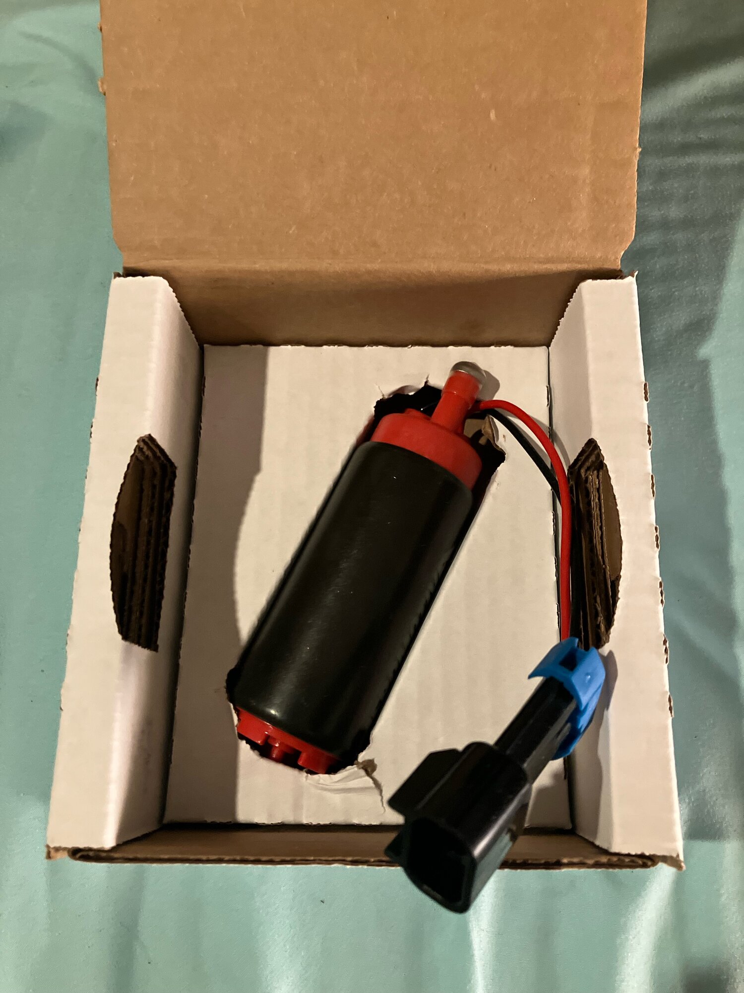

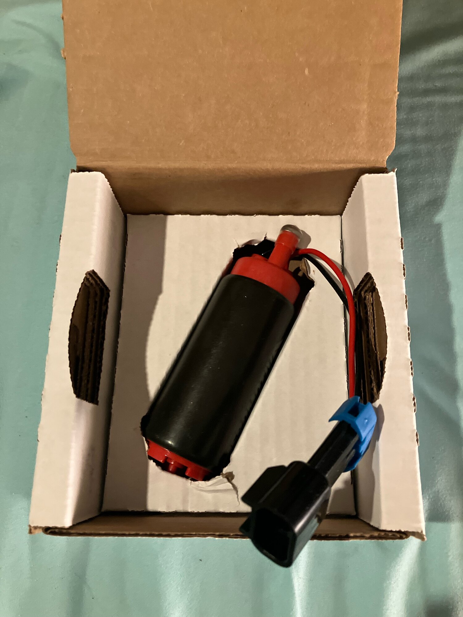

Ditch the o-ring and spacer and go down to a Toyota dealership and order part number: 23239-21010. It's an improvement in every sense of the word, and it shouldn't cost more than two bucks.
@99gst_racer made this post awhile back, and I just wanted to post it here in my build thread too. Because I'm gonna use this same toyota part on my new fuel pump instead of the stock o-ring and spacer hat deal. Very curious how it works out as I need a new o-ring anyway. I'll take pictures and stuff too, to make sure those pictures don't go anywhere. Great info!

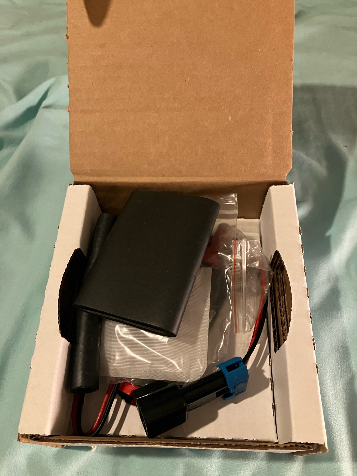

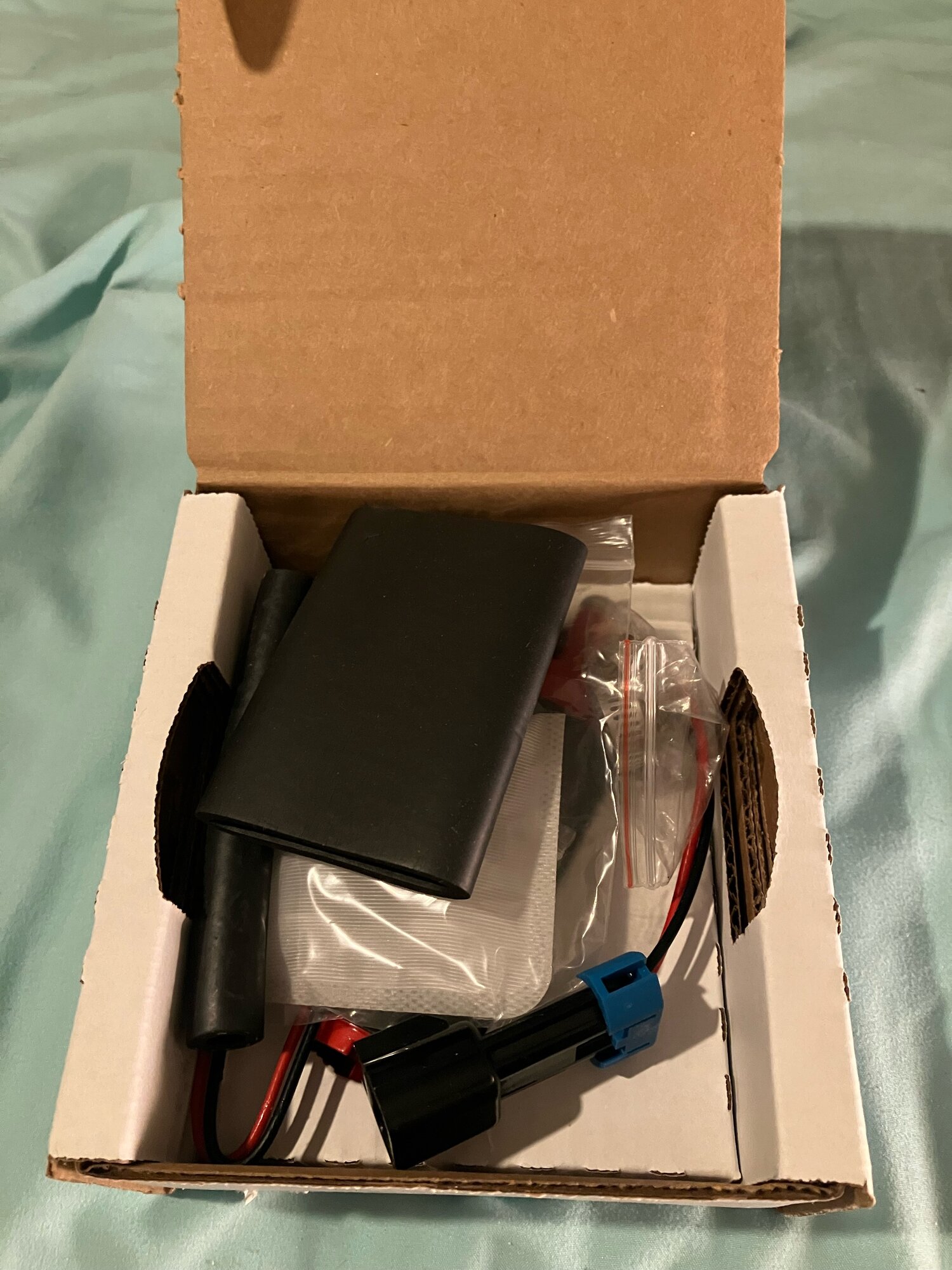

Forgot to include pictures. I know everyone's seen a fuel pump, but can't resist that shiny new part photo op. We'll see how much "modification" this thing requires. It's the exact same dimensions as the Walbro that came out, the only thing I can really see is the fuel pump sock is physically bigger. Either way, I'll post up how it goes. Depending on how tired I am or if I get a late call, I may try to install it after I get off work tomorrow morning.

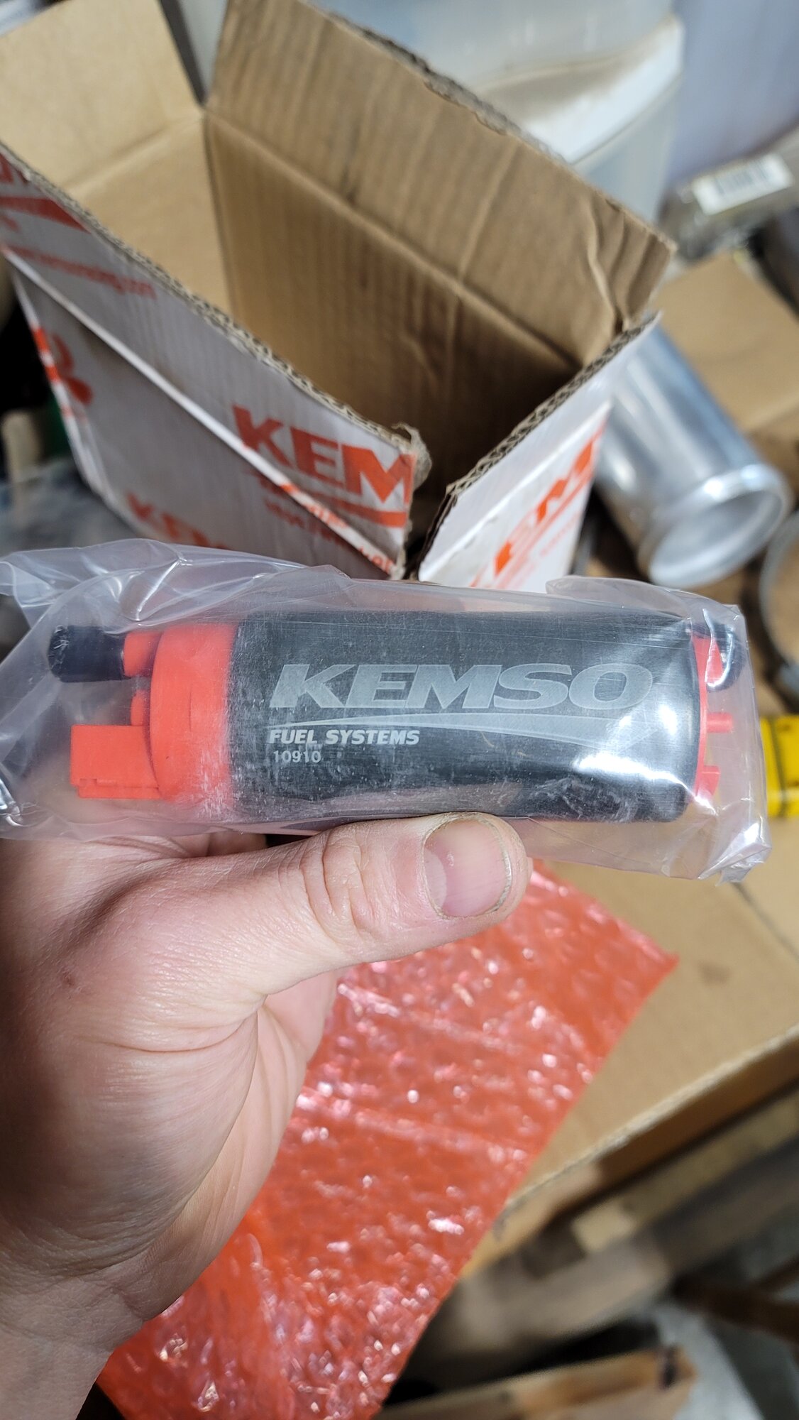

I may be dumb but I've been rocking these Kemso 340s. There loud but not one has failed me, I dont know if there a Chinese brand or what. I used to run those aem ones.
