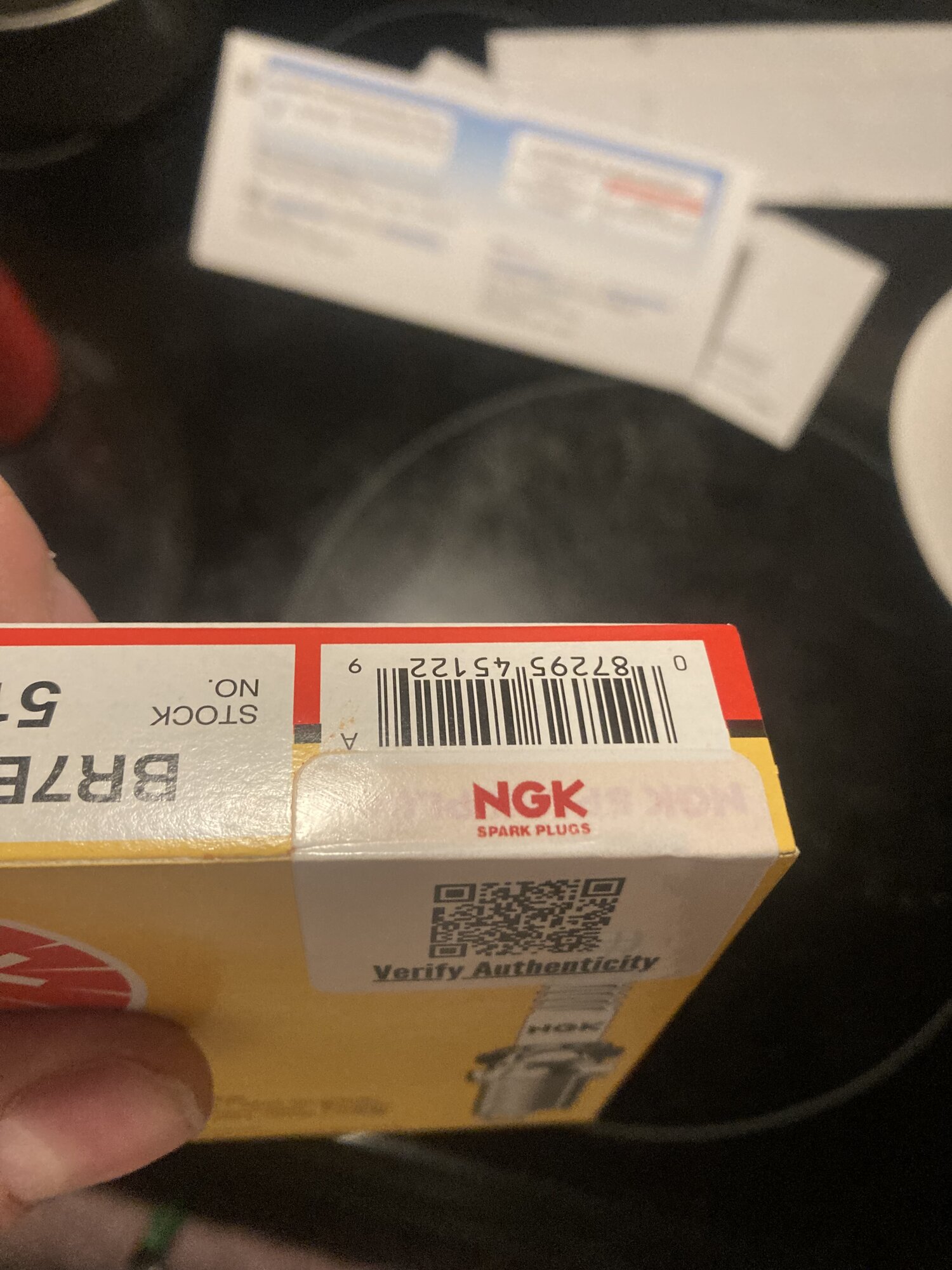

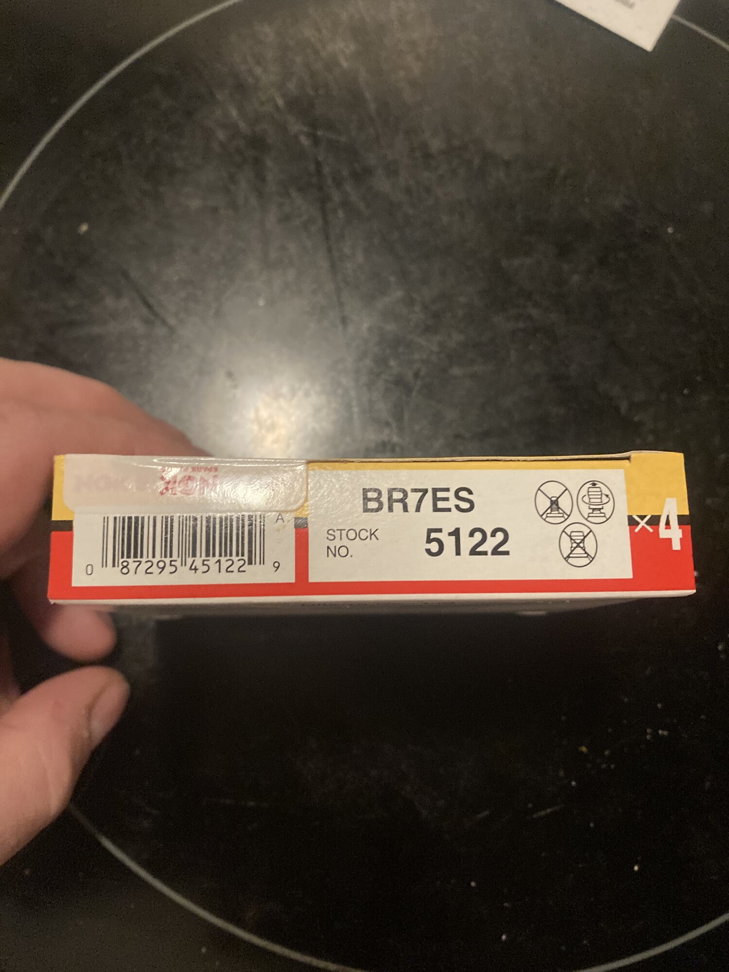

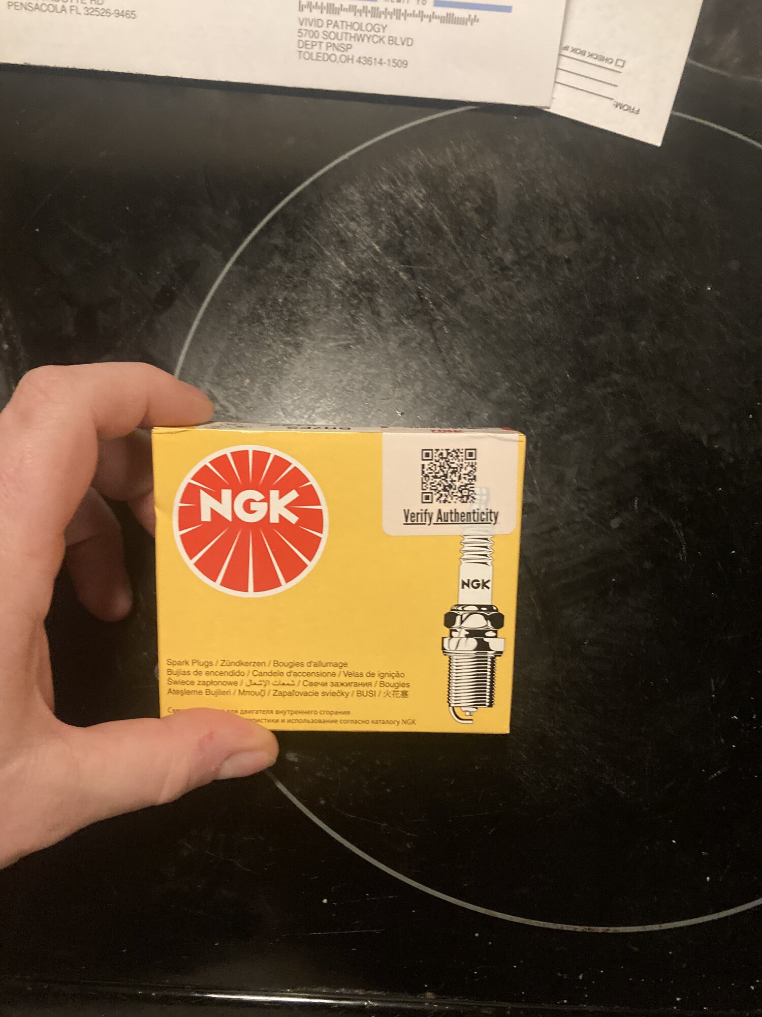

New plugs came in today. I am sick as f*ck so I just slept for 14 hours straight, but this was nice to wake up to.

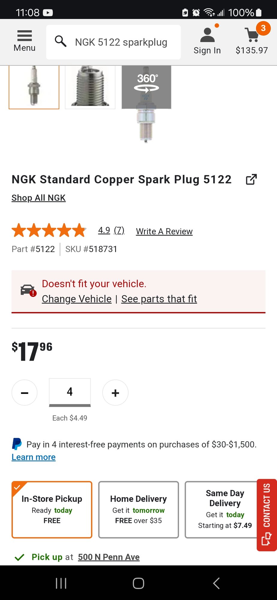

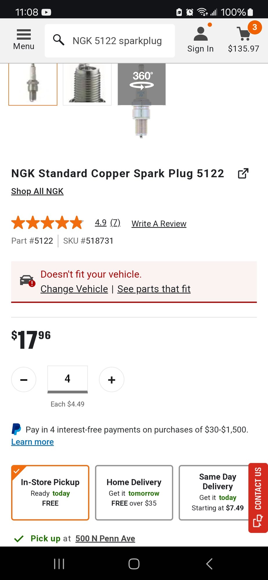

Also, this is an interested development. I bought these from a vendor I know deals with NGK directly, and it looks like they're gonna start trying to fight the fake NGKs out there. When you scan it, it takes you to a site that has a bunch of Q&A stuff. They're sooooo shiny. Gonna install them probably next week when I don't feel like the living dead.
