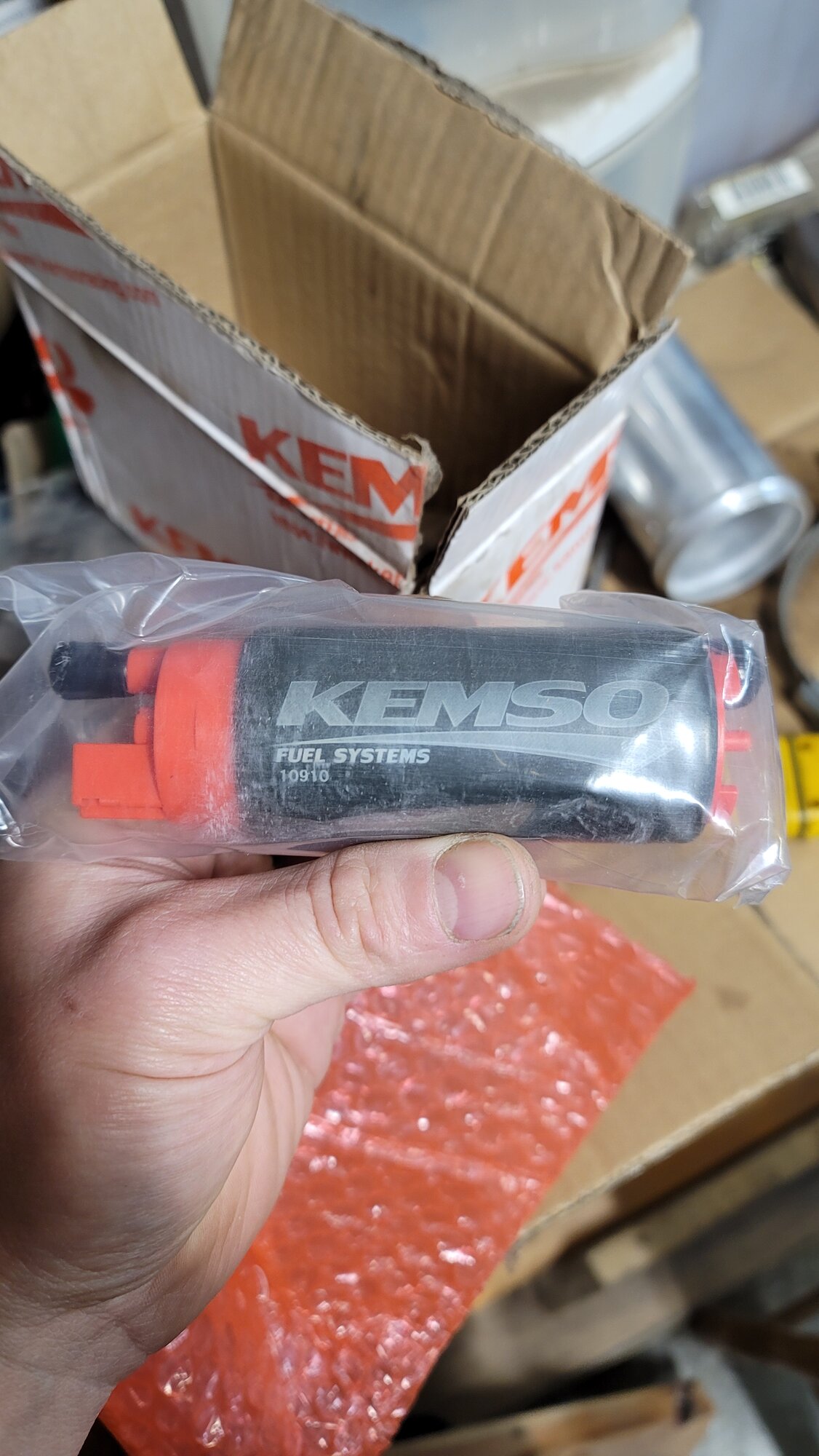

I may be dumb but I've been rocking these Kemso 340s. There loud but not one has failed me, I dont know if there a Chinese brand or what. I used to run those aem ones.

How long has your oldest one lasted? I did a bunch of research on the longevity because I don't really want to have to do this again so soon. But if this one dies I'm just gonna go Walbro/TI 535. Like Stapl3 said, they're cheaper and flow way more.

Yeah it's quite the unit, I've had this one for 4 years. I bought an extra just in case, but it's been solid. I didn't know if anyone knew about that brand or not. If this one dies I'll throw the spare one in, and if that one ever dies ill finally buy something more quality. I honestly only bought it because I was being cheap at that point in time, but maybe it's not so bad after all.

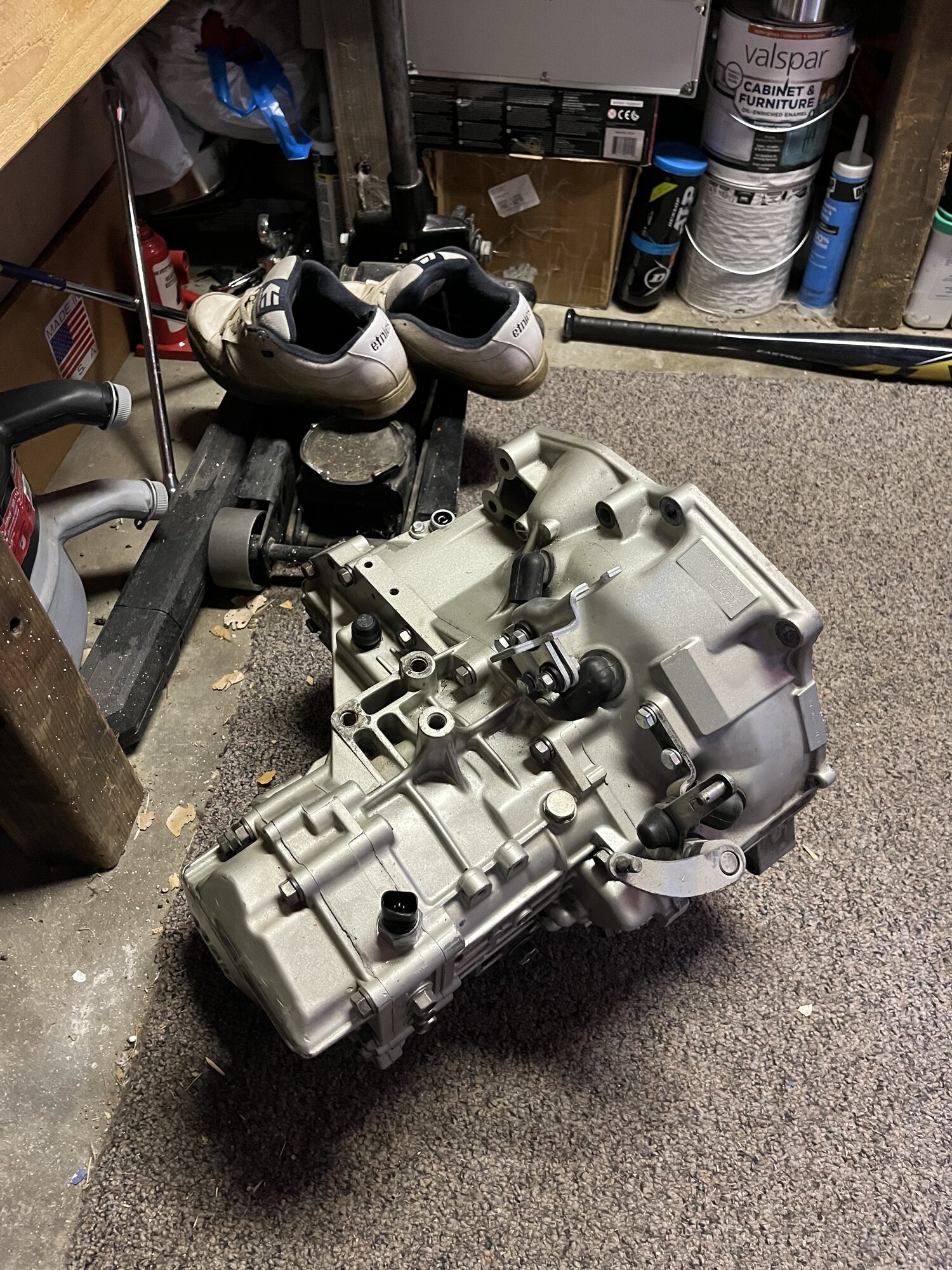

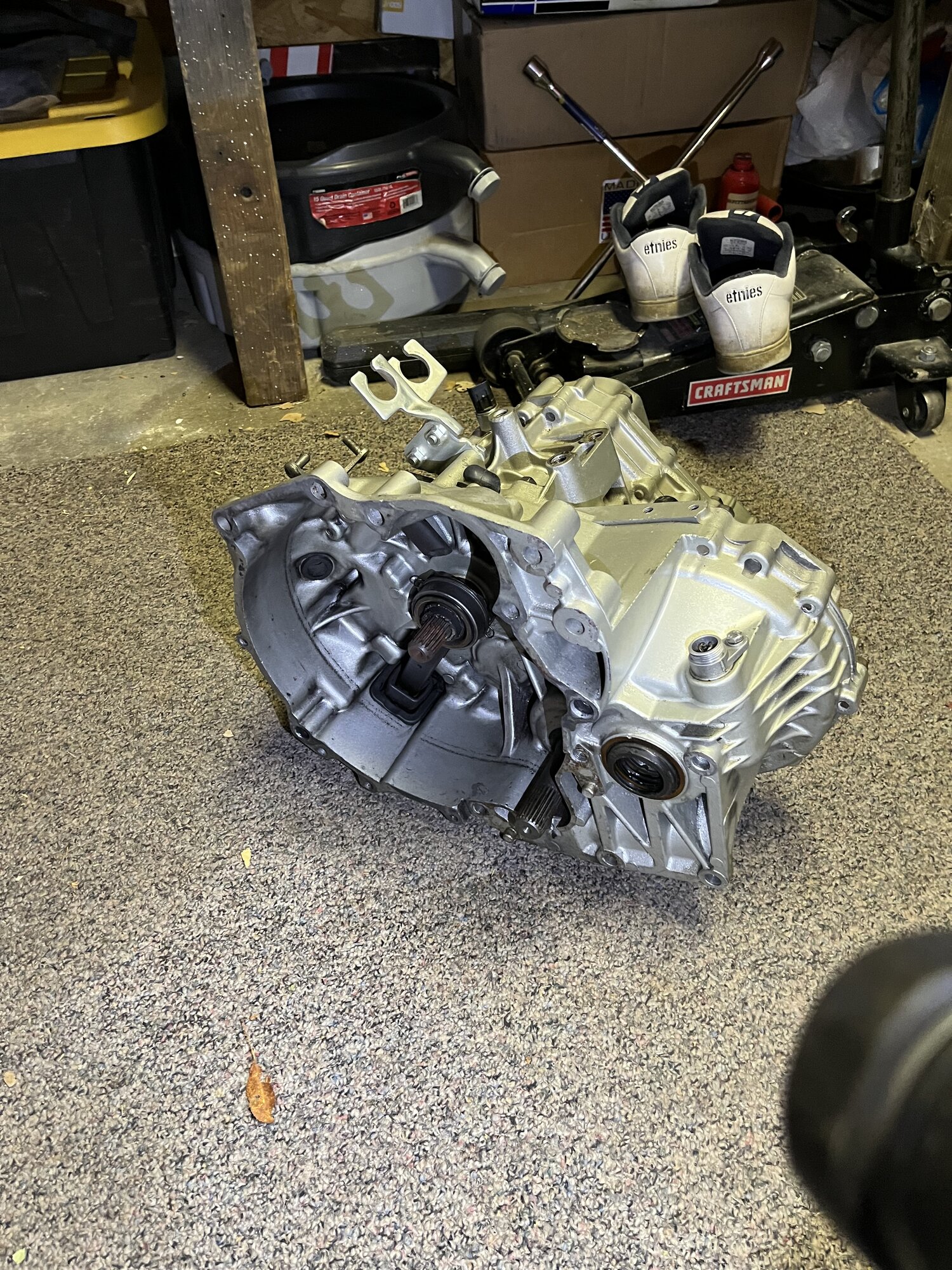

Alright well, I'll let the cat out of the bag as money has exchanged hands at this point. This is my super duper secret purchase that one of you already guessed.
It's the Jacks Transmissions "Drag Trans". Has the double synchro 1-2, and the "HD" 3-4 gears. It has super low miles, and the best part...4-spider center diff!! Which is the whole reason I want it. I got a screaming deal on it, and honestly stoked to use it. This way I can actually push this Green and not worried about blowing up a 22 spline aluminum t-case, or a stock 2 spider diff.

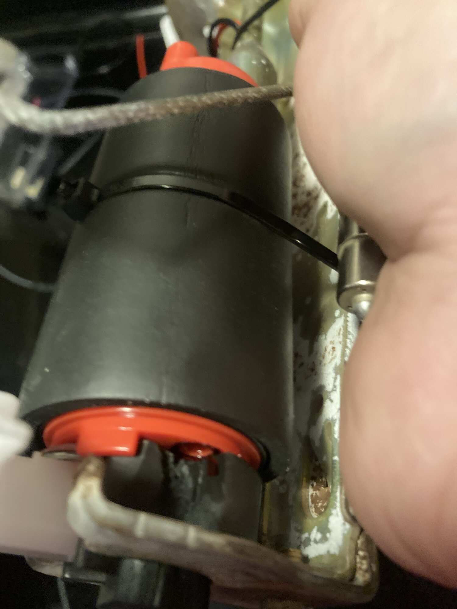

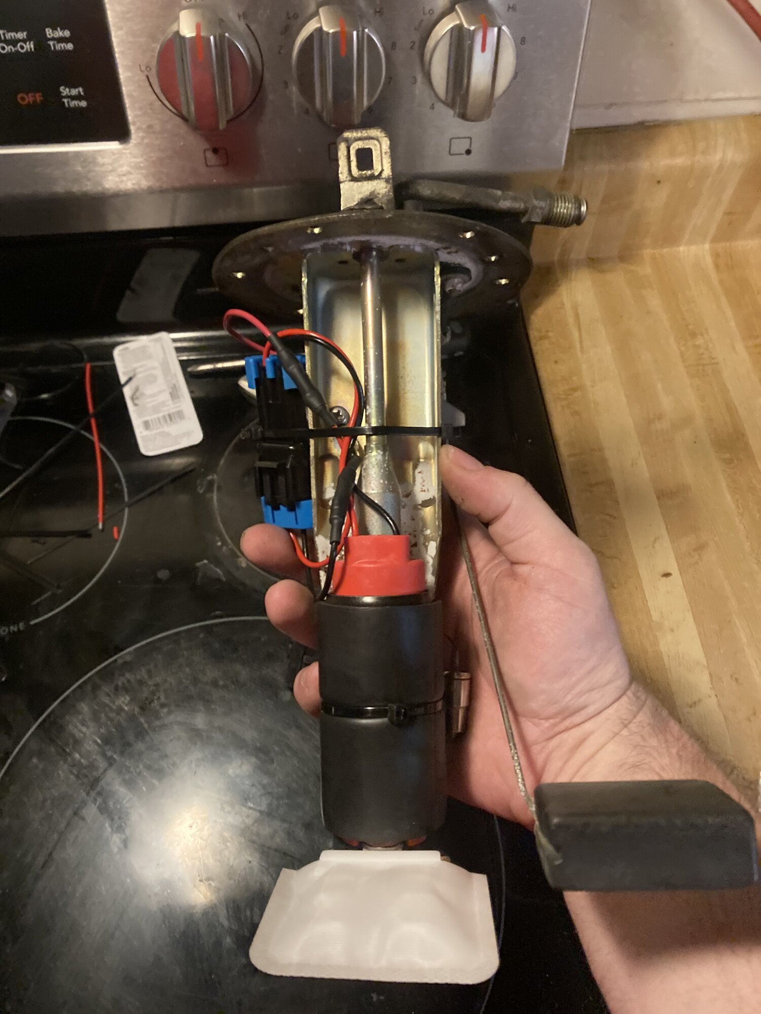

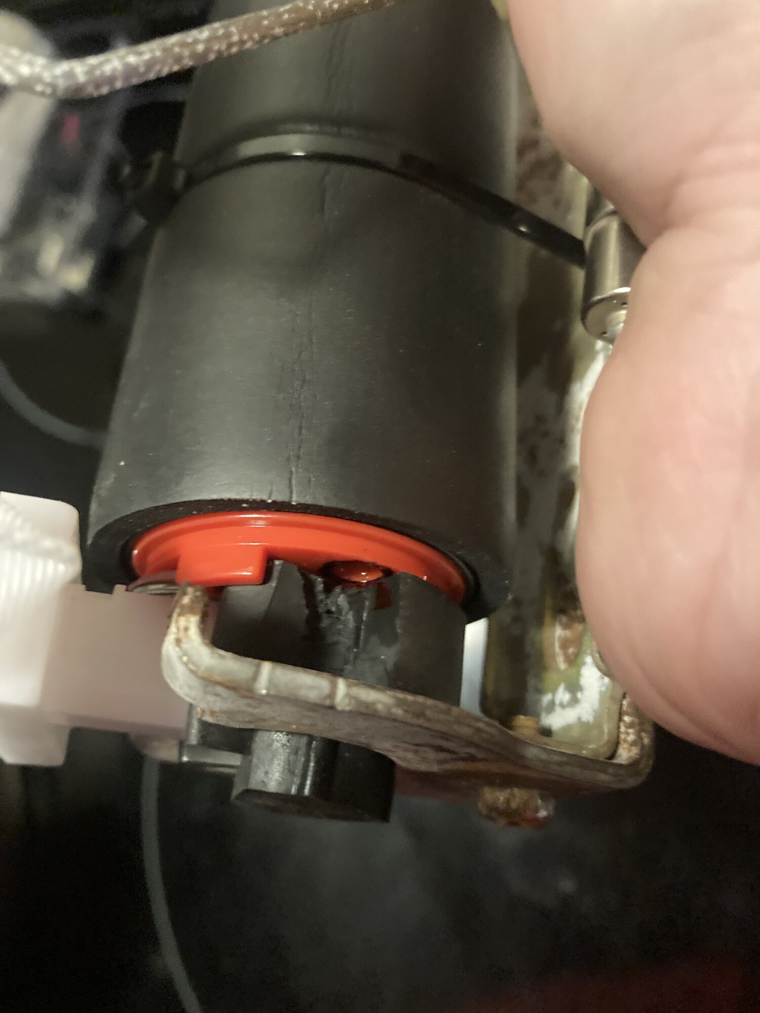

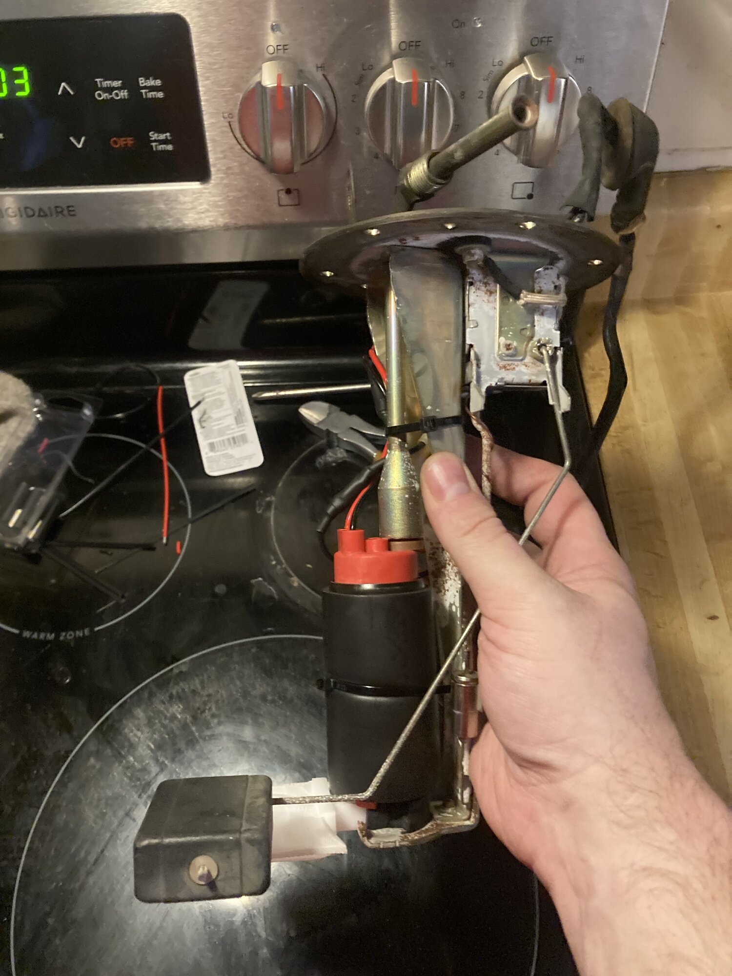

Got the pump installed today. I didn't have to do much to modify the rubber isolator except one thing that the pictures show.
It fits nice and snug, just like the Walbro 255 that came out. Install was an absolute breeze. In the instructions they specify very clearly to keep the port on the top and the bottom of the fuel pump clear or it'll cause hot start issues/fuel pressure bleed down issues, so to keep with the instructions I cut off a little of the rubber isolator on the bottom to free the port. The top one remains clear because nothing blocks it, and now the bottom is good too.
First impressions upon driving it are that I love it. This thing is so freakin' quiet I didn't know if it was actually running or not(I thought I might not have hooked the power wire up or something) but it runs great. The map is slightly richer upon WOT, so it made a difference. The entire tune doesn't need to be altered though, just needs a little more fuel pulled out than before. I let it die (low rpm, in gear) aka forced it to die without turning the key off when it was hot. Before in those situations you had to turn the key off, then key on and let the fuel pump prime for awhile before it would restart. This time though it just cranks right back up. I'll keep testing it, but so far it looks like the hot start issue is resolved.

Nice find on the trans too! Thats exact what mine will be when it's back together minus I have a Quaife LSD front diff and 300m output. Is yours an OEM 4 spider or one of ol Tims cross Chromoly cross shafts?

I don't know about the diff. I think since it's from Jack's, it's probably just the OEM cross shaft.

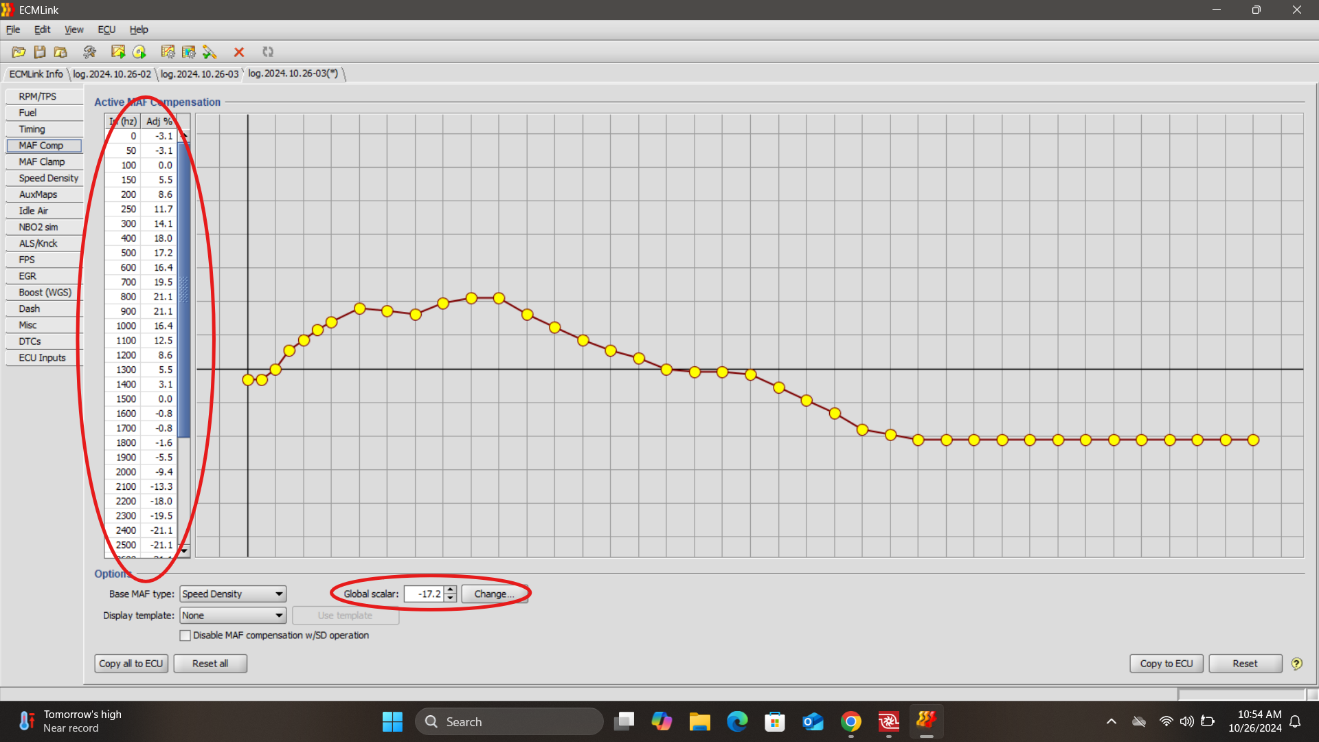

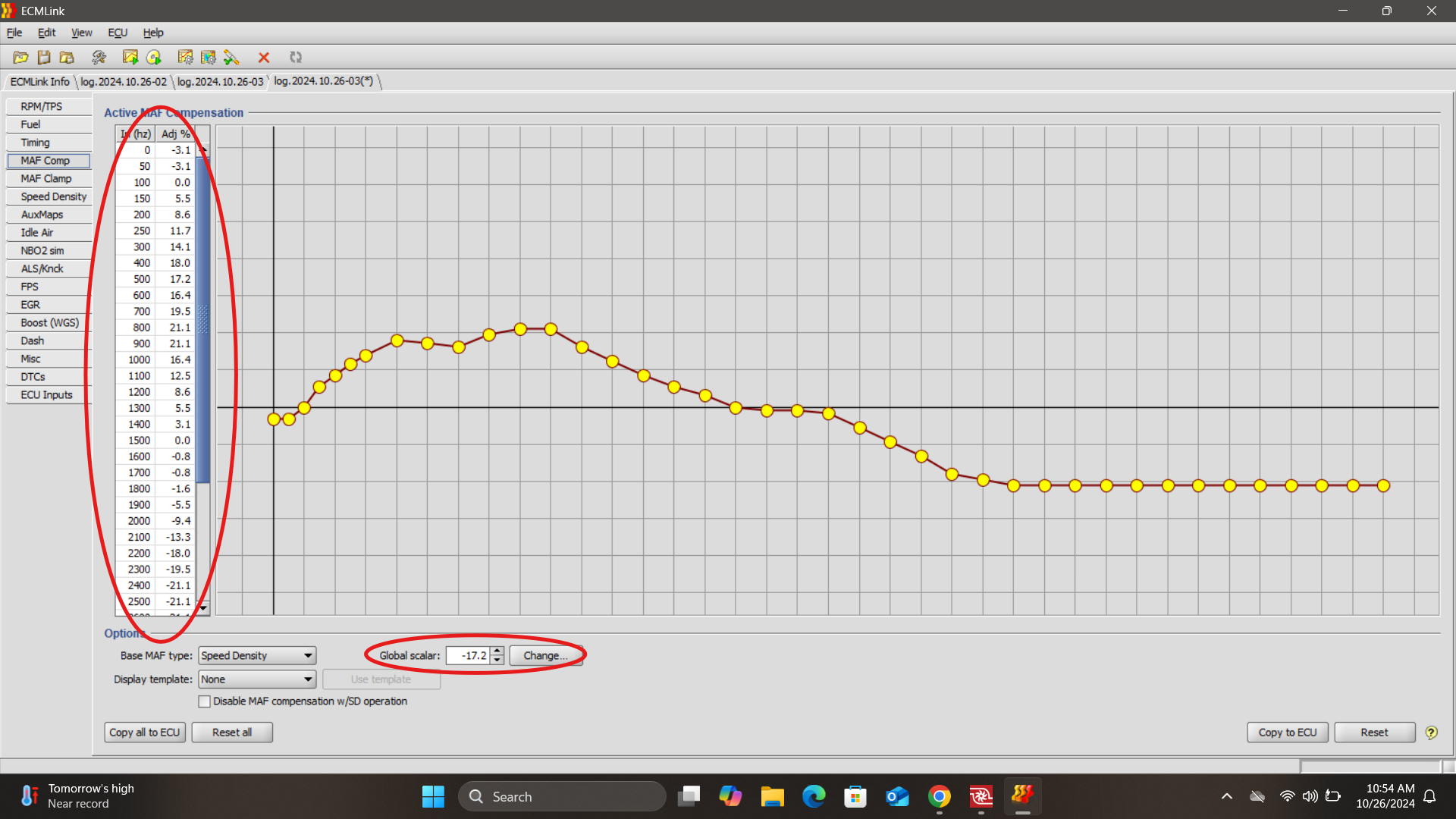

I would personally start with zeroing out the mafcomp tab and checking the disable maf compensation w/sd operation. Also notice at idle your airflowperrev at .5ish at idle (double what it should be). I'd start there and do another log and see where that lands you.

Long story short those are all what it took to even get the car running. Lol. One day I’ll zero it all out and make adjustments with VE only but not today. I may disable hot start enrichment though. It needed it before but I wonder if it still needs it now.

Hope your fuel tank is over 1/2 full... The o-ring at the pump outlet and the check-valve in the pump should prevent the supply line from draining back to the tank. If you can check the PSI of line pressure just after the engine has been running, it will tell you somthing. Stock cars hold a bit of line pressure, and turning the key to start produces instant line pressure.
If your line pressure drops to 0 after turning the key off, and key turn on takes several seconds to reach pressure, I would go back to the pump and check that the o-ring is still where it is supposed to be.
