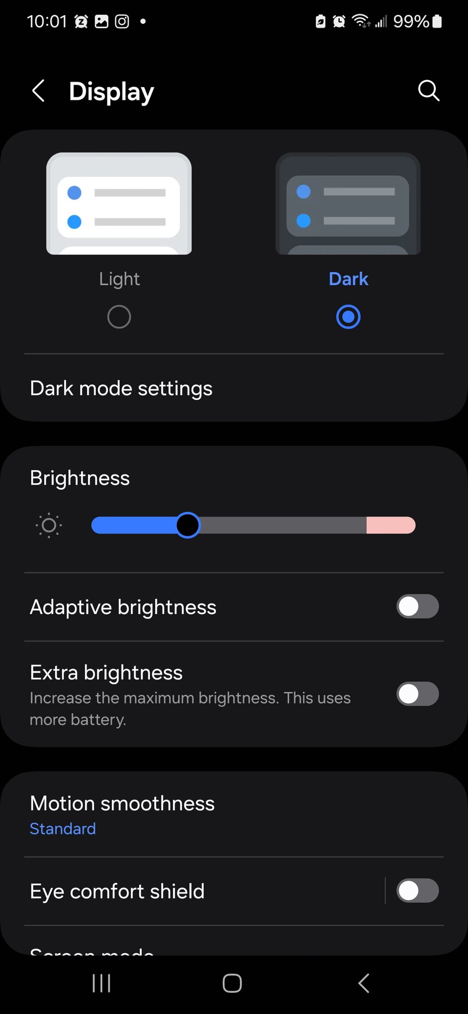

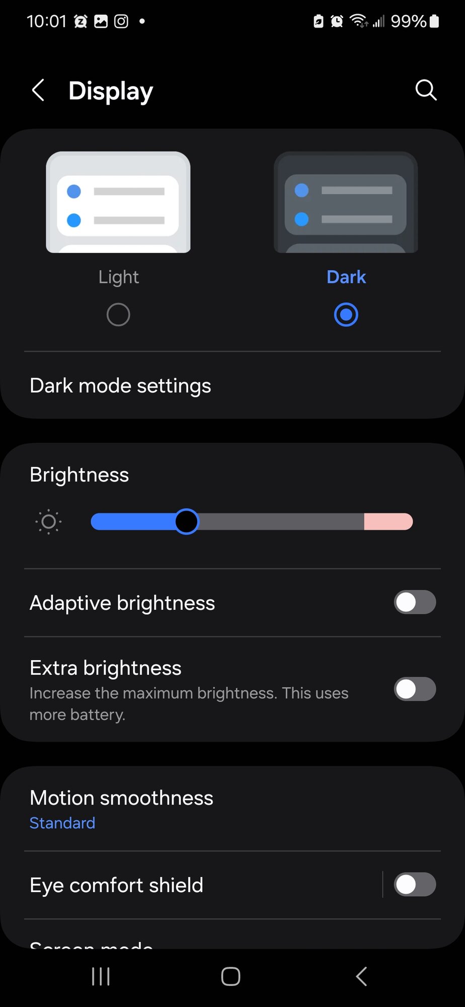

Hold up how did you get the forums to be black?
We are all here to help the best we can!
On the black screen issue, on my Galaxy S23, there is Dark Mode, just FYI.
All you cool people with Androids that can do all this wonderful stuff.
I'm on an iPhone. :(
