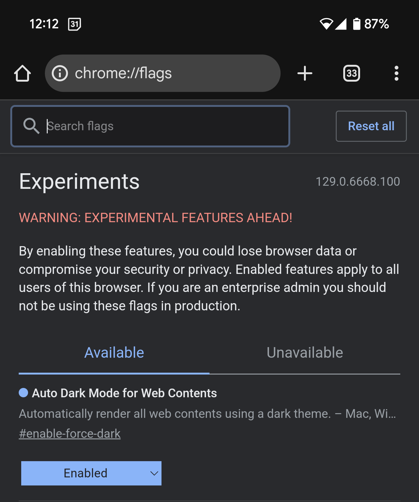

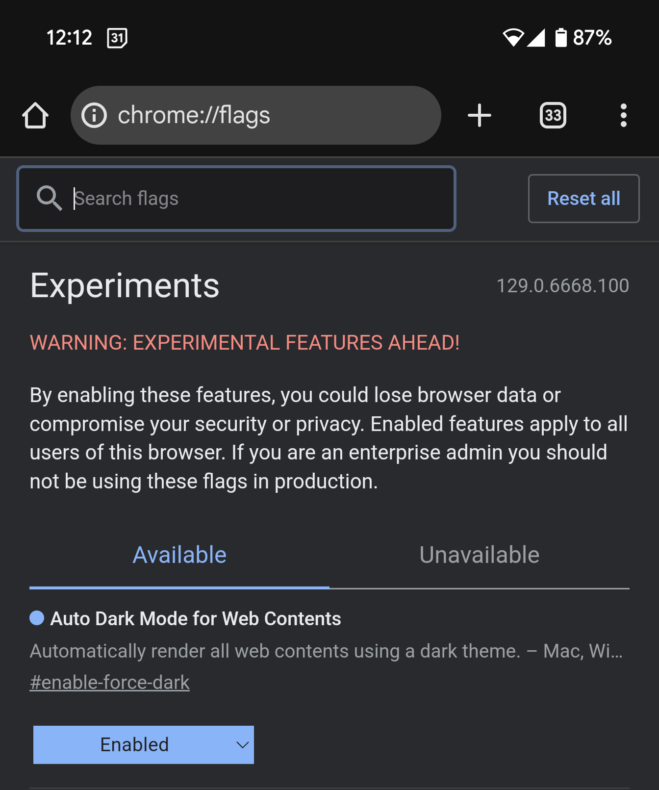

If you're on an android phone and use chrome, Put this in the URL bar: chrome://flags/
Search for "dark" and enable the "Auto Dark Mode for Web Contents" feature
Refresh the chrome page, and then refresh DSMtuners site/app
I have everything in darkmode! It saves battery by not lighting up everything bright white!

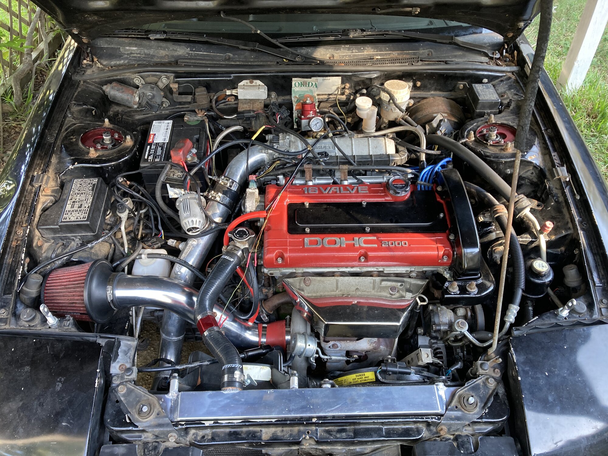

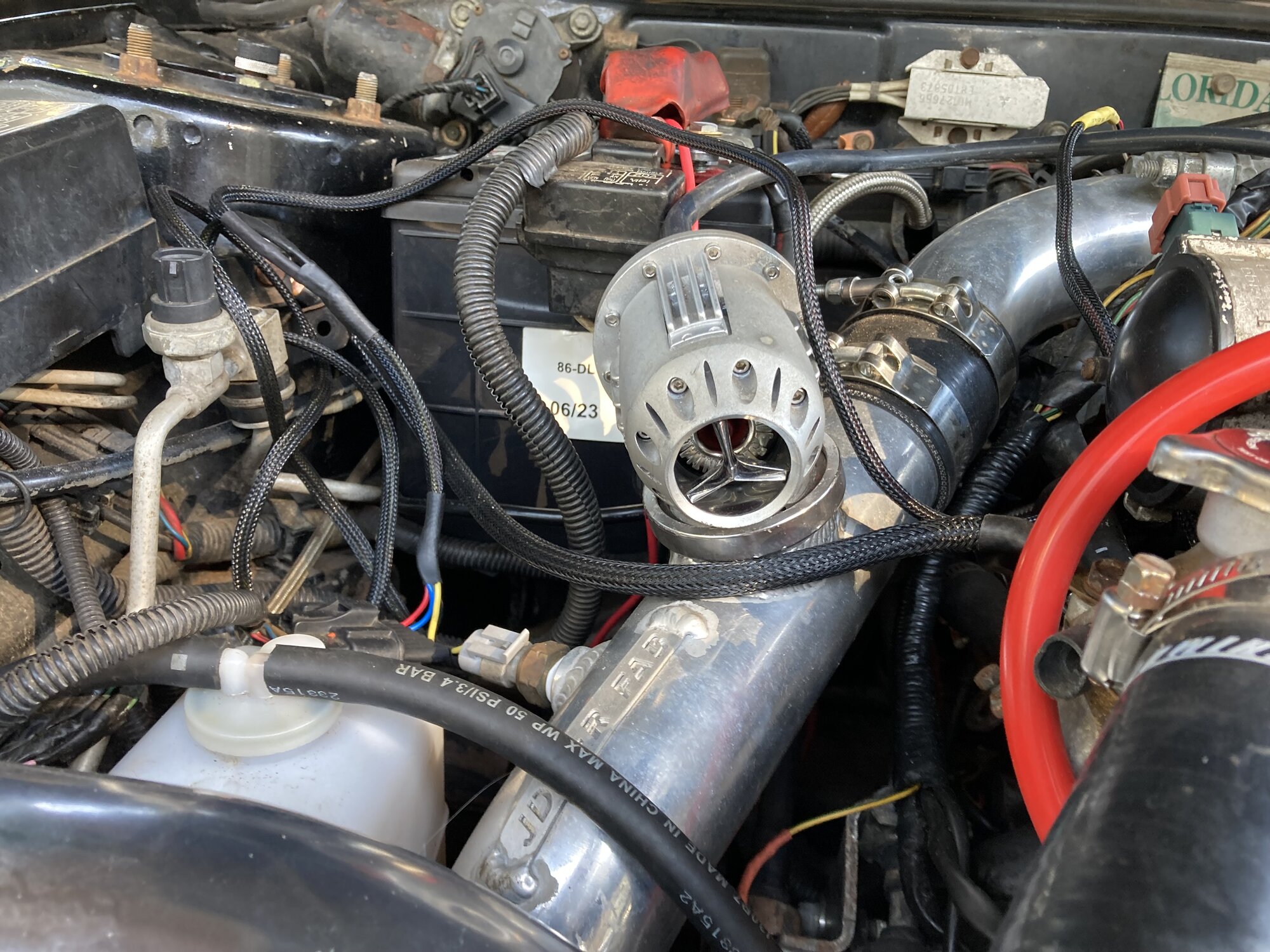

No more recirculating fitting for the bov. Stock high frequency fitting in its place. Stoked!
And seriously. With that aluminum intake pipe the turbo is so much louder and I love it. Need to take a video soon.
