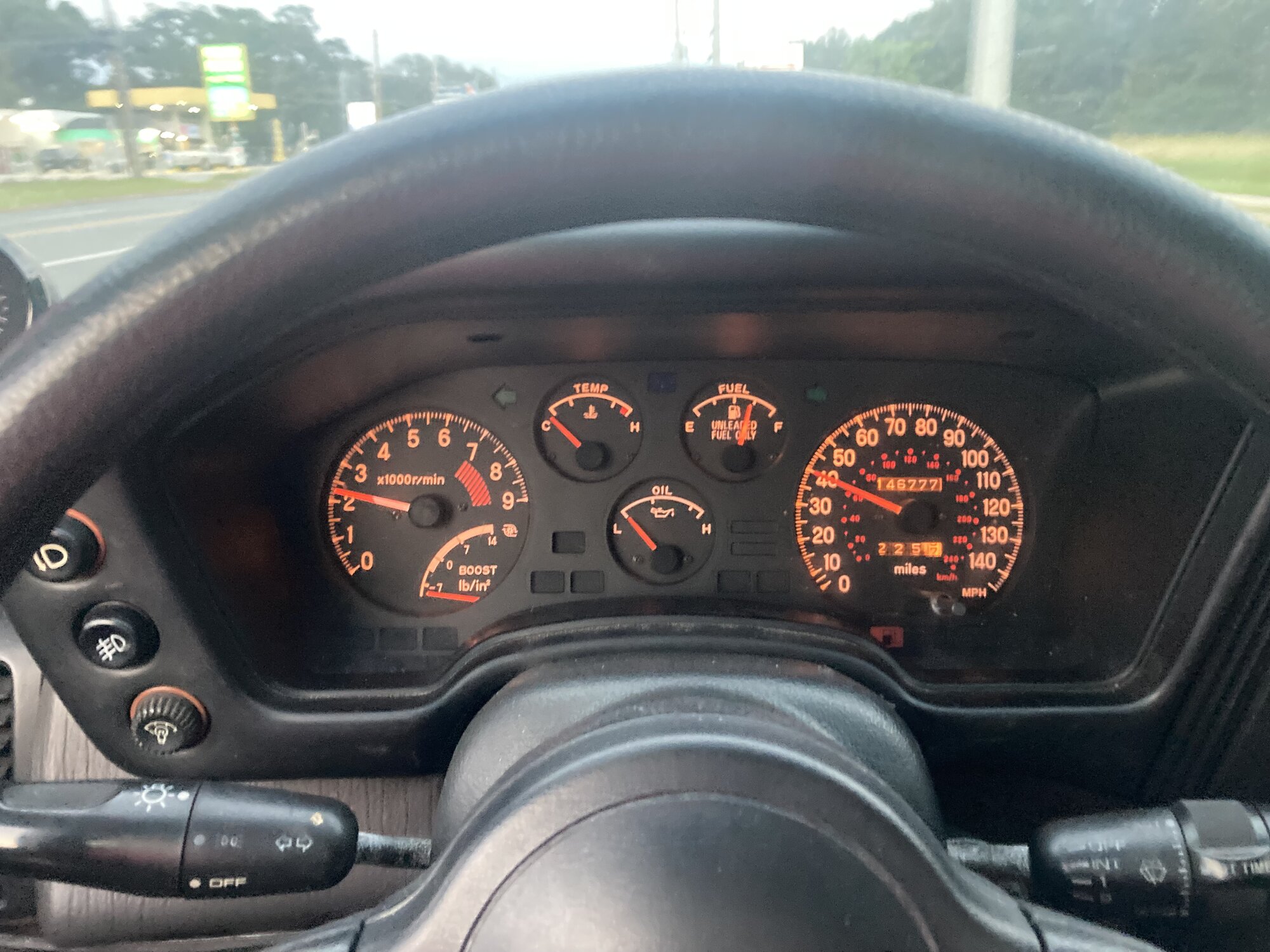

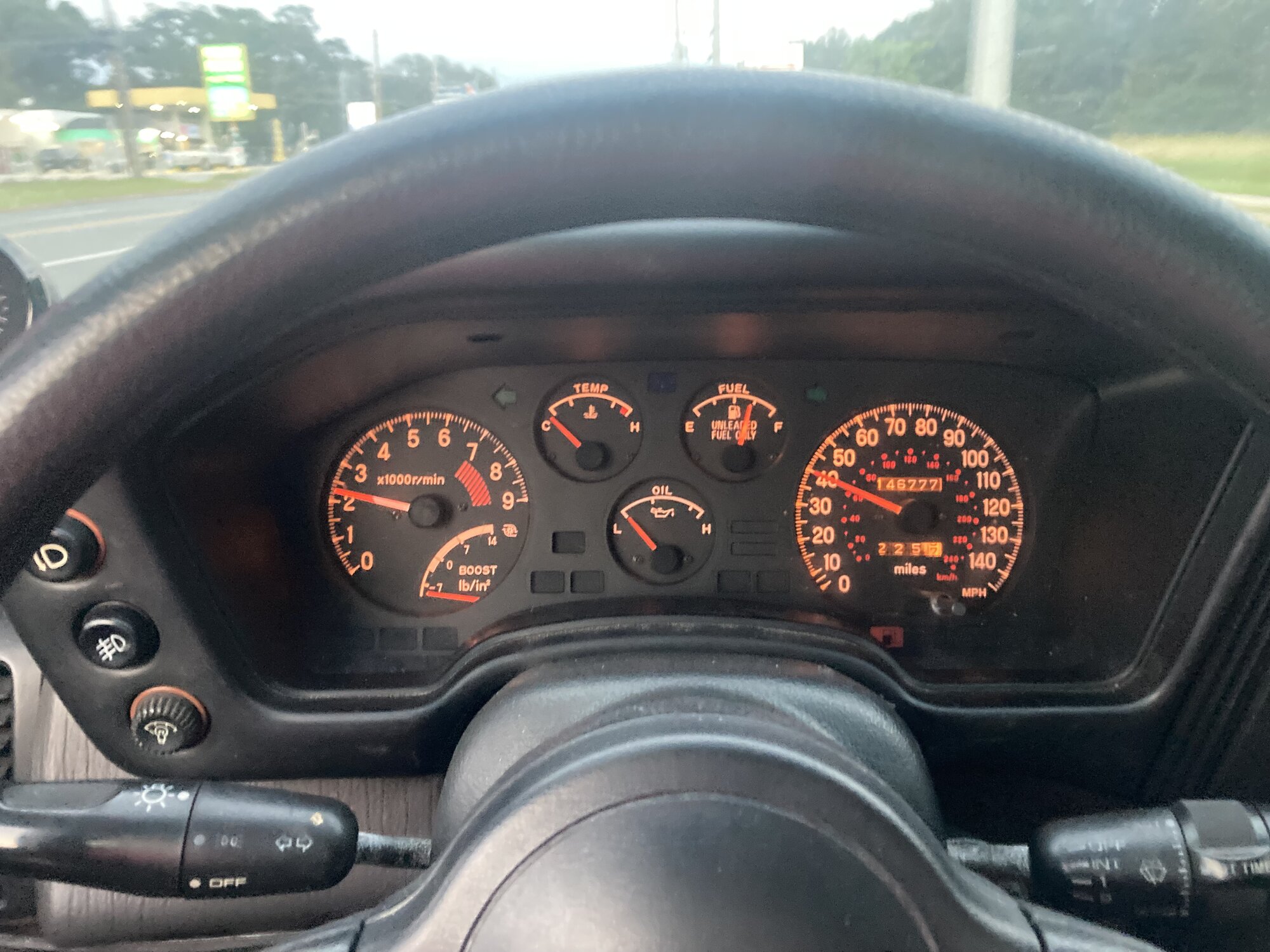

Forgot to include this. I didn’t have to remove the bulb at all, the ebrake connector that tells it if it’s fully down was just loose and dirty. Look at it! No lights!
Really annoys me that the stock water temp and oil pressure gauges don’t work. Have to fix those wires too like I did the Tach but it’s low on the priority list.
I'm reluctant to point out the low fuel indicator. :cool:
Yeah the sending unit or wiring or both is suspect. It comes and goes. I’ll eventually dig into the wiring and/or probably just replace the sending unit entirely to make it go away.
So that one doesn’t count. It’s only like half on.

I’m hesitant to admit that during the great speed density struggle of 2024, my fuel was so low the car wouldn’t restart on an incline. Ironically, low fuel light was off for that. So that was part of the drivability problems…

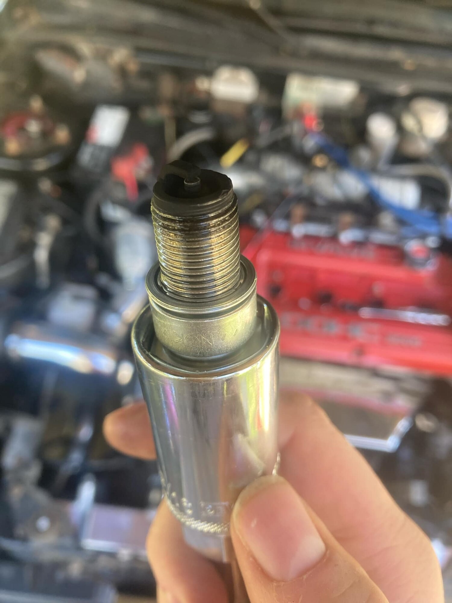

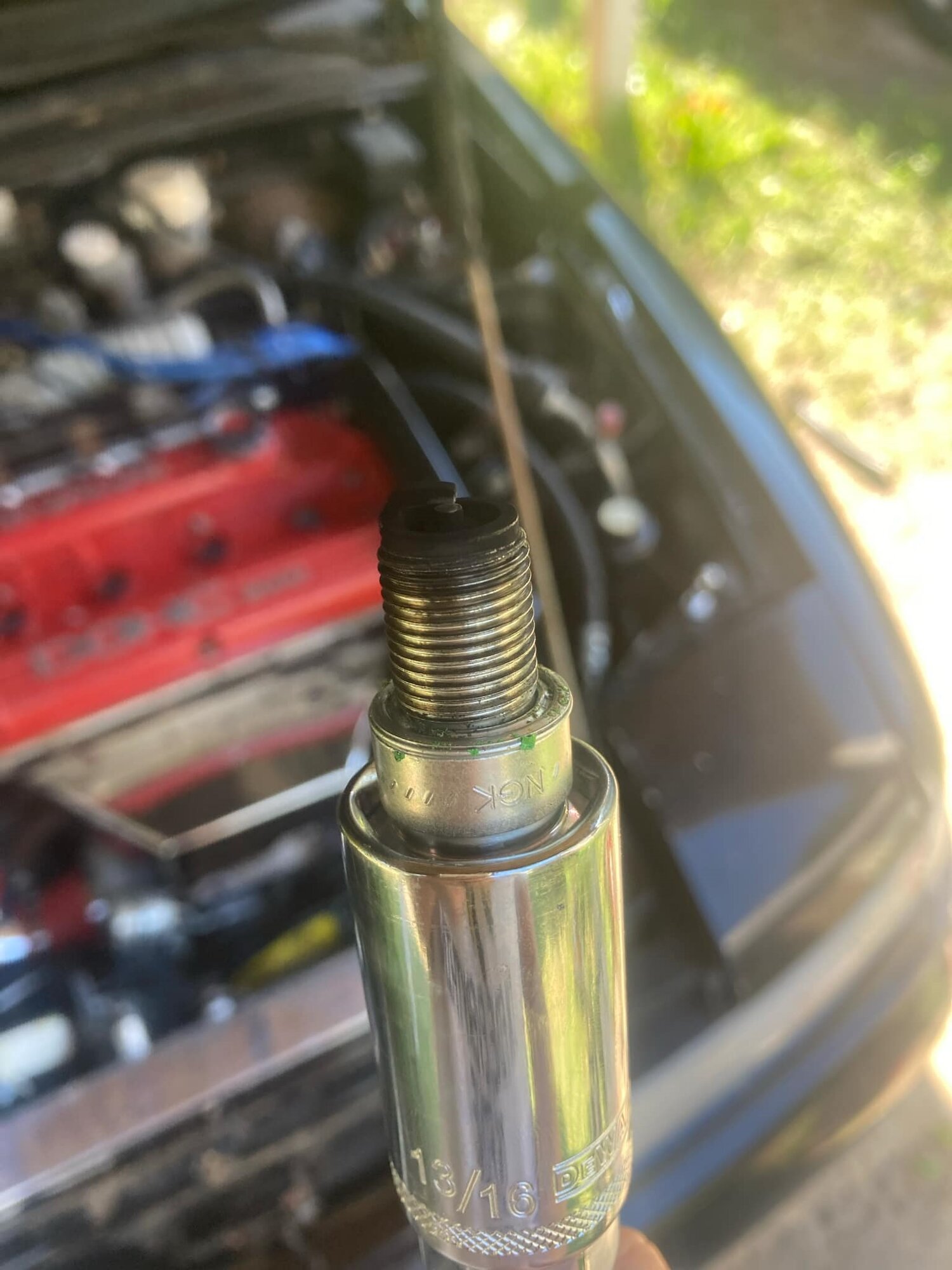

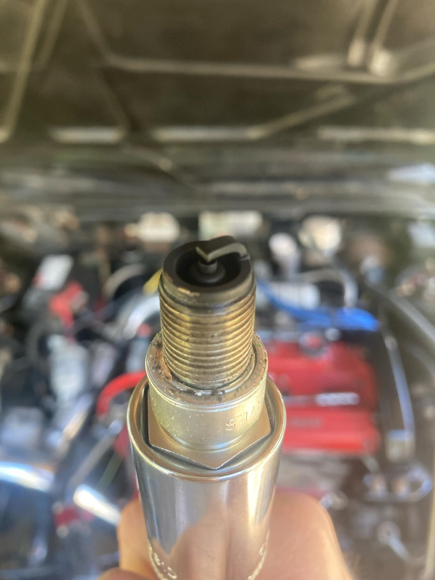

Another glimpse into the past here with something I forgot to post with all the tuning and changes we did Sunday to get the car running, but yeah.
Think these were fouled? :p
I cleaned them pretty good, but have new ones on the way.
Get some BR7ES and gap them at ~.025
Yus. That's what's on there currently, and what's currently in the mail to me now to replace them. :D I have these ones gapped a little tighter, so I'll open it up a bit to 0.25 on the new ones.
Mo spark, mo ignition capability
The bigger/longer the spark, the more energy is available to ignite the mixture.
The only thing is, you fight cylinder pressure causing blowout and the ignition system not supplying enough energy to jump the gap. It's a balancing game of opening the gap for your boost level whilst watching for misfire (the lack of ignition kind).
Mo spark mo ignition capability
For some reason my brain thought a slightly tighter gap was stronger spark/less likely to blow out.
Probably wrong. I'll gap 'em according to the great sage and eminent refuses-to-elaborator's instructions. :D Ain't steered me wrong, yet.
*Edited. Original content was quoted below and was incorrect, was thinking of something else entirely. It's late LOL*
It's the other way around, less energy is required to jump a small gap. The more you open the gap, the more energy is required to make that jump. You also increase the area the spark affects by opening the gap.
..until your ignition system can no longer provide the sufficient energy to jump a large gap to meet the ignition timing event.
Spark plugs are basically electrical shorts. You need a lot more power to short out a longer distance. And when it does, it makes a bigger pop than something half the distance (as an example only)
A tighter gap will be easier to jump and may contain more energy, but it doesn't take much energy to actually ignite. What you need is more opportunity during that jump.
