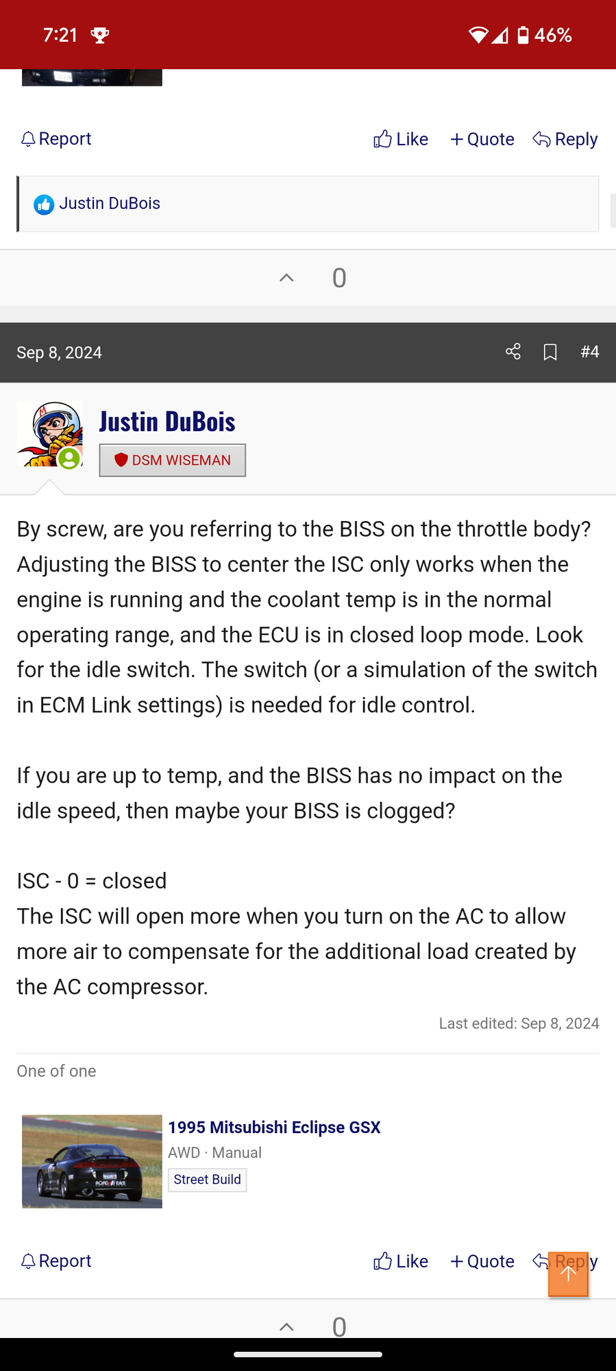

Are you logging EVERYTHING? I don't see learned idle adjust in displayed values.
From my understanding ISC definitely will effect AFR. Lower the ISC, it blocks more air, higher the number the more air it lets through.
So think, if your ISC drops, your car is still injecting the same amount of fuel BUT now with less air (because ISC isnt allowing more air around the throttle plate) now it runs Rich.

@Justin DuBois ISC only works right if it's in closed loop?
Set your global a tad richer than the calculator says. Don't play with the fuel pressure. Leave it at 43.5-44. Work on globals, deadtime for idle and the VE table to get it to idle around stoich if deadtimes cant do it. It will bounce around a bit but 14.2-15-2 is normal. "Track" your table to see what box it is looking at and work with it, then smooth the boxes around it. You will learn alot playing with those and watching your AFR gauge. Leave the FP as a constant in the equation.
If you are using NB simulation, the WB will start to cycle around 14.0ish. Your BISS screw should be around 1 1/2- 2 turns out. I pay no attention to my ISC or my RevperMin stuff, I get the car to run with those 3 things and the idle stop switch, being the only variables usually.

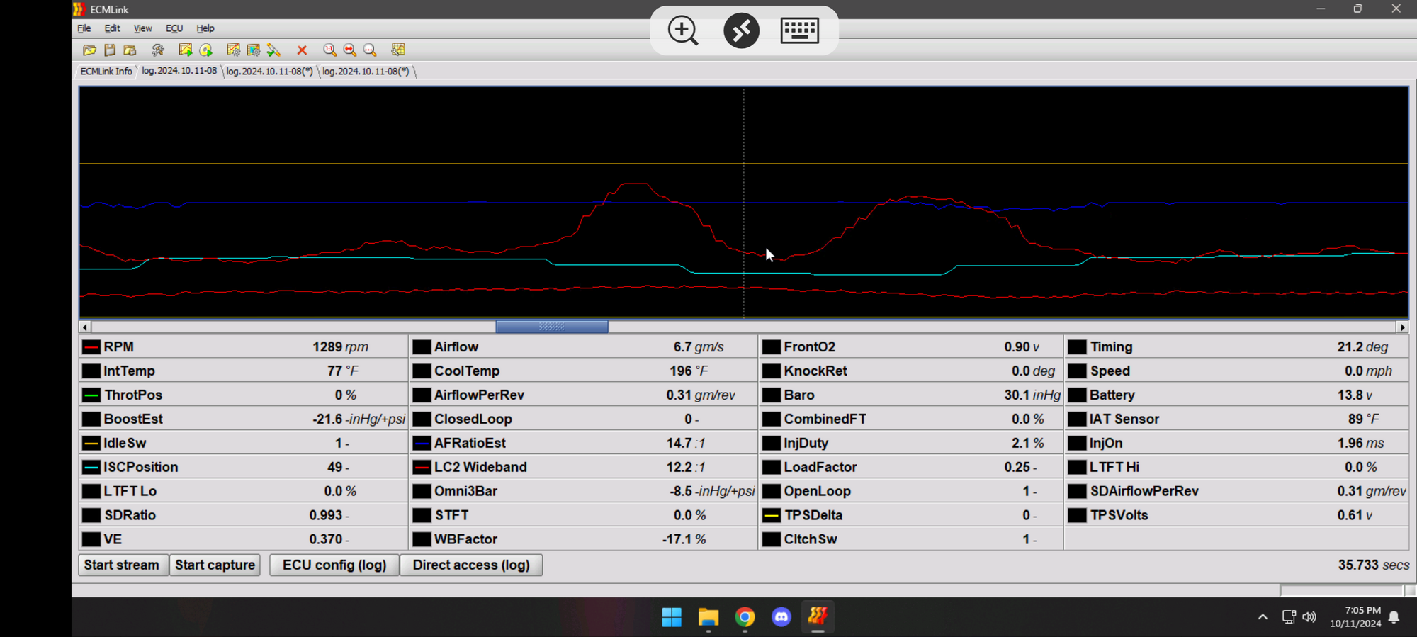

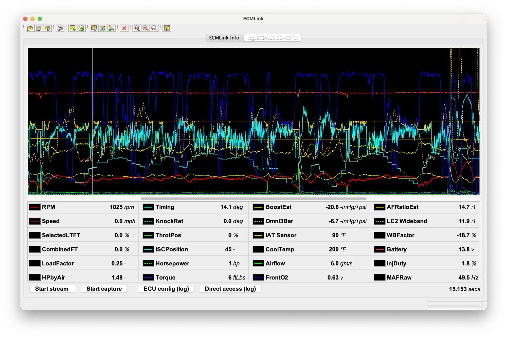

With this log you can kind of see. At the beginning of the log its 200* and like 20-low 30's. Then it decides to start flopping around on the floor and before it dies it'll go to like 60-70. At one point it dropped to like 19 and I had to tap the gas to keep it from dying.

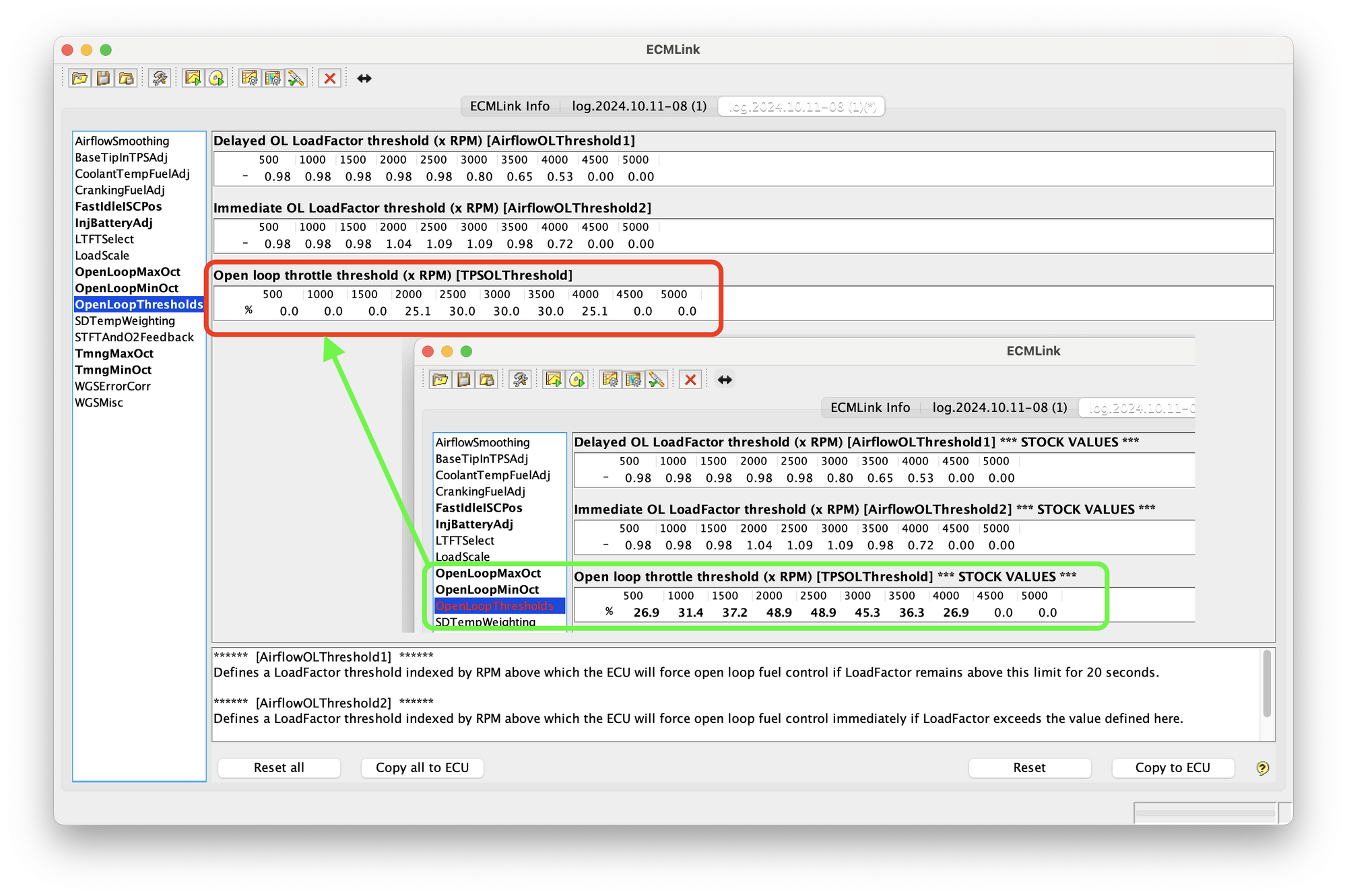

I did find something in your DA tables - Did you know your open loop thresholds are non-stock? Maybe you were trying to force Open loop? Since we are having idle issues in this area, you could consider putting this back to stock - unless you have a reason for having it this way.
FYI - Your OpenLoopMxOct tables are very modified. Is that desirable? Remind me what fuel are you using?

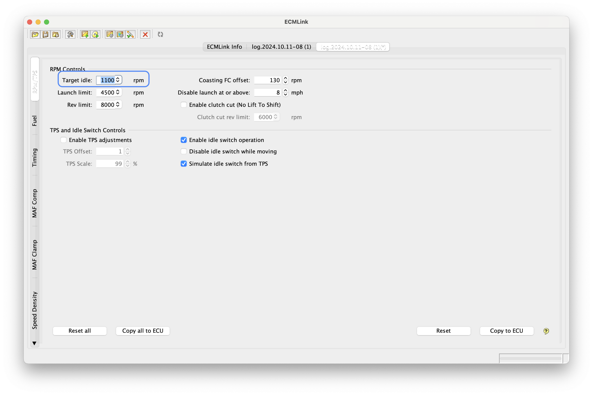

Here - you have 1100 rpm as an idle target. Not my cup of tea, but maybe this is because your cams are giving you a hard time.

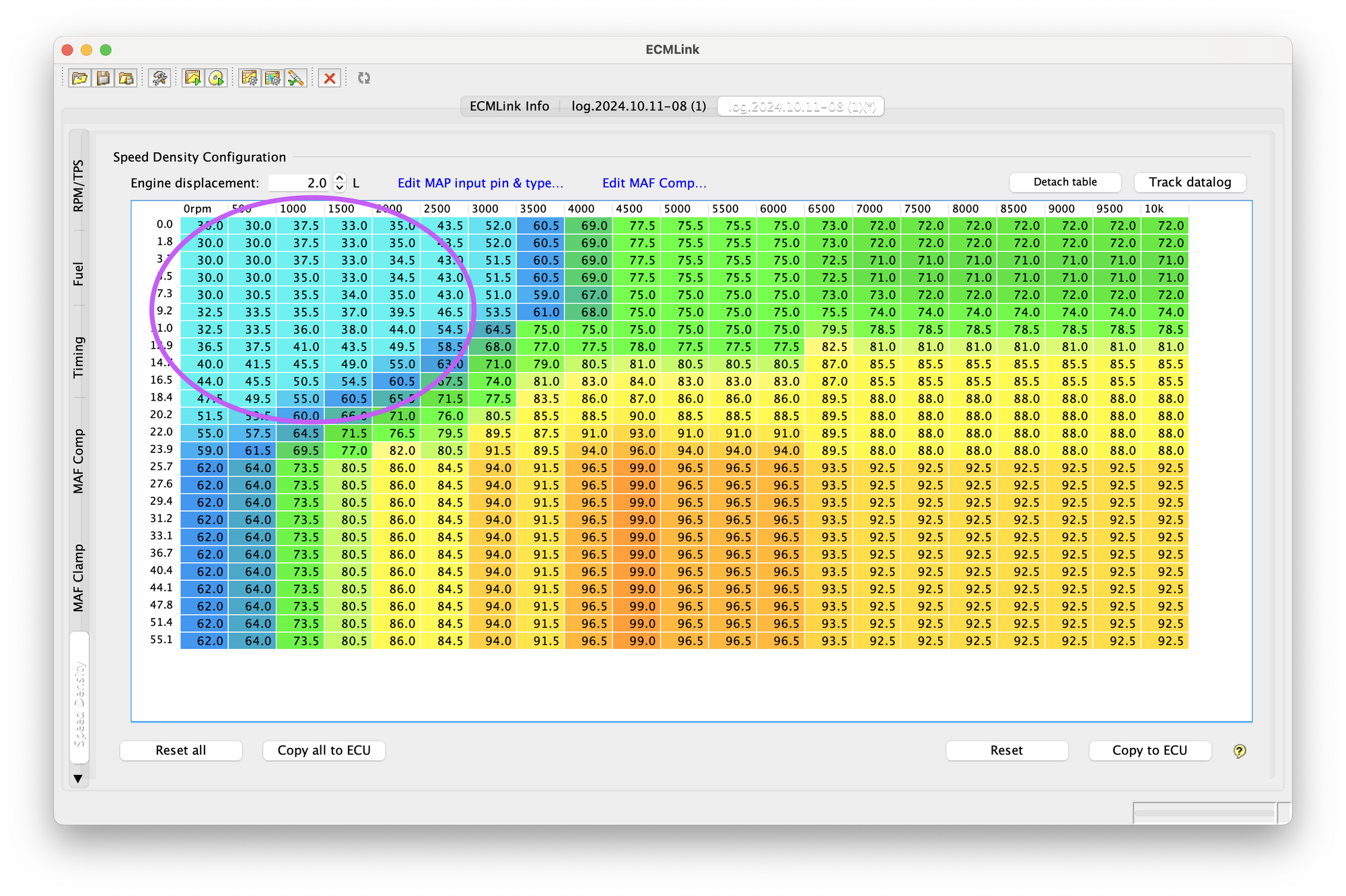

Here is your SD table - and in the idle area you are pulling out a LOT of fuel. Do you really want to pull fuel here? I think this is working against your global dead times. I know your cams are messing with you, but I would try a stock VE table to dial in Global dead time.

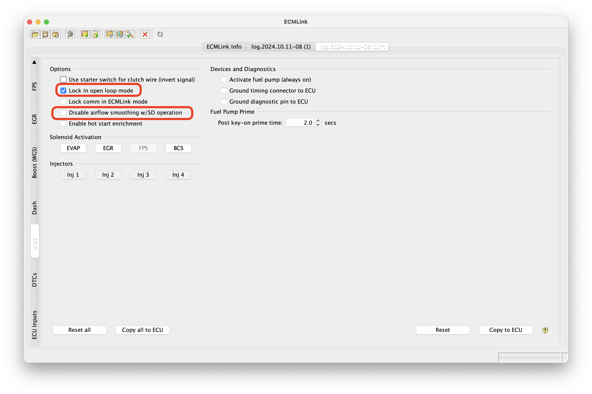

Open Loop lock is enabled - (turn that off), and you can disable airflow smoothing when running SD mode.

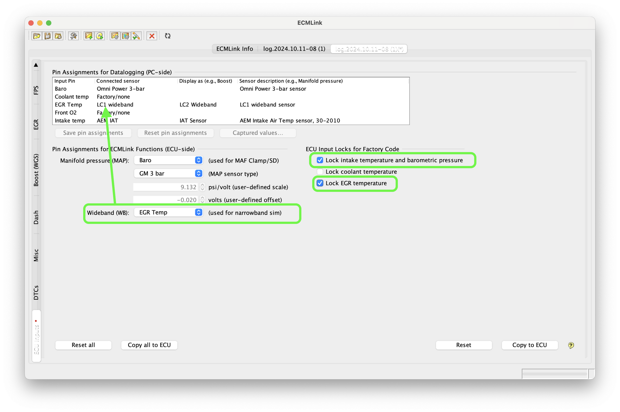

In the realm of modified sensor inputs, there are some changes I would do: Set the Wideband pull down to the channel where your wideband is connected (EGR Temp). It can stay set to EGR Temp weather you enable NB sim or not.
Also - you can enable the input locks for the factory sensors inputs that are no longer factory sensors.

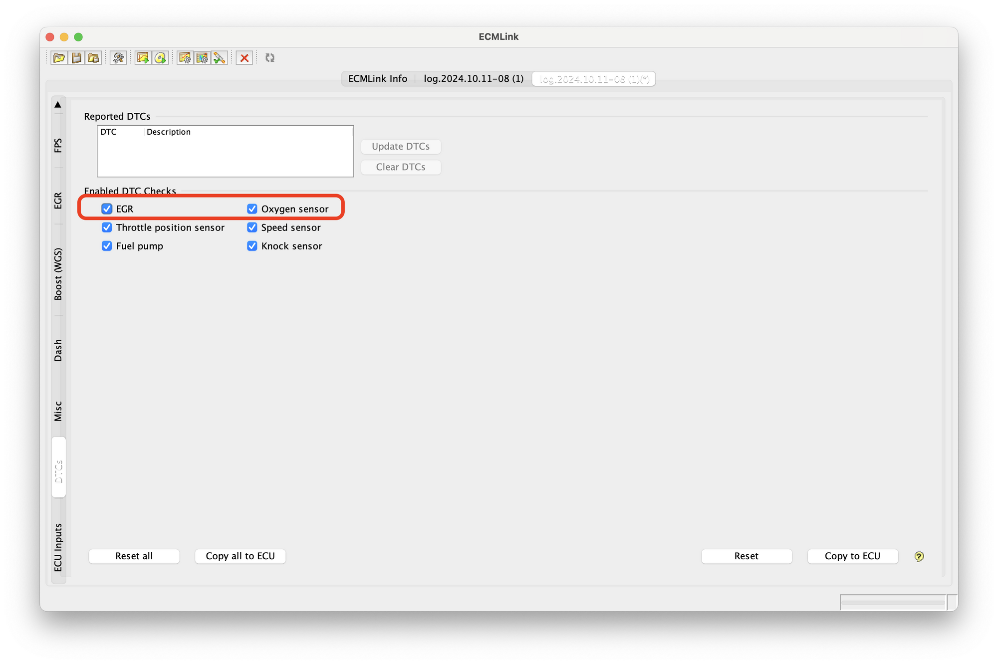

If you are not getting DTC errors this won't matter, but as the EGR and o2 settings are no longer stock, you can disable these tests.

Your narrow band is cycling, and I see the ISC stepping about. This is the minimum set of parameters I recommend for logging:

Because changing nothing but what @Justin DuBois said has made significant progress. The car started and idled, and could almost...almost be revved w/ WOT. It bogs under WOT like usual, but blipping the throttle is significantly more responsive. I think with a few more tweaks, the car may actually be able to be driven soon!
