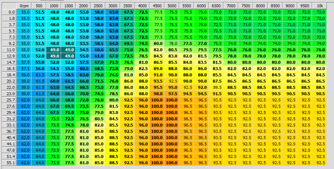

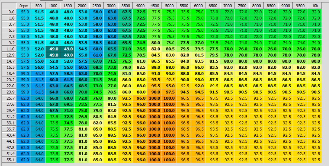

Im also learning a bit here, but just to recap from what ive been researching:
- AirflowPerRev should be like .28-.30ish with Cams
- If AirflowPerRev is high, Lower VE in those cells to help bring it down
A: IFlowering VE to fix AirflowPerRev knocks you off your AFR target BUT now AirflowPerRev is around where it needs to be, then adjust global deadtime to get your idle fuel back to target.
- Do 3rd gear pull and see if VE at 5500 is 100 or very close, if not then adjust global fuel to try and hit that mark.
A: If you need more fuel at that 5500, then make Global Fuel less negative to add more fuel. Make more negative if you need to remove. Should be able to just add the percentage off according to WBFactor to the global fuel?

This is kind of 2 part question. Gradual fuel and not a stab probably means your VE needs some work. I see its about 20% rich at idle, and in some small throttle spots (that dont trigger tps delta its about 15% rich.
Now if you stab it like at the end of that first log and it triggers tpsdelta, and runs lean like it did i think youd need some more Tip In

I wont lie, smoothing kills me too. Its hard not to oversmooth and end up changing all the nice changes you just did. its a fine line for sure.
Ill get flamed for this probably but this is what i KIND OF came up with after removing 20% fuel from your idle cells, and 15% at a few around it, smoothing out some big jumps that were in the table.

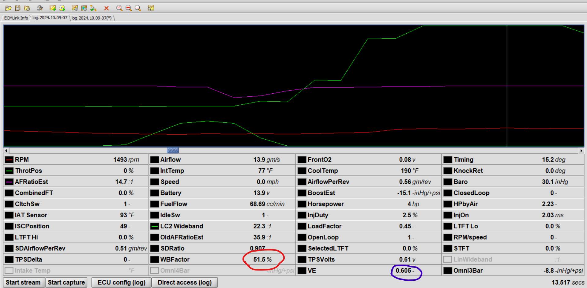

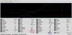

also to add to this, like in your 2nd log
you stabbed it and it set off a TPS delta of 1, but the right after you stabbed it it went lean and WBFactor wanted to add 50% fuel.
If you look at the Blue circle, that's your VE in your table. Obviously you cant ad 50% fuel to there or you'd have a HUGE spike in your table. So what do you do? You add Base tip in the DA table to add the fuel for you while not messing up your VE table. 1728526287763.png
Now if you stab it like at the end of that first log and it triggers tpsdelta, and runs lean like it did i think youd need some more delta.

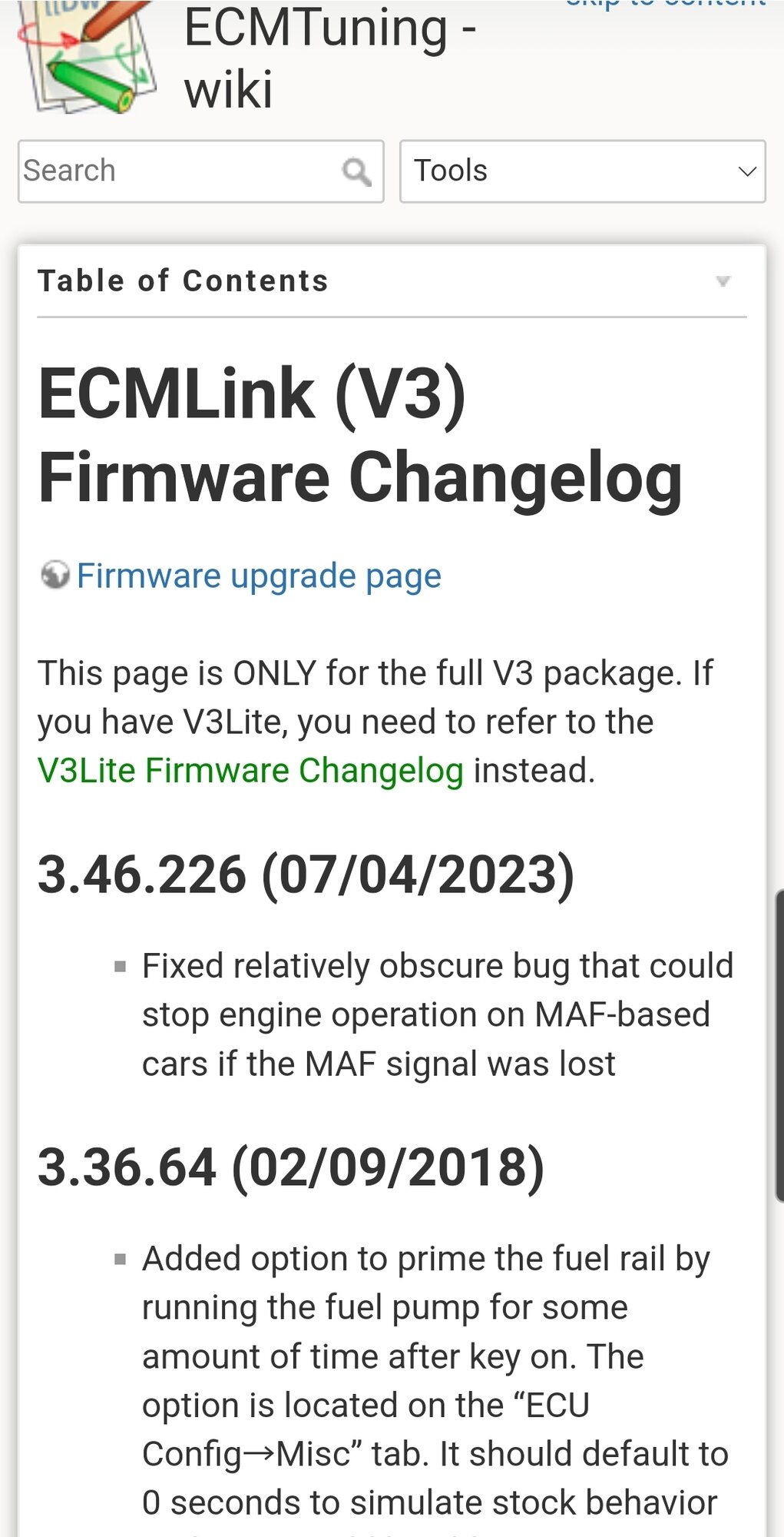

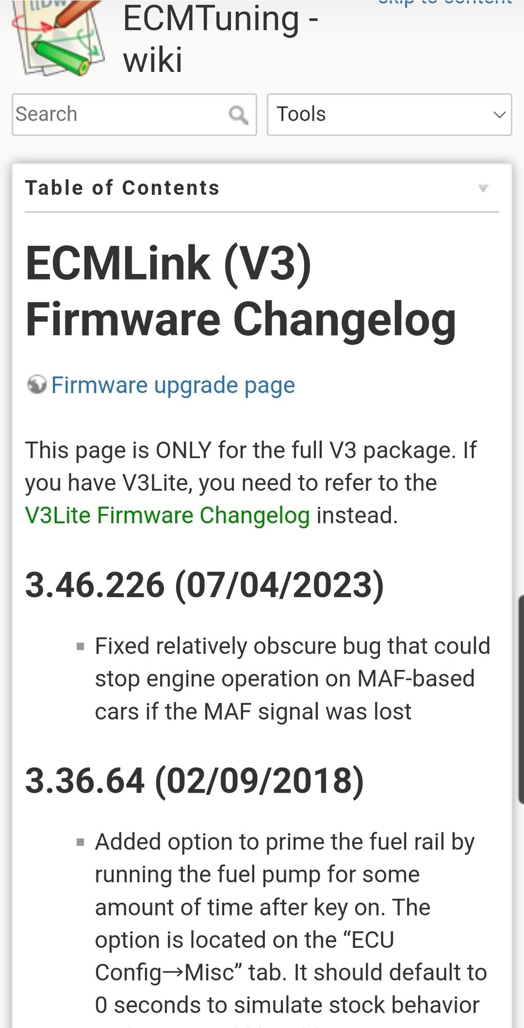

Did you make sure you've got the the latest firmware?
I saw this whilst chasing down my own gremlins. Yikes.
Appreciate ya' brotha. I made sure to update the firmware to the latest one when I first got this ECMLink package though thankfully. It was on an old revision.

The firmware update from 7/4/23 was nothing but problems for me. YMMV.
