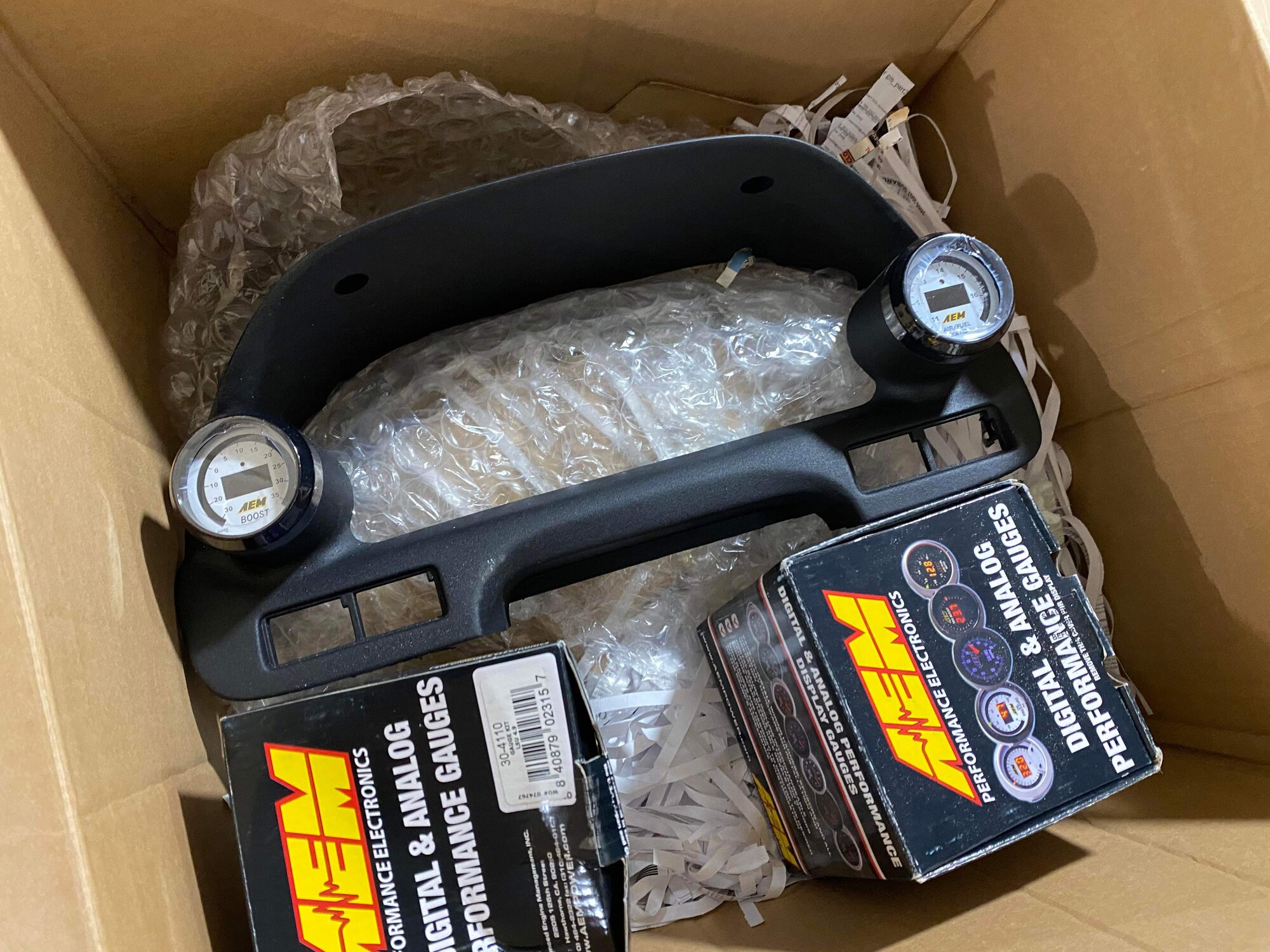

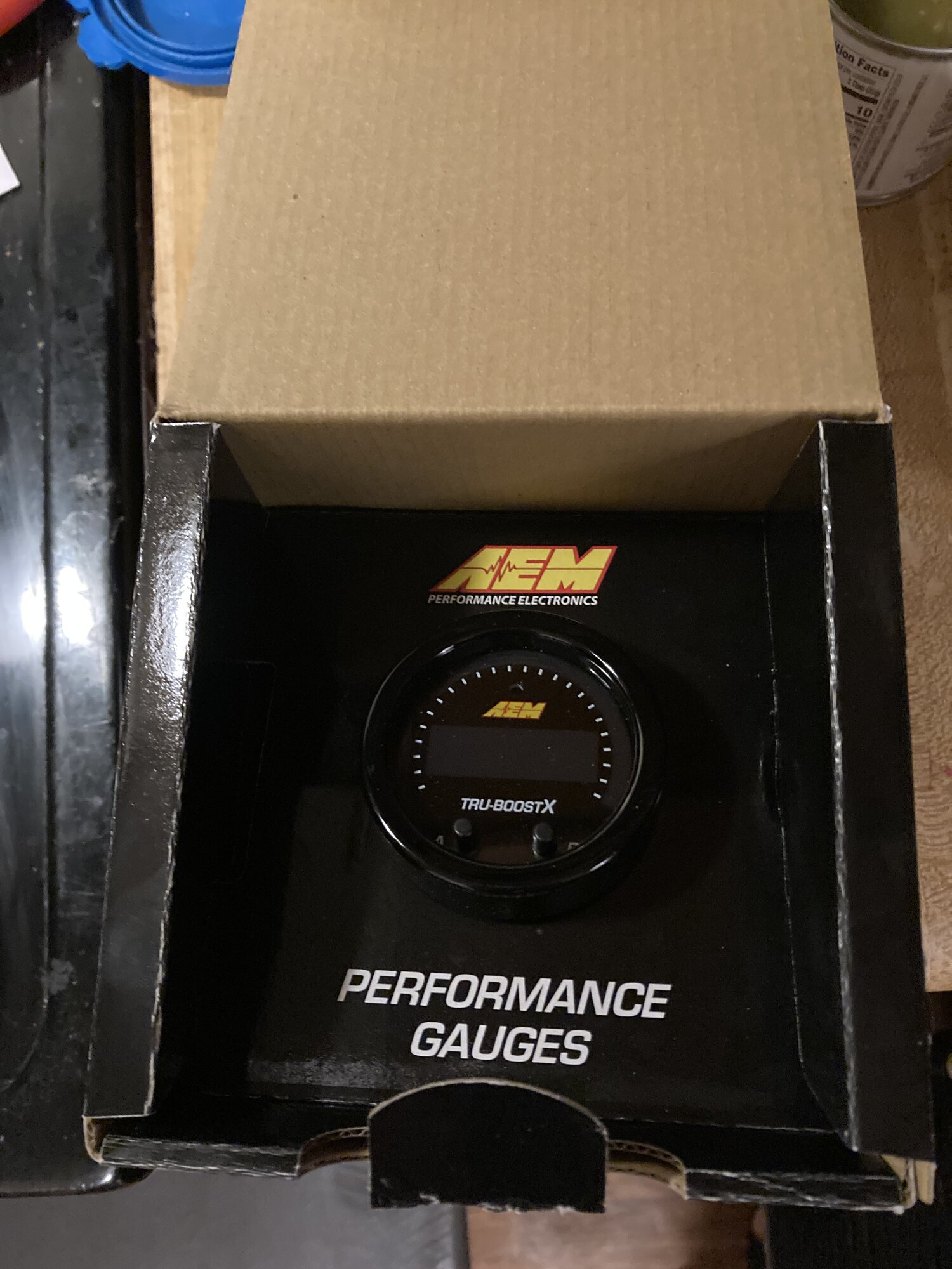

This came in today. Yaaay.
I actually was trying to find the older model of TruBoost but all I could honestly find was the TruBoostX. Ah well. I'm gonna just plan on this thing not lasting, so I'm gonna keep the AEM Digital boost gauge I have in reserve. So when this thing dies, I'll swap back to the boost gauge and use the MAC valve from AEM and have ECMLink control the boost. I'll enjoy it until it dies though! The recall function that shows peak boost will be nice.
View attachment 751956View attachment 751955View attachment 751954

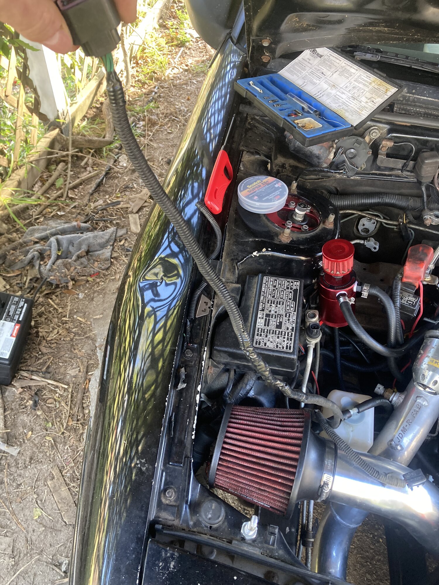

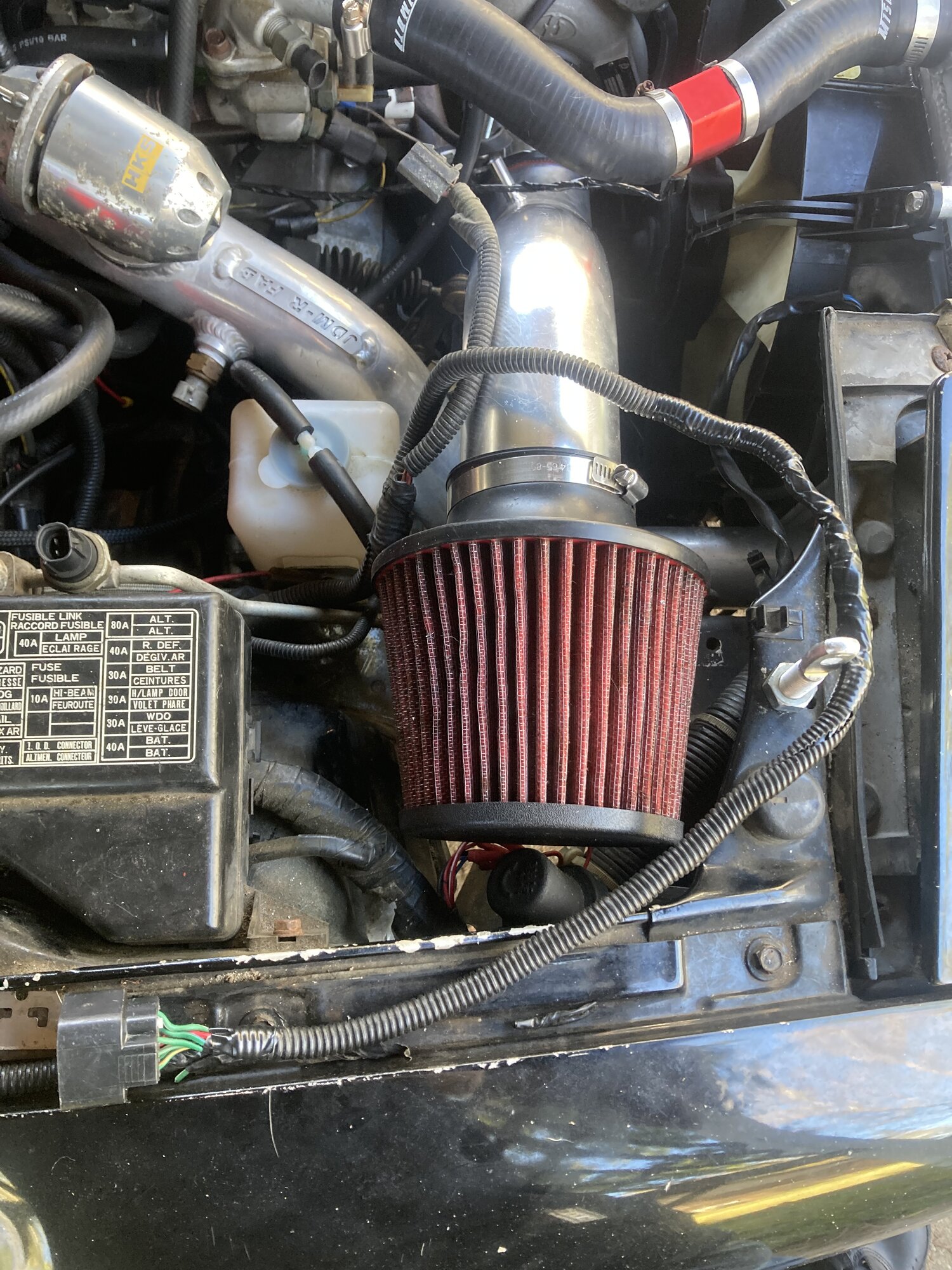

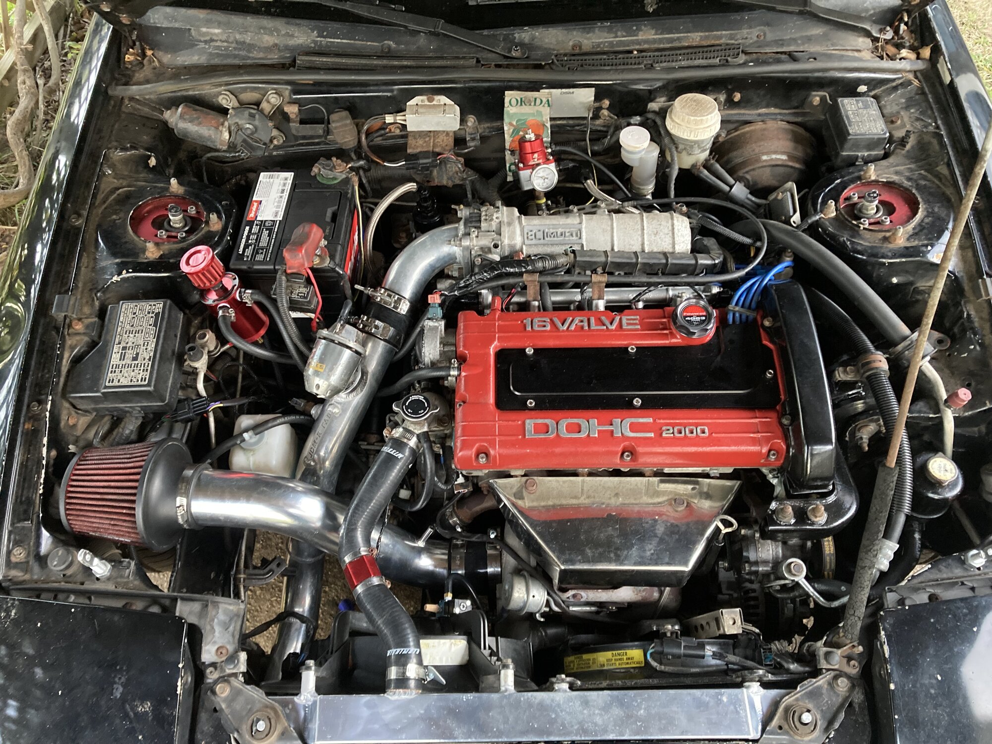

Decent progress today. Wanted to do some wiring today and I got to work early. First up was cutting off the old 2G MAF plug and wiring that was crusty and old. I can't even guess how old the wiring was, or when it was soldered but yeah. If I grabbed it and twisted it, ECMLink would register the MAP Sensor coming unplugged. Oof. So, I cut it all off, and resoldered on an OEM 1G MAF plug that was clean AF with some soft/supple wire. I finished it by using some double wall marine grade 3:1 adhesive lined heatshrink, and used the OEM corrugated tubing with some 3M 33+ electrical tape on the ends and over the soldered area.
Love it. So much better. From there I clicked in the ECMTuning Speed Density harness and wrapped that up.

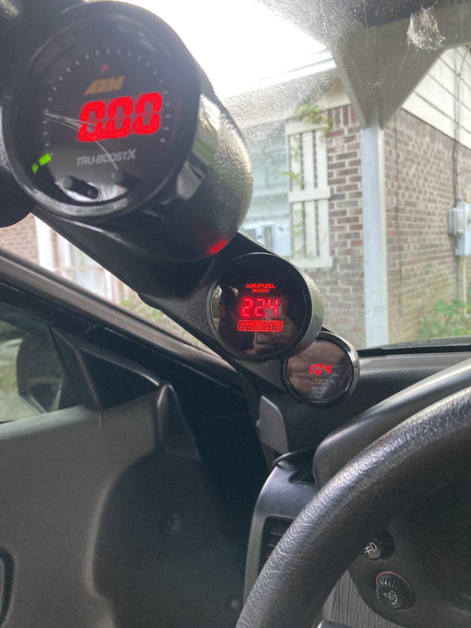

Next up was installing the AEM Tru-BoostX. This was to put it lightly...an "ordeal". In the past install I did, I routed the wires for all the gauges fairly okay, but I lost patience towards the end of the install and just put some wherever they'd fit. This time around, I took off the entire a-pillar trim and tweeter cover and re-ran/cleaned up the wires even more. The end product was much less wiring, and it's all ran through a hole in the OEM a-pillar trim, underneath the A-pillar pod. Looks like factory, and I'm very pleased. The wiring harness for the Tru-BoostX is super long so I actually could run the solenoid wires from the harness all the way to the engine bay without adding any extra wire. Still...this took forever, man. Curse my OCD.
And you can't even tell where I added the solenoid and ran the extra wires. I'm proud of this.

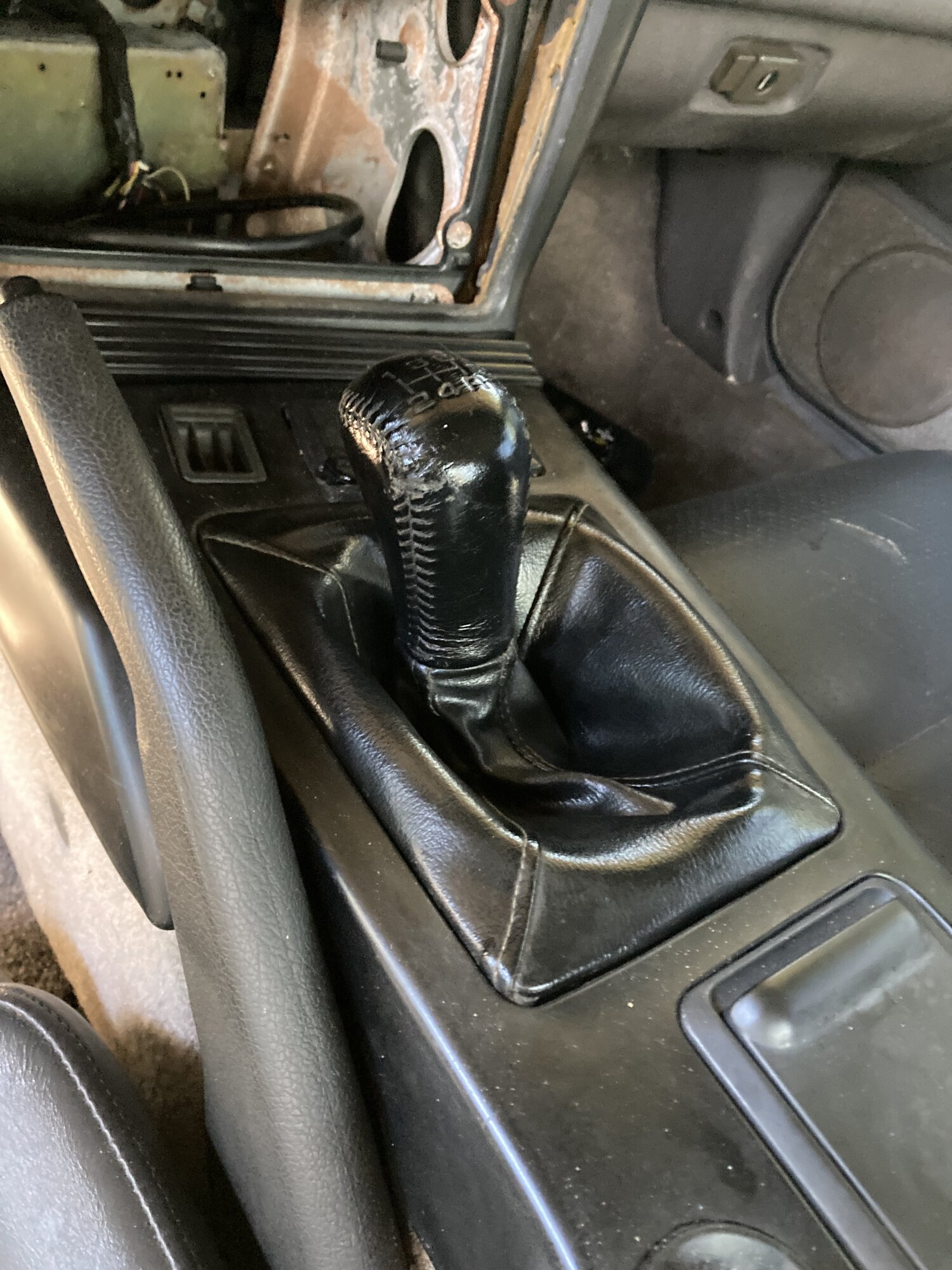

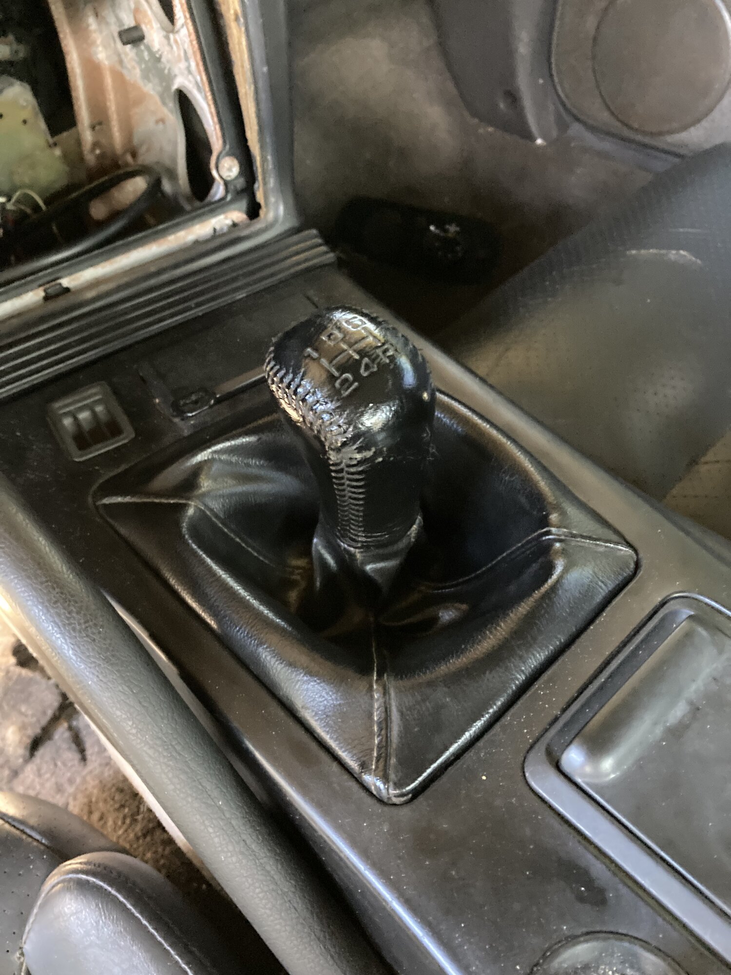

Lastly, kind of boring but I ended up getting tired of the shift knob I had. It would loosen because it can't be screwed in, and otherwise just kind of jank. I'm not giving up on it, but for now I'm going back to the heavy AF weighted leather knob I got. I also cleaned up the shift boot and the knob itself, and gave it some leather dressing. It's not wet in this picture, or oily to the touch. It's just that dry and shiny.

Either way, super happy. Test drive was successful, and no matter how much I twist the wiring, poke it, prod it, lick it do other stuff to it, no issues with readouts or readings. The Tru-BoostX also reads boost WAY faster than the old boost gauge, and actually reads in between 4 and 6. Lol. The old AEM Classic gauge just read either 4 or 6. Never in between. This one will actually read the exact number including decimals/half numbers. Like -5.68. Very happy.
I may legitimately upgrade the classic water temp gauge to the X series temp gauge because I like it so much, but honestly...I'm hesitant to have to mess with the gauges wiring AGAIN.

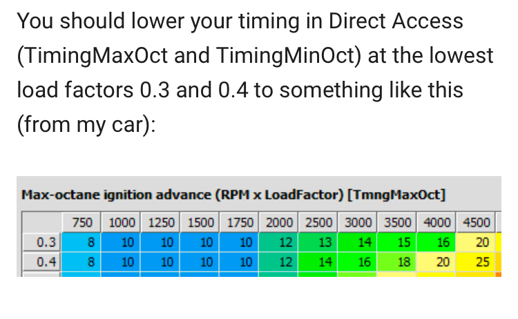

Can you upload a log? I don’t feel like going through the thread to look for one LOL And are you back on sd? I don’t remember
I’m personally using stock 1G min/max octane timing and fuel maps. You can get them from ecmtuning. This helped an idle surge issue I was having at cold start
I would put the sd map back to stock and start over. Cells at idle should be upper 30s lower 40s don’t lower them to get airflowperrev to .25 like the how to suggests. That’s probably for stock cams your car will act up (ask me how I know)
For fuel I used the injbattadjust from fic and adjusted the global until stft was hovering around 0. Seems to be working well for me so far. Car runs great
Make sure your tps and isc are adjusted correctly. I have my target idle at 950, hot start enrichment enabled, and don’t have the fuel pump prime with key on

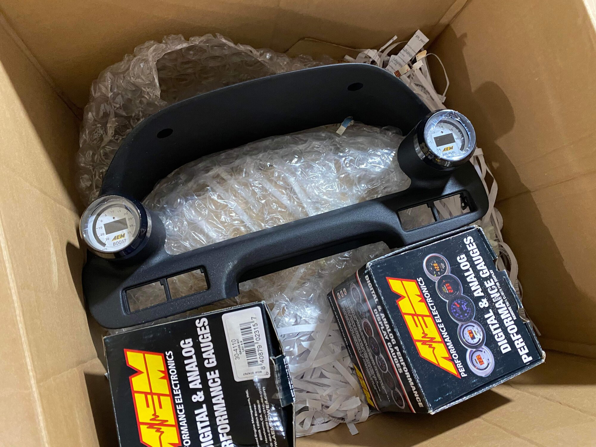

Makes me sad. I really don’t wanna have to rewire the gauges AGAIN. Lol.
If I switch to the aem wideband I’m gonna say screw it and just swing for the x series water temp gauge too so they all match.
Screw it, I just went ahead and bought both. Not gonna keep messing with replacing the sensors. We’ll see what happens with the X series stuff. At least it’ll all match now. Woot.
