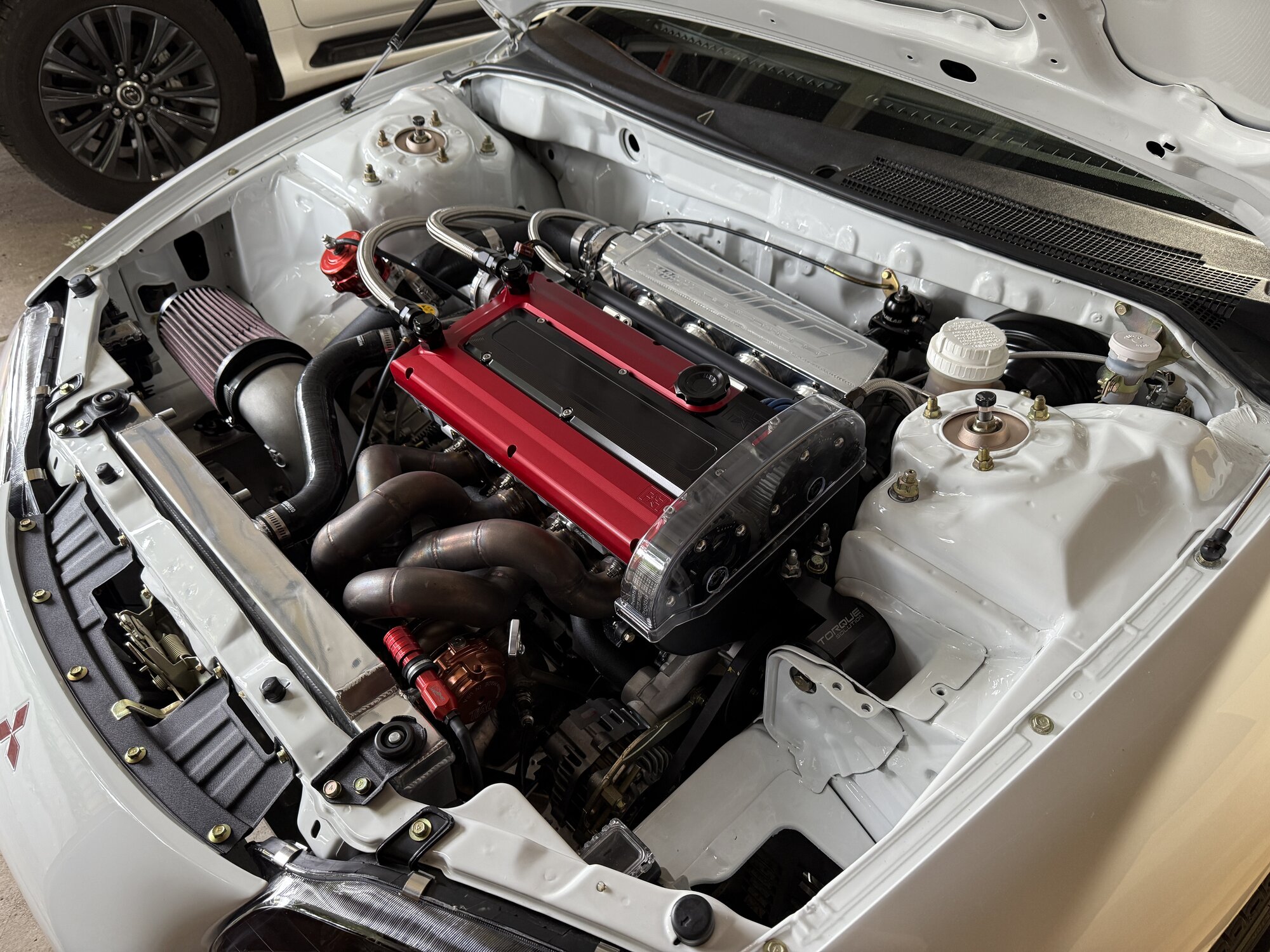

This is the ongoing build of my 99 Northstar White GSX.
So I got the car back in December and finally got to buttoning things up since it started warming up. I have to do all the new break-in stuff with the new long-block etc. Wanted to get ahead of it and have it dialed in before summer hits. Car is filthyyyyyy.

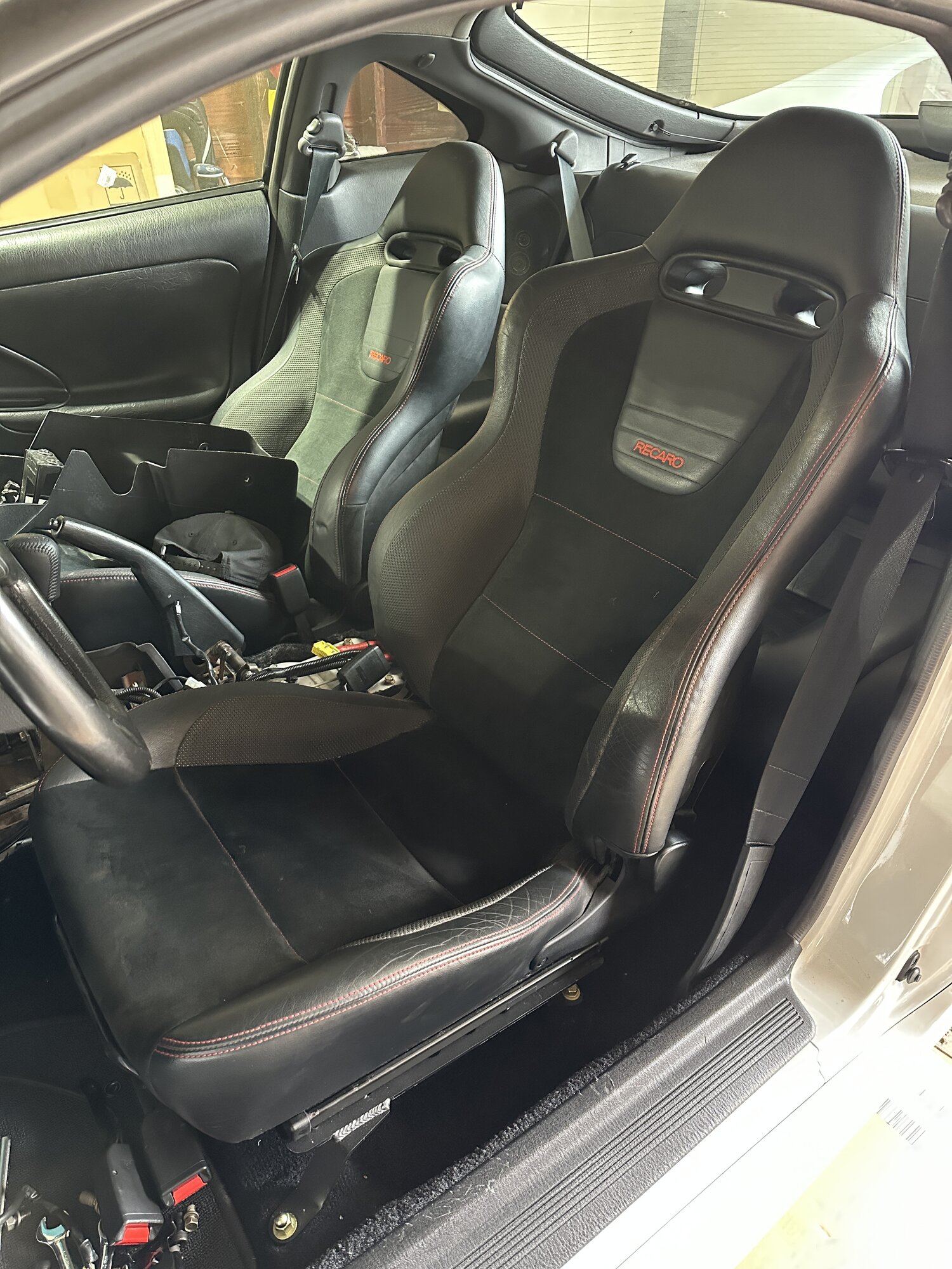

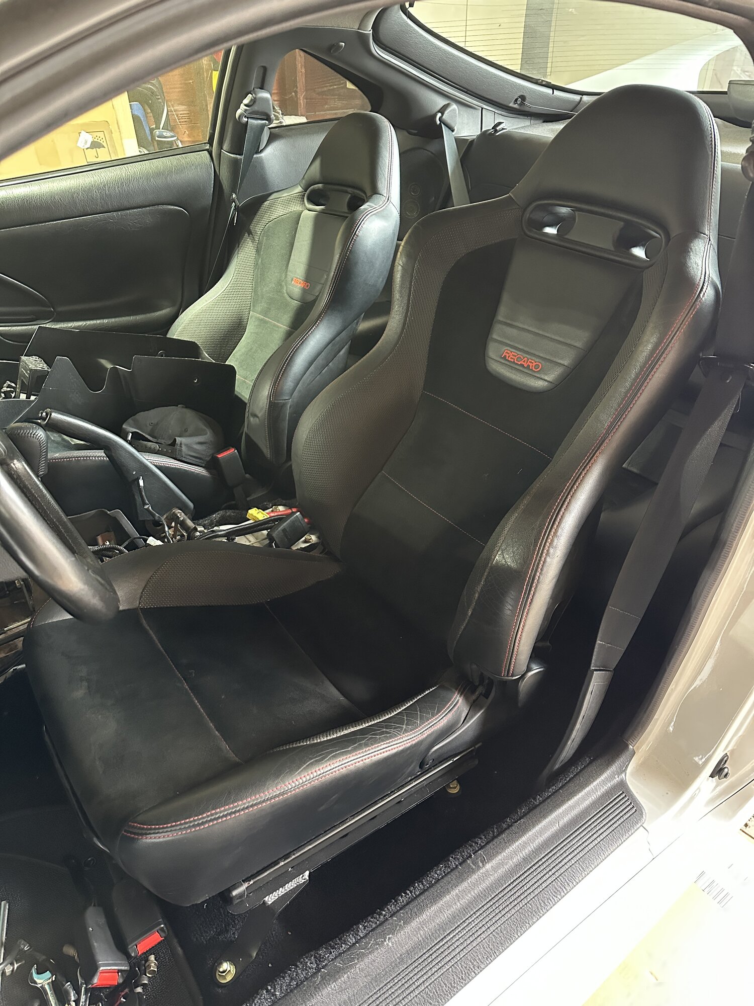

I finally got around to getting the recaros in. I used the planted brackets as they were the only ones available. I had to cut the seat belt bracket off of those, as I was using the factory recaro seat belt buckle mount. The seats sit a solid 1.5 - 2 inches higher than OEM.
The slider lever hits the brackets when you slide them all the way to the rear, I will probably leave them like that as I will never have them slid that far back.

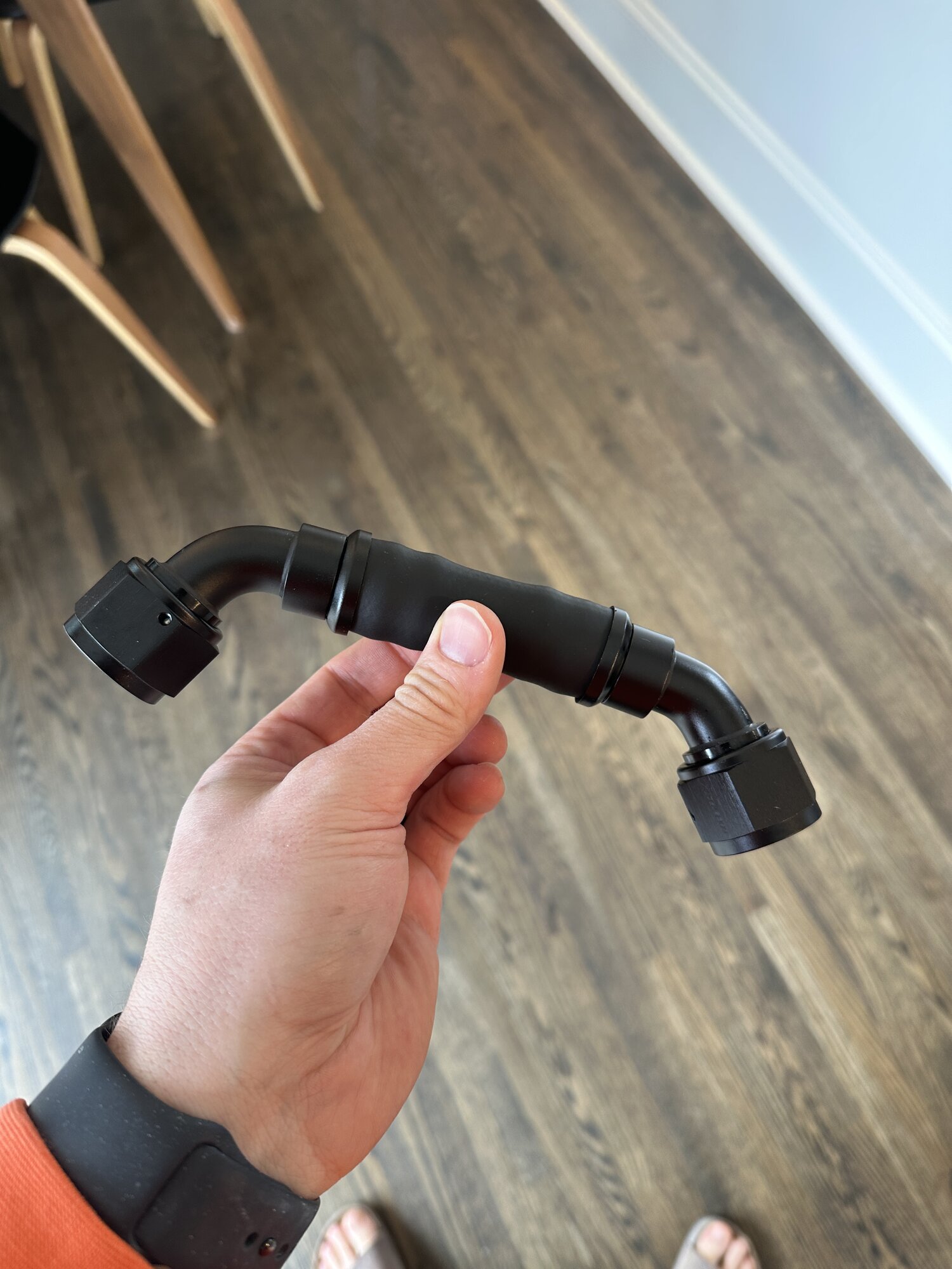

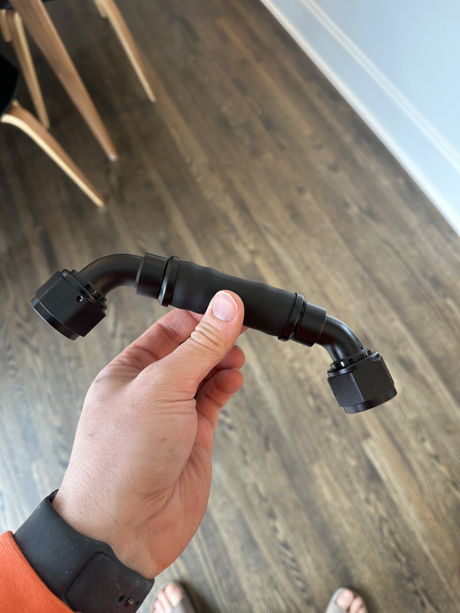

Some other notable items, I fixed the turbo drain line as I had a tiny leak on the previous one.

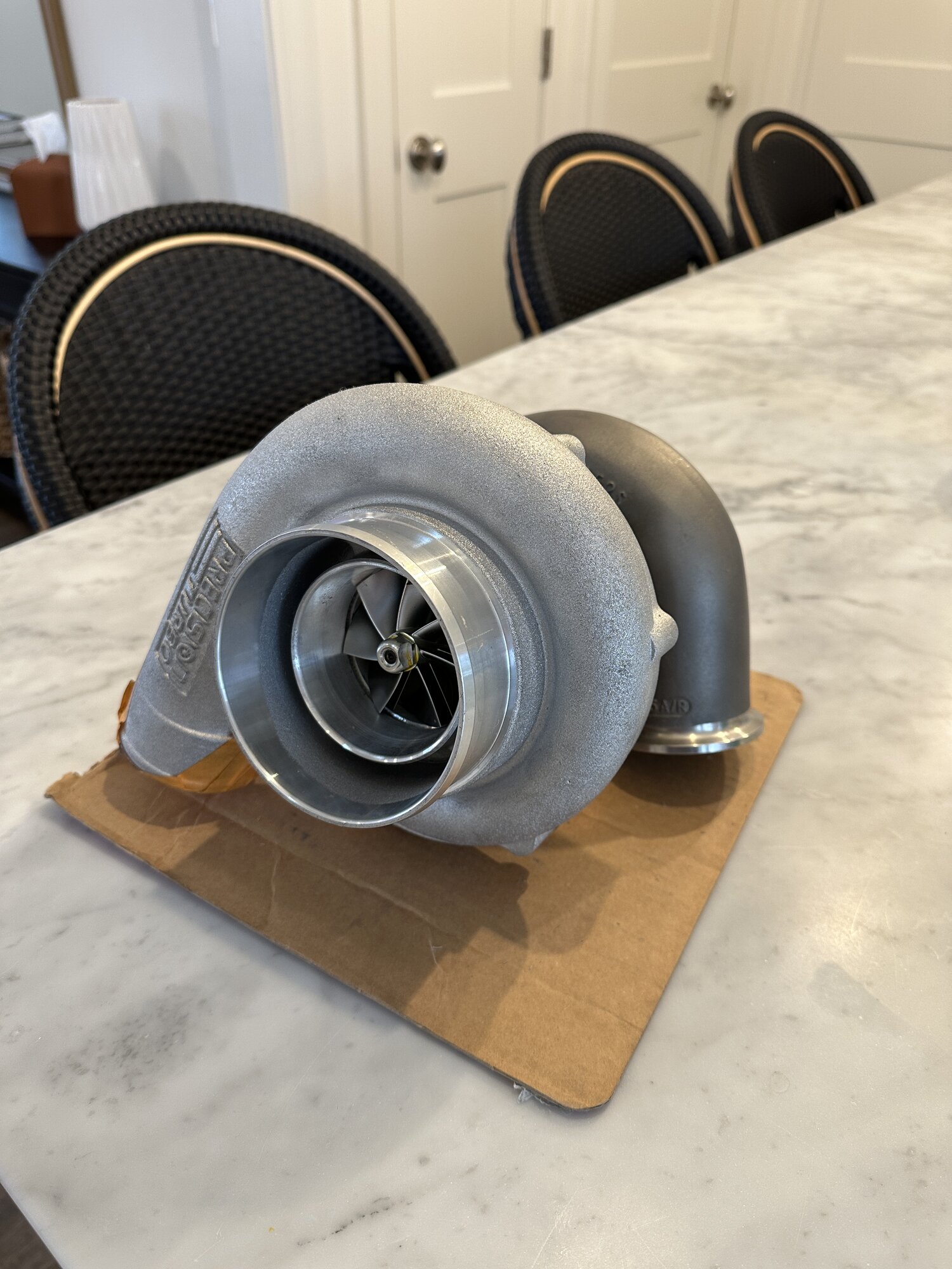

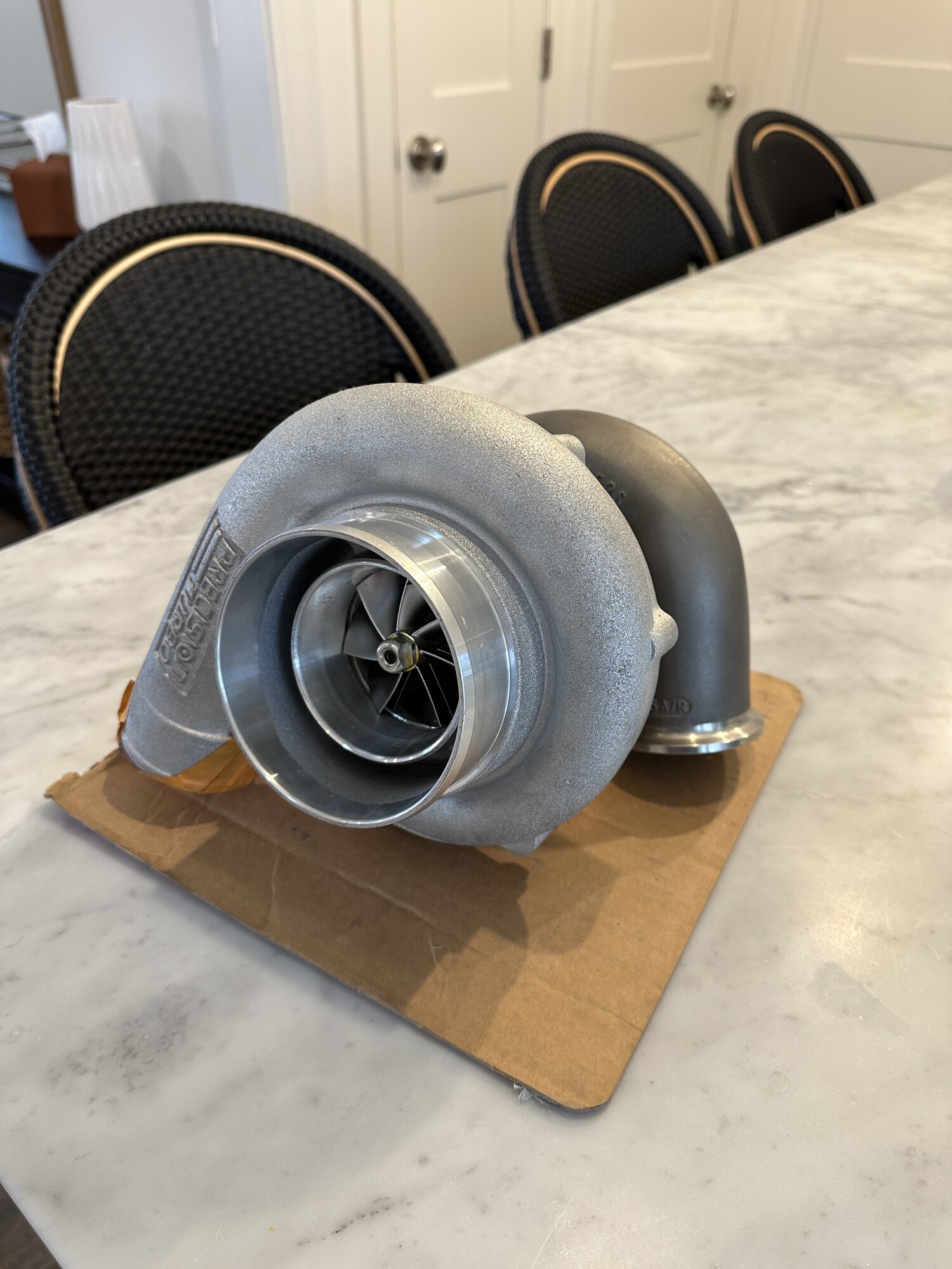

I also bought a 6466 gen 2. No idea when I'll get to this, but it was a good deal and I wanted to ditch the Holset at some point.

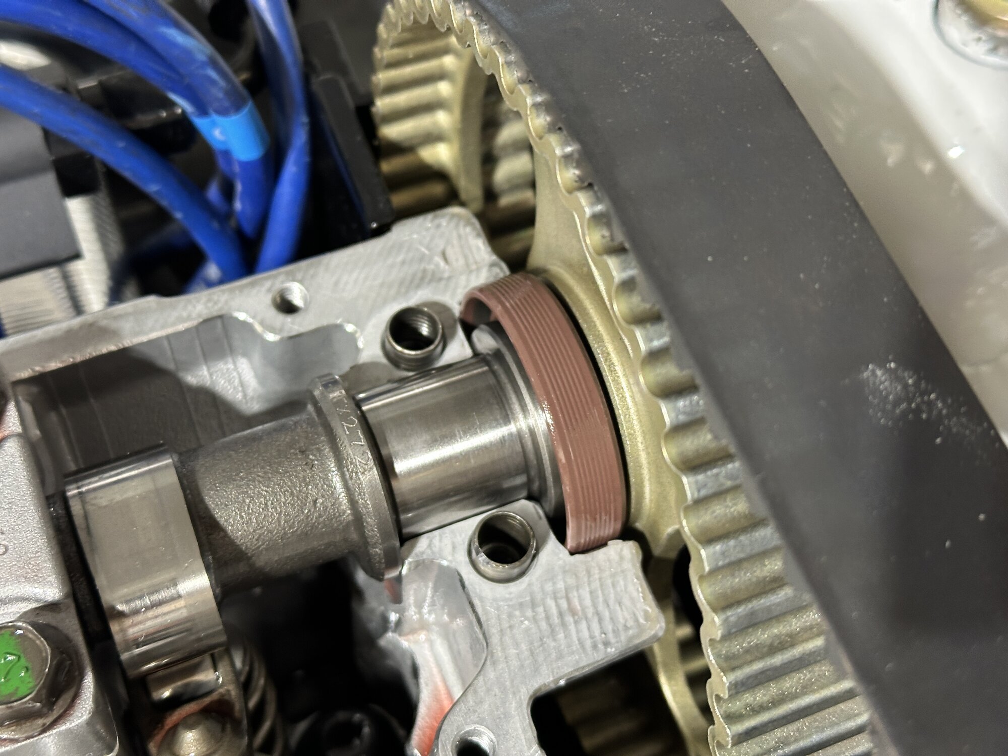

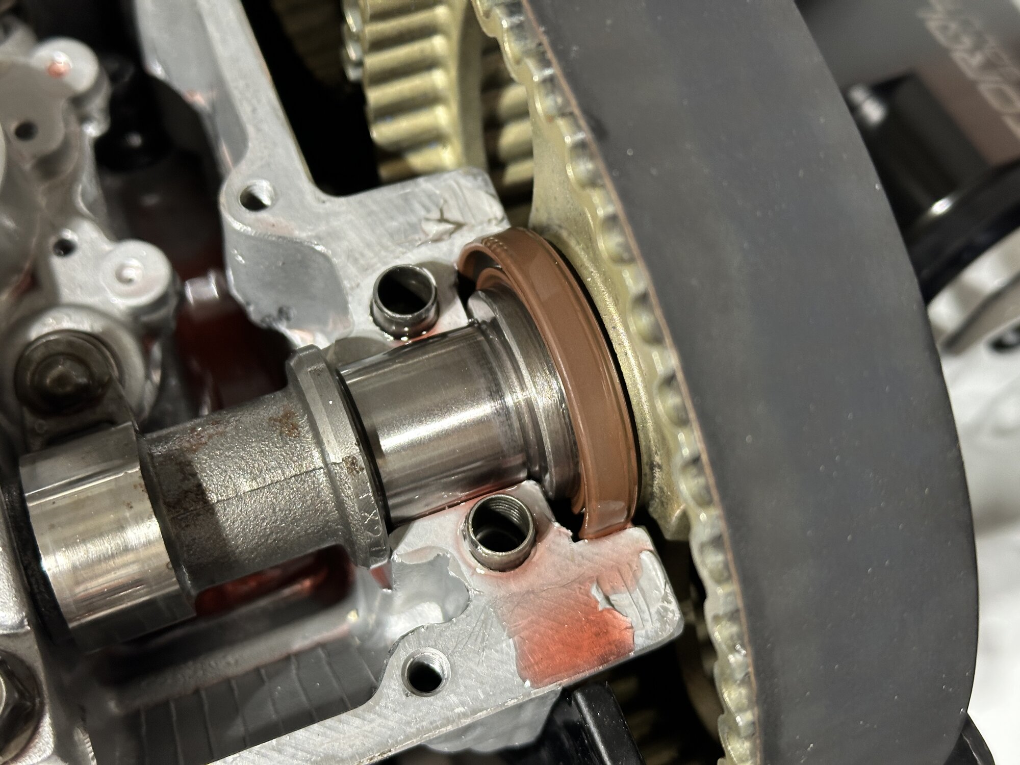

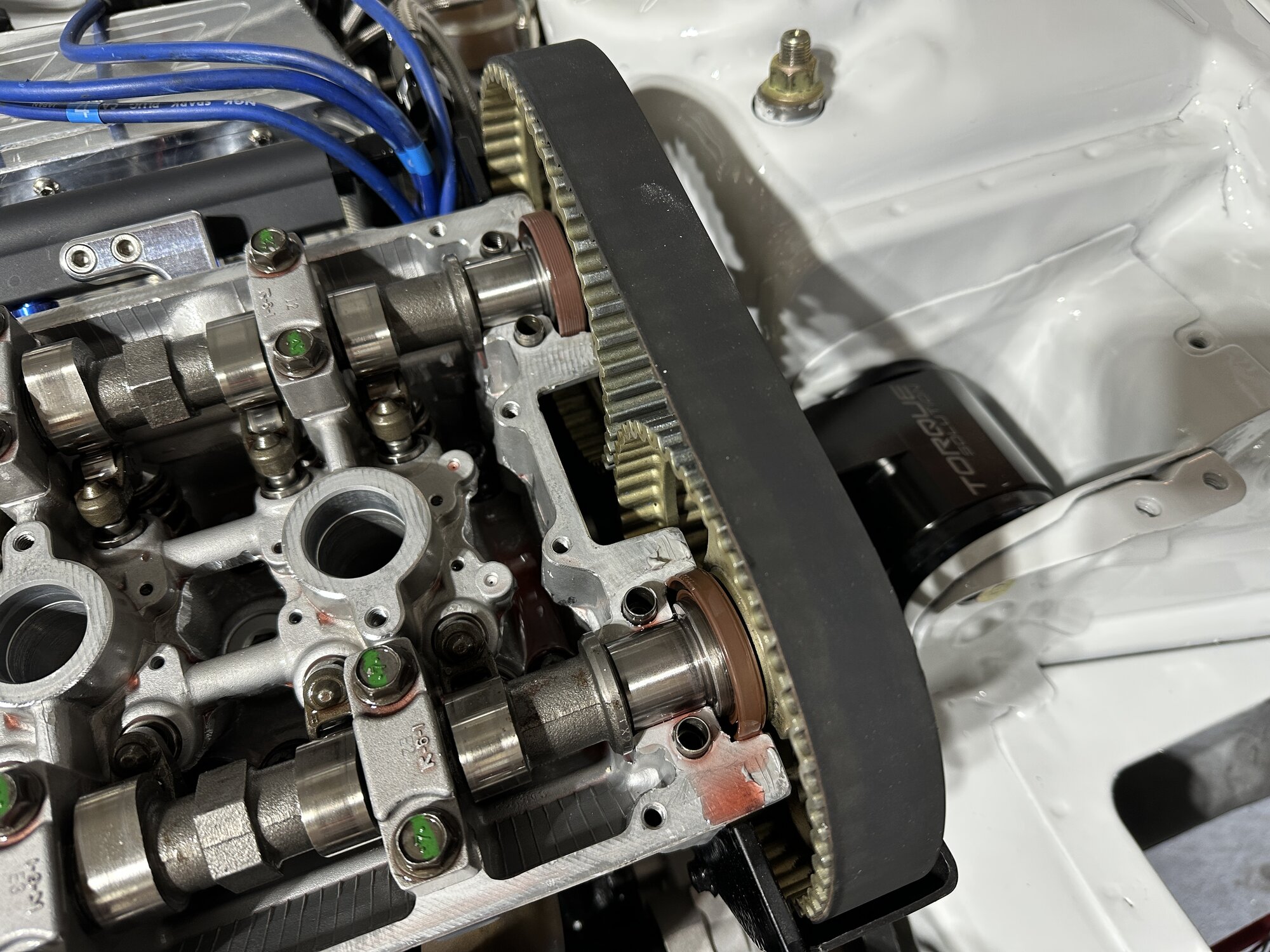

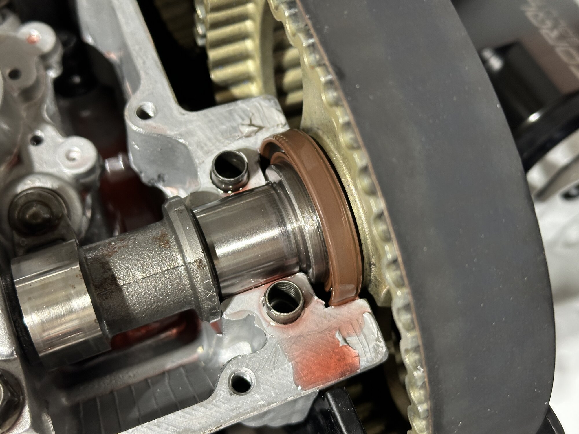

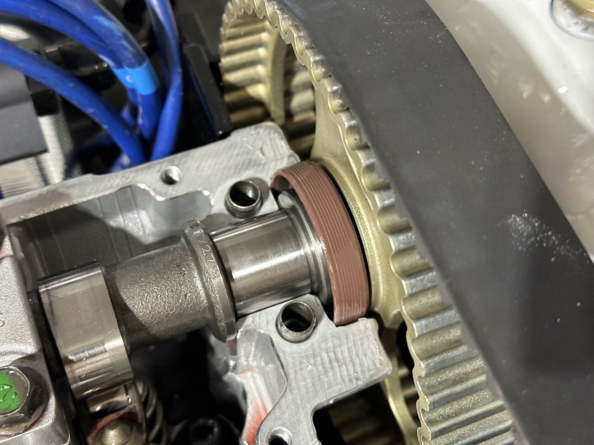

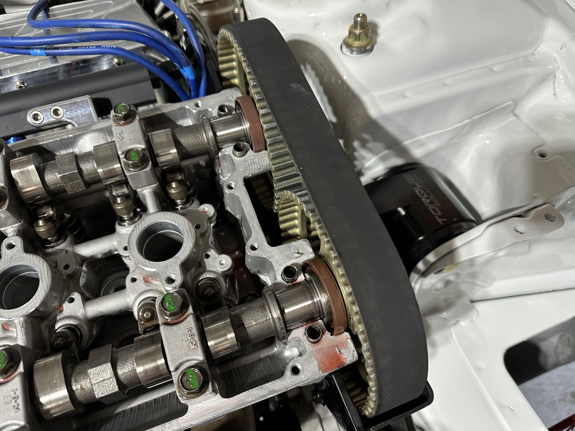

Unfortunately when I was doing my initial start up there was a massive leak from the brand new head... turns out the new shop I used (and was highly recommended) used some random cam gear seal. Note the OEM exhaust cam seal versus this random wrong intake cam gear seal....
So they came and picked up the car within 2 days and are going to fix their mistake and get it back to me so I can get going on it, again....
Peace.

Weren't you having cam seal issues on the other motor? At least the shop is standing behind their work. Hope to see you enjoying your car soon dude.
Yep,
First shop was just junk. They rushed the build as they were moving across country. They didn't RTV correctly per the FSM. They did use OEM seals though.
New shop seemed to make an honest mistake. They say Mitsubishi probably packaged a seal wrong. They RTV'd correctly, just have the wrong seal in there. I'm really not sure how you could install two different seals as they are identically, but at least they are working on it. Hope to have it done any day and back in the garage!

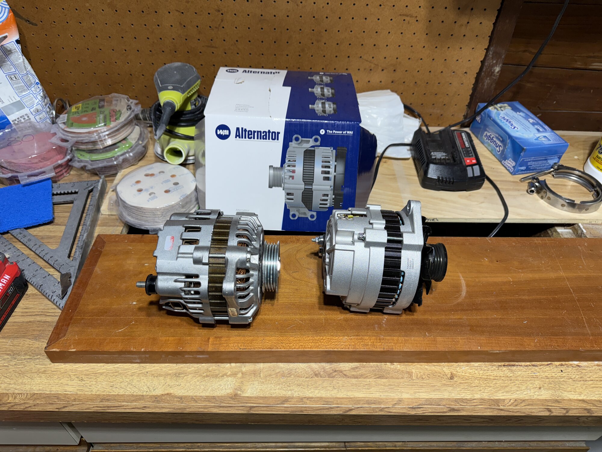

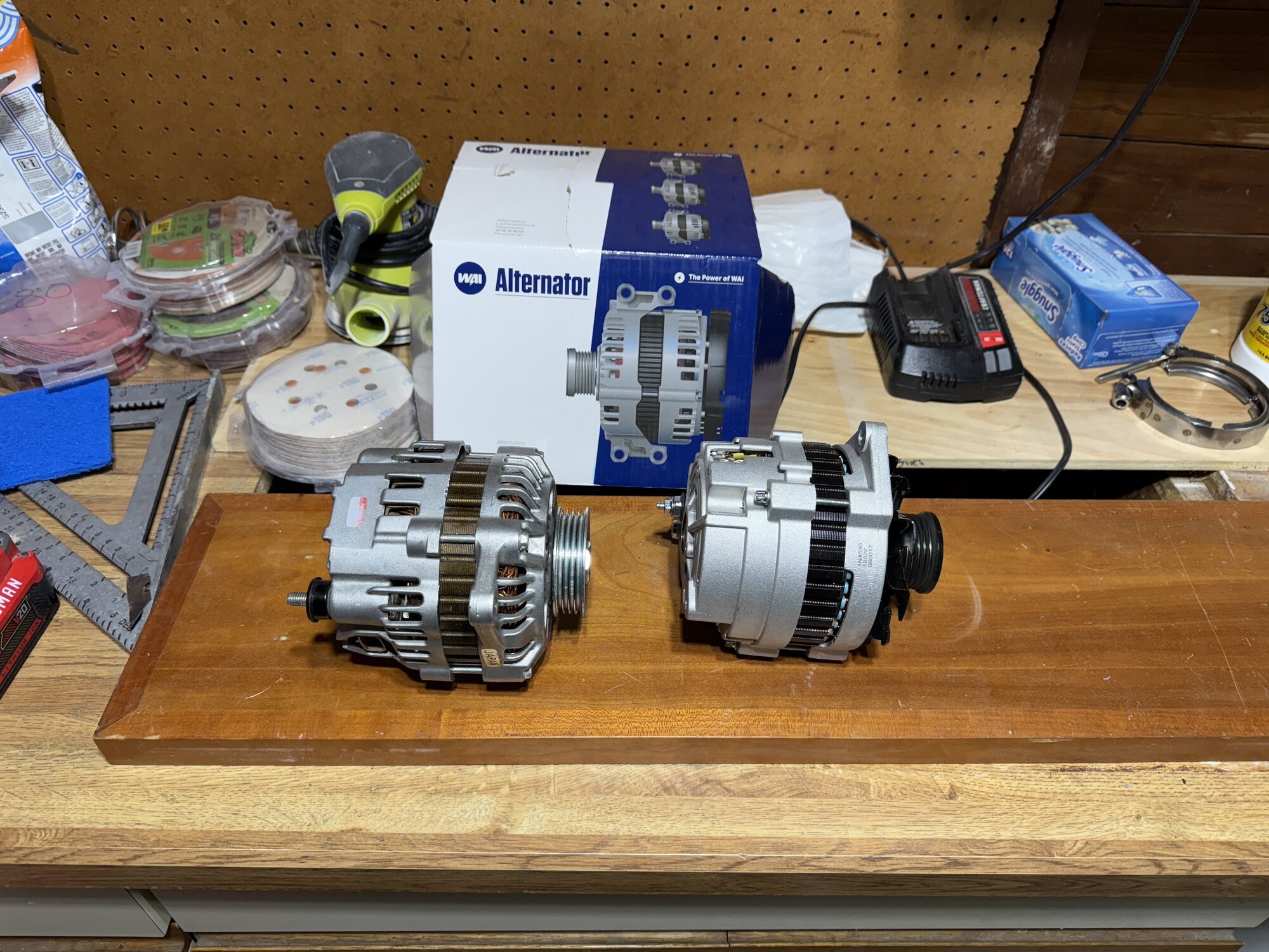

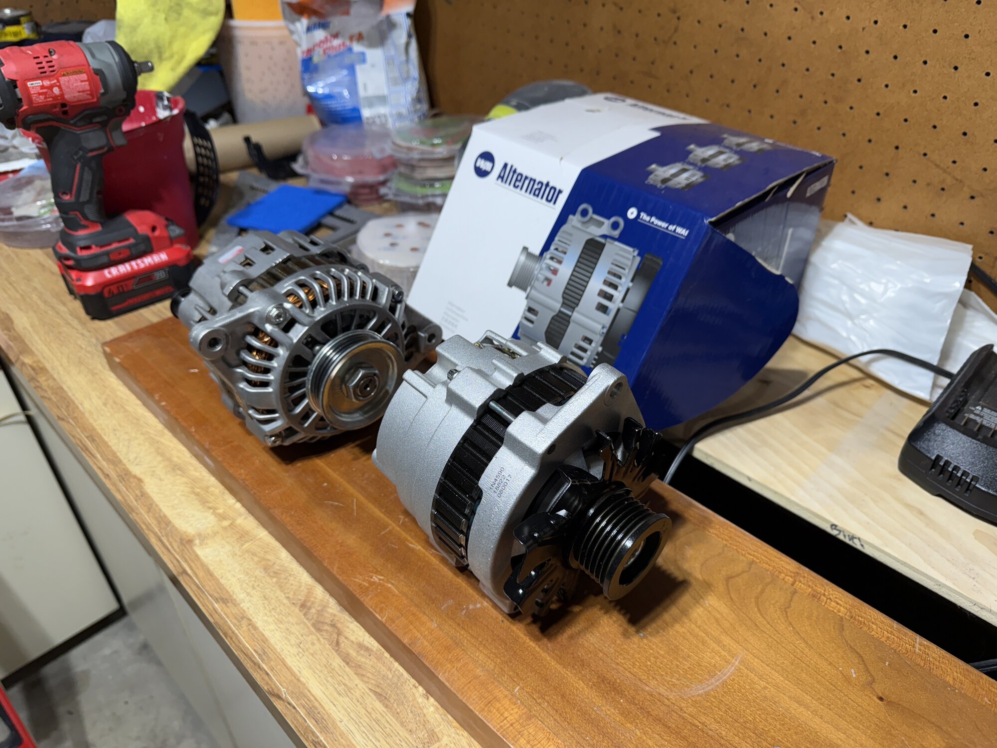

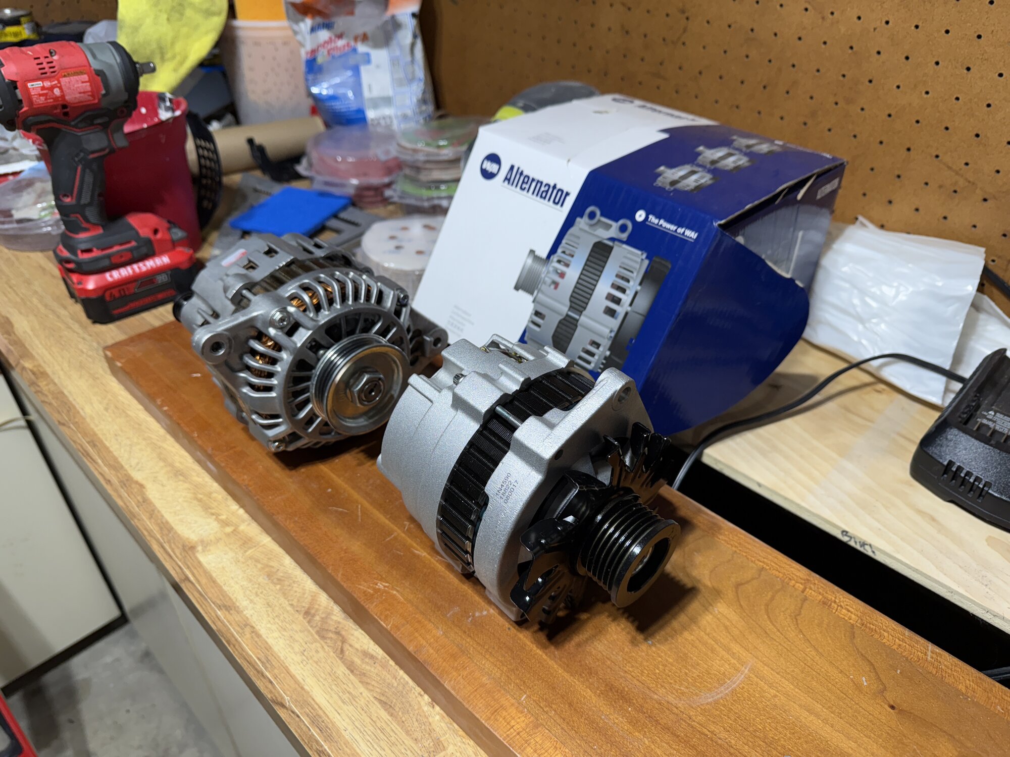

  • Alternator crapping out. Won't charge enough, you can hear the fuel pump change tone when you press the brake pedal / switch the lights on / flash brights etc. I ordered an MCR 160AMP Saturn Alternator, super excited for that.

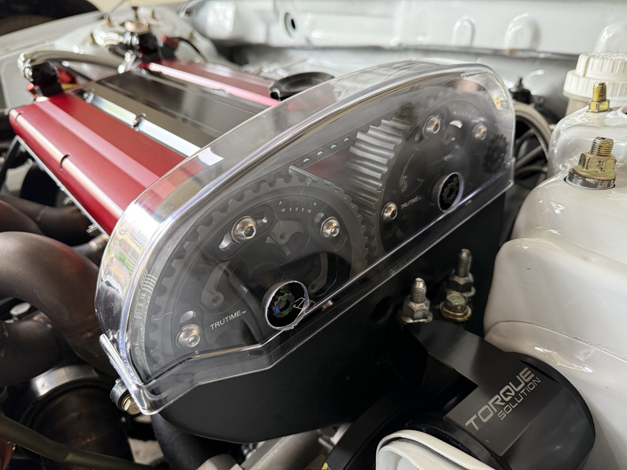

Another thing I had to do was replace all the AEM bolts to be slim SS button head bolts because for whatever reason they hit the timing cover from factory. I loctited all of these for peace of mine. Seems like some were a little loose. I also had to trim the timing cover for the cam bolts which stick out a bit as well. I give myself a 8/10 on trimming. I actually torched a socket and pushed that through the timing cover hoping it would be cleaner, but I still ended up having to use a dremel. Anyone have an idea how to make these look better?
Another thing I had to do was replace all the AEM bolts to be slim SS button head bolts because for whatever reason they hit the timing cover from factory. I loctited all of these for peace of mind. Seems like some were a little loose. I also had to trim the timing cover for the cam bolts which stick out a bit as well. I give myself a 8/10 on trimming. I actually torched a socket and pushed that through the timing cover hoping it would be cleaner, but I still ended up having to use a dremel. Anyone have an idea how to make these look better?
Yeah it's funny to me that they went to all the trouble of designing this cover and then didn't allow any extra room in it for these things that cause a bit of extra width with some of the aftermarket wheels. I went to all the trouble of making my cover wider but it's pretty ugly, you'd hate it LOL. I also made the feet sturdier though, much thicker.

-Alternator was taking a crap on me.

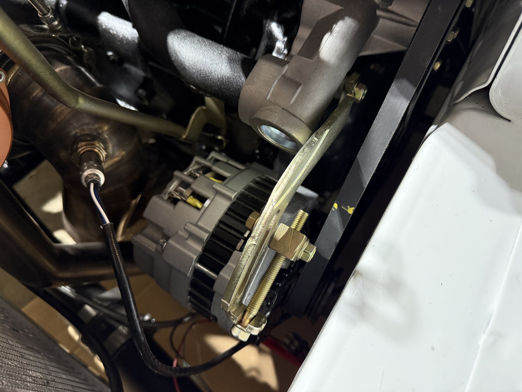

I picked up a new MCR 160A Saturn alternator as I have a prius EPS setup on the way and my stock sized alt seemed to be not keeping up. I could hear the fuel pump change noise when using some accessories etc.

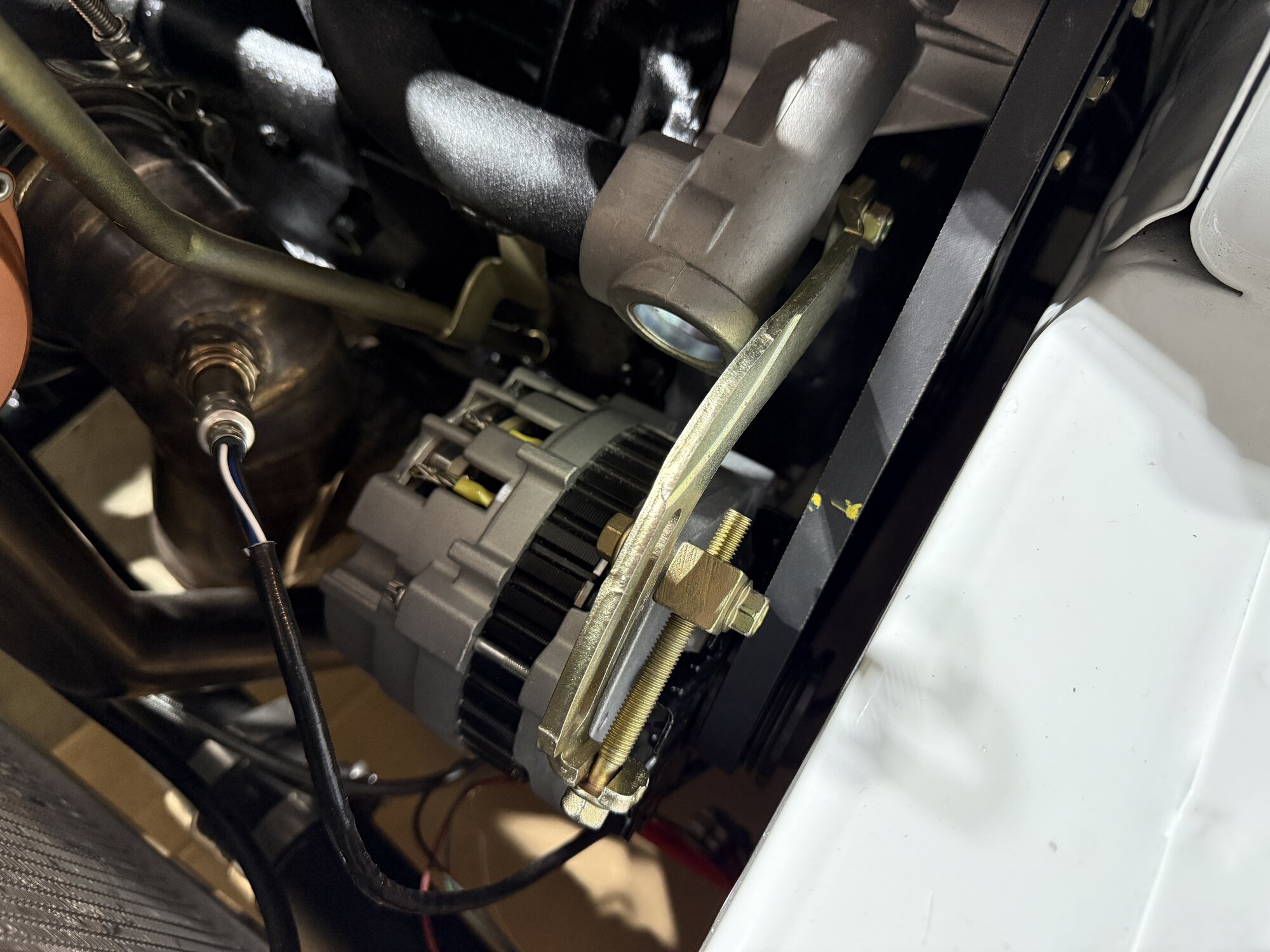

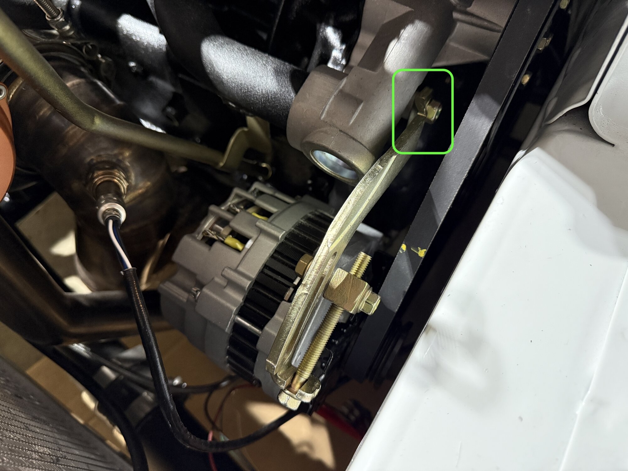

I flipped the bracket for now. Seems to work just fine...

Brady, I'm running a MRC 160 too. How is yours wired? One wire to a fuse and one to the battery? How do you see voltage? On DSMlink I'm assuming. Thanks Vic
I just have the single 4/0 from alt to battery. I'm definitely not seeing full voltage until it is above 1,050 or so RPM.

The leverage needed to hold the alternator at the right spot is the short bolt that goes through the T-block, bracket slot, backed up by a nut/thredded ear of the alternator. The long bolt in the t-block that goes to the open notch is just to set the tension. As you said - this should just be "for now" until you get a proper bracket. Also note - when you remove the bracket by taking out the water pump bolt - that bolt also helps the water pump seal against the block. Be sure torque it back down to spec and anticipate some coolant leaks.
That bolt holds the water pump on?!?!
