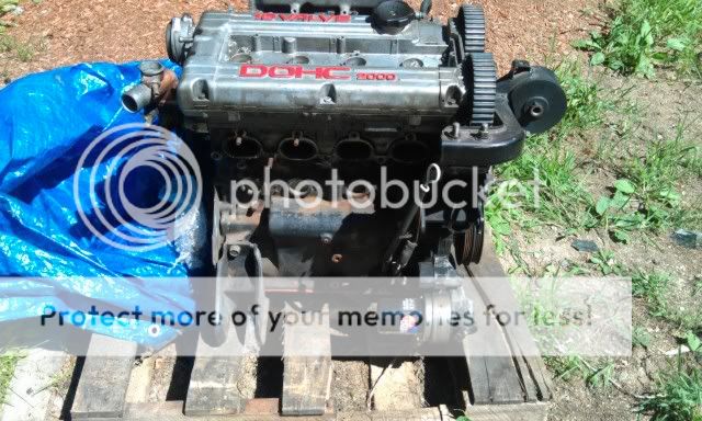

Though hours of reading the forums I decided I was going to get a 4g63 and just swap it in. I spent about 1k trying to gather all the parts together when I realized that I was no where near as mechanically inclined as I should be to take on a task like this, so I started selling those parts and looking for one that already turbo'd. Here are some pictures of the 1.8 and the motor I had gotten for it but then sold it for my next car.

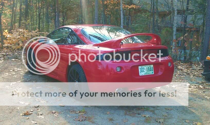

The next weekend that I came home from college now being about mid October, I had some VHT and a rear strut bar waiting for me when I got home. The VHT tail lights are awesome, I love the way they came out on the first try, they are a little dark but I'm happy with them and I will be getting the ECLIPSE part painted to match the car to finish it off.
From this

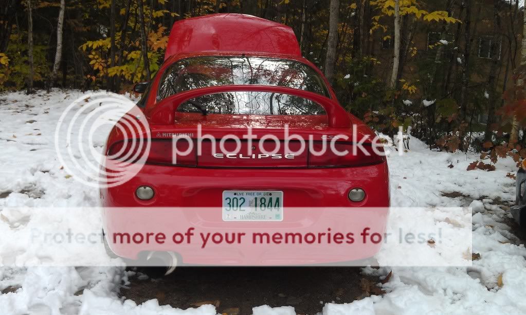

To this (snow is gone!)
I also installed the rear strut bar, I just need to cut holes in the covers to finish it off. I just barely fit over the subs!(snow is back:nono:)

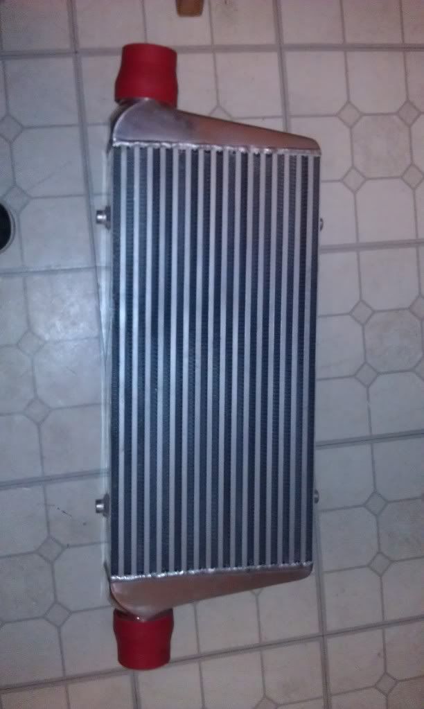

Big FMIC with 3" core, might be a little aggressive for just a small 16g but we will see.

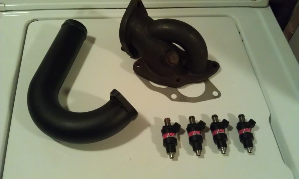

I also got a coated j-pipe, after market o2 housing 2.5" that will hopefully bolt up to my 3" down-pipe that should be in soon, and a set of RC 550 injectors. I will just be running a custom chip for now and eventually going to the link.

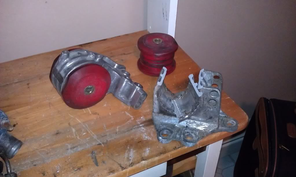

I also went to work on installing my pro-thane motor mounts on a spare set of mounts. The first one came out fairly easily but the second one did not as you can see.
Me 1 :hellyeah: - Pro-thane 1 :cry:.
ouch with that mount! that makes me nervous now cause I'm going to do the inserts also. what method are you using to do those?
I drilled out all the rubber I could, then cut the metal lining. I went to hit the lining out with a chisel and hammer and missed the chisel and caught the side of the mount instead. :ohdamn: I would suggest cutting that lining in 2 places and lightly tapping it out and you should be good, or just don't miss like me! I was kinda surprised how easily it broke though so mine could have had issues before.

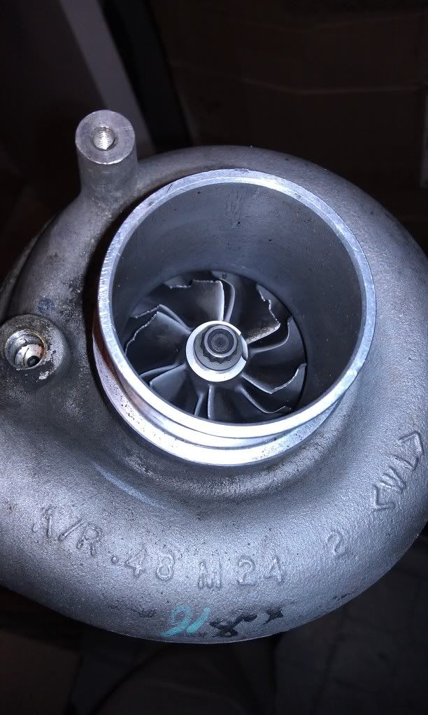

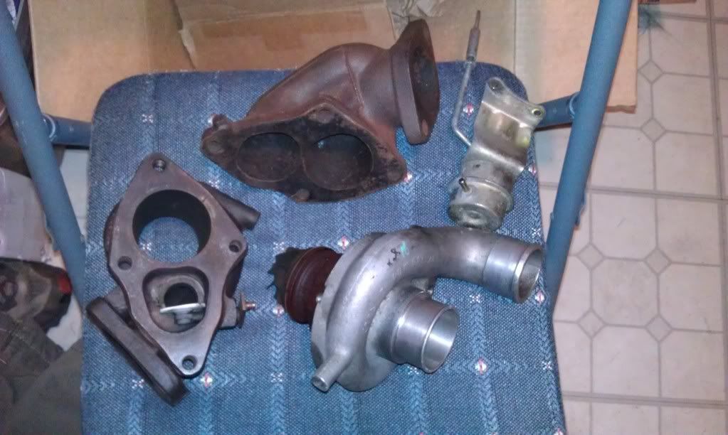

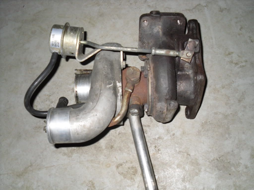

I don't have much to update but I did get some more parts in for my spring break swap. I'm planing on running the new t-25 until summer break when I should have the money to get dsmlink v3 and the rest of the smaller things needed to get the car to where I want before I swap the newly acquired t-28.
I need to put a little work in to it like replacing the intake fin but I got it for any amazing deal and it is a true Garrett t-28 with an adjustable actuator. It has no shaft play what so ever will just need some cleaning and the fins replaced and its good to go.
I got a 2g ported o2 housing. I'm not sure if I'm going to use the after market on I have or the ported still kinda in the air at this point. But both match up a lot better with the t-28 than they do with the t-25.

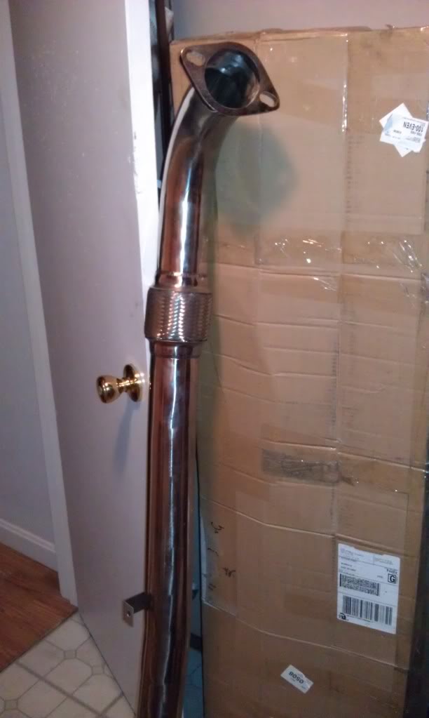

I also got my first of to orders from Allen at SIM. I got a killer deal on this 3" down-pipe which will finish off my exhaust after I cut part of the end off to fit the 3" cat in.

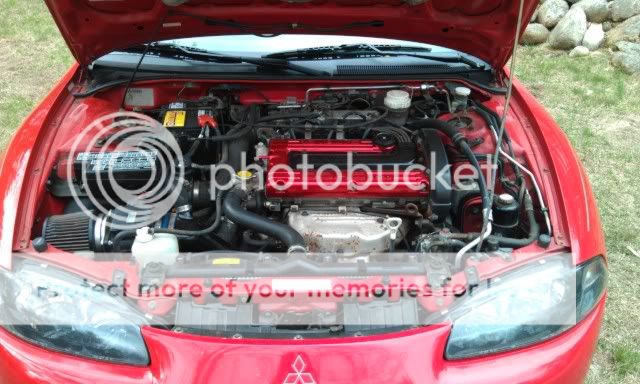

I did some of the final work on the car this break but didn't really have time to take pictures of the whole thing. I installed my 3" down pipe with 3" cat and 2.5" O2 housing. I also swapped over a new t-25 and did the BCS mod and am now around 16PSI. Next was a set of torque solutions shifter bushings which improved the the shifting 10 fold. When going in to gear you are certain that it is the correction one and probably was the best 25$ spent on the car so far. Then I installed a Mishimotor radiator and a JMF heat shield. I also got my AEM wide band hooked up
Here is what the engine bay looks currently...
