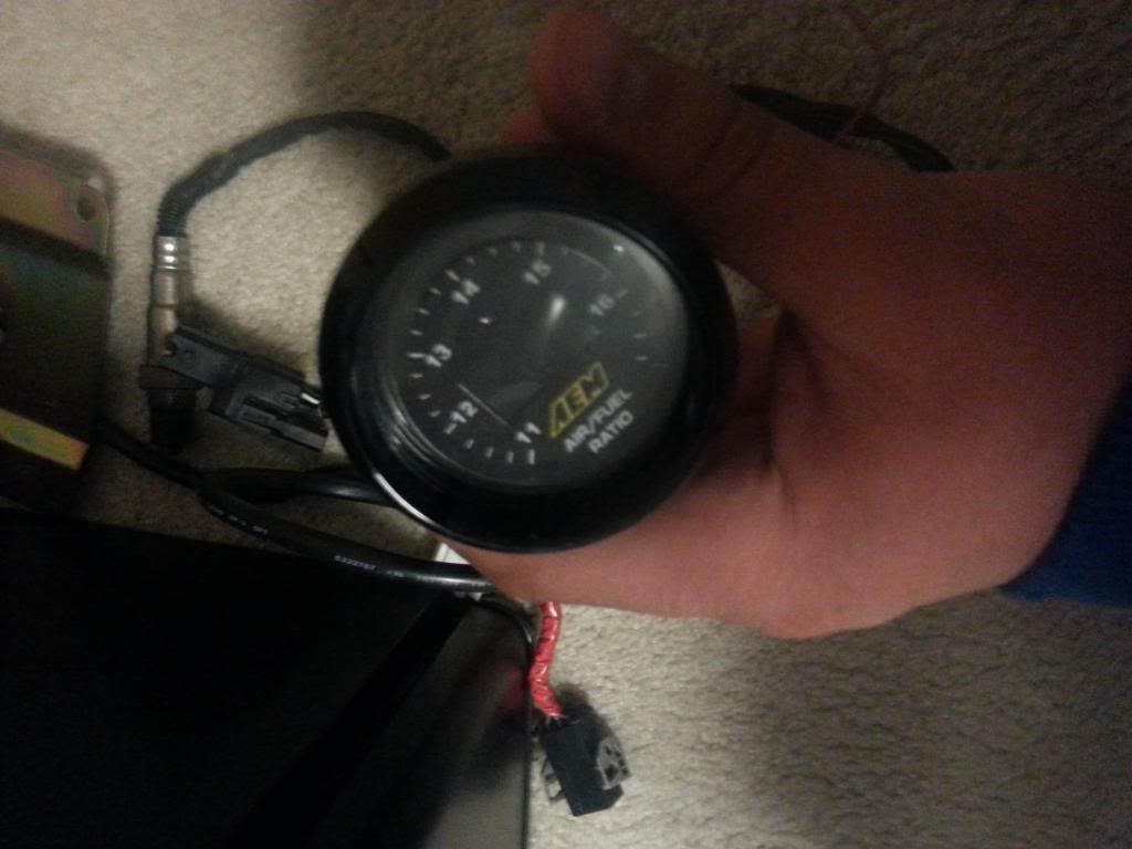

AEM Wideband Gauge

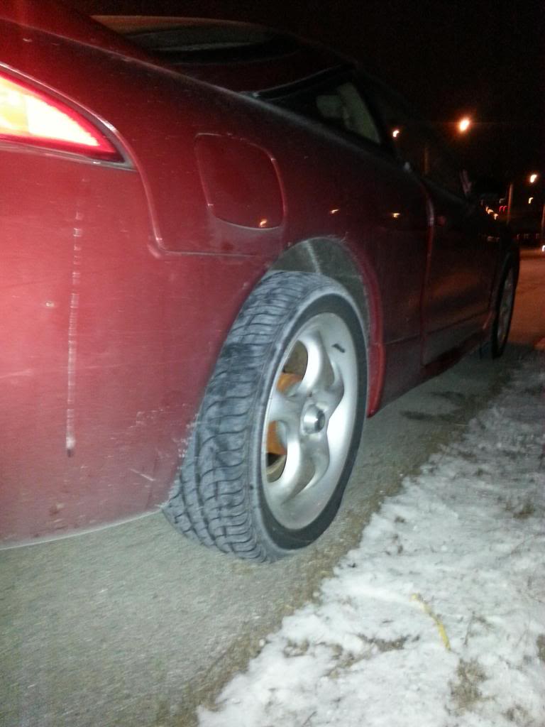

Got a flat tire on Christmas Eve, found out that the PO did not leave a hex key to get the wheel lugs off in the car, nobody I called had one, and every store was closed. :cry: Managed to drive 2 miles home on the shoulder at 2mph (Tow truck would take 5 hrs to get there) Merry Christmas LOL..
Ordered a new tire that took 2 weeks to come in since I had to special order it out of state because my tires were discontinued

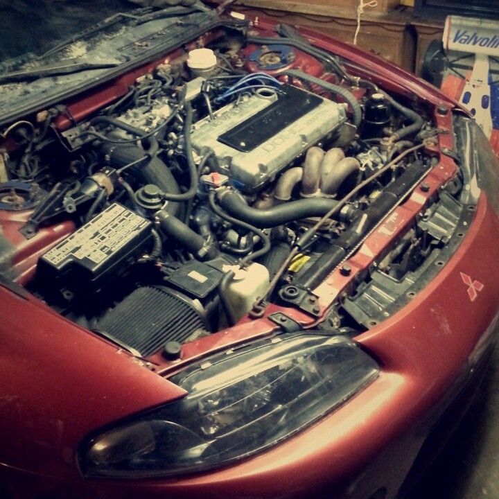

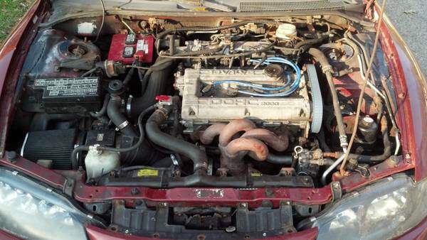

Post some pictures up of the engine bay. Just as an FYI I would make sure you have a real 16g on the car. A car with that many miles may have had the turbo die, and someone could have bought a cheap turbo from an eBay vendor as a replacement. Keep the boost low regardless, as you do not yet have the supporting mods to properly run that 16g.
Here are some interior and engine bay pics.

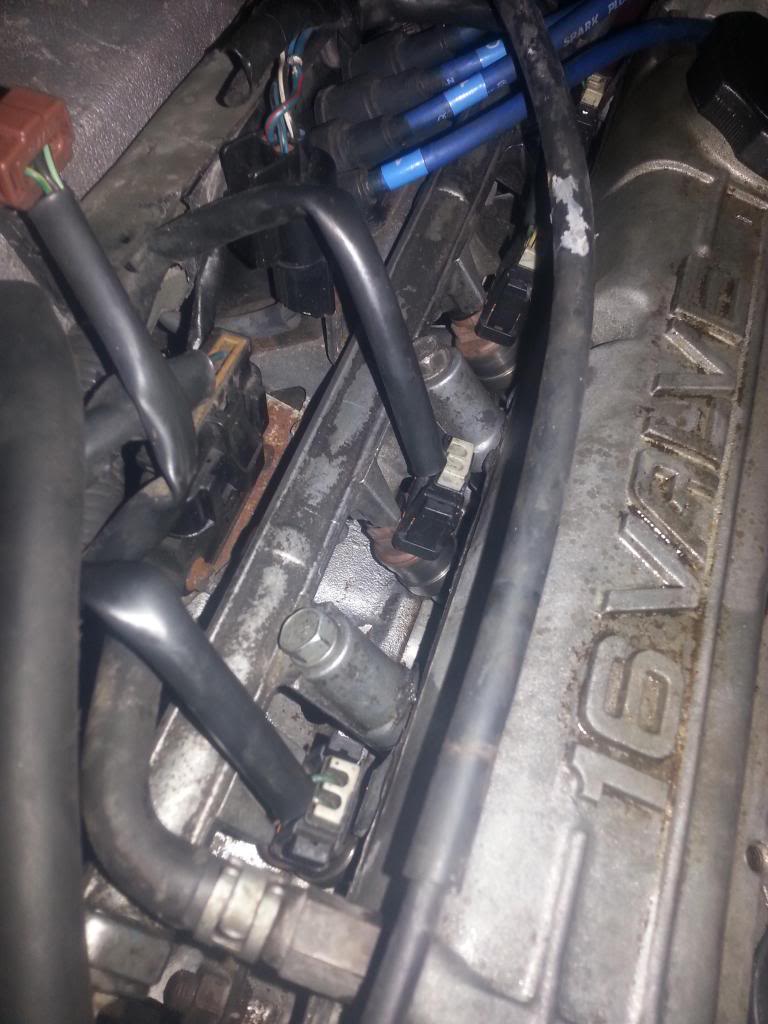

This pic is before the 1G BOV install
And I'm not touching the boost until I've got the other mods on my list on. Does that look alright? Or should I be upgrading other parts as well before raising boost levels
Woo, another Auto AWD. Enjoy never having to worry about bent shift forks, bad TOB, chattering clutches, heavy clutch pedals, changing clutch disks and PP for power, or breaking drivetrain parts. You should look into doing the kiggly shifter mod, as that will help a ton to extend transmission life and it makes the car so much more enjoyable to drive. I think it's great that you're starting out relatively slow, taking your time and trying to do things right. First step before you mod anything, is to make sure all of your maintenance is up to date. Timing belt, compression, all that fun boring stuff. When all that is good and given a clean bill of health and you've got the proper supporting mods, then turn up the boost(safely) and aim for your goal. Car is very clean. Keep up the good work!

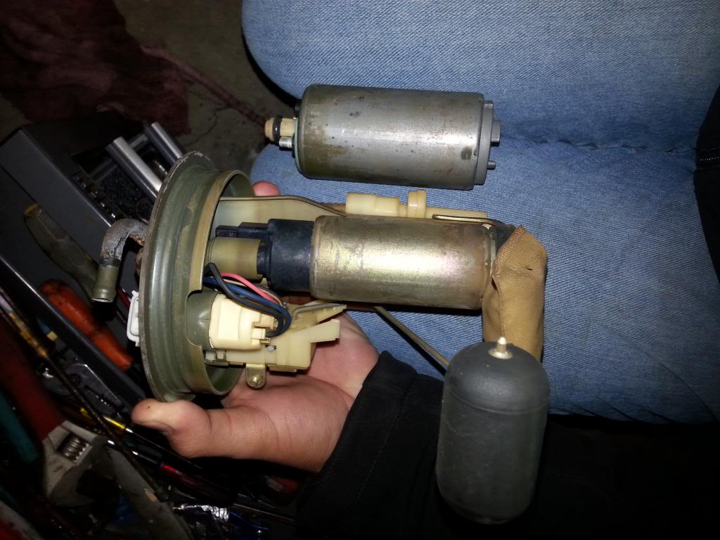

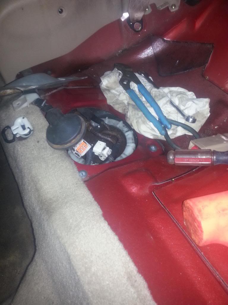

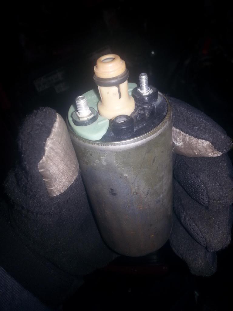

Took out the old fuel pump to to find that the fuel pump I purchased was actually from a vr4 and would not fit unless I rigged it, no thanks.
vr4 190lph fuel pump
Comparison of stock and vr4
I decided just to buy a Walbro 255 tonight since it is plug and play and I can install it the right way the first time.

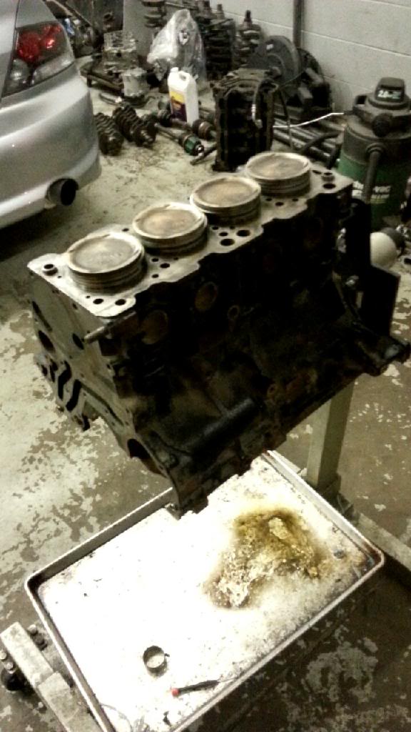

Build was coming along man. And i'm right there with yah with the spun bearing and being a teen. IT sucks :/ but this is your chance to build. If you go that route I would recommend getting all the machine work done on the block first, then go to the rotating assembly. A new Oem crank would be the safest route(cheapest) , With manly pistons and rods. They're cheaper then most forged and you'll hold well over your power level goals. Also look into Acl bearing or Clivite bearings Best of luck on your build keep us updated!
Sorry to hear about the rod bearing did that a while back, ended up just starting from scratch and rebuilding it, again LOL.
shes coming back together nice man
Thanks man!! And for anyone wondering how much boost I'm going to be running it's 22psi(14psi while breaking in engine) so hopefully I'll be close to 300hp to the crank, next step is FMIC and big trans oil cooler.

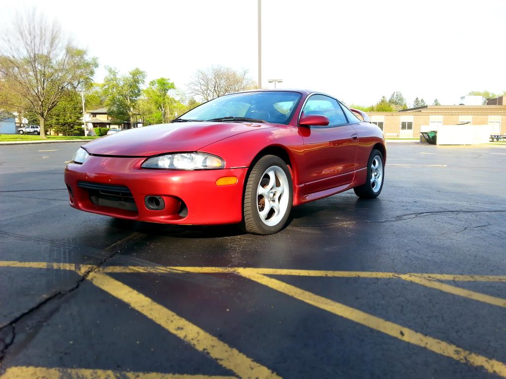

Car is running! Snapped a few pics today since it was nice out
