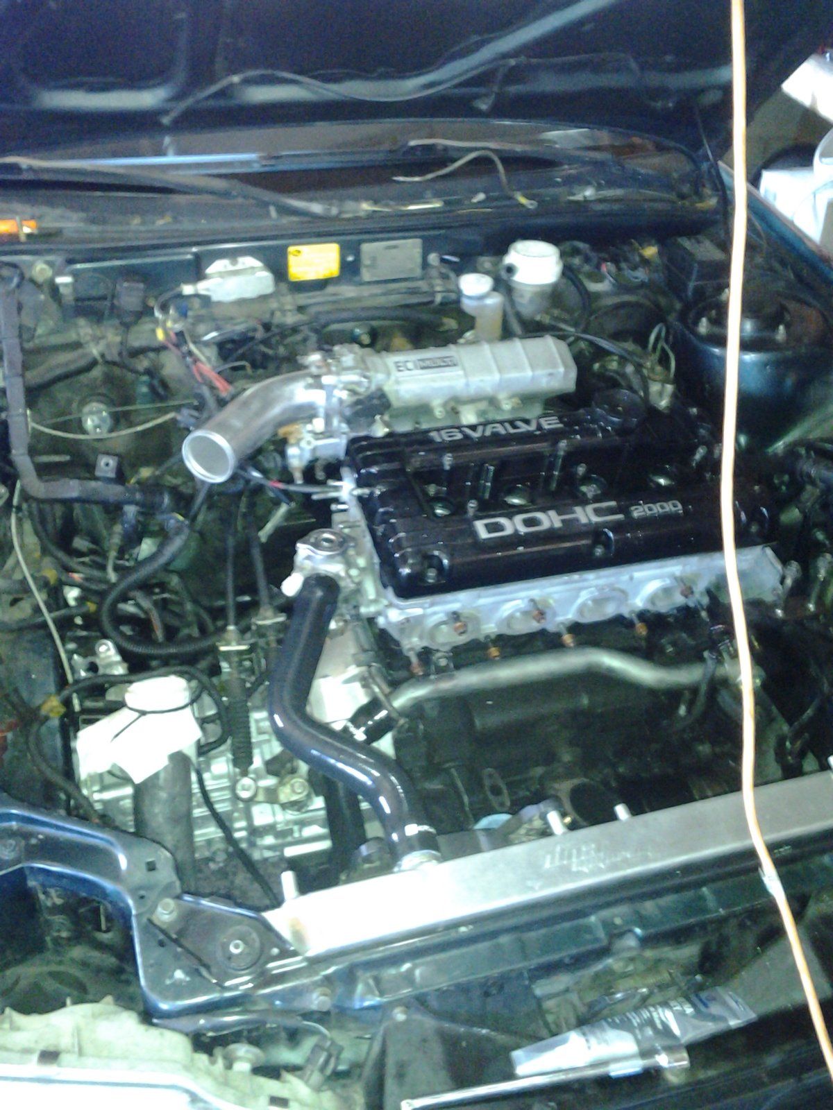

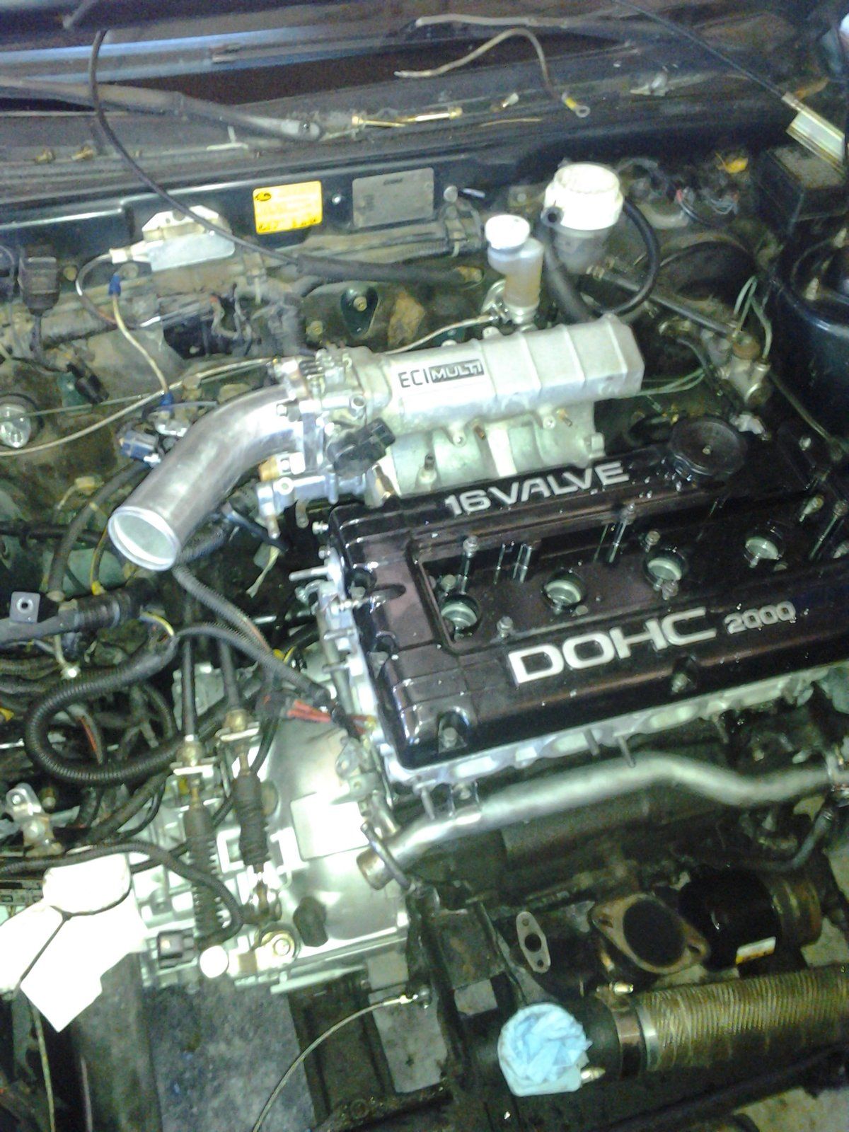

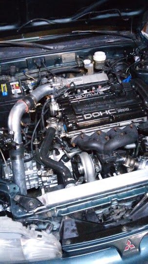

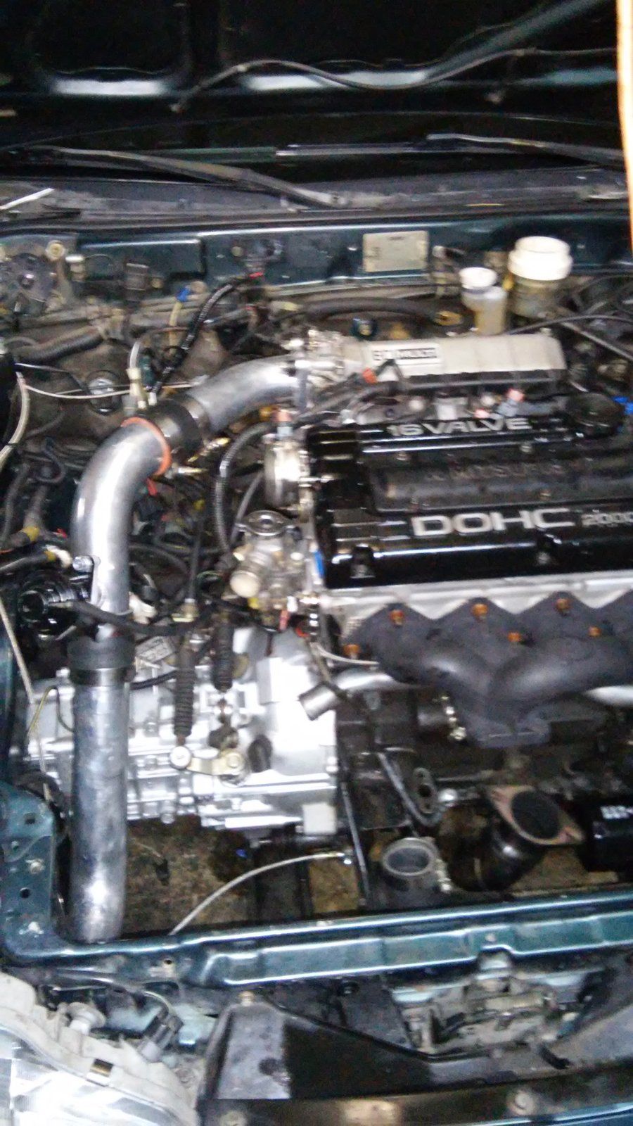

Did some work today finished taking out all the emission stuff installed the intake
manifold, throttle cable and throttle body

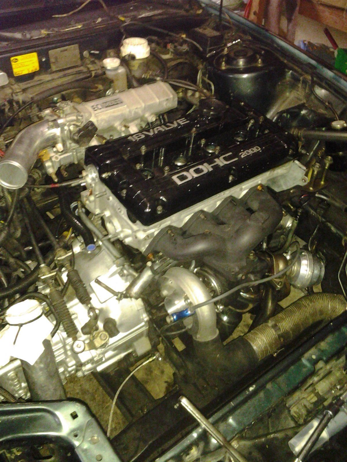

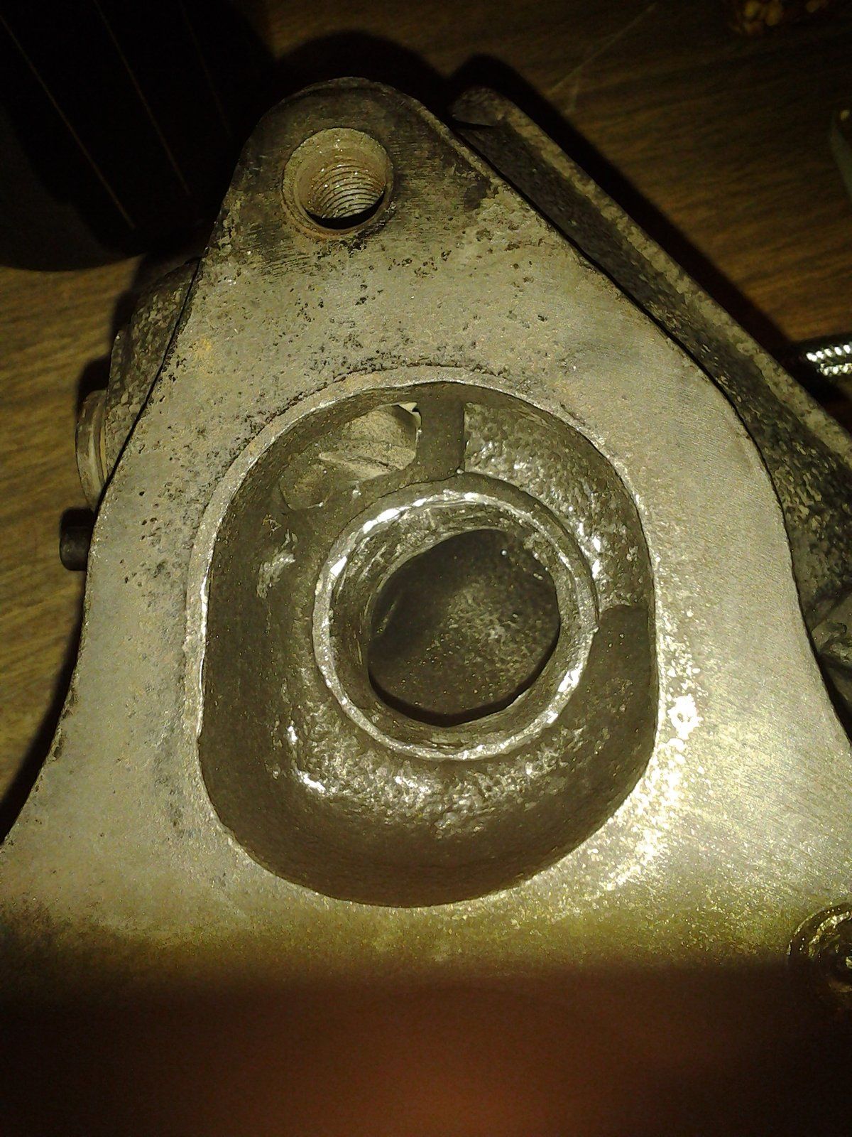

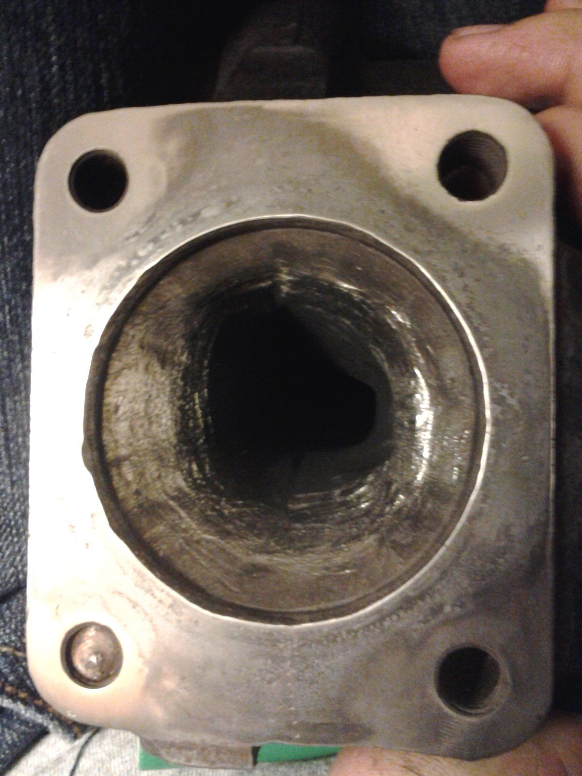

Also did some porting on the turbine housing and got rid of the flapper.

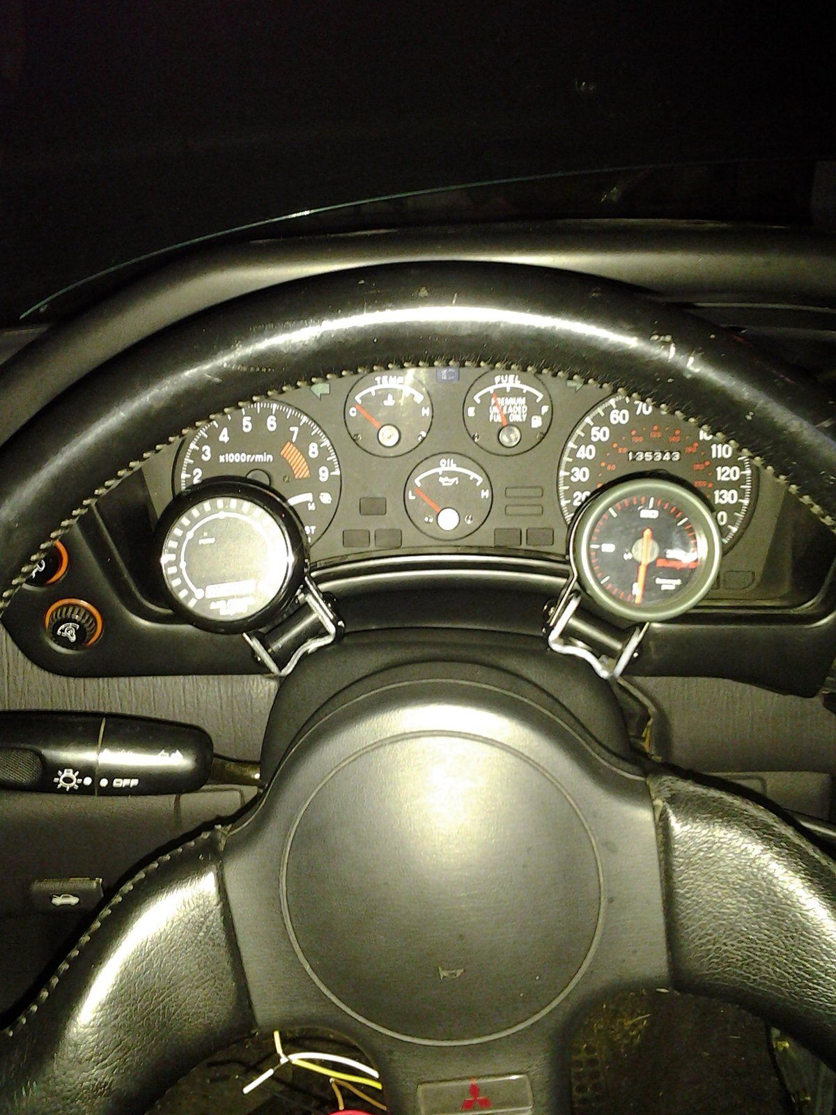

Installed a couple gauges not 100% sure if I like them there
Also got the rest of the Coolant hoses cut to size.. getting antsy!

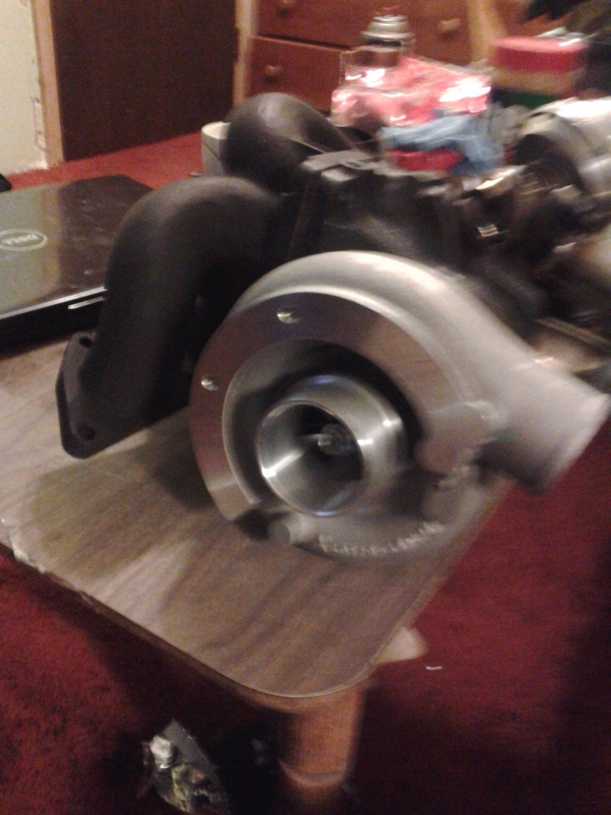

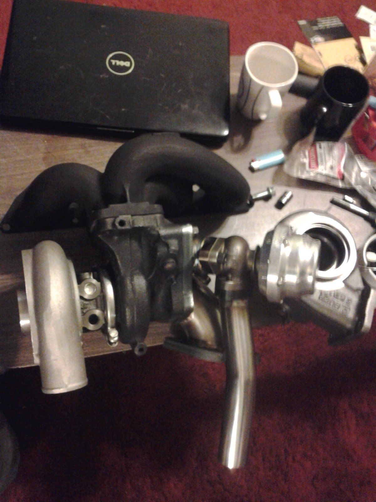

Well I have a small but significant update I've decided to go with a bigger turbo, I picked up a brand new Mitsubishi 20g from Forced performance, just had to have my vague goals be a little bit bigger.

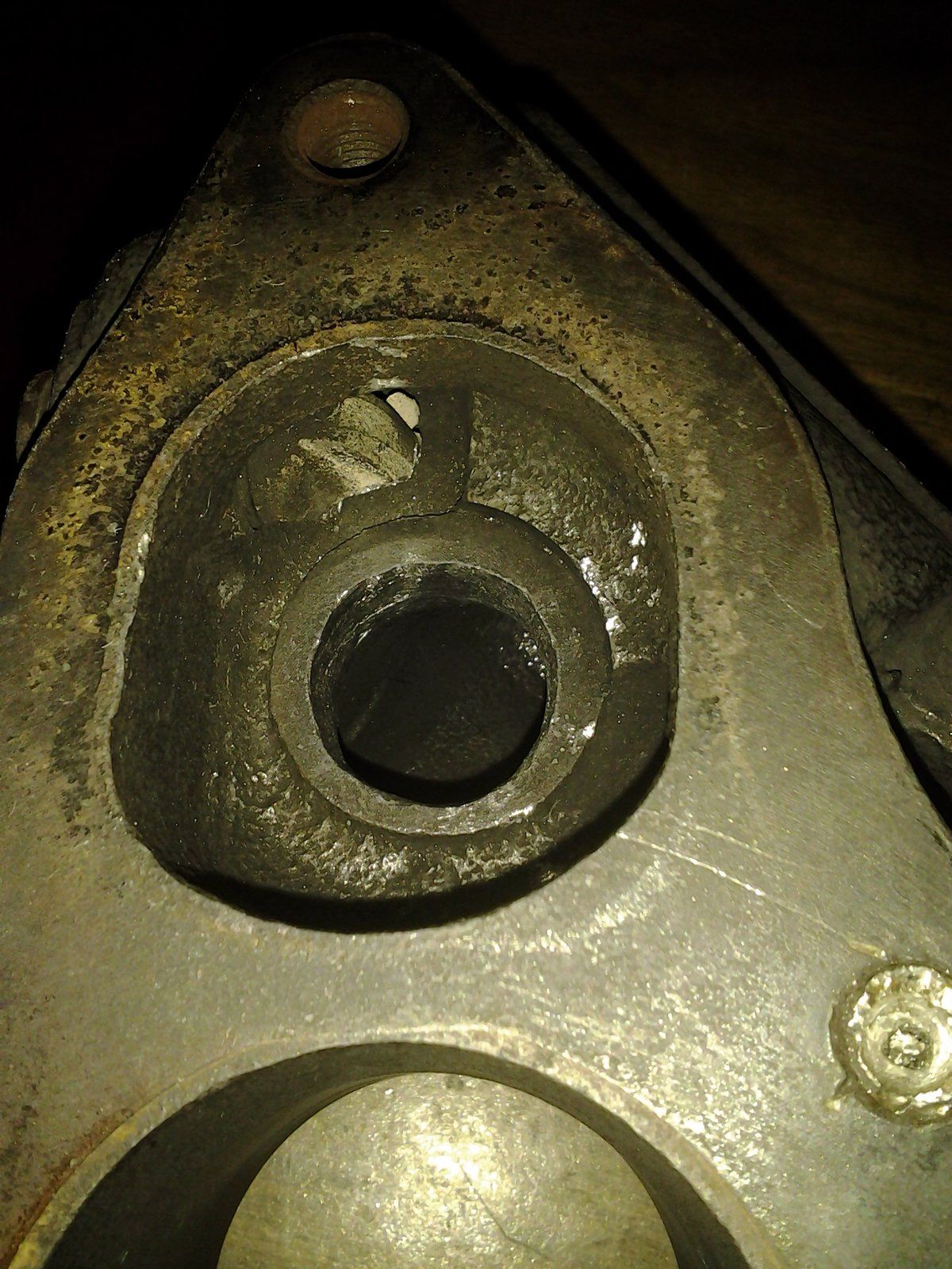

Looking good. I had a bolt bust off in my exhaust housing as well. The machine shop told me that it would be like $90 to get it out because of the carbide bits. I went with an ebay that I picked up for $30. Ported the waste gate port and it works fine. I had a little boost creep with the old housing but not with this one(the port is a lot larger now).

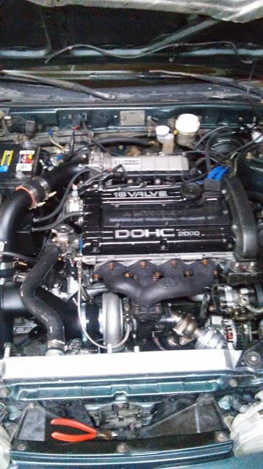

Well its been a while since my last update but ive still been working on it.

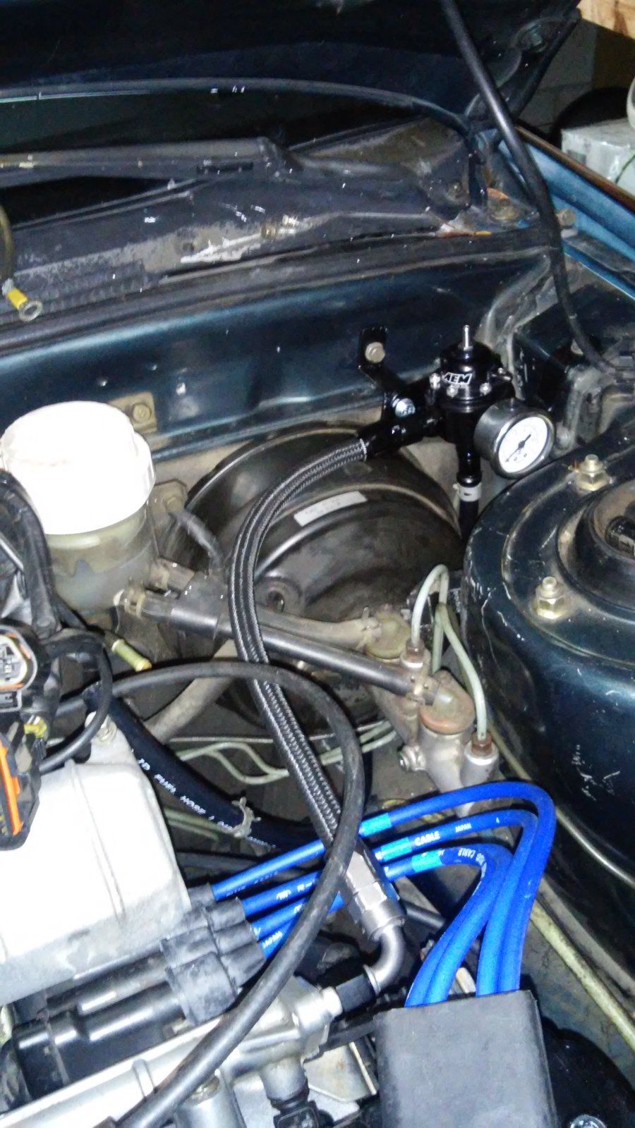

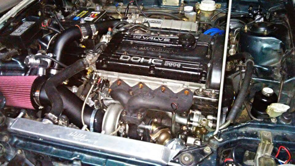

Got the AEM fpr installed
Did some cleaning in the engine bay and sprayed a little bit. and got the cams, and speed density sensors and wiring installed.
almost done just waiting on my turbine housing to get out of the machine shop. then ill time it and it will be ready to start. :)

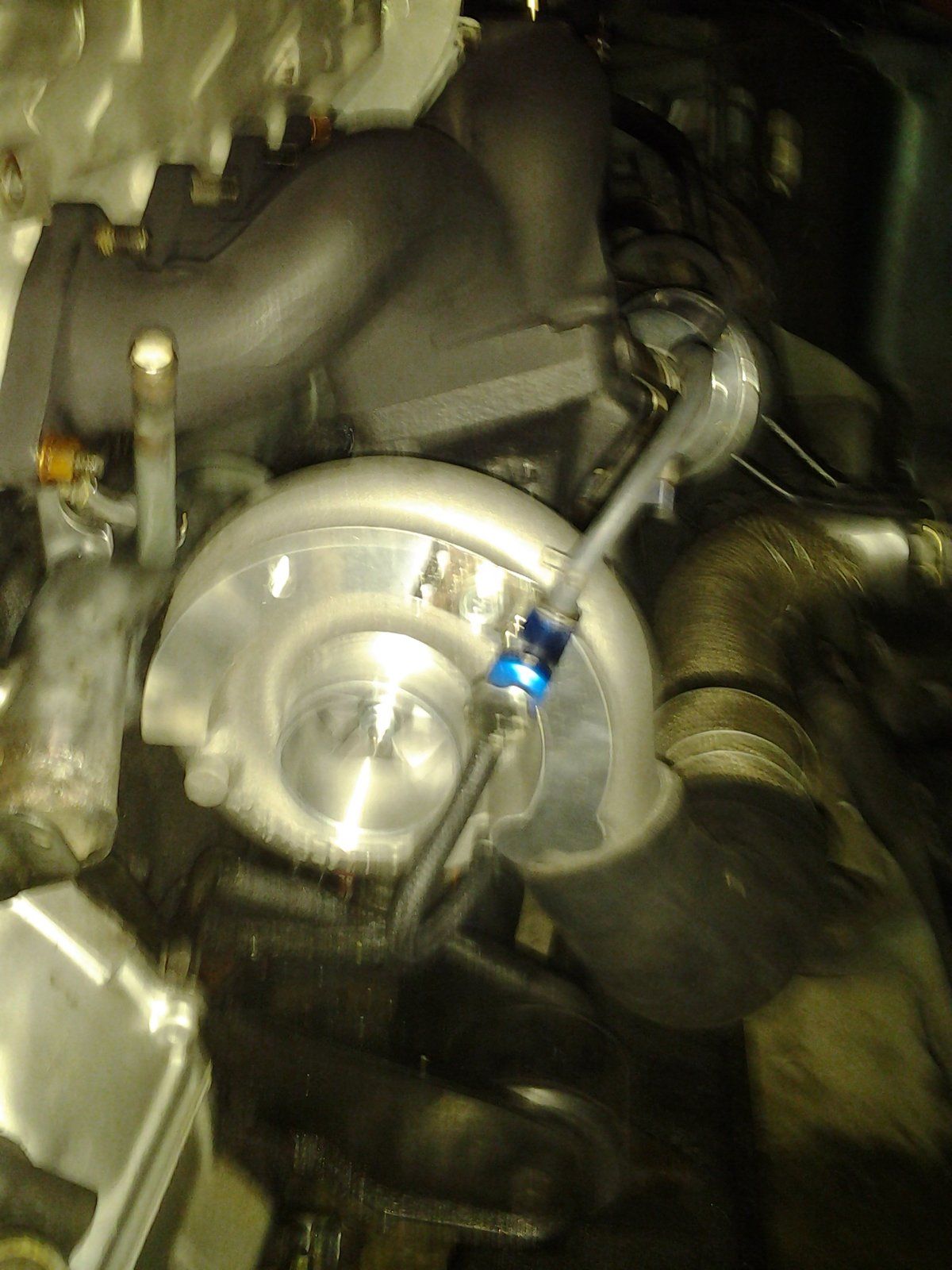

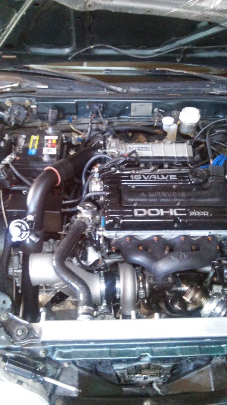

Got the turbine housing out of the shop yesterday, installed turbo, got it timed, just having an issue with setting up the oil feed gonna have to run a bit longer of a line than i have now. almost ready to crank it over.
ill have some pictures soon.

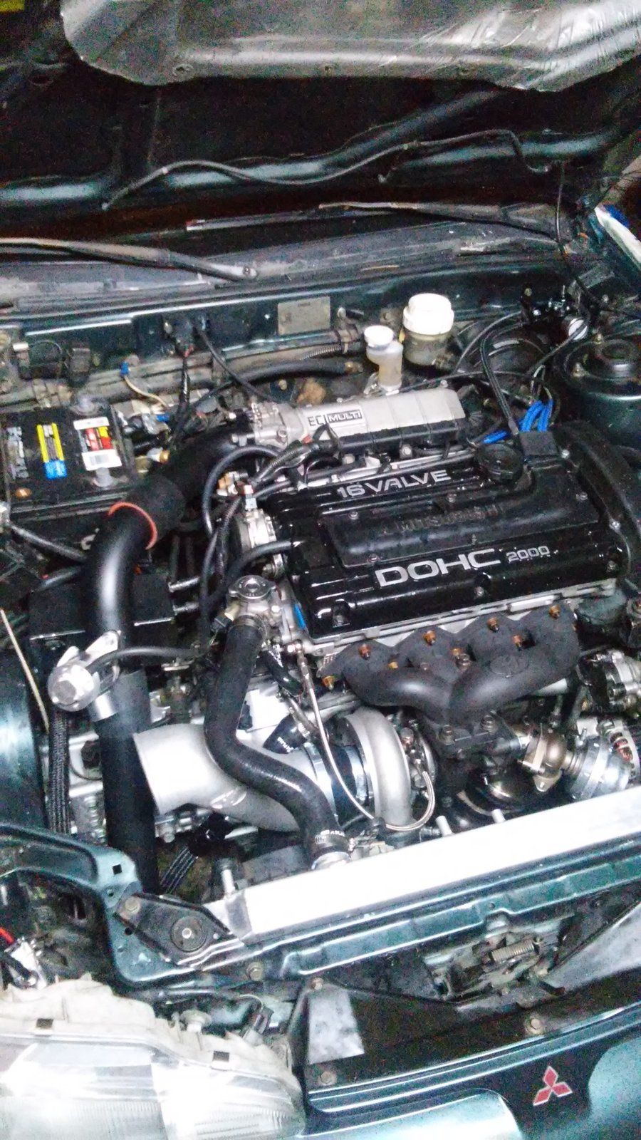

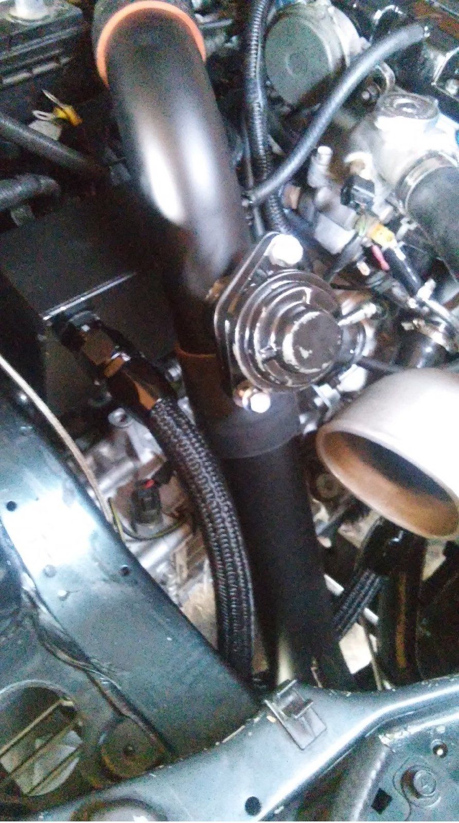

Painted my intercooler pipes and finished my catch can set up, im pretty satisfied with it, im going to switch the fittings on the side to the valve cover to an fittings when I get a new vc. also picked up some tires. next update should be first start and working on getting it tuned.
