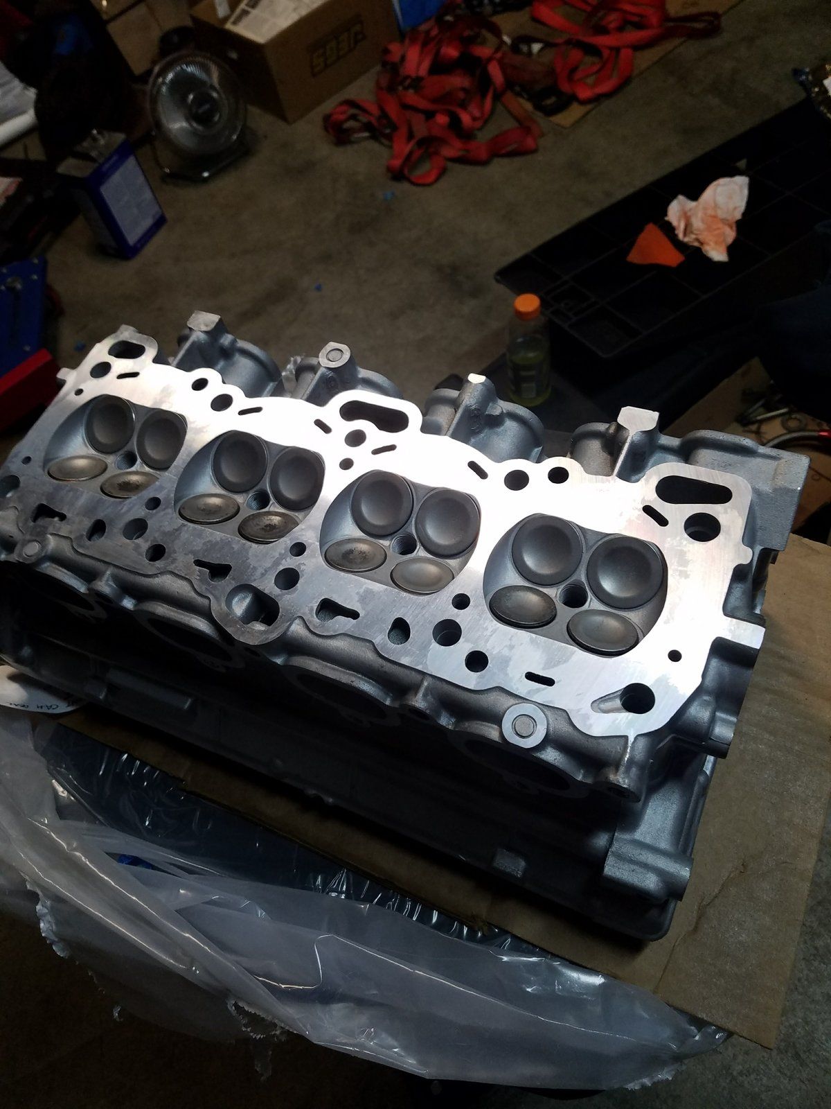

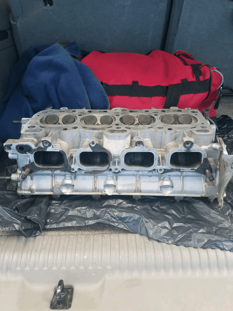

I loaded up the head and took it to a local machine shop, who wouldn't resurface it due to not enough material. CRAP! So i purchased a Ported/Polished head from a member through the forums classifieds. As it being my first timing belt car, i was in over my head, and with school and work i decided to take it to a shop. I needed a vehicle so i just put the old head back on until i could get an MLS gasket. All was well. For now.....

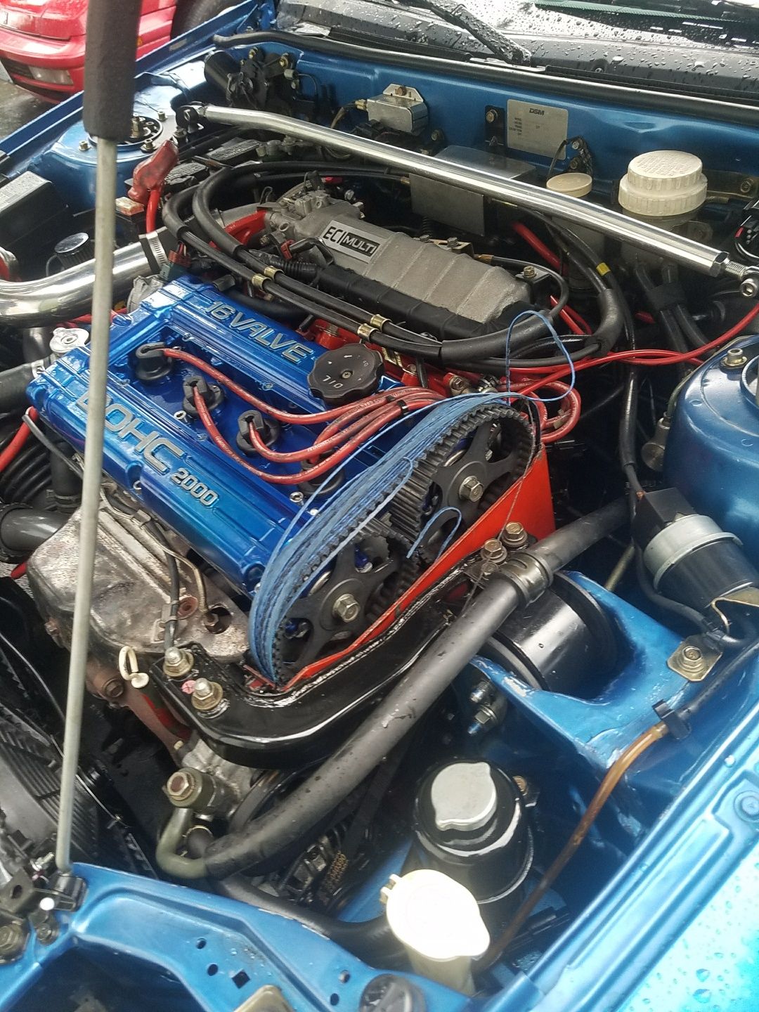

After getting the car back, i enjoyed it for 3 or so weeks, driving it every moment i could. I fell in love with the car, I had DSM fever. It was good while it lasted, until i was struck down by my one true fear...... Balance shafts. The car had been acting funny, but nothing major, no big deal. Until one day after class i got back into it, and it wouldnt start. CRAP! I opened the hood, and this is what i found.

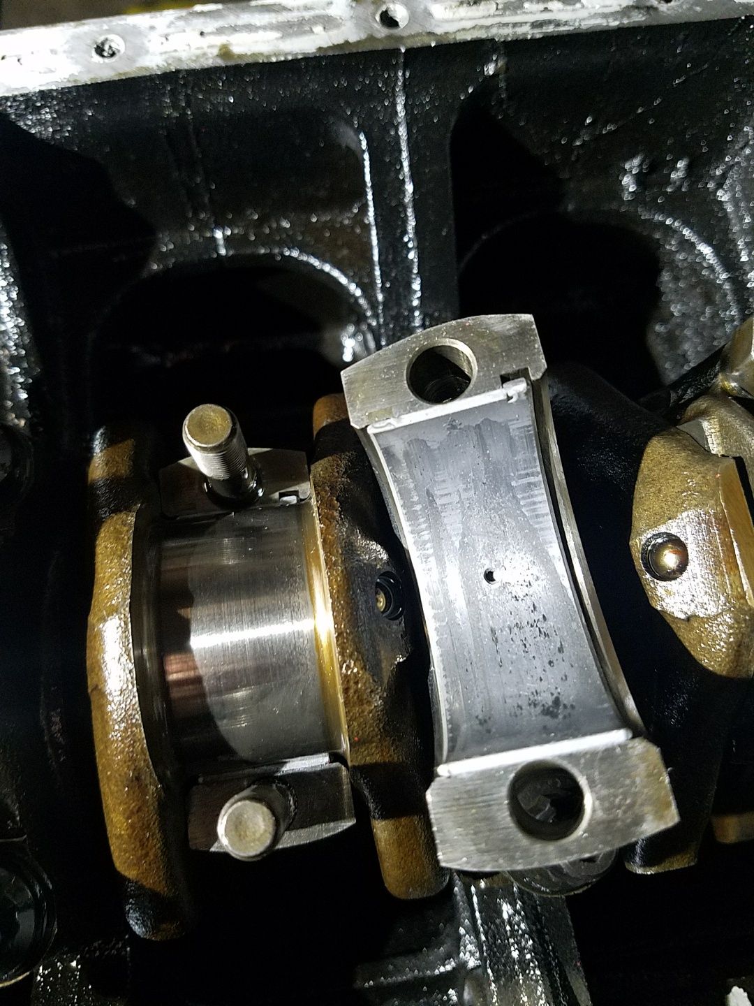

My timing belt was ripped to shreds, but still didn't skip any teeth (Thanks Gates). I was livid, thought the shop had screwed up. Took it there for them to inspect, and low and behold. the rear balance shaft bearing had siezed. you could tell by the black spot on the block where the heat had cooked the paint away. Brought the car home, and instantly tore into it, got the motor and tranny out in two days. I didn't know what i was going to find inside the motor. This is what i found.
Main bearings were completely Toasted, my worst fear. Time for a complete rebuild....

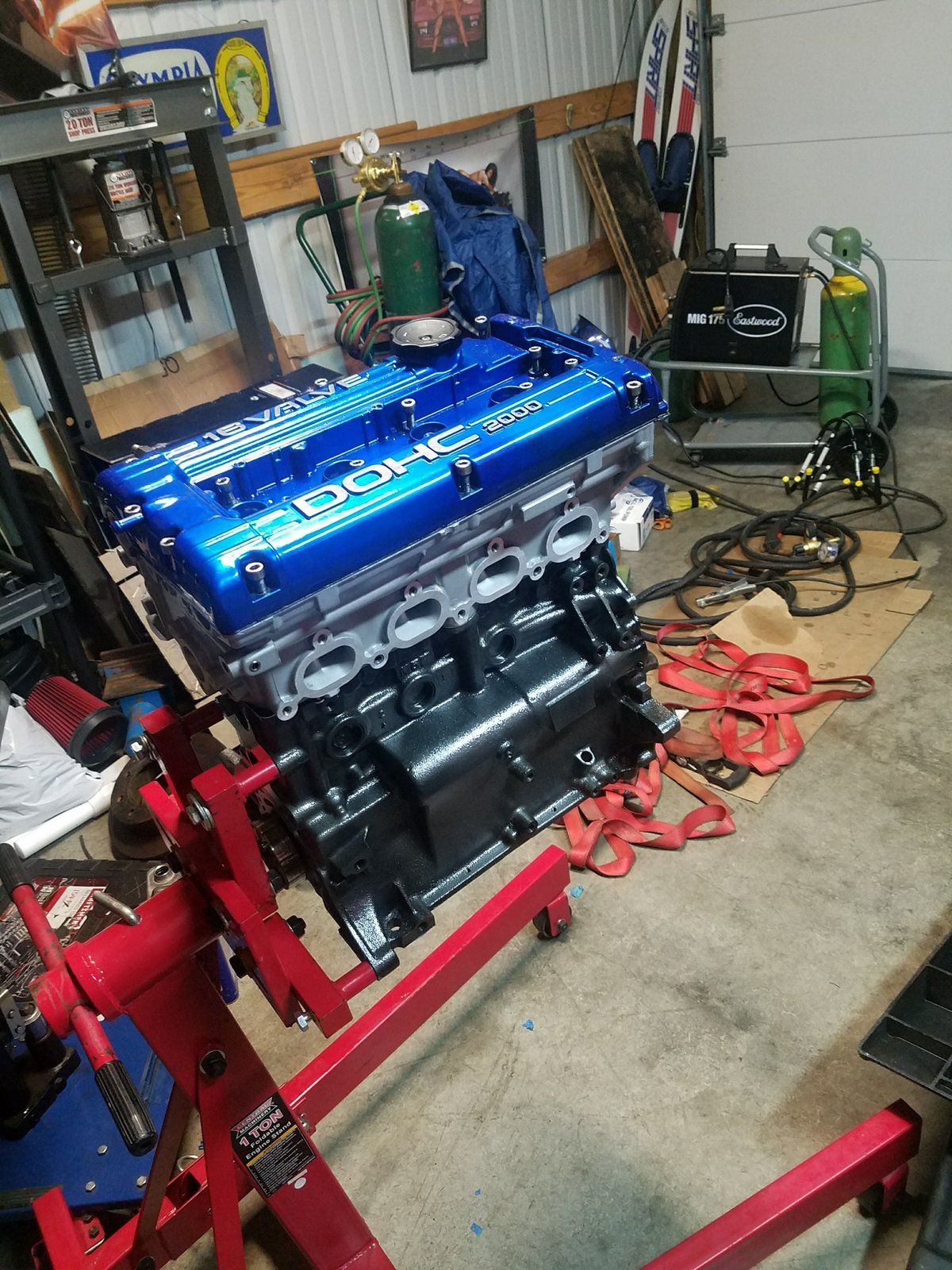

After a few weeks of calls, and trying to find a reputable shop. I settled on Action Machine in Shoreline WA.(I would highly recommend them) dropped the motor off, with the new set of kiggly beehives, and had them get me a quote. I settled on a mild build, Since the crank was almost perfect, i opted not to do the stroker kit. Engine got bored over, 5 angle valve job, Mahle pistons, K1 rods, Balance shaft delete, inspected and cleaned everything.

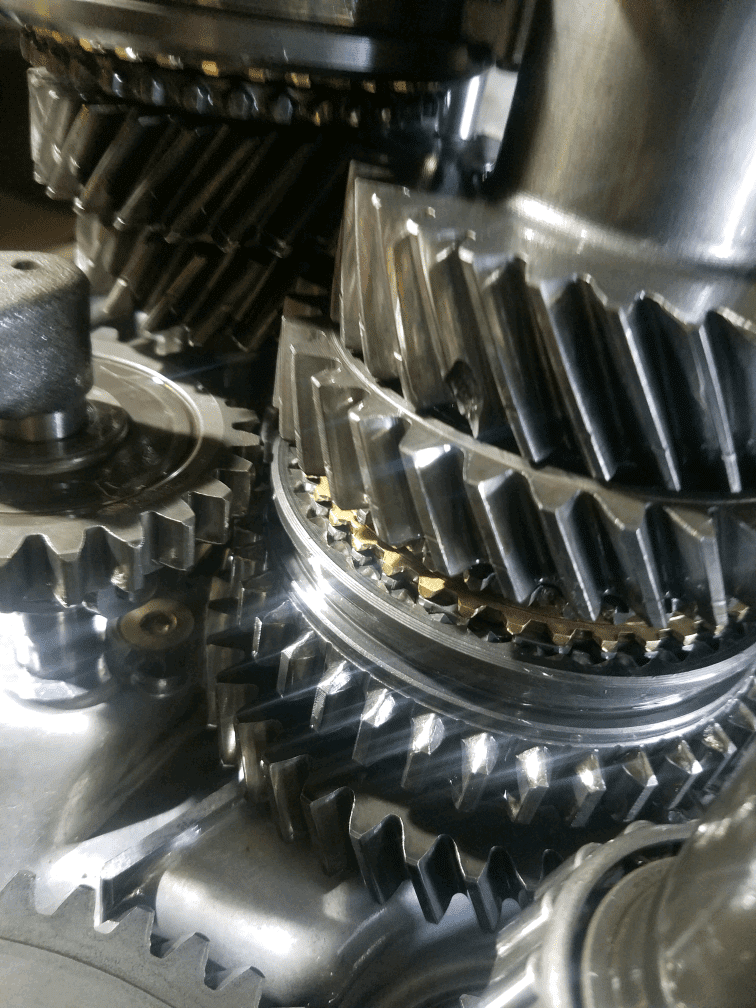

Now i was good to go right? Wrong... The transmission would occasionally grind in 1st gear, so i figured id throw some new syncros in it, not a big deal? right? WRONG Again... after busting into it i realized i was over my head, didn't have the time nor the expertise to do it correctly. I was greeted by this wonderful site inside aswell.
So yet again I needed to enlist the help of some experts, did some research and decided i would send out my clusters to Jacks Transmission. They were incredibly helpful and did an absolutely amazing job on the gear cluster build. And this is where the story catches up to present day, right now im at a point where i need to buy quite a few parts to finish the job. so far i have these on my list to finish my build.
