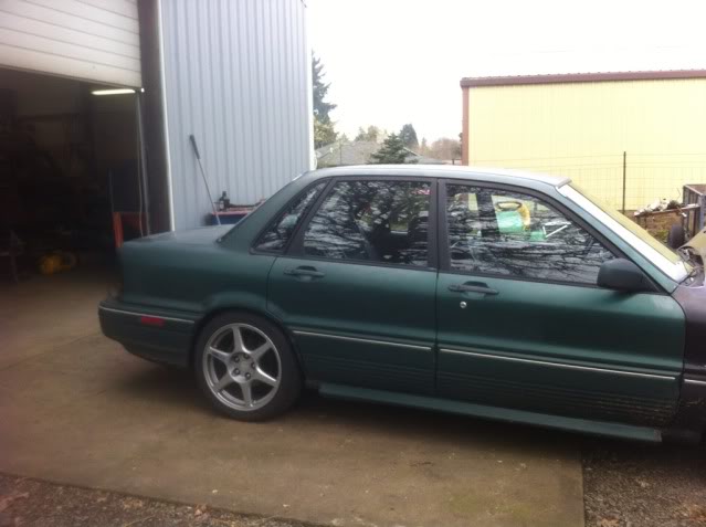

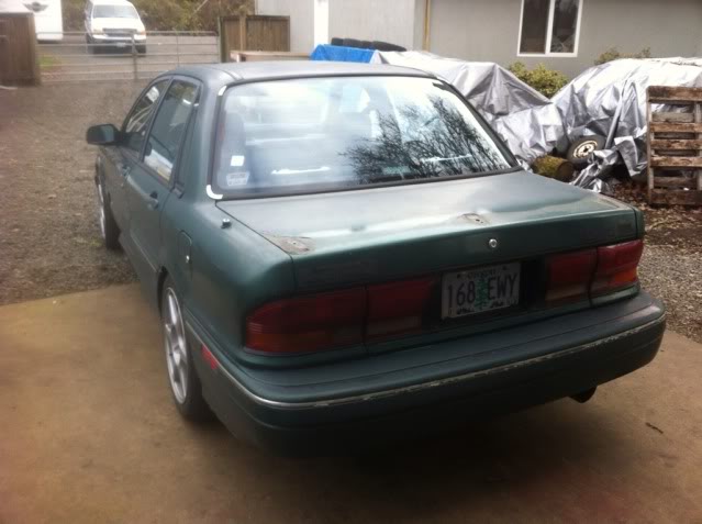

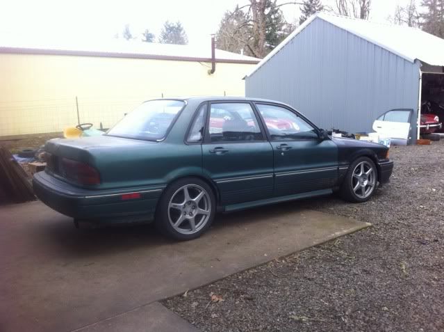

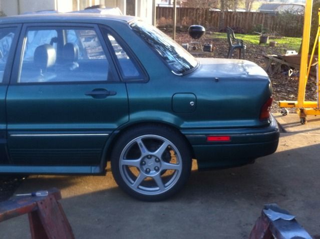

Removed the rear wing today.
I really like the wingless look. Looks as if you have a few projects going on, what is that red car peeking out of the garage in the distance?
Thanks and ya I like the clean look of no wing. I do have plans of running a small lip wing like what you would see on a e46 M3 just something simple and light.
The red car is a 2003 MINI cooper S we campained from 2004-2006. It was in SCCA T3 class. It was competitive enough to earn a spot at the Natinal runoffs in 2006. I own a vintage restoration/ race fabrication shop so we get a decent amount of projects haha.

Very cool business you have there. I was speaking of the vehicle in the last set of images. I am thinking it is an MG but I could be wrong. :)
I just re read what you posted haha. So the car peeking out of the garage is a 63 triumph spitfire. Needs practically everything to run and drive again.
Ahh I figured it was MG or Triumph. Thanks. :thumb:

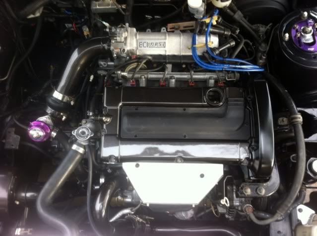

Great build man! Definitely go with a small lip on the rear like you speak of. Should really just set it off! Cant wait to see a fresh paint job on it! What kind of coilovers are those?
I know that the 1g coilovers r different but u have any plans to modify the camber plates bc right now u can only play with caster???

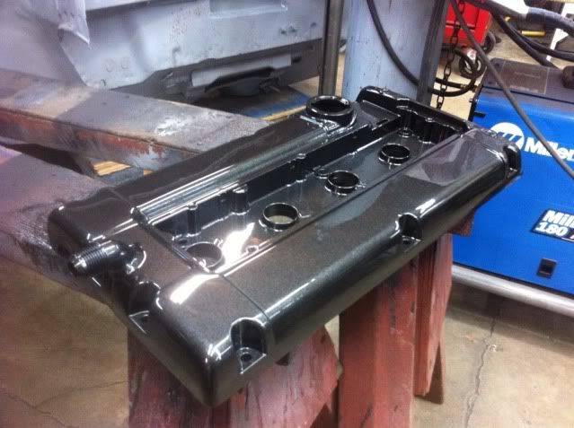

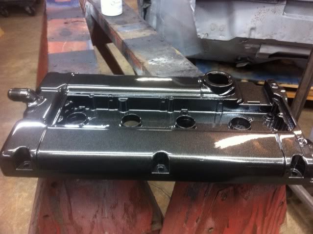

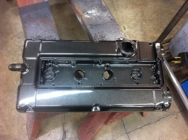

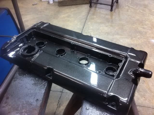

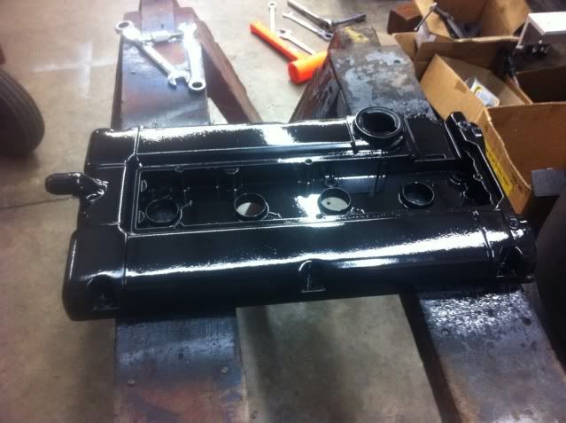

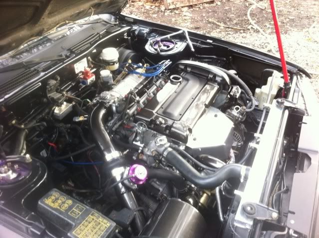

And that valve cover looks awesome keep the good work man
I do have plans to make custom plates to give more camber and keep my caster at around 4-4.5 deg. But for now I'm at -1.9 deg camber and at the caster settings I'm looking for. So I can focus on the rear suspention first to get better turn in. I still want to do the rear tow elimination, rear sway bar and braided brake lines. I also have plans to be making brackets for the Brembo brakes on the front.

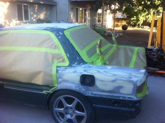

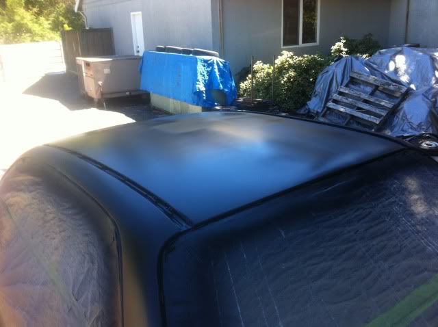

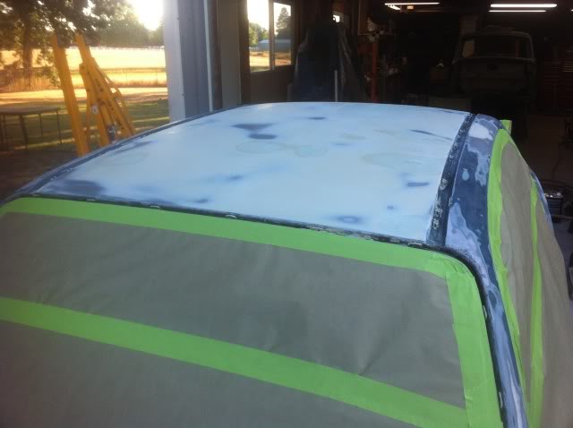

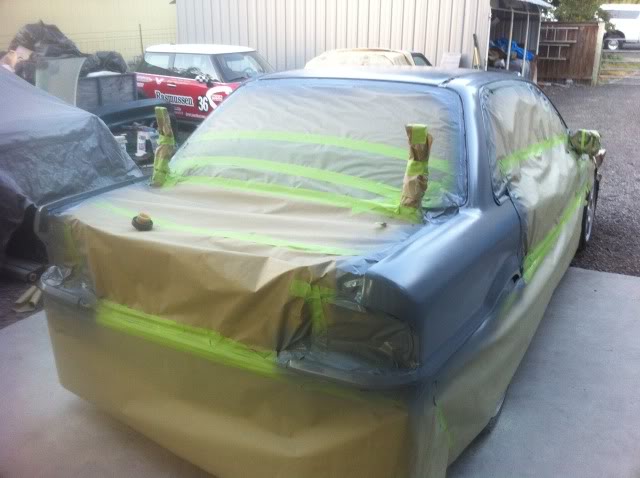

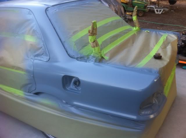

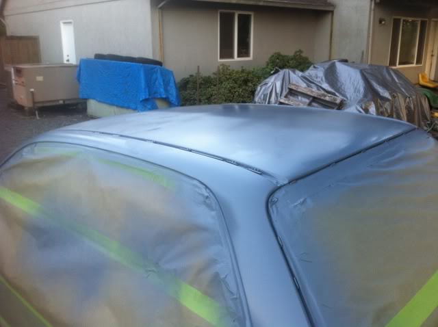

It's paint and body time!!!!

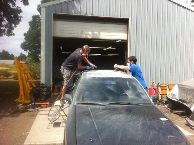

I had a sanding party last weekend and a couple friends stopped by to help sand.

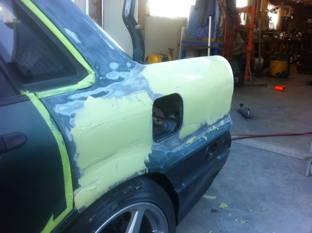

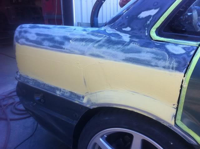

Bondo time!!!
