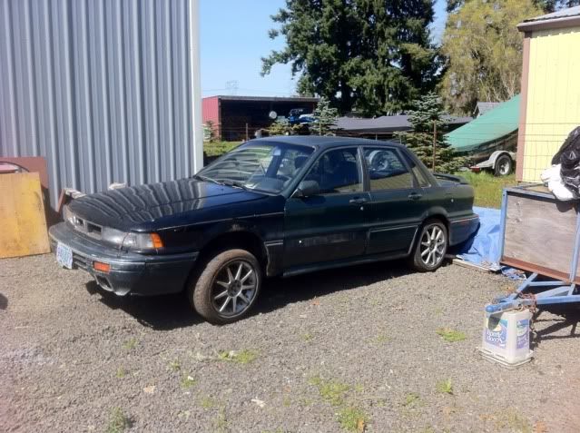

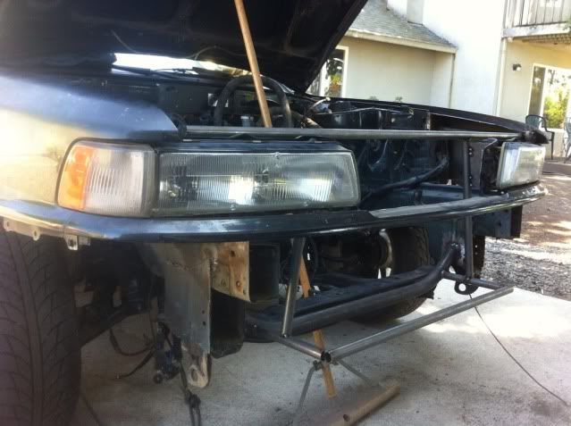

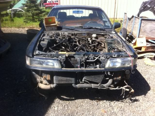

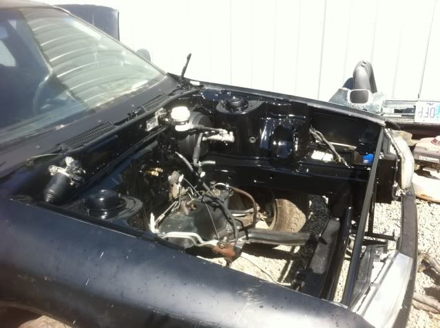

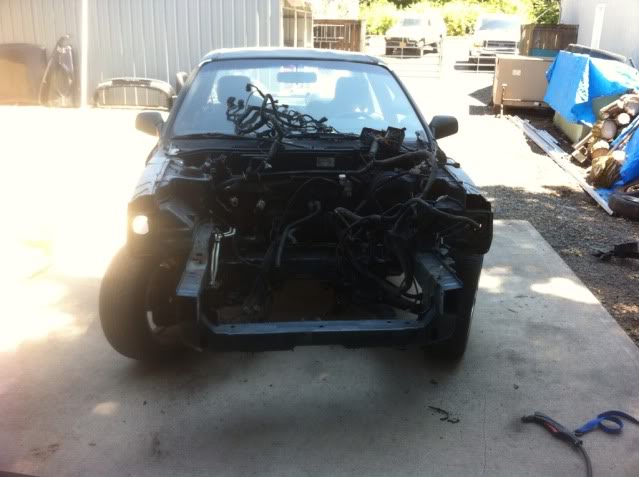

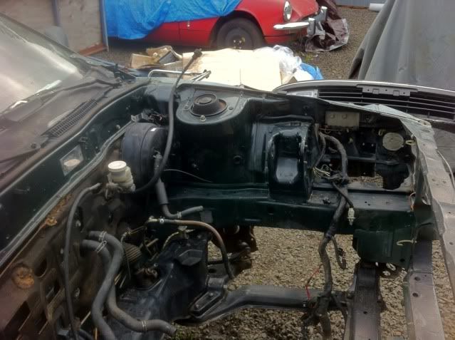

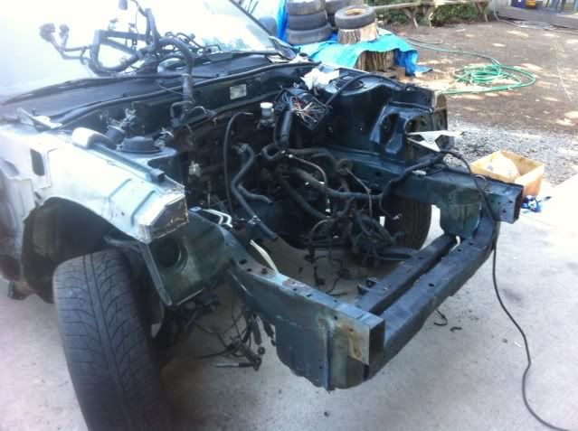

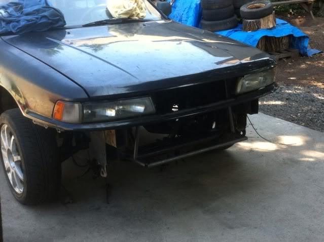

just picked up a car that has been a favorite of mine for years now.

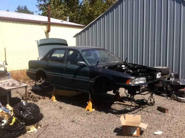

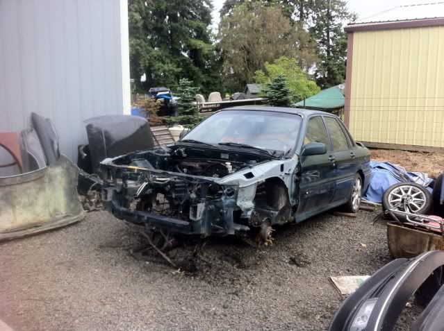

its a 1991 galant VR4 1865/2000 it is missing the engine and trans. but im going to swap everything from my Talon to keep this guy on the road/track.
this will be a budget build for daily/track day use. goal hp 400-450 depending.

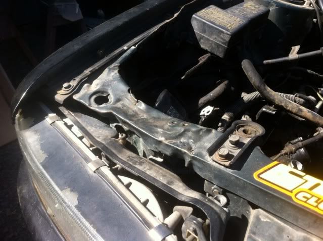

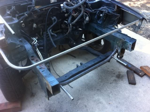

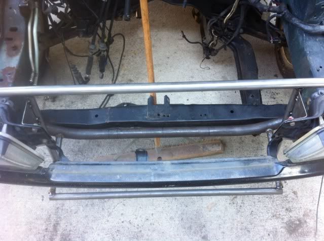

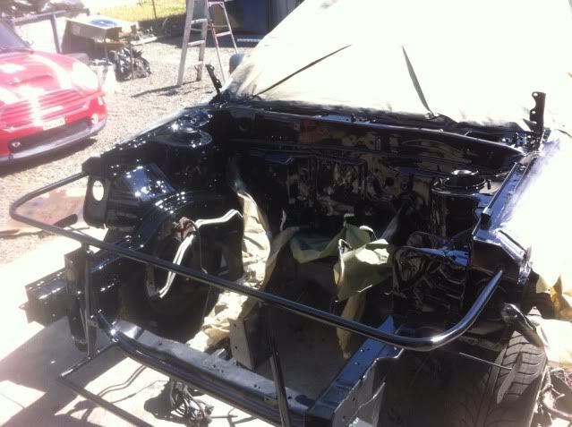

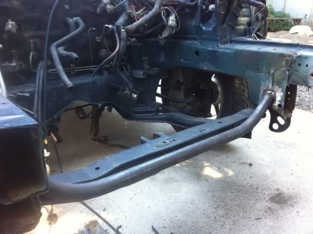

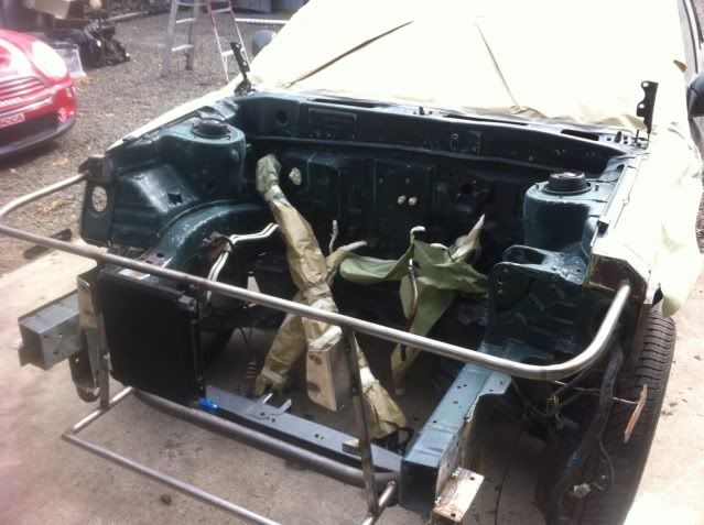

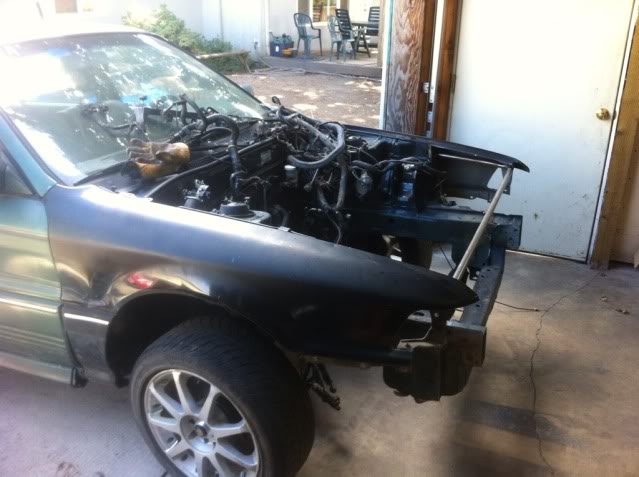

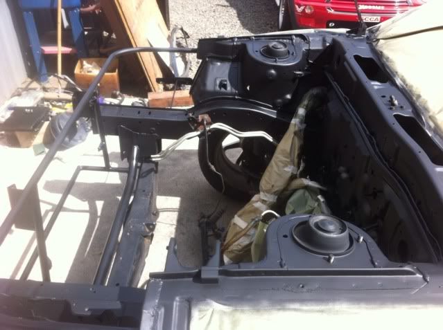

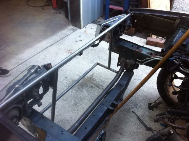

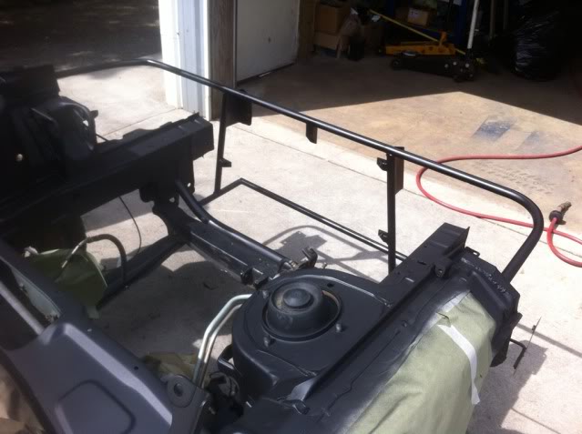

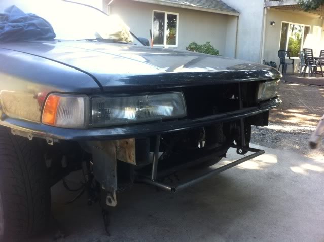

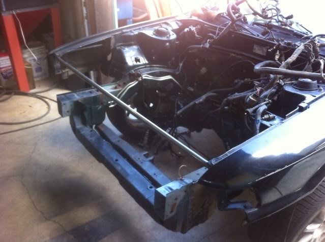

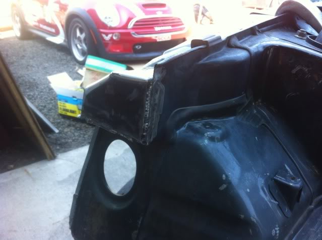

the front has minor damage so i decided it would be a good time to do a partial tube front end. then i would be able to relocate the radiator forward about 2-3 inches to accommodate a bigger HX35 turbo.

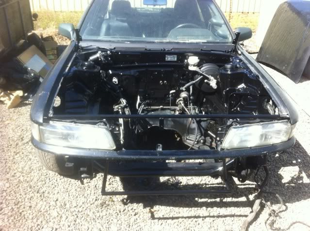

Shes not much to look at right now but i have plans for body work and black Paint.
Just to note I'm very amazed as to how heavy the jdm front bumper really is. I don't have the exact weight but compaired to doing the levin conversion on my old AE86 it's a night and day difference.

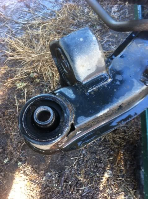

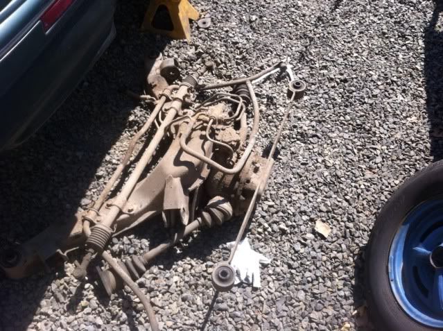

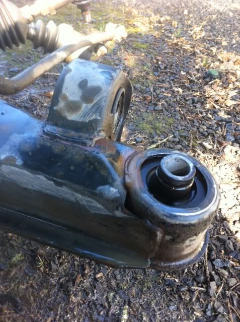

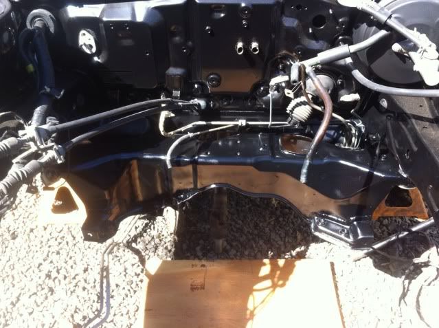

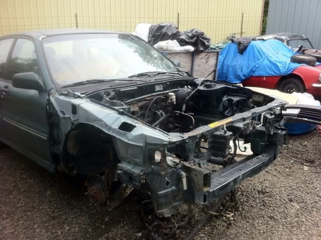

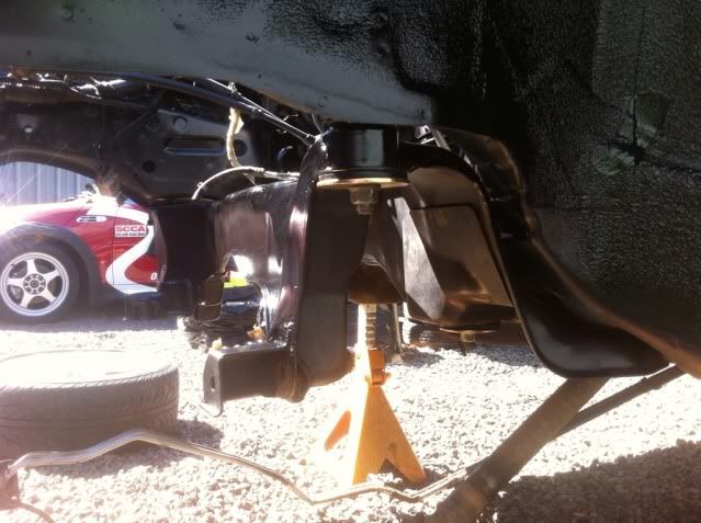

You sure it's just the rear subframe that's bent? just seems like if a beefy part like the rear end mounts are bent then the unitbody could be bent too. I would measure from front to rear mounts to make sure each are same distance from front.
amzing work mate, keep us posted.
I'm glad you mentioned that. I found the factory body measuments online and everything is within spec. It looks like the suspention arm took the hit and bent the mounting point.

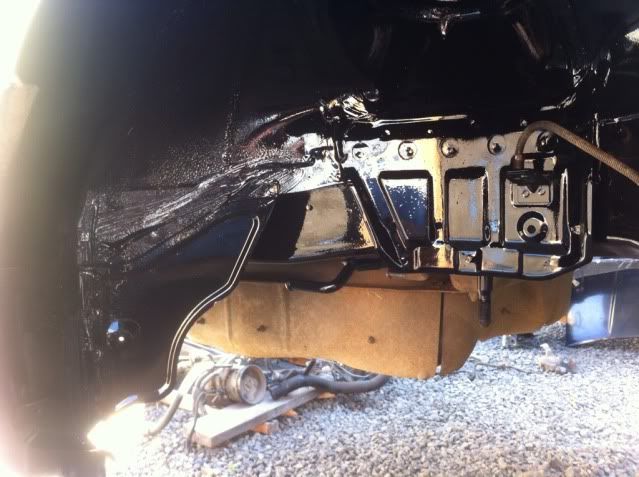

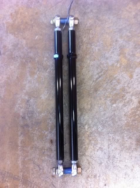

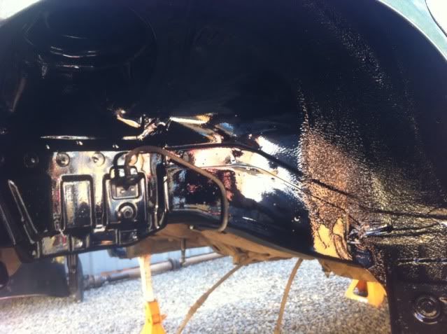

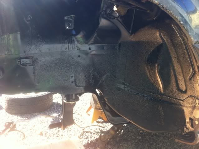

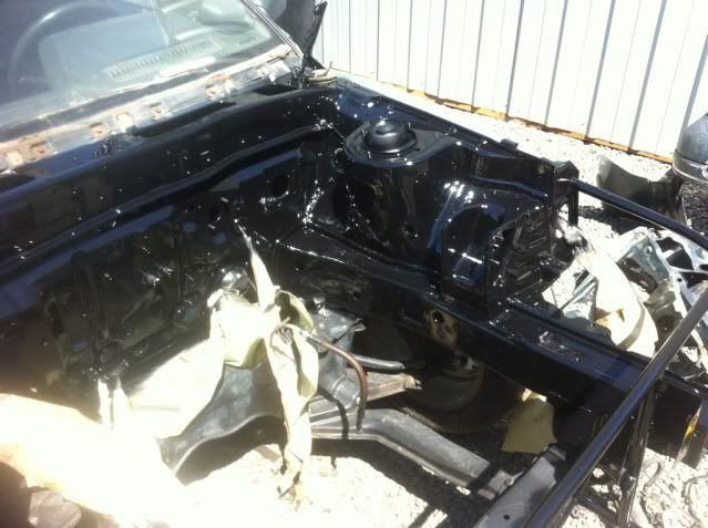

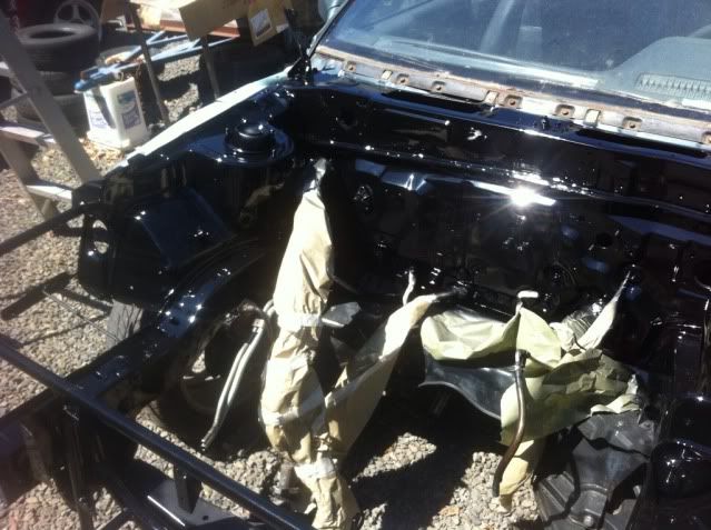

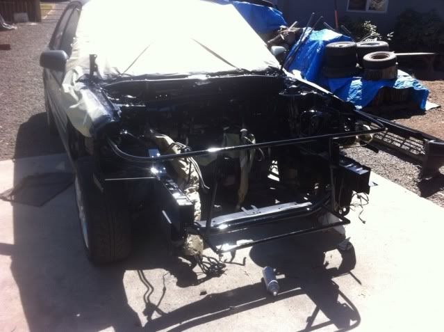

Well a small update. I cleaned and painted the rear inner fenders semi gloss black. Also finished fabricating adjustable upper rear controll arms out of DOM. I drilled out two nuts and welded them to the arms. Took about 2 hrs to thread 4 ends due to how hard the Dom is haha. At least I shouldn't have any bent arms to worry about:)
