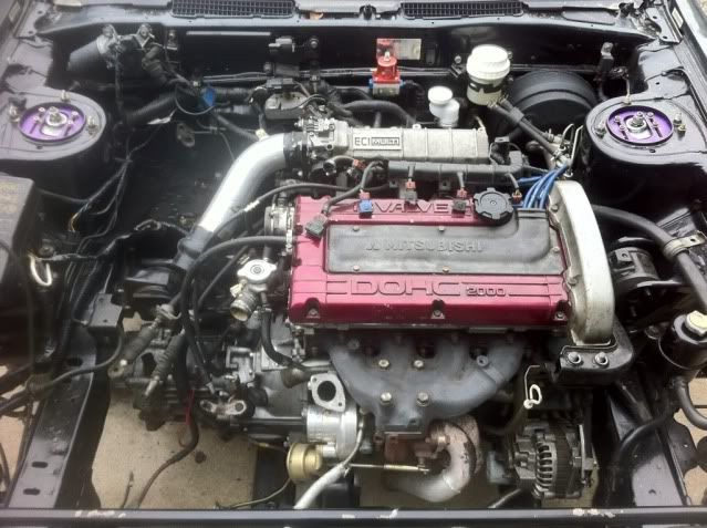

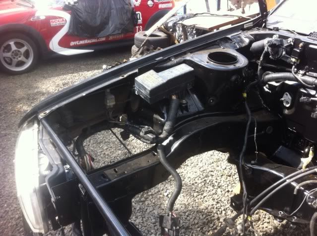

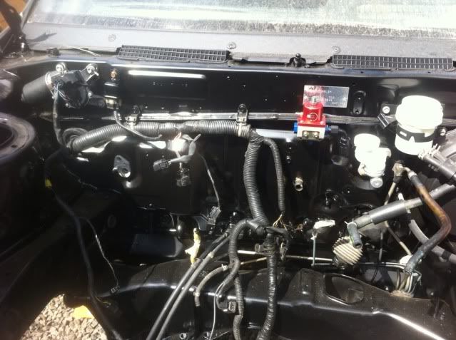

I will defenitly have more pics up soon. Currently in the process of cleaning and detailing the body harness as well as the engine harness. Will need to extend some wires as well as repaire others that are broken and brittle.

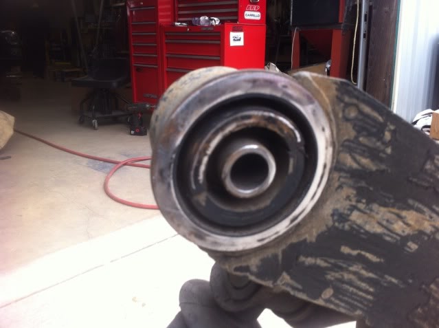

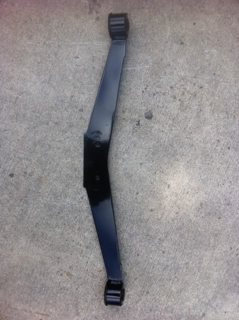

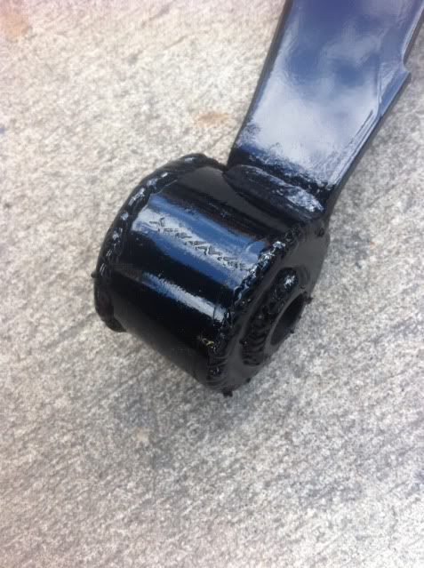

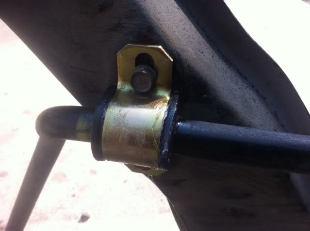

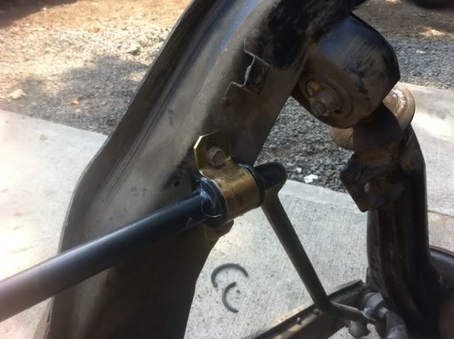

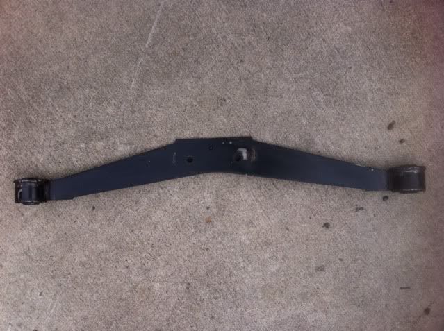

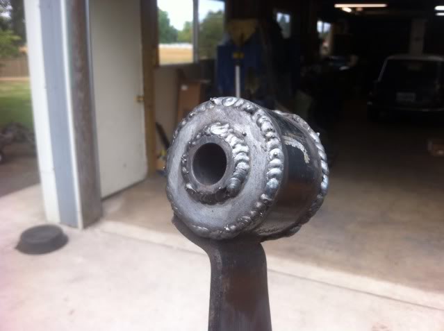

I want to solid mount the rear subframe without using bushings. So I found some washers from lowes that fit the stock steel sleeve. I'm not worried about the washers breaking free or any future damage. I've performed this before on my SCCA ITE class 2004 MINI cooper s with no issues in 5 race seasons.

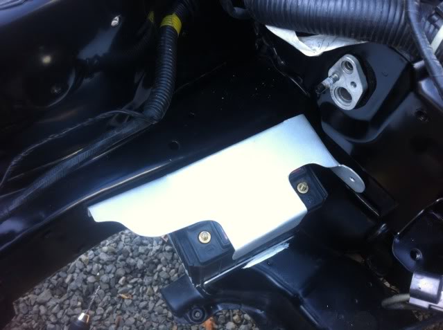

And after paint.

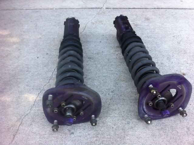

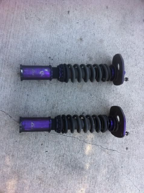

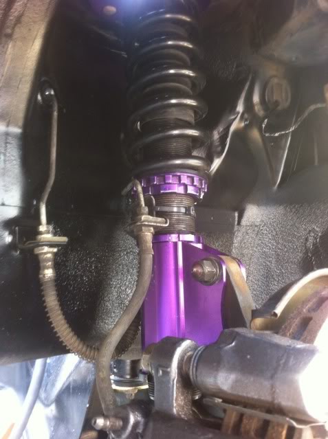

Well I got ahead of myself today and forgot to take pics of the cleaned up coilovers. Tomorow I will take some installed on the car.

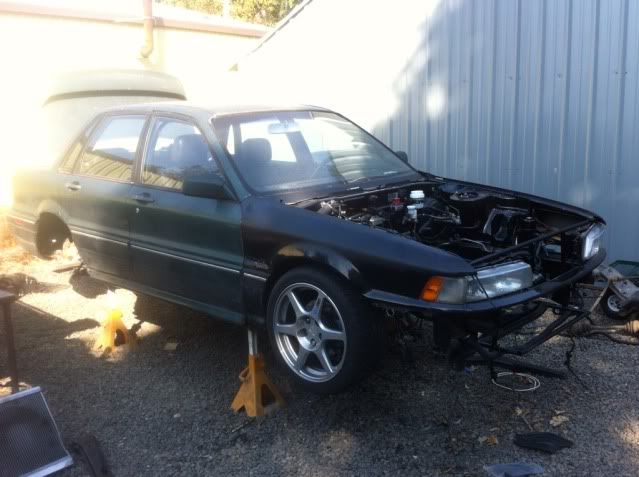

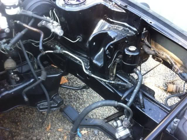

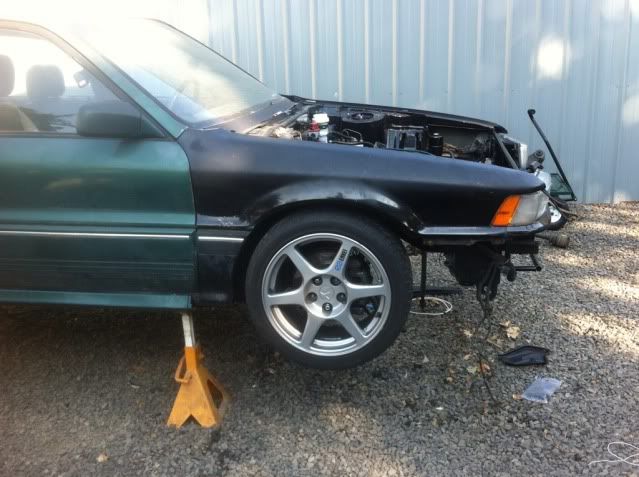

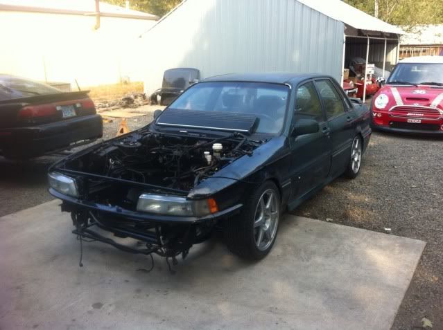

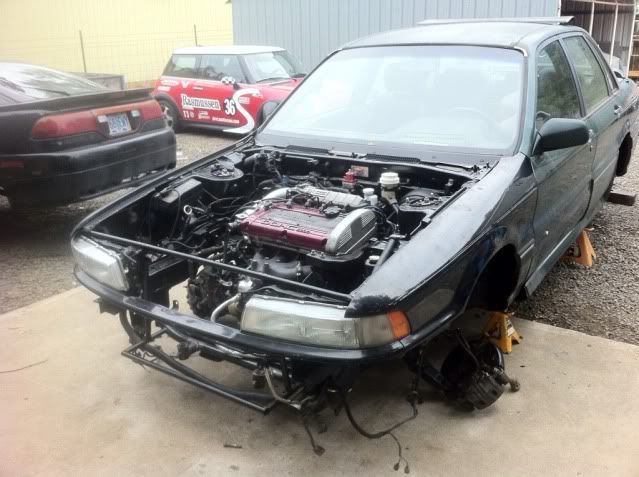

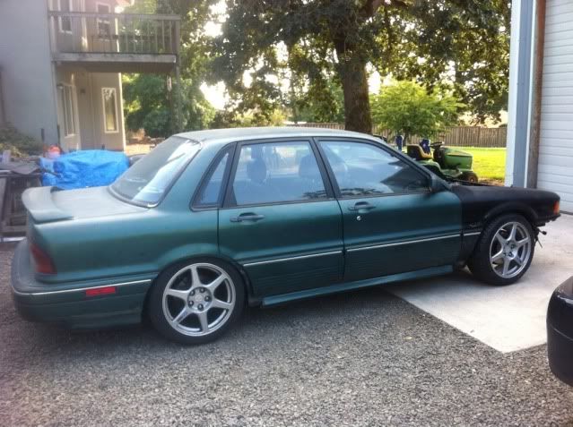

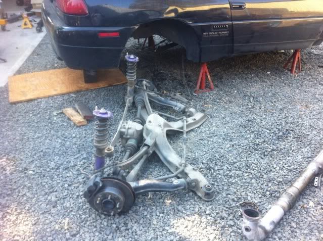

Today I swapped the ABS delete,front 5 lug hubs,front coilovers,talon PS rack, poly swaybar bushings and talon PS res with lines.
Here's a pic of the front. I haven't cleaned the calipers Or rotors because I will be swapping them out for brembo rotors and race calipers.

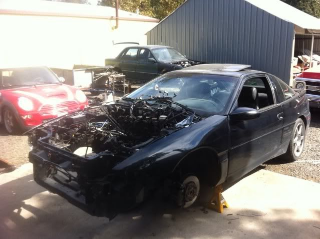

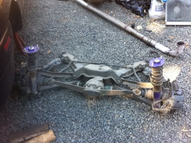

I also removed the rear subframe from the talon. Ready for cleaning tomorrow.

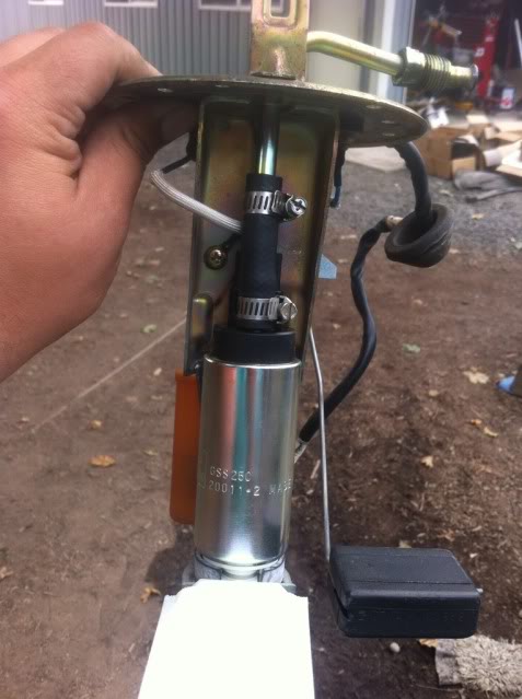

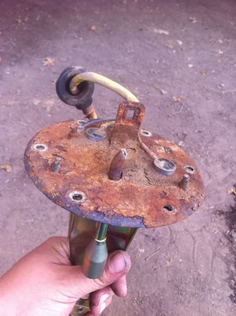

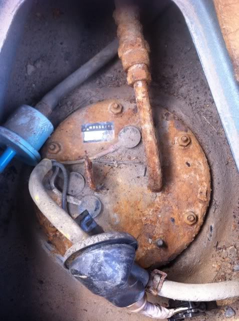

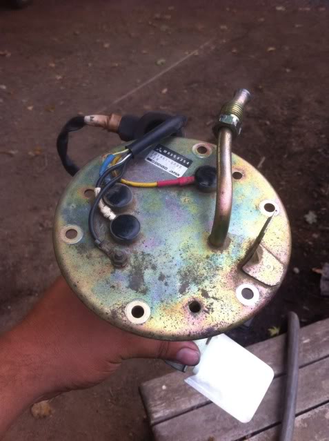

Ready to install the Walbro 255 and found this shit!
The hanger is to rusted to use so I broke the fitting to hopfully save the hose. I then bead blasted the fitting and soaked it in PB blaster.
Looks like the hose will be ok.

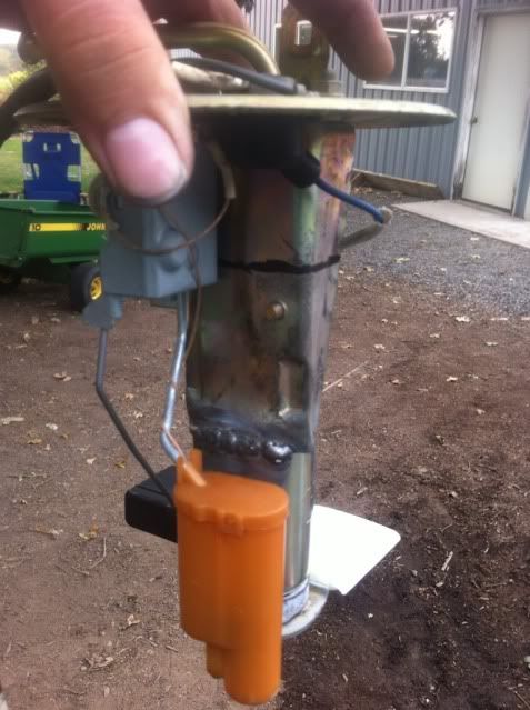

Since the FP is toast I figured I would modify a 1g dsm hanger.
