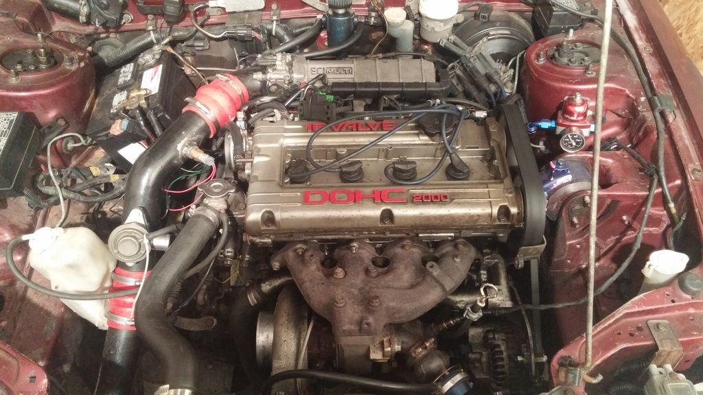

At this point in time, I blocked the egr off with a proper blockoff plate, and the car finally idling by itself, but ran very rich. I let it alone for about a week as I was relentlessly researching scaling and latencies and tuning guides for the blackbox. I came to the conclusion the car needed to be maf tuned first in order to get the injector settings right and the ve table built. I wired the maf, flashed the basic ceddy mods to the ecu and tried starting it. Cranked but didn't fire. Plugged in my gm iat and unplugged the maf, flashed back my previous tune, same thing. I couldn't understand why the car ran fine the day before on the same tune but wouldnt start today after wiring in the maf.
Fearing again that I wired something wrong, I called my buddy to come to my garage the other night so I have a second set of eyes to point out anything I missed. I switched to my friends dsmlink ecu and scaled the injectors and switched back to the maf, seeing if it would start on it being its the last thing I wired before the car wouldn't run. Sure enough it fired right up with dsmlink. It ran like crap and threw a code for injector 2 malfunction. We found out number 2 and 4 injector clips were broken inside where the pin ends. It bent one pin on both injectors. I had 2 injector clips laying around and soldered them in, fired the car up and ran perfect, just a little rich. 15 minutes of messing with Dsmlink I had the car idling perfect.

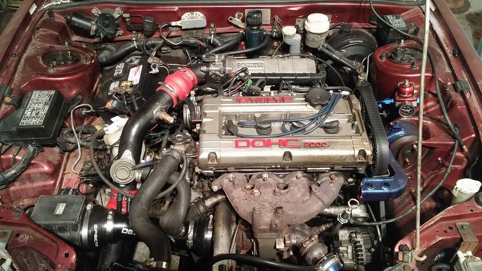

Last night I went up to work on it, switched back to the blackbox ecu and flashed back the maf tune, and also lowered the dead time on the injectors a bit. Fired up first try. It ran for a bit, it was a little rich so I lowered the dead times again. This time it was damn near perfect. I couldn't take any logs because of evoscan acting up, so being i had nothing to go off of to further tune it I installed my catch can and slim fan. The next time I go up to the garage i hope to get some logs and finish tuning it and finish my side exit exhaust.

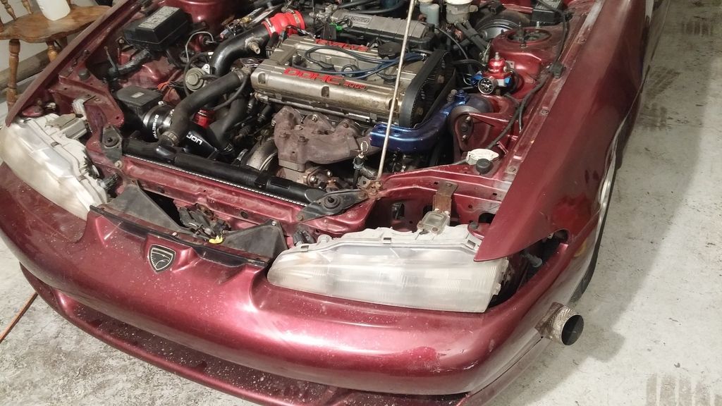

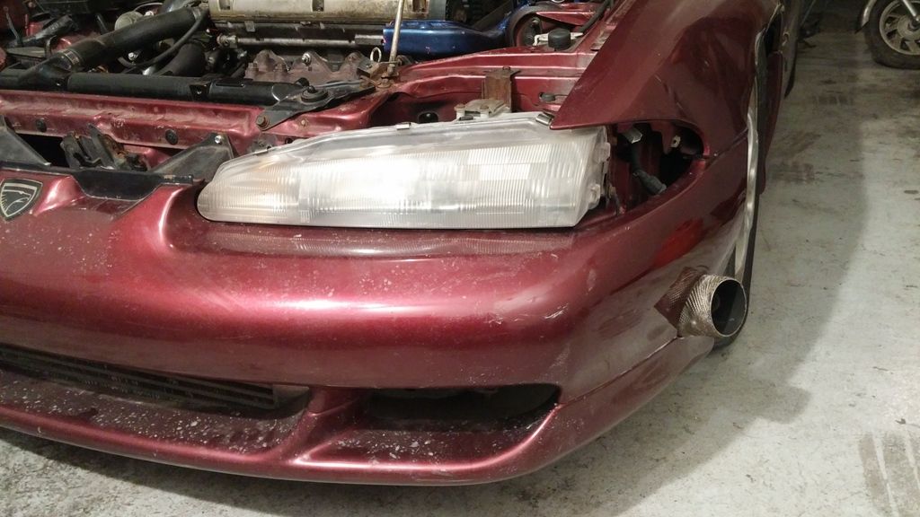

I know the car looks rough but its a work in progress. I also am relocating the battery, so that's why the battery is sitting like that in the pics, I don't have a tray for it. :dsm:

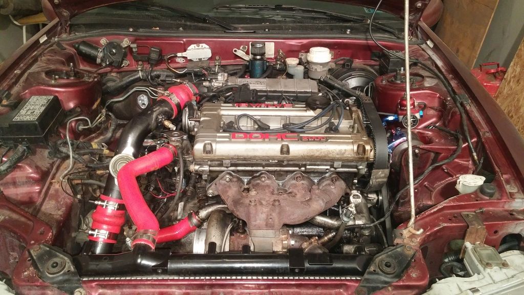

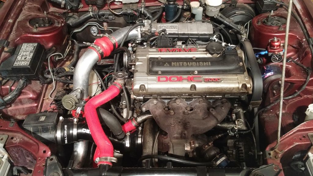

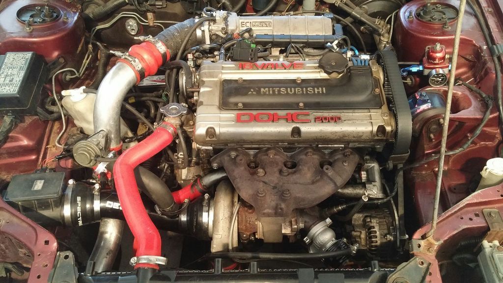

I reprogrammed the lc1 to the factory settings, and now the car runs in closed loop like it should. I was having issues with my upper intercooler pipe where the iat bung was welded, it had a boost leak and had it rewelded 3 times and it leaked everytime, so I bought a punishment fmic kit from the person I bought the Talon and laser from. Im using the piping from the kit on the Talon and using the core on the laser when I start to build it. I also changed all 16 valve stem seals and the valve cover gasket due to oil seeping out of the runners on the turbo manifold. I also put my pcv valve back in and replaced all coupler clamps with t bolt clamps. I need to do throttle body shaft seals yet.
Now I have the car idling perfect. When I rev it in neutral it has a slight misfire. When i go to drive and release the clutch it misfires really bad until it goes over 2000 rpm then it clears up and drives fine. I have replaced the coil pack, spark plugs, power transistor and inspected the spark plug wires. It has gotten a lot better but still not 100%.
Today I am installing a Tial 38mm wastegate and my buddy sent me spark plug wires to try they should be here this weekend.
20160305_202415_zpslz5trnq3.jpg20160319_235455_zps98dgu80s.jpg20160321_195634_zps9asqpaor.jpg
Update: Got the Talon registered and insured. I have been driving it for a couple days now. I believe I have a faulty front right wheel bearing. Also, the more I drive the car the better it runs, the misifre is still there but not nearly as bad as it was. I still need to do some tuning but it looks like things are finally looking up.
