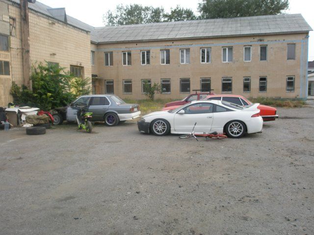

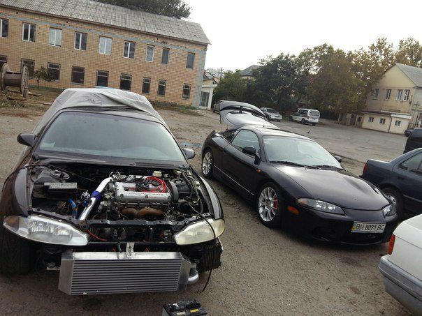

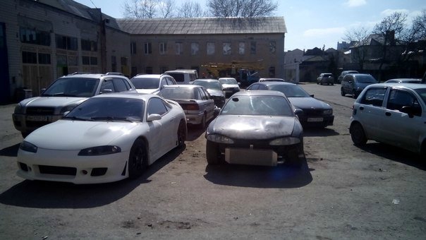

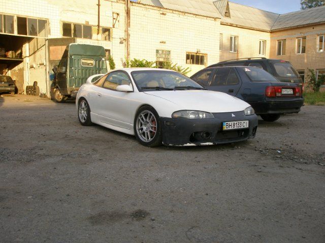

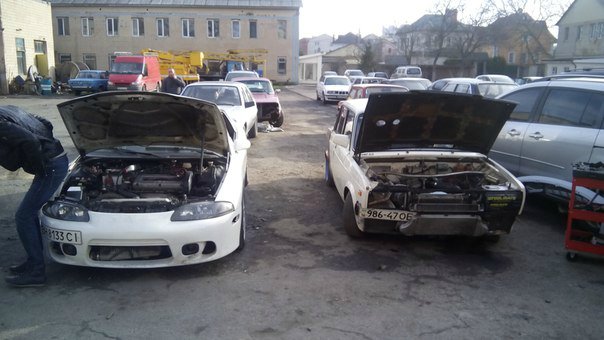

I have two cars.First-Clean GsX stock'99(White).Second-Race car with rollcage.plastic body,2,3 engine on 35gtx etc.(Black)
This is the speclist. Something is ready,Something is not.I'll subscribe everything in details/ Maybe someone helps me with a parts:coy:.who knows >?
White ^
Engine:
7 bolt .
Evo beams
Evo pistons
Polished crank
Arp hardware
Stock head(polished)
Original-waterpump, oil pump, timing kit
Original timing belt
Fidanza flywheel
Evo3 turbo
Oneport NoS
Mishimoto radiator
Intake:
Apex'I filter
Pipe 2.5
Big intercooler
Fuel (switching to E-85):
Evo 560
Walbro 280 lph w/ rewire
Custom fuel rail
Fuel pressure regulator
Exterior:
Original GSX stock '99
Suspension:
Meganracing coilovers
All new original parts
Interior:
Cream and black skin
Transmission:
Rear LSD
Twinclutch clutchmasters\stock
Wheels/Breaks
Evo 8 enkei wheels
Evo 8 Brembo breaks
235\40\17
Electronics:
Evo 8 ECU
Evo 8 MAF
Boost gauge
Black^

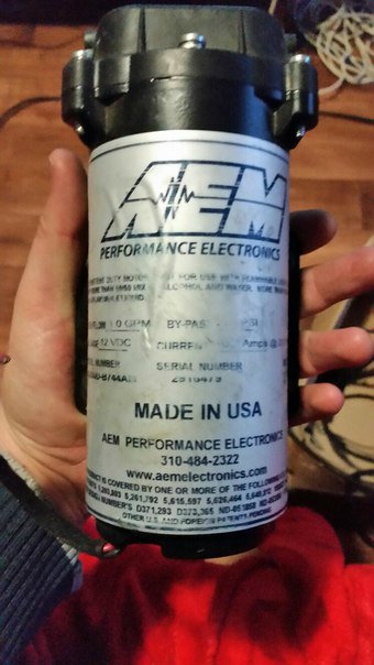

Meth stage 2

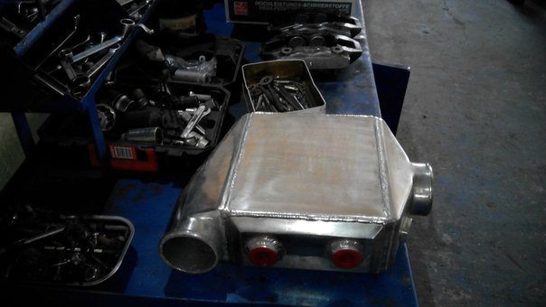

Water Intercooler

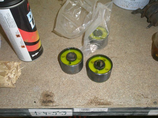

Aluminium subframe bushing kit(front+rear)
Arms with regulations
Energy suspension bushing kit
Aluminium driveshaft bushing kit

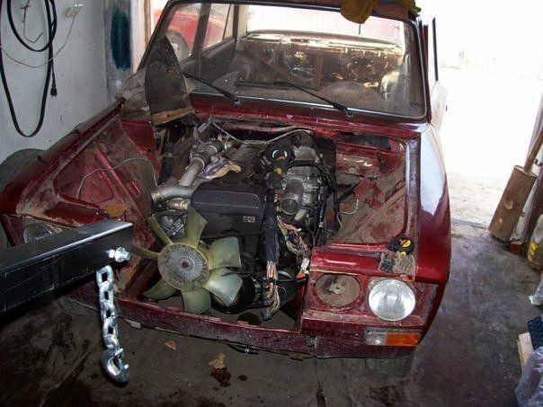

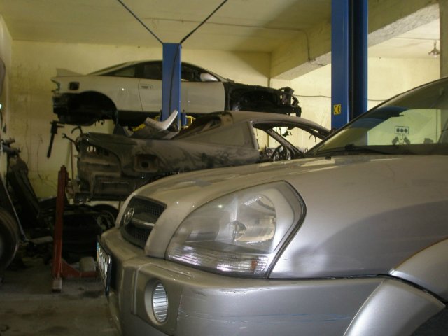

My first car was VAZ(Russian crap),it had something like rally suspension,lightweight wheels,audi 100 seats,focal acoustic and playstation 2.I thought,it was too boring and decided to swap 1jz-gte)))))
My second car was Mitsubishi galant(base of eclipse).I rode on it about 60 thousands miles.
Than my family bought Hyundai Tucson and galant became useless.

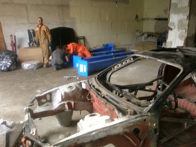

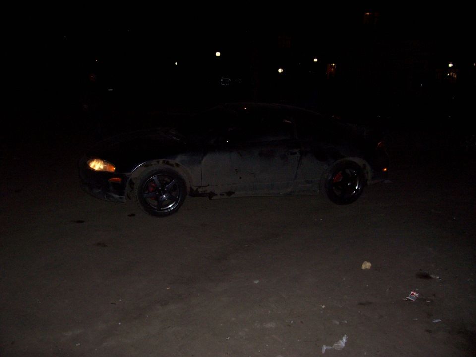

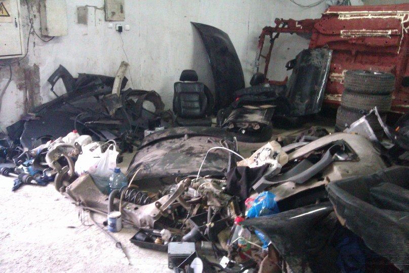

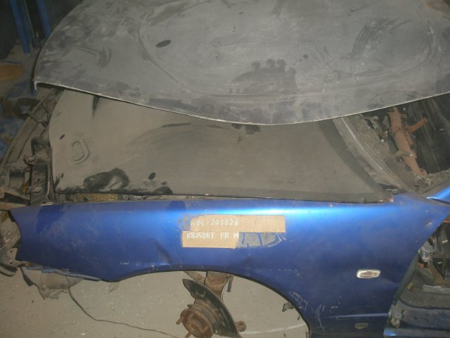

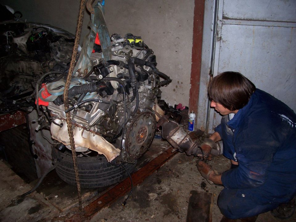

I sold it and buy Eclipse.It was nice GST in awful condition.It cost me 4700$.There was rust everywhere,broken springs,dead engine & turbo.Somehow this shit was driven to my hometown.And i began to rebuild it.

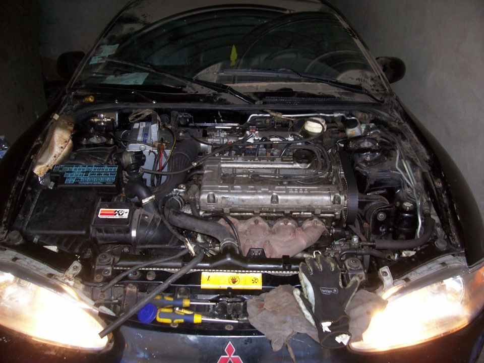

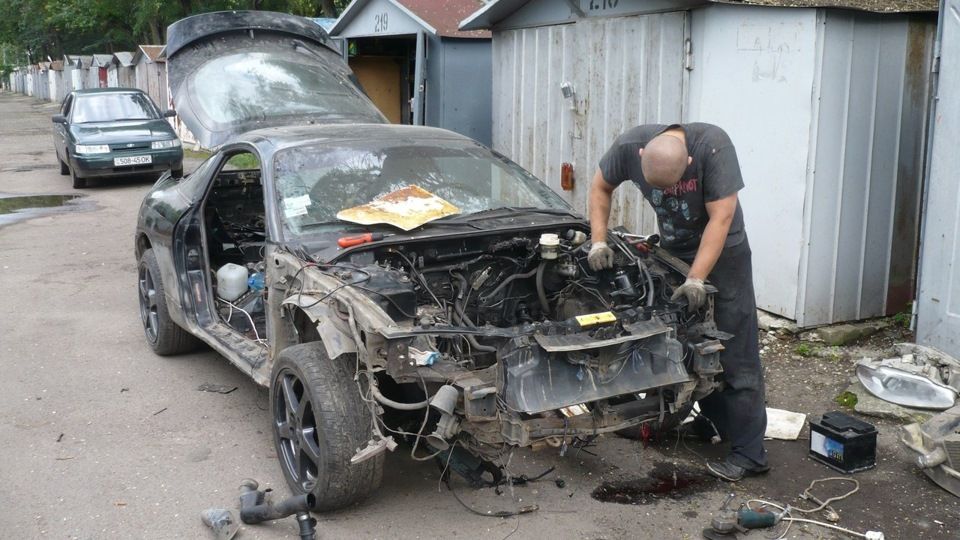

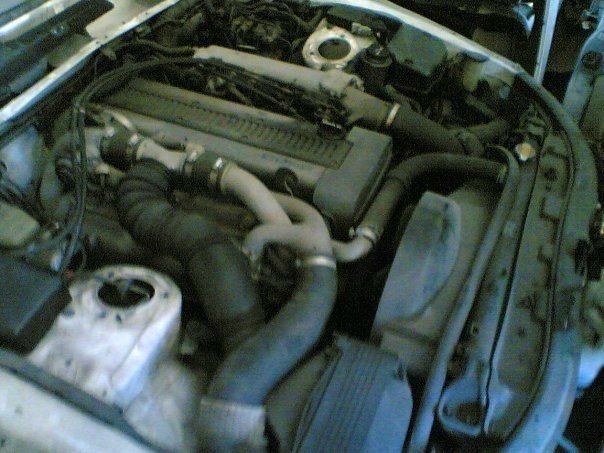

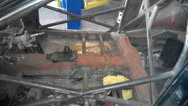

Car was an incredible crap.Engine died in a month.Rust was everywhere.Suspension was in an extremly bad condition.I was full of desperation,but i didn't give up.I rent a garage and rebuilt engine,suspension and electronics.Parts were aftermarket from local shops(extremely low quality).I didn't know what to do with a body and assembled how it was

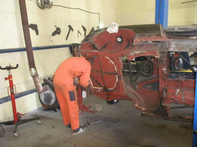

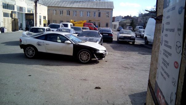

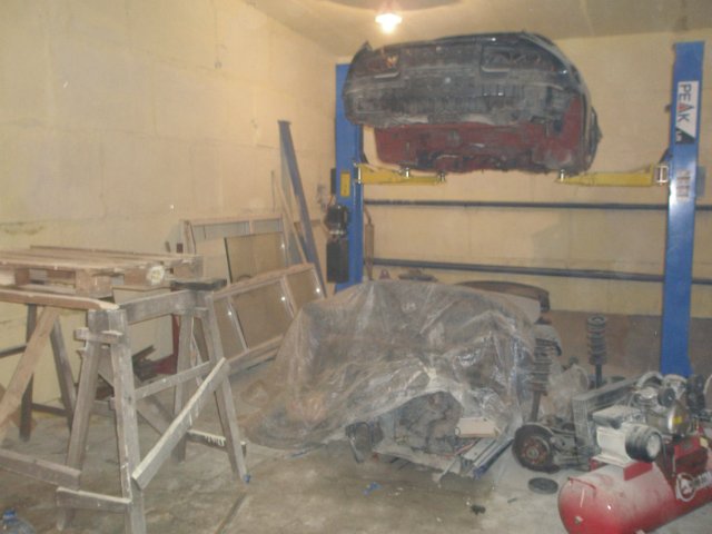

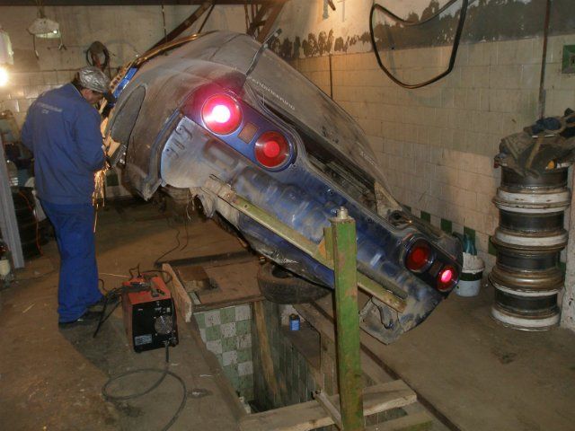

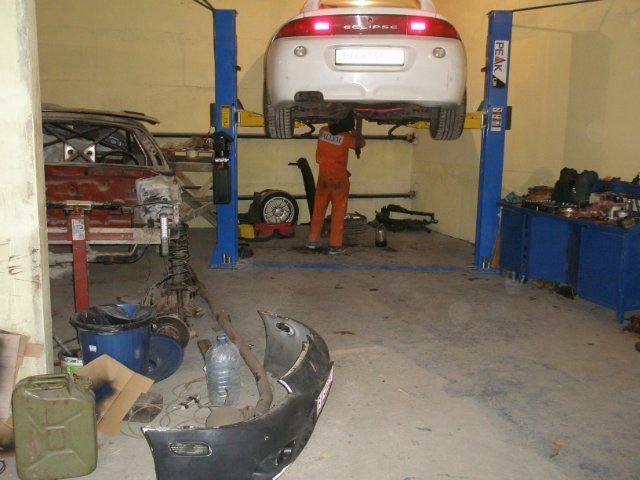

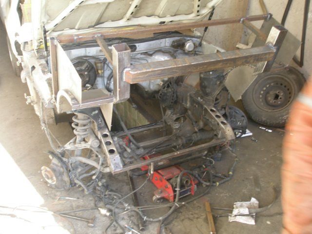

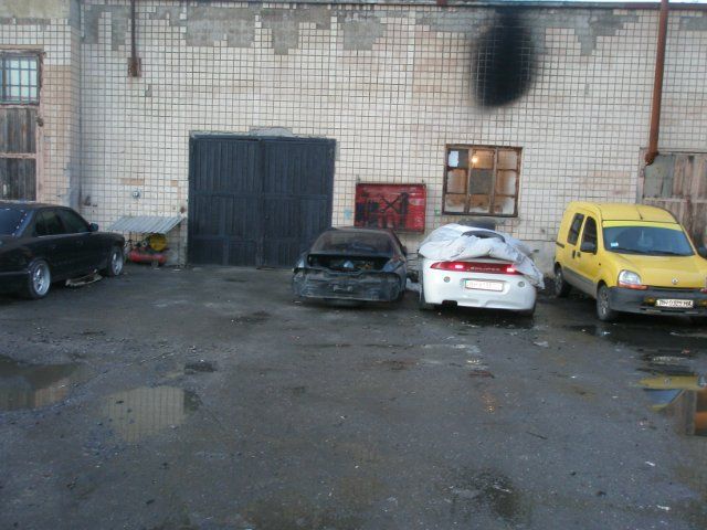

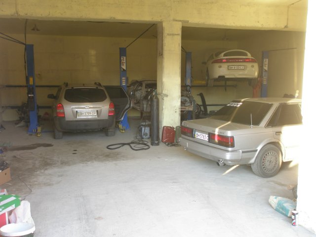

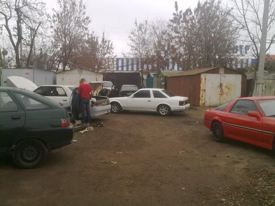

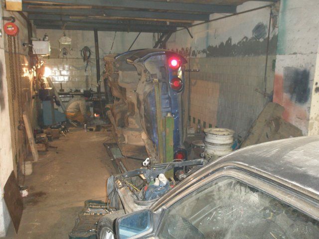

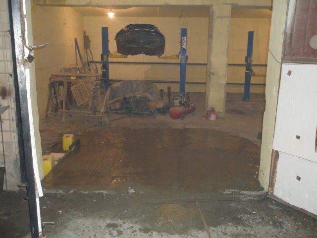

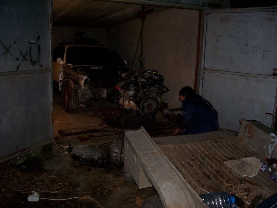

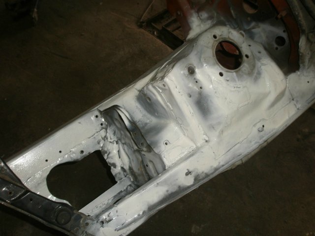

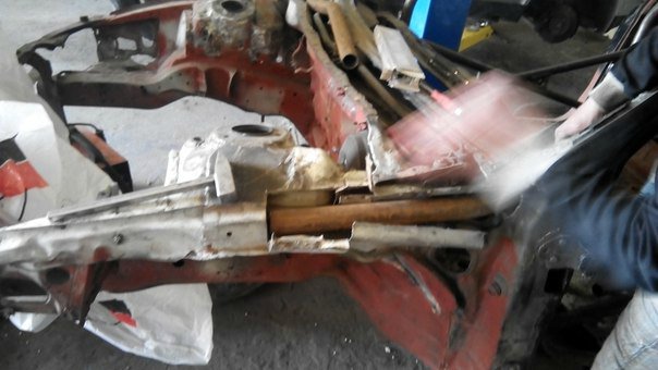

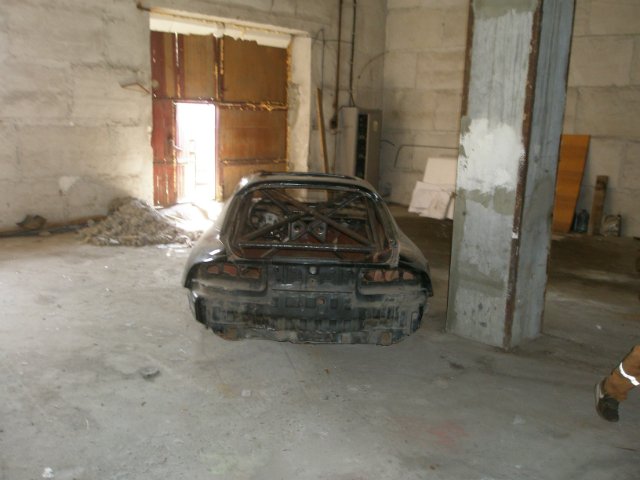

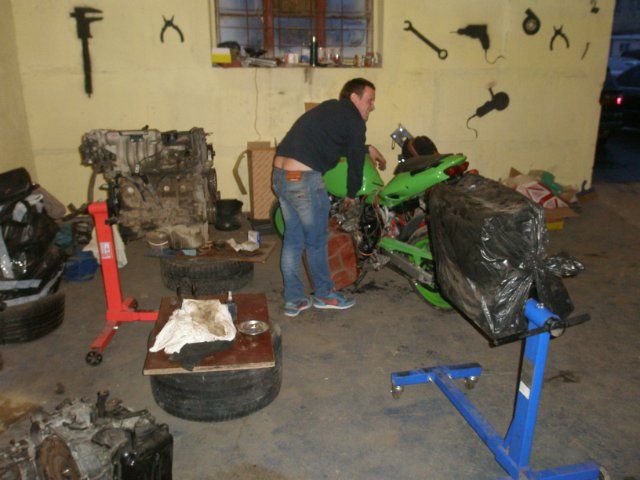

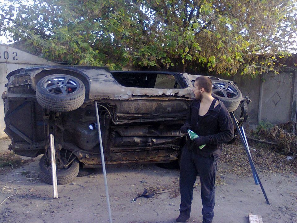

Later my neighbour from garages agreed to weld(repair) eclipse's body.I moved to other garage to disassemble car and my friend moved to my garage to swap v8))

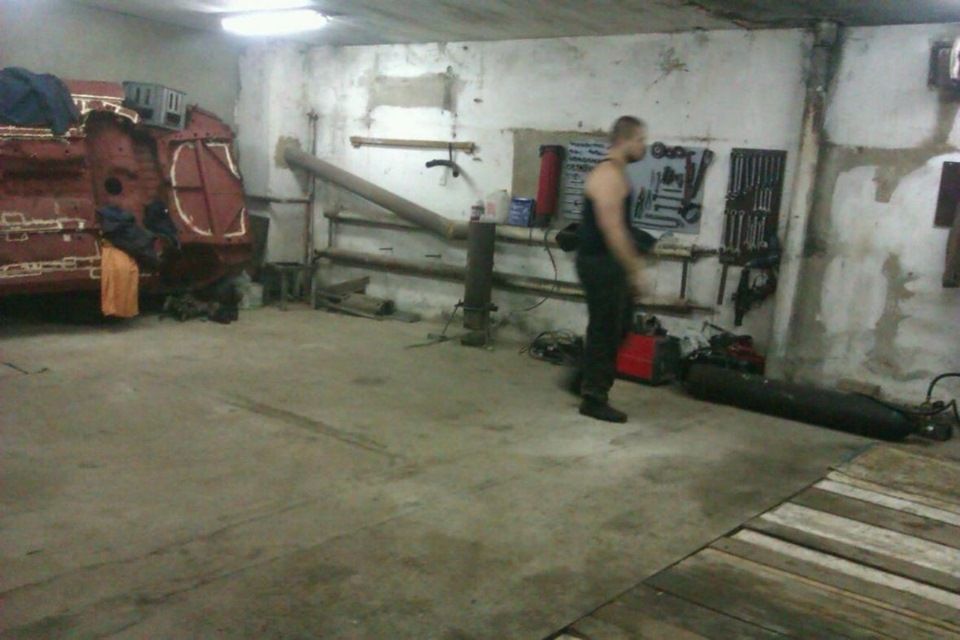

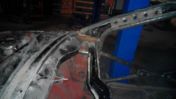

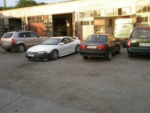

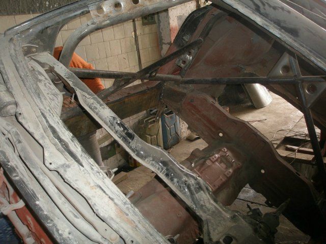

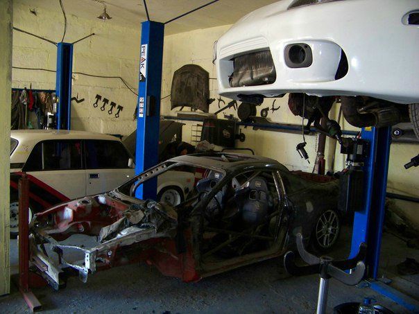

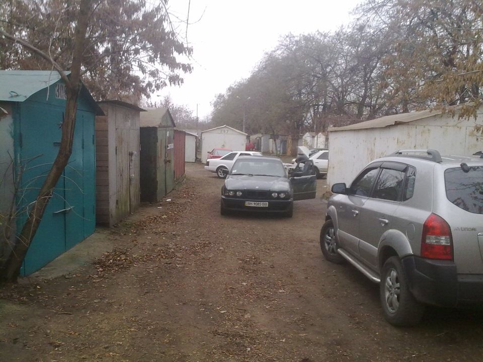

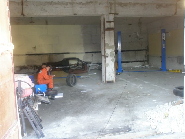

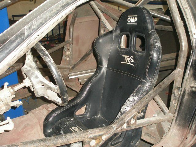

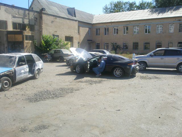

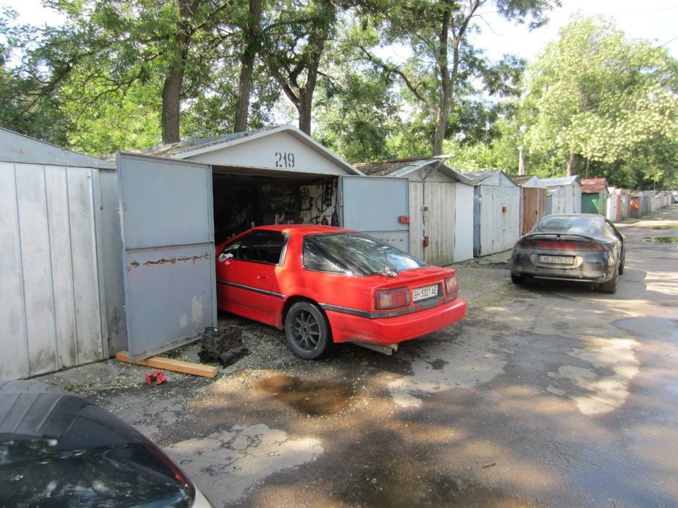

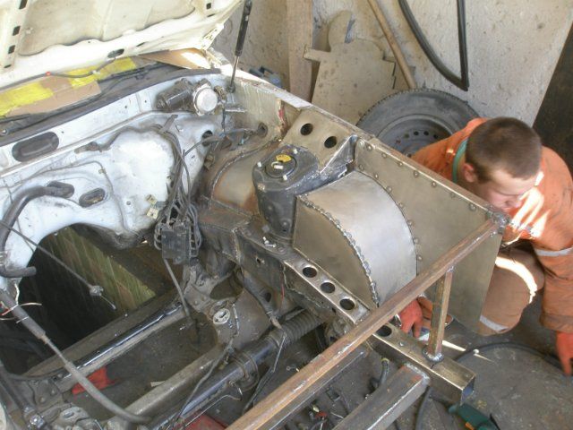

We became to meet in garages with friends.And the director of parking started to conflict this us.I was tired of this and when my new friend repaired eclipse body we rent new bigger garage and moved on to make a roll cage.We also begun to take ours friend's car for repair.I decided to earn some money and built a normal car))
7cc301cs-960.jpg 9cc301cs-960.jpg 52c301cs-960.jpg 380301cs-960.jpg a62301cs-960.jpg e62301cs-960.jpg
to be continued..

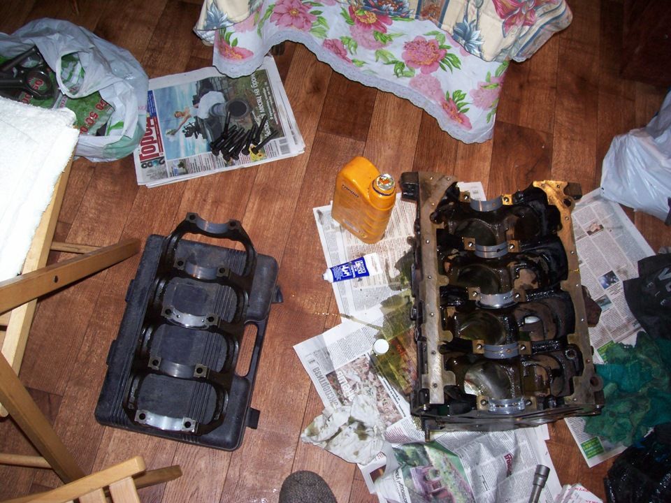

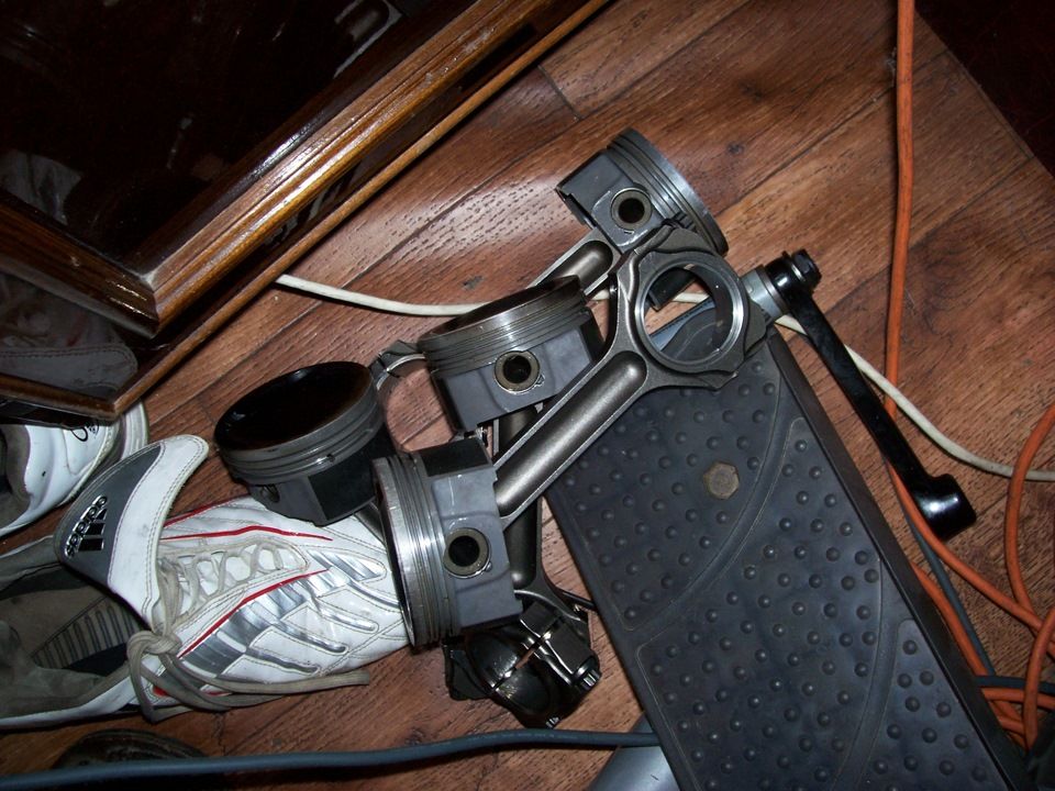

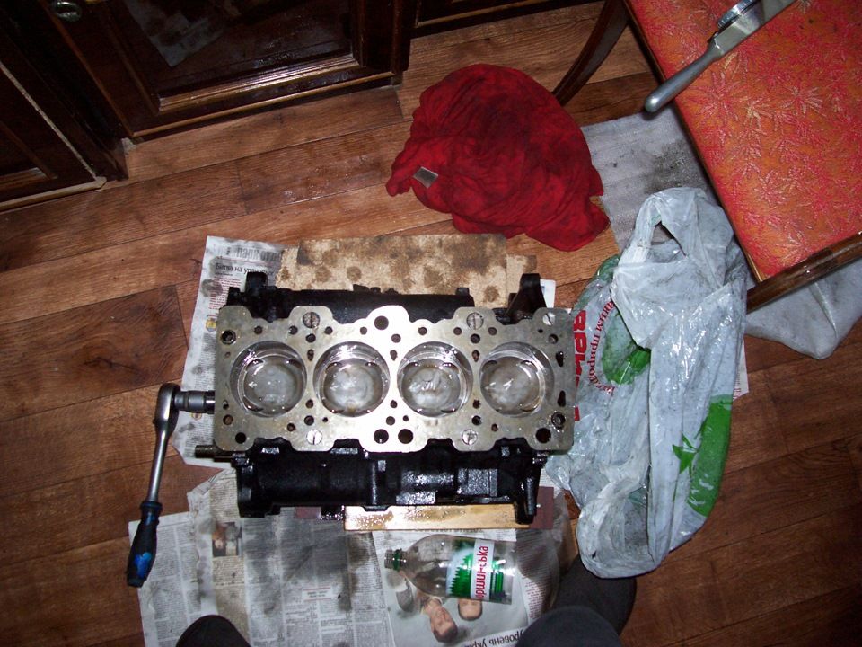

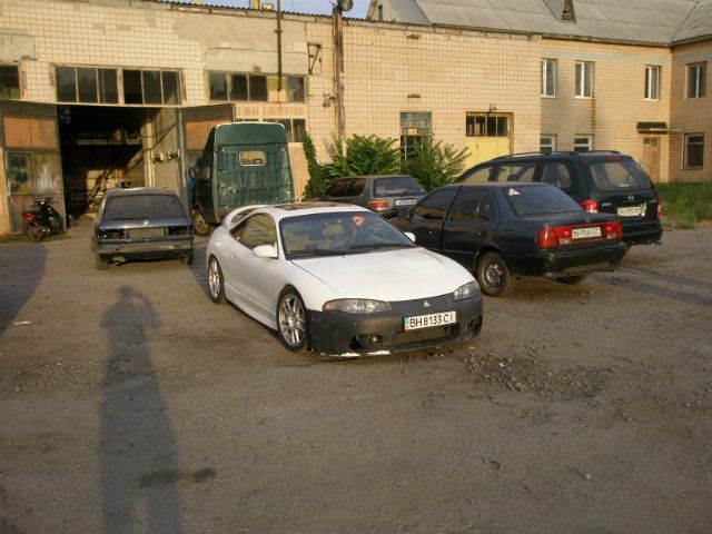

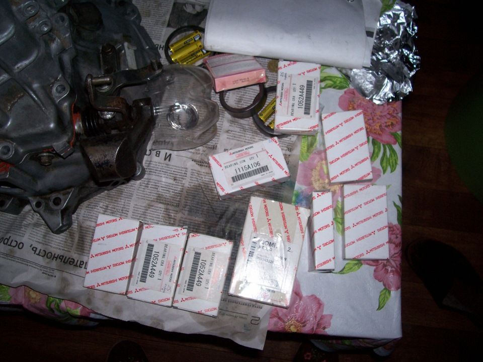

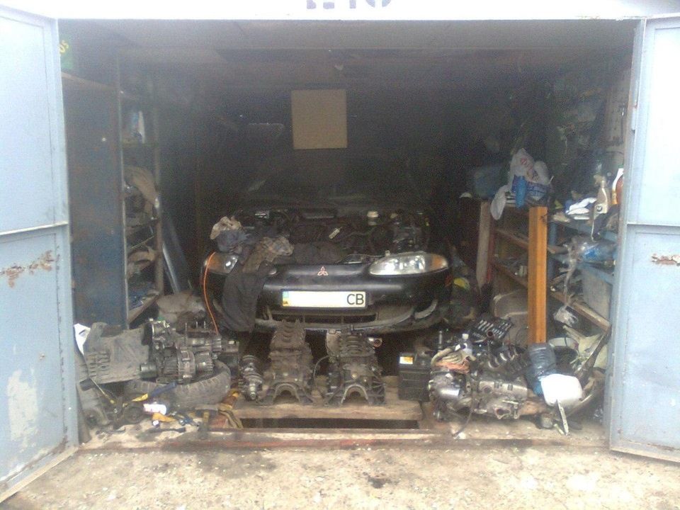

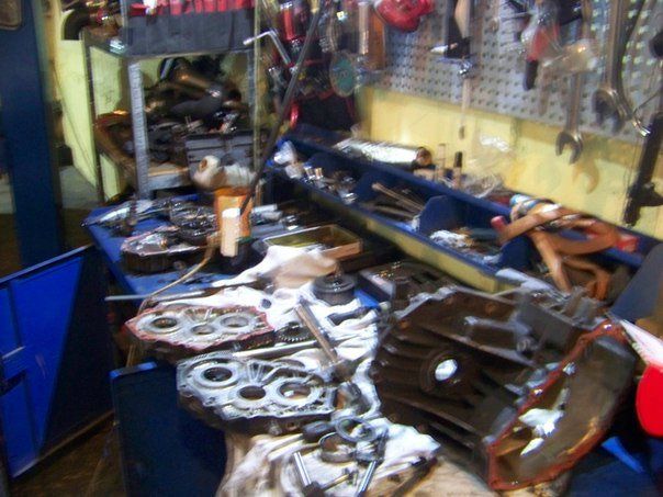

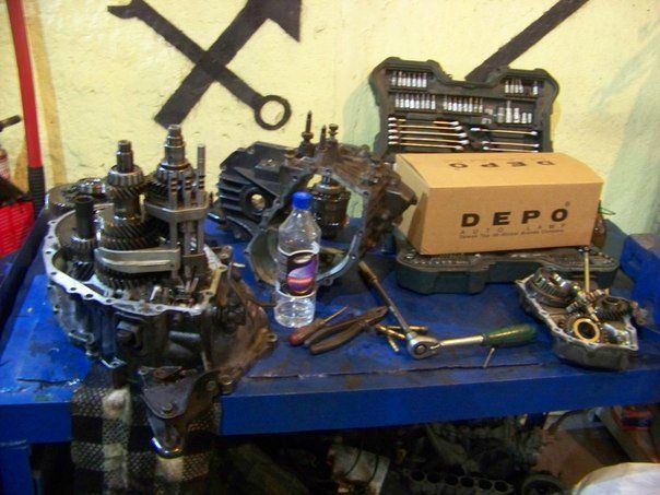

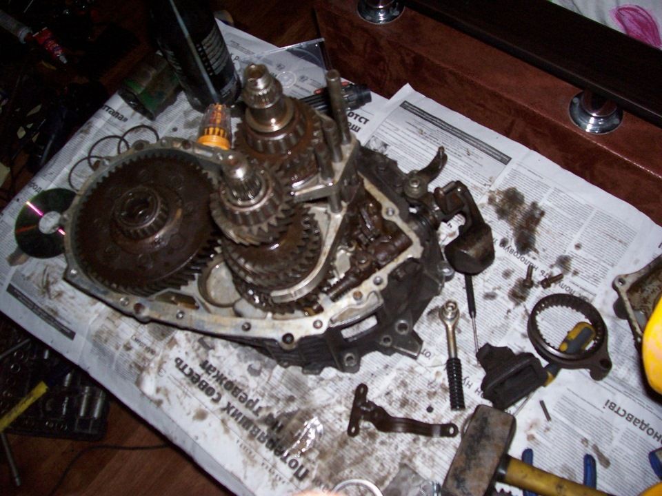

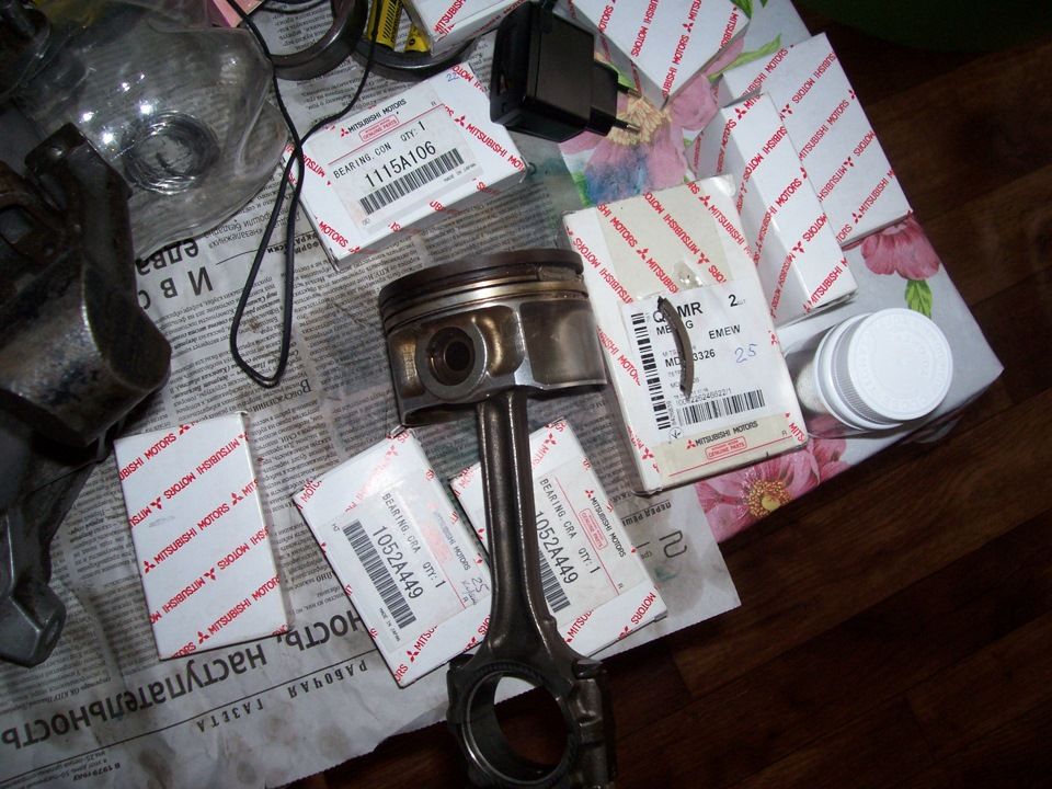

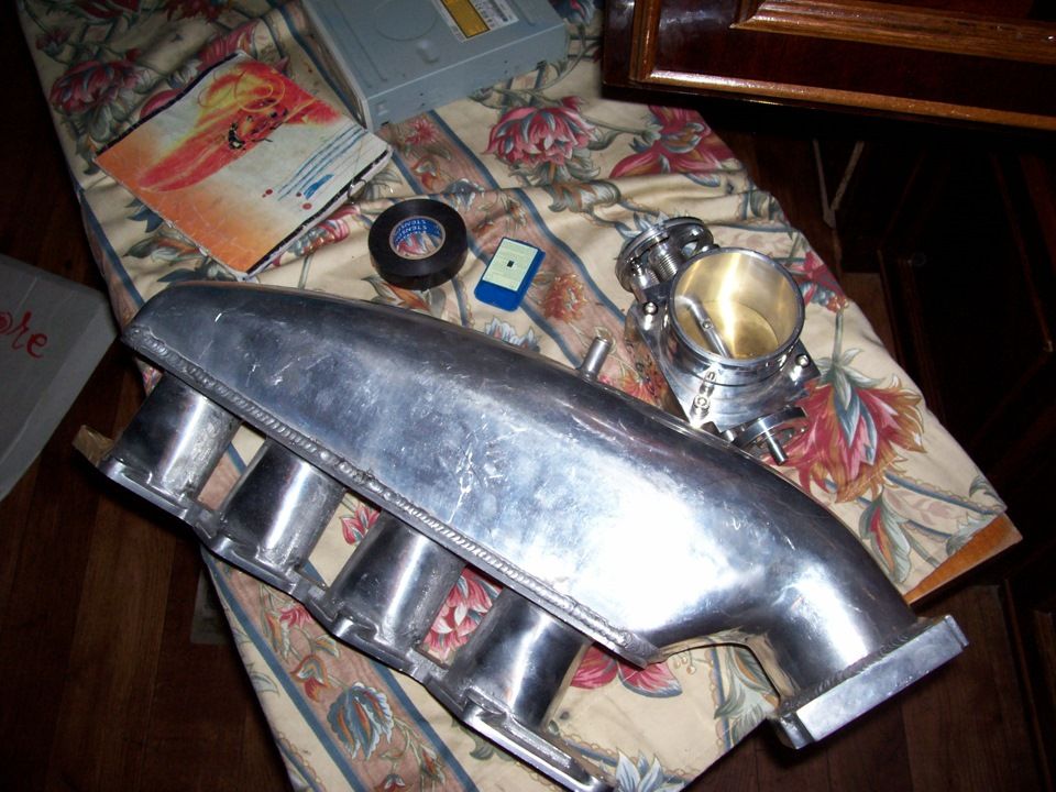

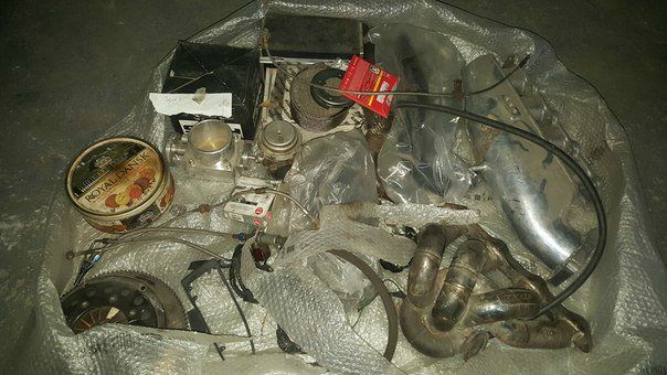

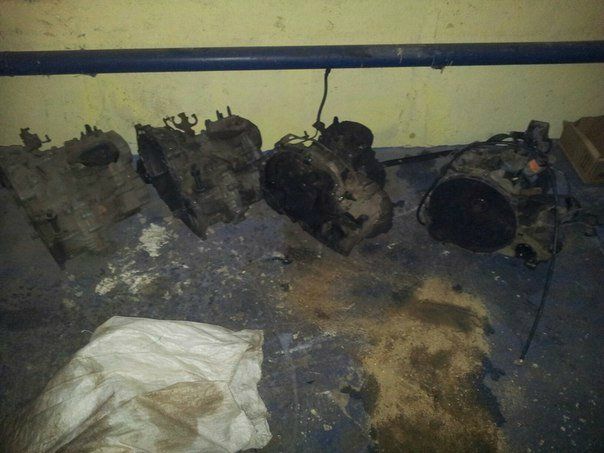

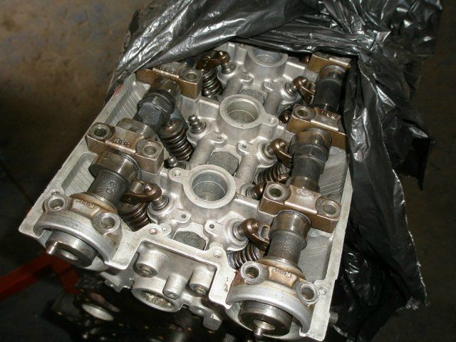

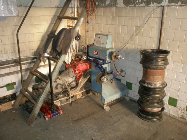

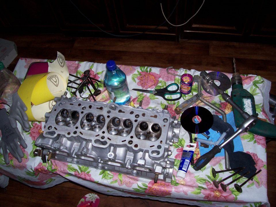

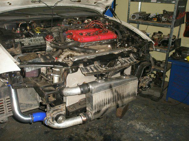

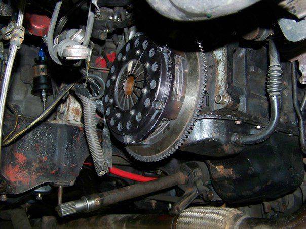

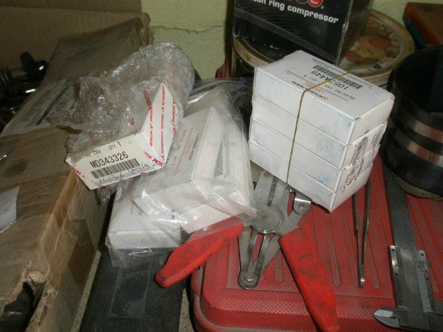

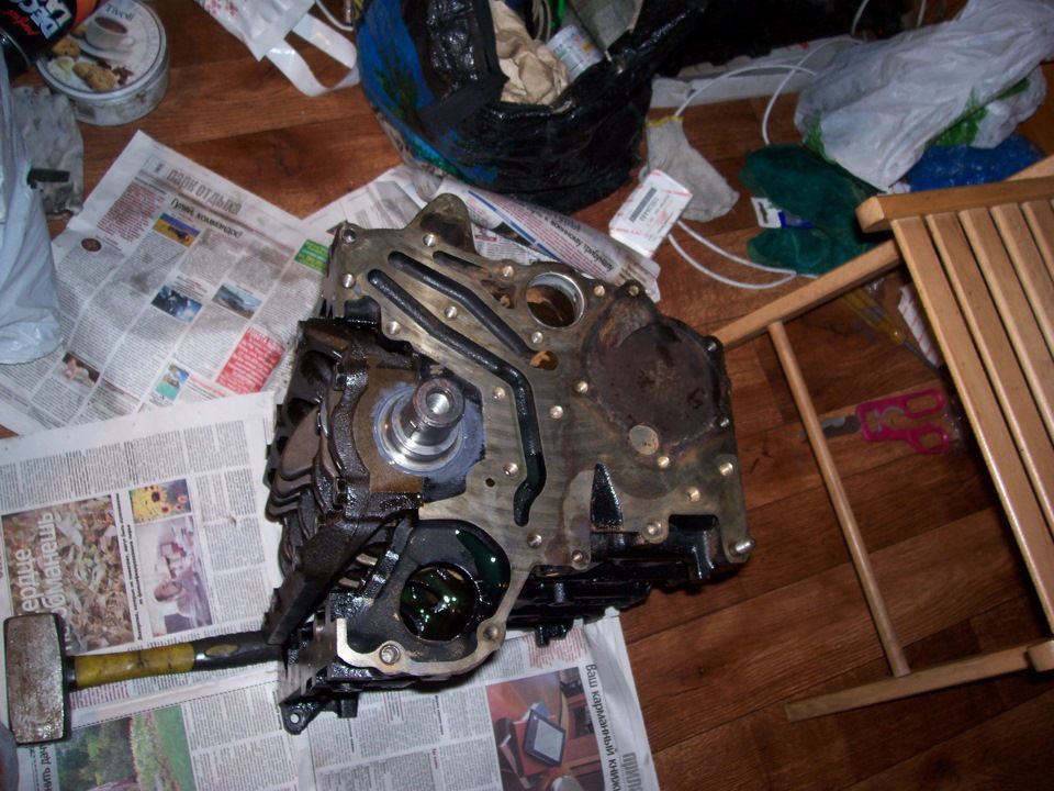

First my goal was to rebuild engine and gearbox with original parts.But later i decided to buy some not hardcore tuning parts too.When i bought everything i needed than washed dirty parts at carwash service and became to assemble.I assembled engine block(64 crank+forged Mahle) and stock SPZT box.After this i began to assemble head.Sometimes later i broke up with my garage friend which didn't make me promised rollcage and became to work alone.Later i decided that FWD sucks and decided to find AWD swap kit.I found it in Moscow also in St.Peterburg i bought Garret 35gtx with DNP exhaust manifold and fp cams 272/272. I with my friend sat in TUcson and went to Russia..

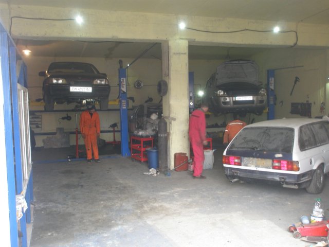

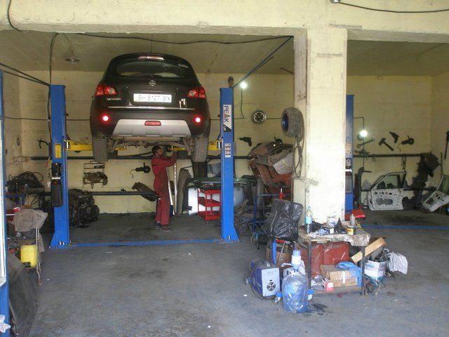

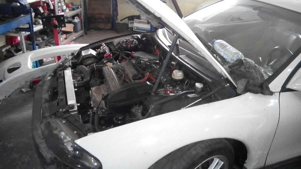

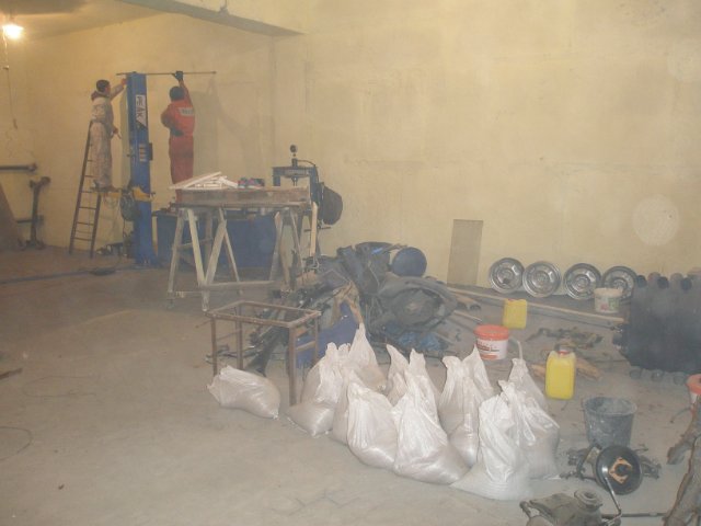

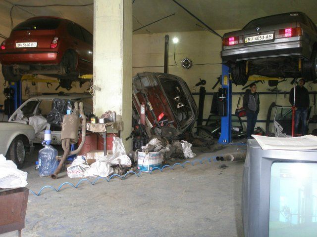

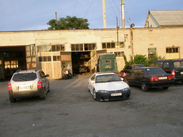

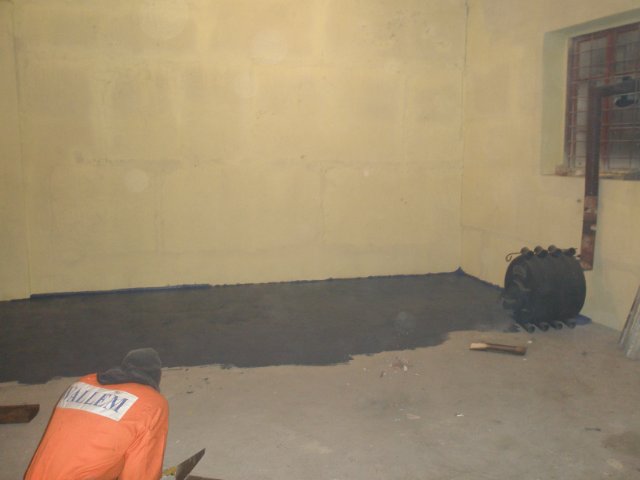

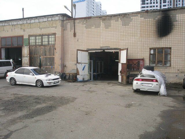

When i came back from Russia i decided to open normal carservice.Couple month later i bought one more Eclipse in Europe.I cooperated with owner of online aftermarket parts shop.We found good place,bought lot of tools,cleaned a place.We finished preparation for good start in a month and decided to make a grand opening party.I invited plenty of tuners,girls,friends,photographer.We made some barbeque and madephotoset with girls.

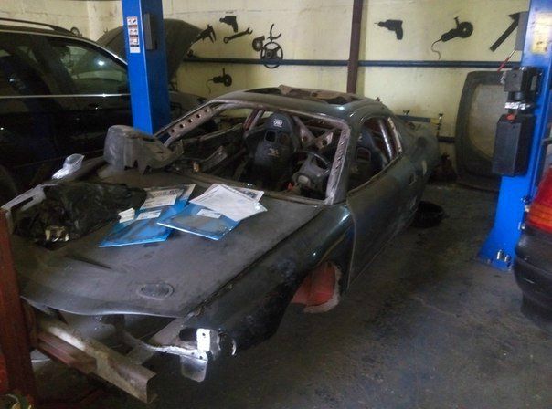

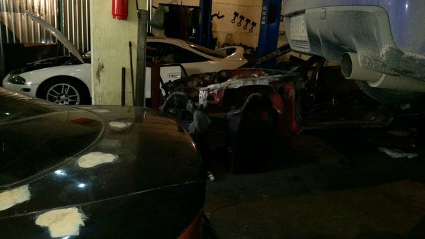

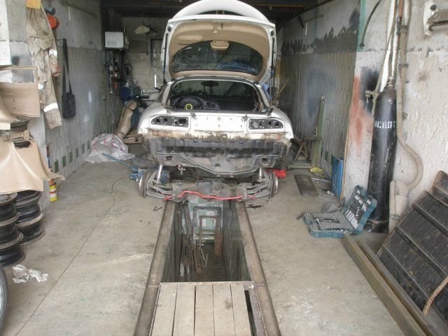

After party i begun to rebuild my new car.It taked 4 month.i rebuilt body and reassemled it from bumper to bumper.
Some photos: i'll upload tomorrow

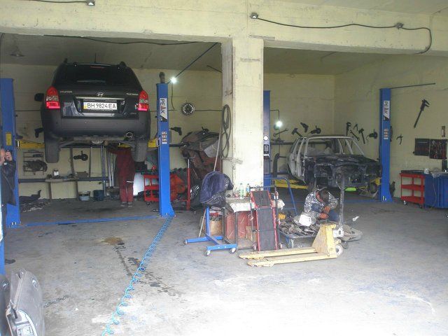

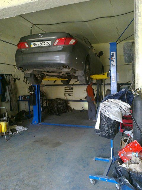

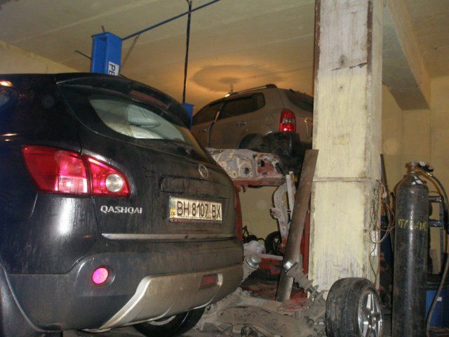

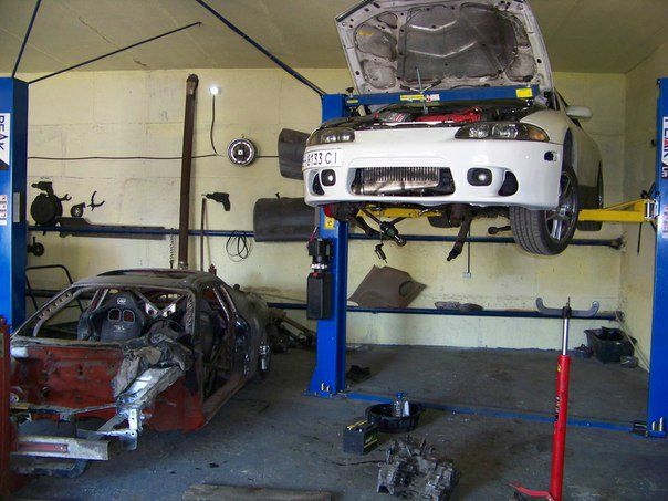

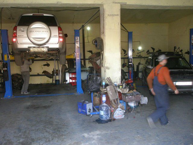

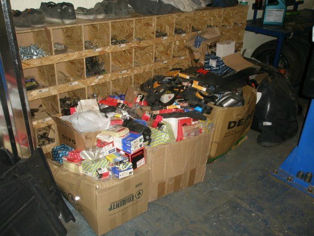

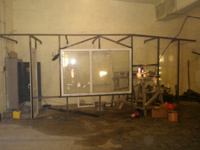

I met a new partner.He was real customizer and real fan of american cars.He has couple of Stangs and LT1 which we sold to start new shop.First it was little place only for two cars but then we expanded a little and installed some lifts.
My old shop closed in a half of year and i bought equipment and internet site from it.

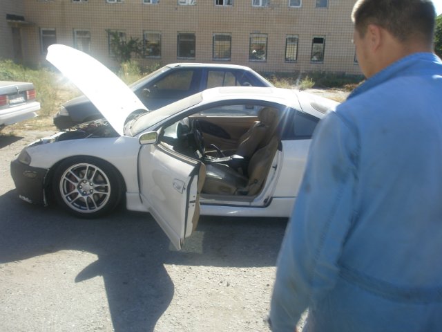

Meanwhile in my GSX died clutch,engine and some elecritcs.I wanted to fix it his winter but my Tucson's automatic gearbox decided to die too.And i left without cars for four month.

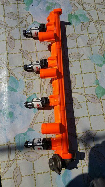

Some photos^

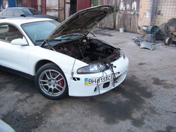

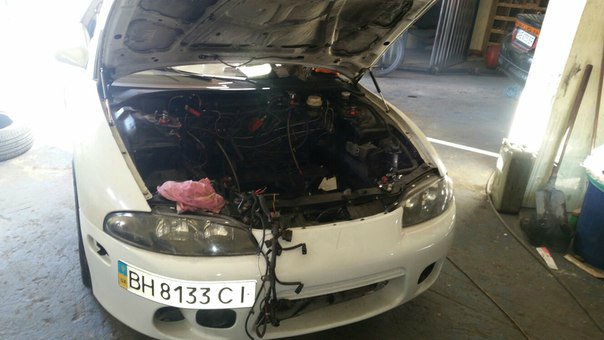

Hi,guys.It's summer time and for someone it means to rest ,but for us it mean to build with double speed.
Finally, i nearly finished businesses with my shop and started to do my cars
-White GSx

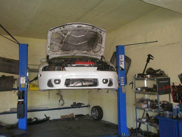

To make it looks so clean i disassemle it from bumper to bumper
every year and do everything that looks bad.
this year i will do next

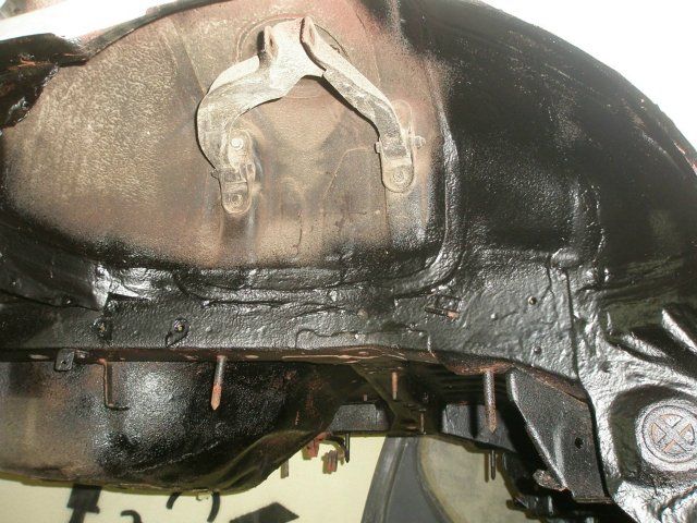

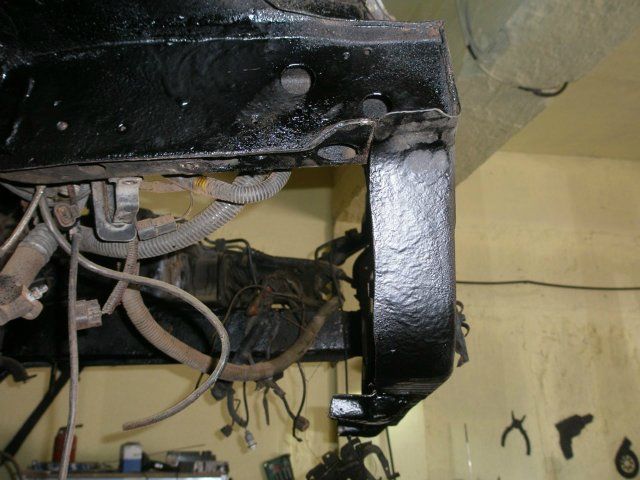

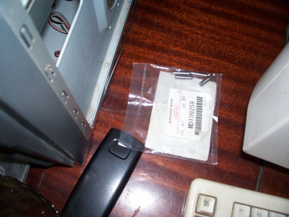

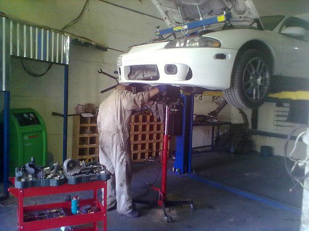

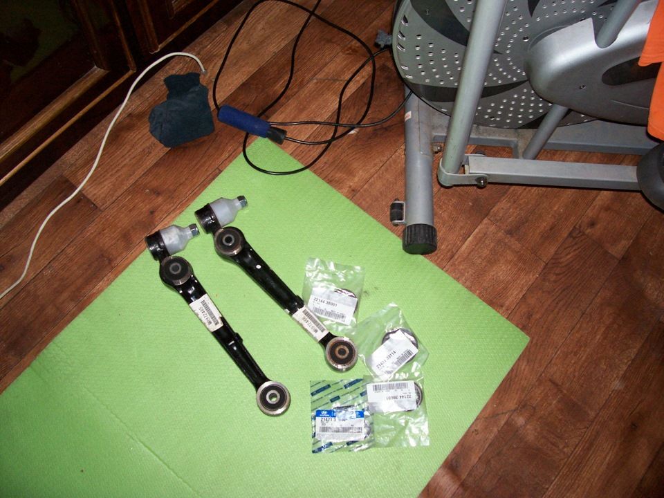

1.Engine Rebuild (oil jet fell out from block,new bearings,seals,oilrings)

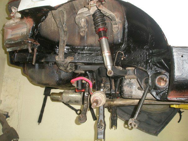

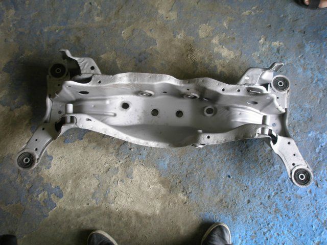

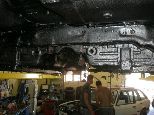

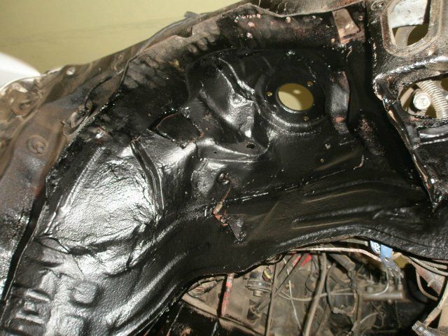

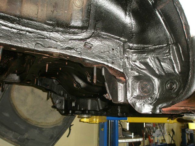

2.Rear subframe(sandblast treatment, custom bushes,painted to black color)
3.Front frame changed
4.New diff

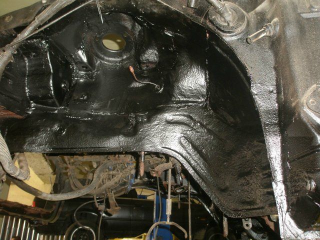

5.Body(fully anticorrosive treatment,painted hood and bumper)
6.Front cooler kit.
7.New solenoid,gaugaes

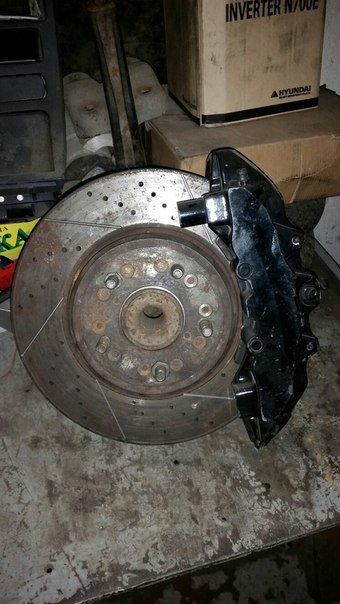

8.Brembo Brakes (brakes rebuild,new pads,willwood regulator)
in black eclipse now only body is under construct
