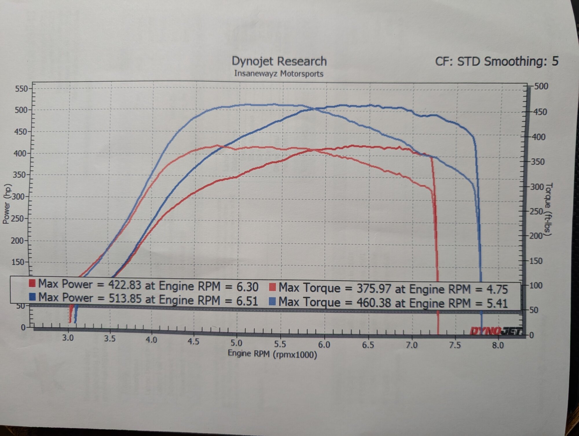

Finally got the car dyno'd with the Haltech R3, it took about 4 months to iron out all of the bugs and clean everything up.
This is the dyno sheet while on pump gas and at 25lbs on ECMLink.
I had an evo3 o2 housing with an internal wastegate with this setup, and a 70mm S90 throttle body. Coils were Denso COP kit.
Red line: 93 pump gas
Blue line: One ethanol S
This is the dynosheet on Haltech R3, the only thing that changed was the Morrison Fabrications o2 housing using an external gate and the DBW 68mm throttle body (and the tuner). The crank trigger was changed to the Magnus 36-2 kit and the cam trigger is factory but the one of the teeth was removed. Coils were Nissan R35.
